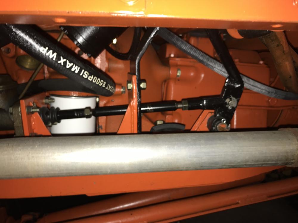

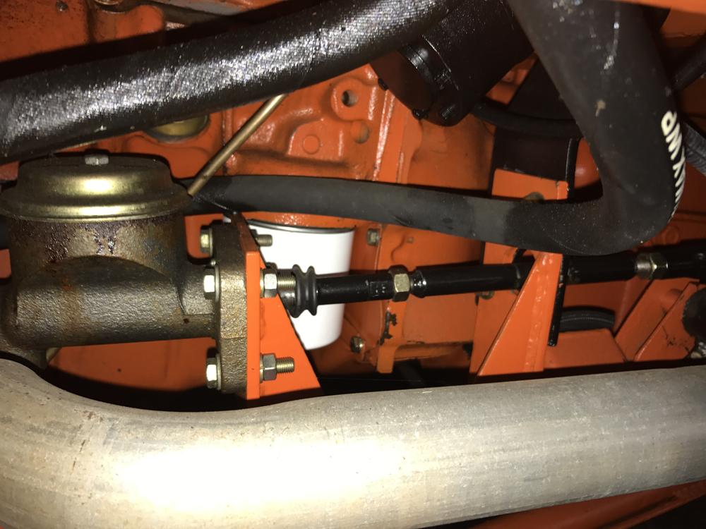

Was hoping to just add a momentary switch under the pedal through the floor but the pedal doesn't get close enough. So here are some pics of what I have to work with and use the linkage or pedal to actuate the switch.
Open to input on a nice clean safe design :

On some of my tractors the switch is on the front side of the pedal so that when it's just sitting the switch is "open" when depressed it closes the circuit.
That does mean if the master is out of fluid its disengaged though the best is to go to the clutch arm itself to really know it's depressed. But even then if rusted to the flywheel it can move. And a double redundant system would incorporate neutral switch in the transmission
Water is a concern. Other option is a new shift knob with momentary switch. That will make me and others check for neutral and be in it. You would have to push the button and turn the key.
