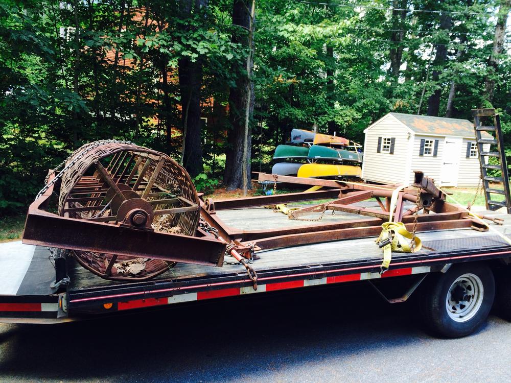

Headed up Conway and plan on meeting up with another member to pickup the Valley Engineering Powdermaker/Roller I bought in Fryeburg, Me.. Will get pics up.

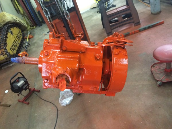

Front housing and springs painted in background. Also test fit the transmission to motor. Not sure why they used the washers in between the first few pics was not cleaned and the last one is cleaned and fits tight and flush. Only thing I can think of is that the round flange did not fit in because it had paint and junk on it. I also measured and the output shaft is not even close to bottoming out.
New motor mounts and I will be putting the rubber back in on the bellhousing mounts. That is how it was and on the bottom of the bell there is two little nipples that stick out that the rubber takes out. If it was metal to metal it would vibrate and the nipple would not allow it to sit flush. Must be a locator pin for factory install.

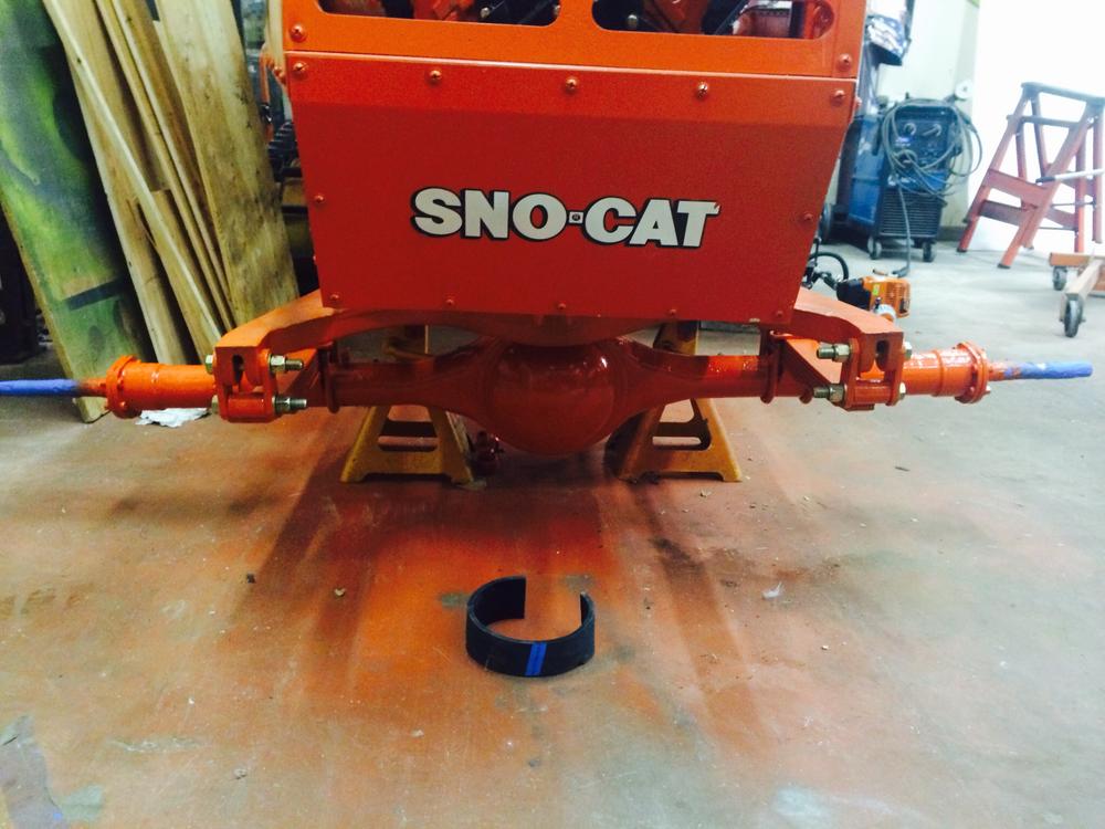

You dun good Bluefin. Using the long bolts for the springs and shackles is good because that way the threaded section is not wearing inside the spring and aluminum fifth wheel. You may want to cut the excess from the ends to make it "factory correct" but that is just an aesthetic thing, not to mention weight saving. Lookin fine!!

Transmission painted ready to go in.

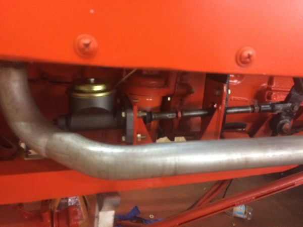

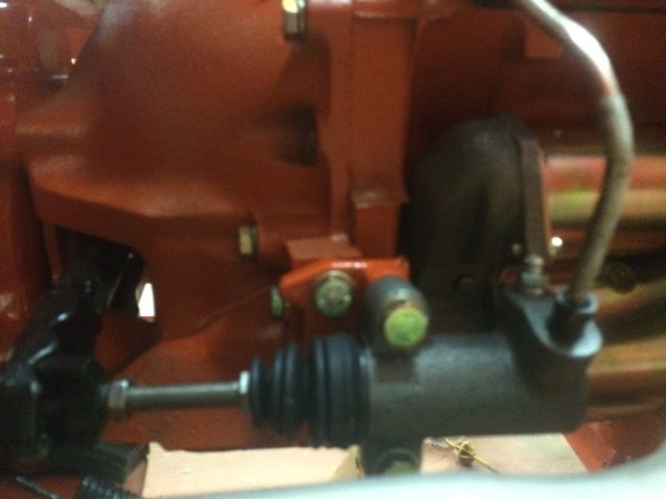

New clutch, bearing, shift fork, master, slave, line.
Amazing how much nicer the clutch feel is.
