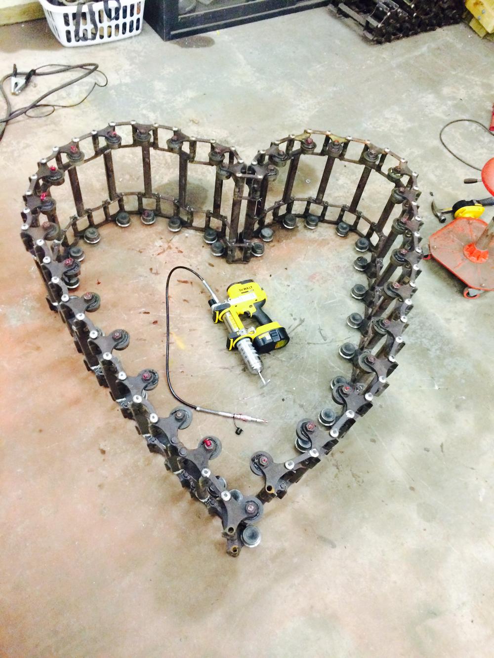

Swapped some rollers thanks to some friends.. Never thought I would say greasing the tracks is easy. They are coming off everytime going forwAed!
what do you think about the dewalt grease gun we just bought a lincoln for the shop I have been resisting one for my self because they use different batterys. does the dewalt have a high low pressure setting? I found my pneumatics don't work track adjusters well.
Just so happens Valentine's is my birthday day. The dewalt gun is awsome. Having lots of 18v dewalts makes it easy. Primes quick only used 2.5 tubes compare to 4 billion in pneumatics . They make. 20 Volt also.
Great investment

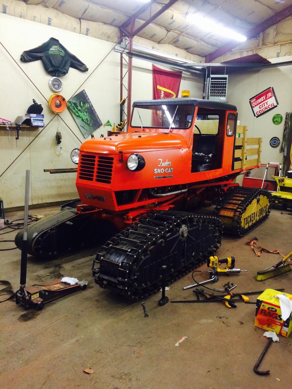

Back on track. Was able to take all the slack out of the adjusters and bend the random bent links straight again. Removed a grouser and with all the wear over the years I am down to 30 bearing grousers instead of the 31. Turns smooth adustment is mint and now have plenty of room for future adjustment.
Drove around a bit. Boy does it feel good and tight. Clutch silky smooth purring like a snow kitten!
Nothing left that would keep me off the snow. Feels good!

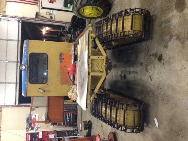

This is how we started with the idea to leave it as is. Guess I was wrong!

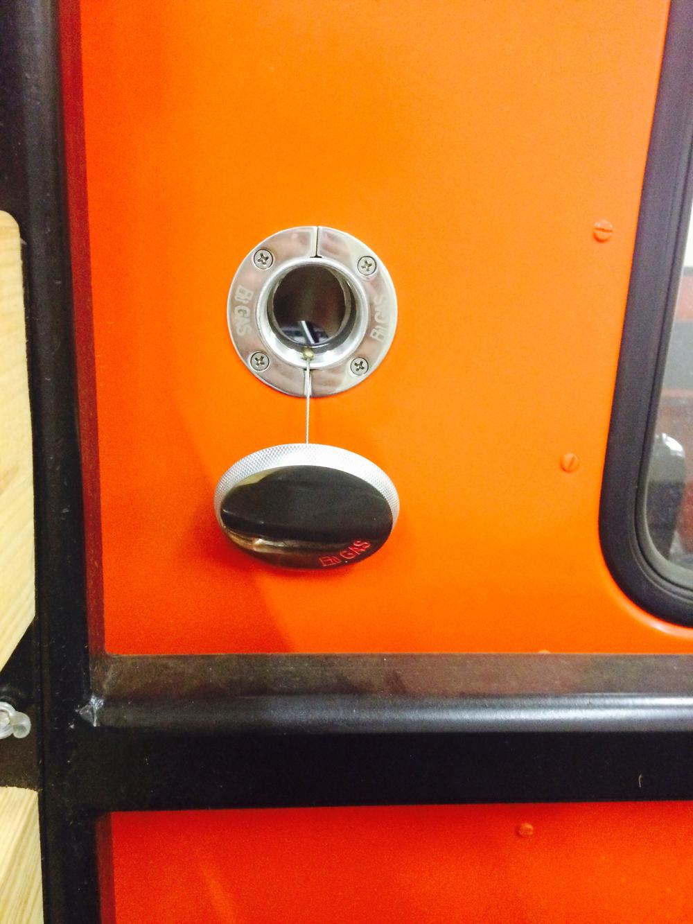

This Canadian deckfill is stainless and fit the stock hole
. Also is now 1.5"
And vented for new tank
27 gallons room for a 18 pack on the other side. Factory shelf fits over the new setup
