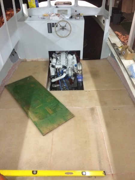

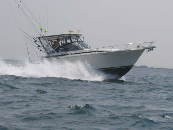

Just back from Bike Week in Laconia, been wakeboarding behind the zodiac on the mighty Merrimack River, and thought you should see some pics of the downeaster that has been cramping my garage burning up sometime. Boat was gutted, deck and stringers are all composite and that is a new 370 hp cummins turbo diesel in a 25 footer. Should go good and can get back to slaying some Bluefin tuna and lobsters. Hence the Blackfin4Blufefin handle. Pic is of the 31 running which was sold in March RIP. Going to need to change my handle at some point.

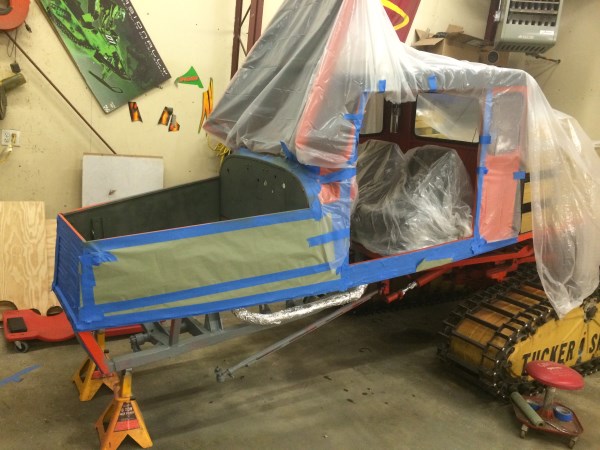

Painting in progress.

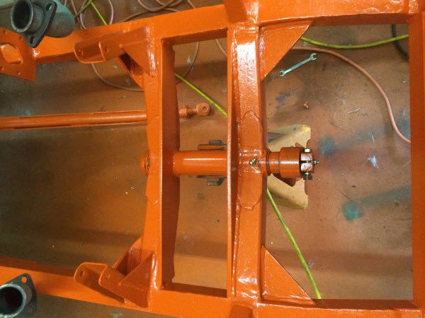

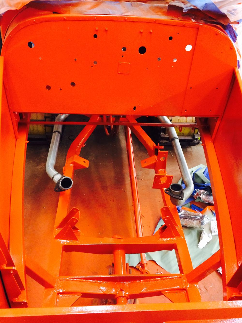

Paint does wonders. I sit and pick apart the rough weld work and grinding trying to get perfect but orange brings it all to life!
sprayed more orange. Some on the tucker and most on me.

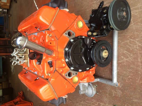

One more coat then engine install!

Small block is at the surgeon for stud amputation. Got the new starter and alternator. Working on the boat a bunch. Painting some parts for Tucker.

More Paint. Trunion all greased new fittings. Hope to have the turn table and leaf springs back on tomorrow night. Motor is back stud is out.

looking good! I am enjoying the boat pics almost as much as the 442! tell me more about the hull, how old is it? that turbo looks scary close to the stringer- what are you doing for heat protection?
That is going to be one awesome fish killing machine:beer:
1989 ish Terry Jason Hull. all re done composite nydacore. There is an insulating wrap that is not on it. We had a Blackfin that we repowered with two of these cummins already with similar clearance.

Also got the decks cut for the boat. Splashing that next week for a test run. Motor install coming soon!
