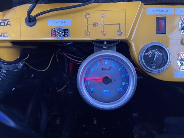

Hillbilt you nailed it! I just deleted the governor, used a phenolic/aluminum spacer combo under the carb,added a Petronix rev limiter (set at 4500 RPM…..wasn’t sure on max for these engines)……worked like a charm!! I was losing power in 3rd gear….runs like a whipped dog now! Added a tach….why not.

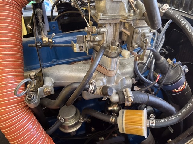

Sweet! You beat me lol. Looks real clean Bob. I got the spacer welded up and mounted the new carb. Have to modify the throttle linkage but chipping away. The fuel line is only on there for mock up I’m changing it to a 90* fitting and moving my fuel pump location

Oh, as a side note….I reset the max RPM to 3600, tested the power in all gears (in a farm field), runs like a champ (was able to go from a standstill in 4th gear until I hit the rev limiter at 3600 RPM). It could never do that….on snow! I hit a bumpy patch in the field, got thrown around in the cab….scared me a little….lol.
Im sure these engines could take more than 3600 RPM, but I believe they were designed for that max limit (Ford Industrial KSG416).

Thanks, I found some posts here on it and the guy said deleting the governor and bumping the timing up a couple degrees was night and day difference, glad to see it also worked for you. As for the carb I haven't been able to properly run and idle it just yet as my fuel pump decided to die on me, I was going to replace and move it regardless so no biggie. But I did fill the carb manually to test fire it and it definitely revs up alot quicker than before, but still have lots of tuning to do.

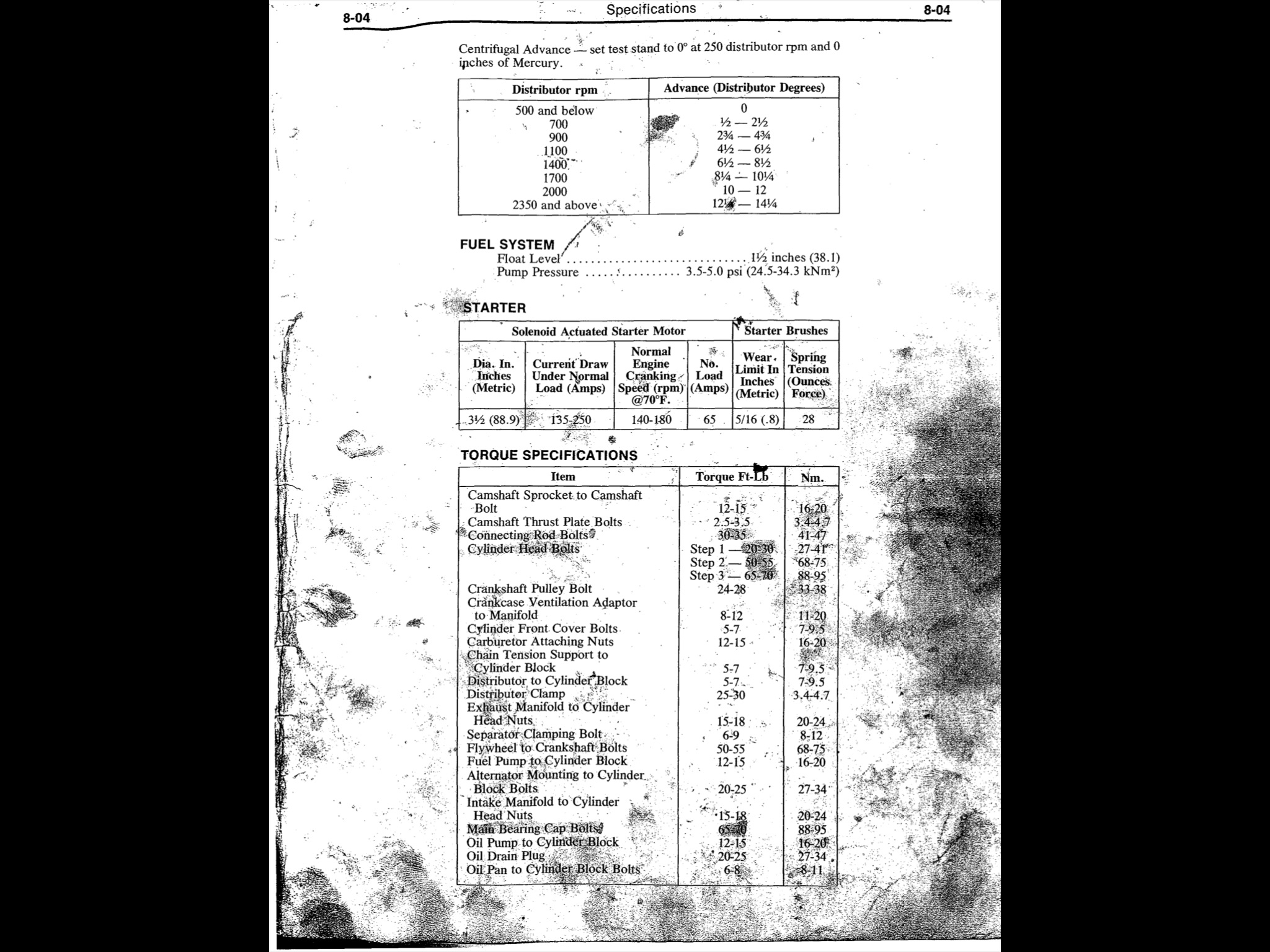

The manual on the KSG416 calls out 6 deg. BTDC (I set it when rebuilding the engine as there are no timing marks on the crank pulley….at least my pulley didn’t have them…..only on the block). Here’s a couple pages on the advance.
The fuel pump I used came from Summit (working well). I bought an electric pump for an emergency back up, but mechanical keeps it simple on the fuel side.

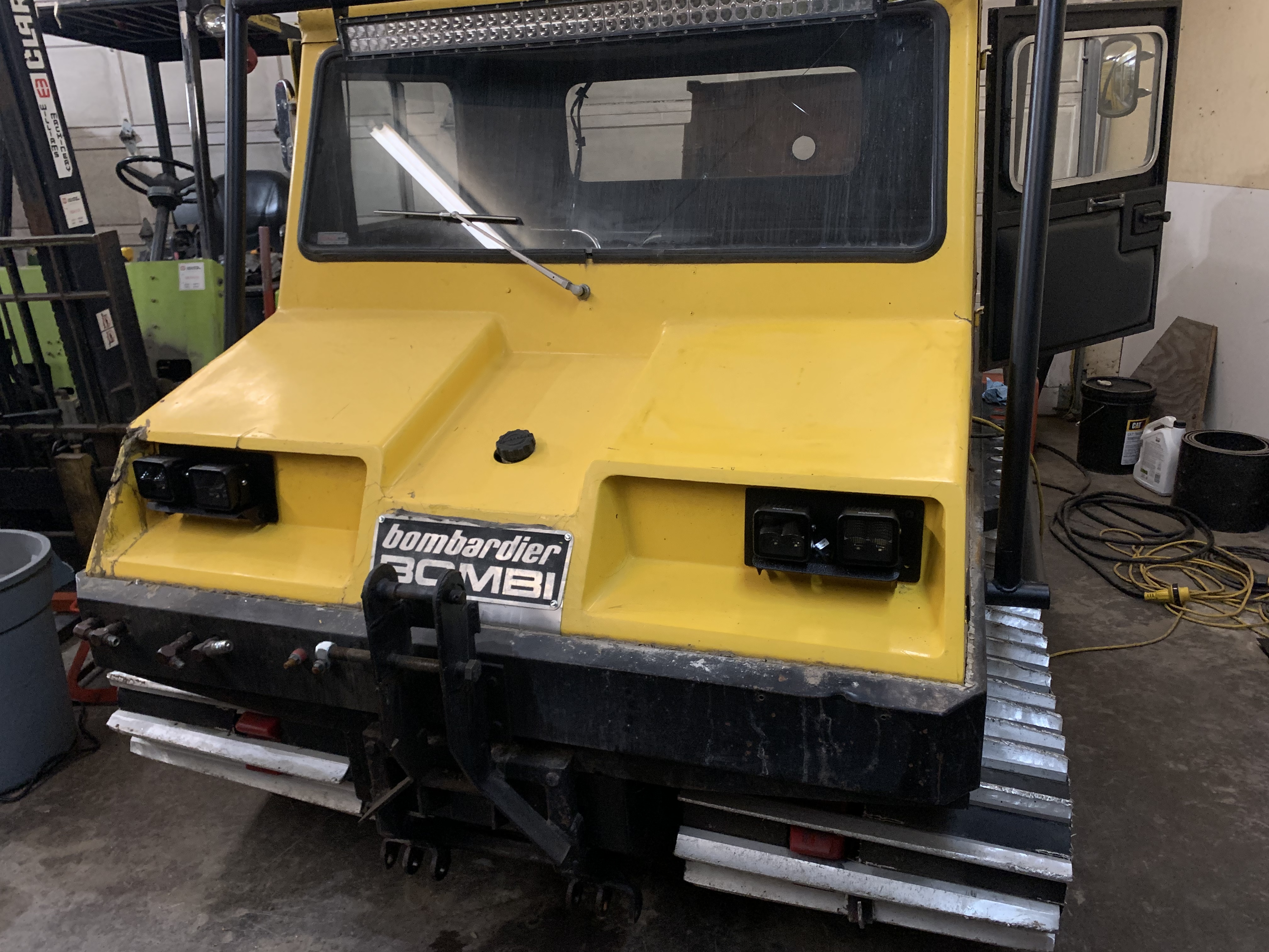

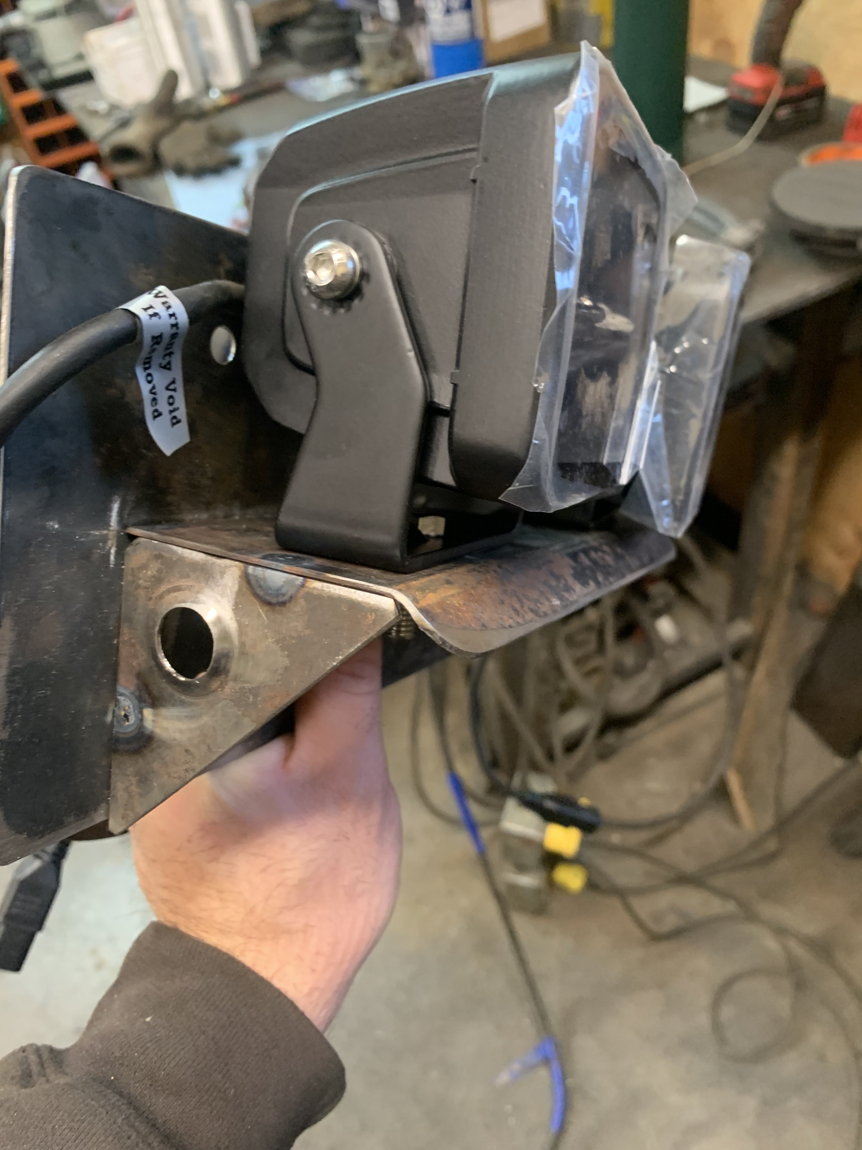

Waiting for some fueling parts I moved onto the lights. I wasn’t sure of what to do but knew I didn’t want to run the factory lighting. They didn’t work and didn’t want to put time into making them work last year as I just ran with the light bar. A sale came up on some led pod lights and picked them up. Floods and spots.
Removed the factory lights and started on the mounts for the pods

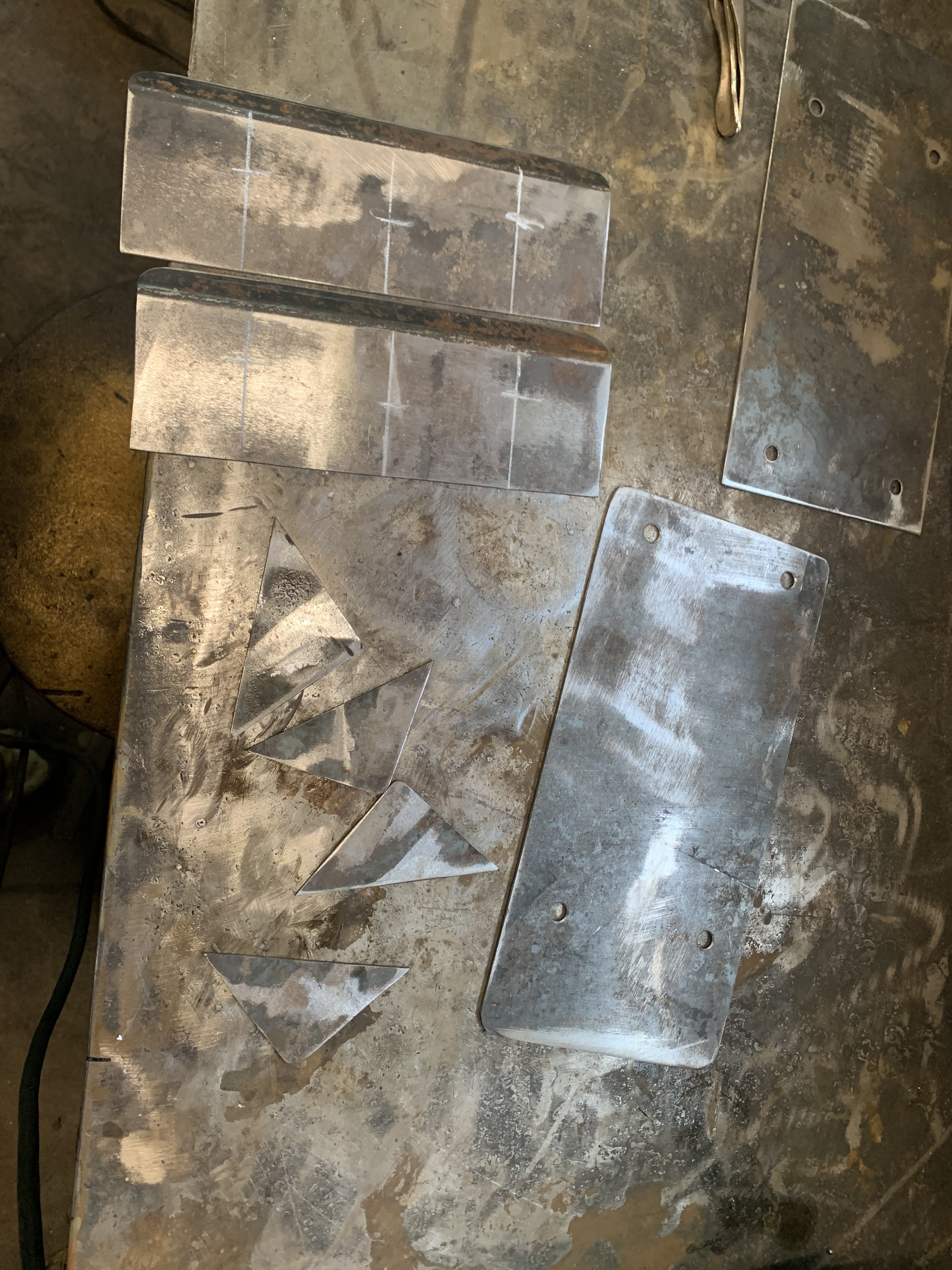

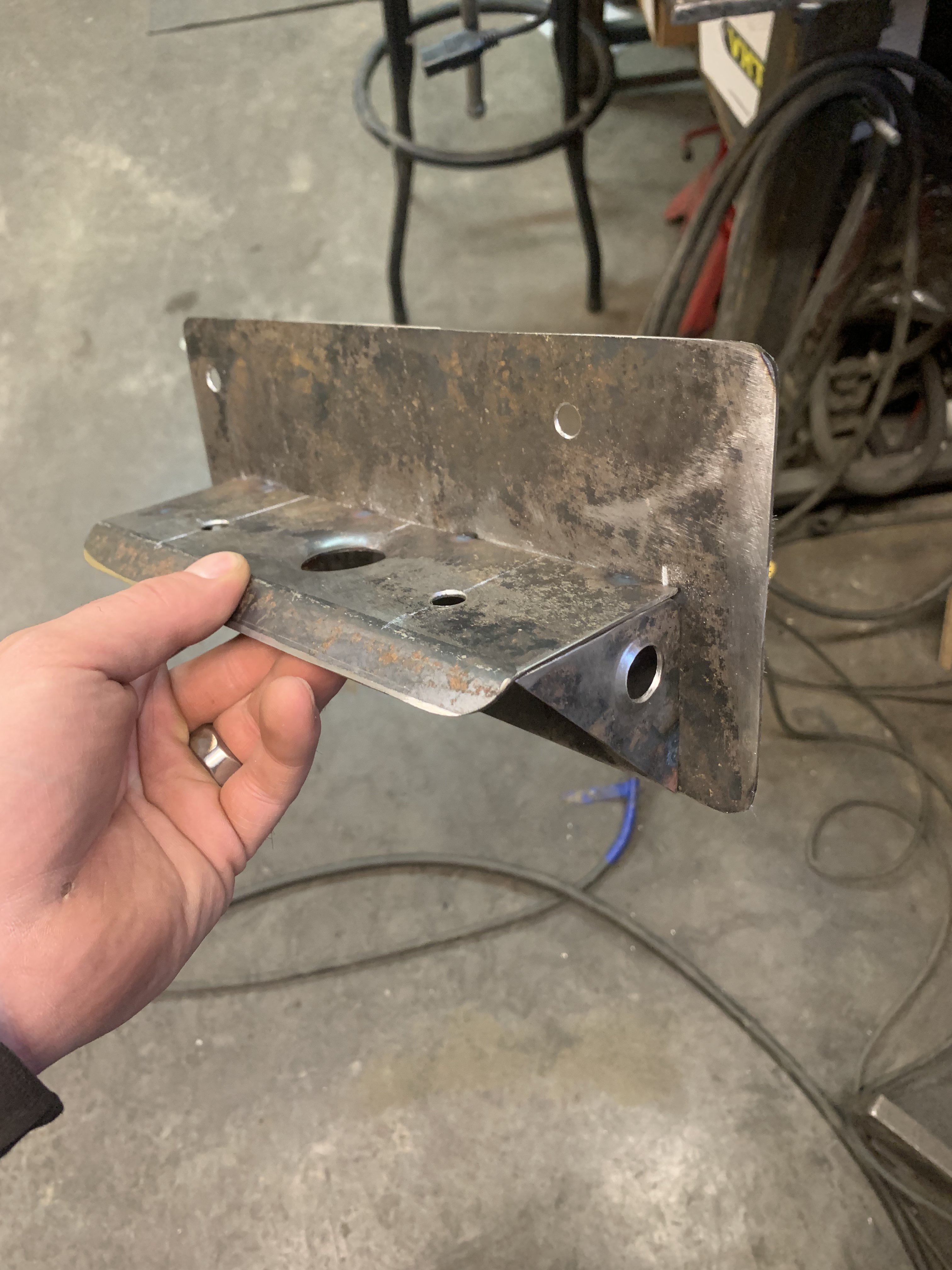

drilled some holes and hacked something together
Got the mounts welded up and splashed with some spray on bedliner. I had to move the mount lower down on the plate to clear the headlight pocket. Also the flood pods have taller mounts than the spot pods. It annoyed me but at least the same left to right. Also notched the bottom of the mounting plate to pass the wires through.
