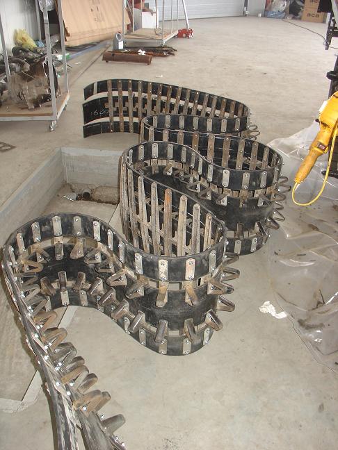

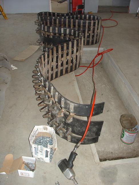

Jim VT Hey
I will try to tell you the image of the state adout the trucks.
The metall cleats are in very dood condition, just rusty from inactivity, have not worked, and i think that need no form of intervantion. ( I could do them - galvanized, but because i am hurry to walk in the snow .....i hope to understand)
The rubber belts, are new as the nuts and the bolts.
What i kept it from the old track, among with the metall cleats, are the segments allouminioum, on which the screws are held, and of course the guides.
In the left track i had no problem, just at the beginning i started working with Key EU prlug No 13 and had troubles unscrewing. The screws are not forced to rotate and making use cutter ahd this delay enough.
In the process i discovered that the screws were in inches 1/2 and bought new tools for the impact wrenches.
We are currently working on the right side, and the olny problem is that.
Some of the guides are missing (3-4).
At the same pace i will continue,in the right side, BUT CAN SOMEONE IN THE FORUM tell me where can i get the guides that are missing- broken.
If someone are intersting to replaced the metal cleats, any sujestions.

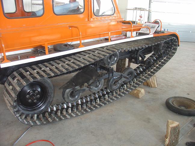

I am working in the right side of the truck.
The left is ok
Gradually the progress of the work is satisfactory and hopefully on Monday I have finished the belt tension.

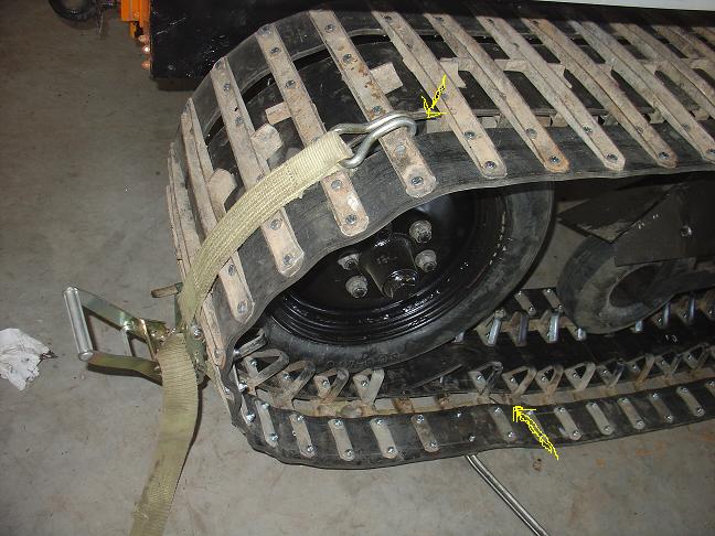

we are ready for the tension.
The weather has improved it - 10 c :w00t2:.
The problem is that the track was very hard from the cold, and it is difficult to stretch- tension it.
It is different if the temperature is not appropriate
I hope to finish soon. The weather is appropriate because it preserves the snow in good condition.

In the forums I have attended the efforts stretch of track with the help of appropriate tools (track jack ) and successful attempts with homemade tool (track jack ).
I wanted to build a homemade tool, and ι bought all the metal parts.
I was ready to connect them to use in the tension.
Eventually I decided to use something different.

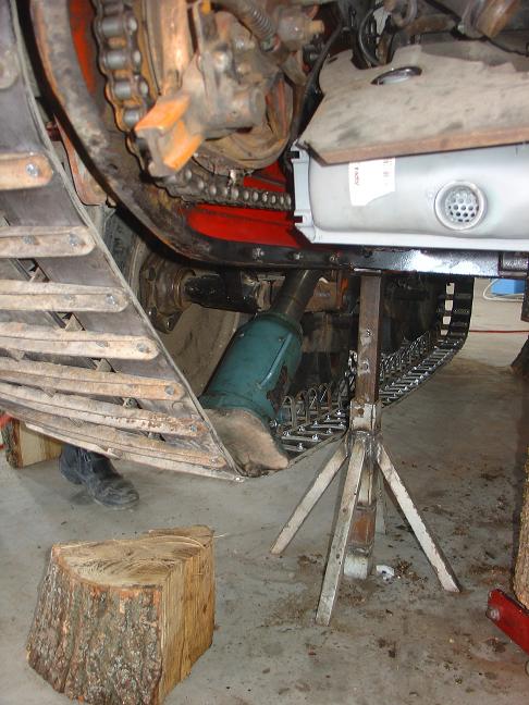

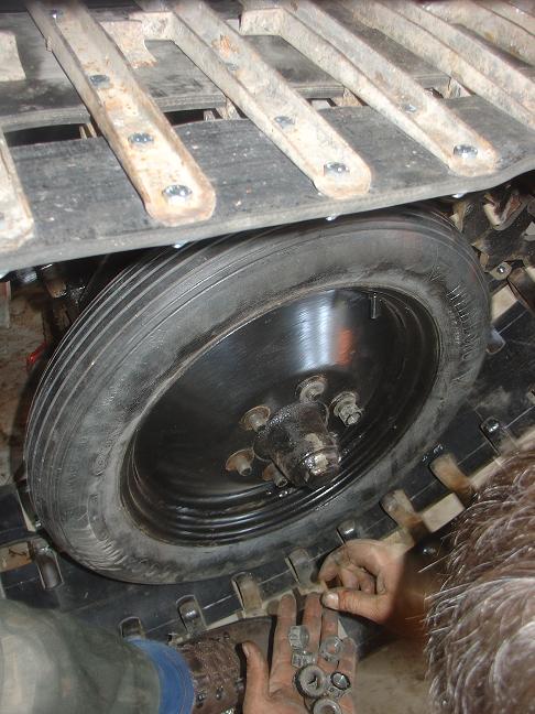

The straps with metal hooks, which we use in trucks or platforms for holding loads. The mechanism is simple, by moving the lever tightens the straps and move items of the track.
In our case, each track is positioned left and right straps, and pulled up to come to the two straight edges.
For the best stretch, followed this tactic - approach.
α) We left the ST4 up on blocks - jacks and moved the track by
hand onto the guides.
b) We removed the front wheel to be no resistance and within
minutes the screws join two edges.
Then once insure the two compounds (6 bolts - screws) to track and making sure that everything is OK,
c) place the front wheel in place. To do this we placed a jack on the
inside of the box and pushed the track down.
Pressing the foot on the outer side of the track in two minutes the wheel was placed in position.
In the same way and was left track.
It is a little different way but was unsuccessful. Each method has drawbacks and advantages.
In this case allows us to move it freely and tracks and tighten same loose screws better.
I hope I gave some new ideas on how we tension the track.

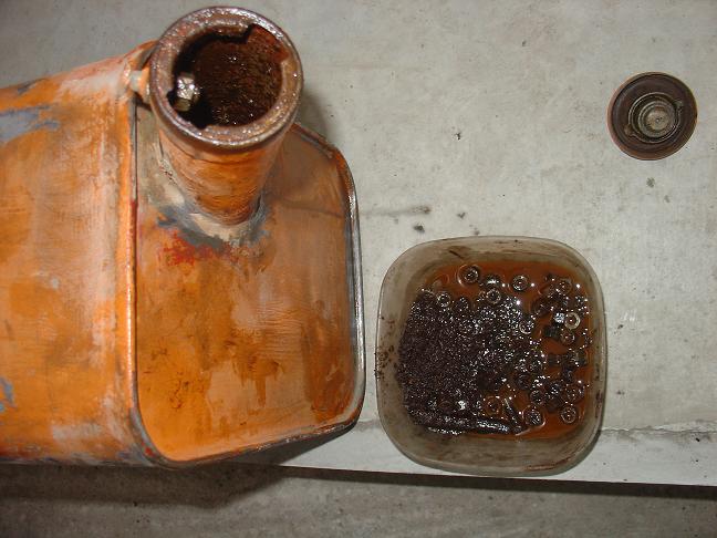

The next step is to repair the tank. Outside it has superficial rust, but the problems are inside.
Apparently because of many months of downtime substitutes gasoline have created a black layer. So water vapor in sidewalls. (Rust- dirty)
I started by placing a chain and bolts left over from the tracks, oil and shake and Shake well.
I think the tank takes much work, but I intend to replace the float and parts supply of gasoline along the way.

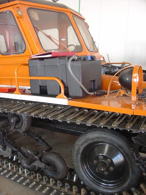

Temporarily put an outboard fuel tank to 30 liters of approximately 6.6 gallons in the front near the engine.
believe in this way that I will have time
a) and the ST4 can move without problems with dirty Tank
b) I will have time to repair the original tank.
I've also ordered a spare container with 30 liters of spatiality other - 6.6
JimVT tell me your opinion.
How long and how far away I can cover with these quantities of 13 gallons of fuel

My last trip I climbed a 6 to 8% grade with 12" fresh snow for 12 miles. Down hill on the way back and my 5 US gallon boat tank had 1/2 inch remaining. My GPS said 27miles total. I have a strong 40hp with a larger carb. Two people and not much gear but two batteries and tools.
I was told those tanks are troublesome .Some times on a hill it will not pull any gas.

The stock snow trac tank is what I am told as being troublesome. It May be just when they are old ...They did used them untill the production stopped. The plastic boat tanks work good . I use a 5gal and a small 2.5 gallon boat thank tied on the rear for a reserve. It isn't connected.You can see it on the last picture.
I usually get 6 to 9 mpg . It depends on if I am just out playing or traveling.
I have seen two tanks one on each side but I don't think the extra fuel line hose would make much differnce if you wanted on the left. Lyndon always unplugged his after running because it syfened down and flooded the engine. I never have had that problem. He said with this setup if you pump gives up it will still run without the pump.
Be sure to open the tank vent.
with the boat tank you have more storage in the rear. I ues a 5 gallon but lyndon like larger sizes and has gone up to 20gallons .

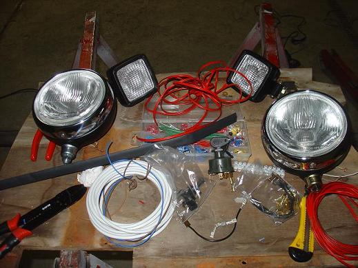

I also have ordered the running lights, and two great headlights on the front, and two small in case of reverse.
Ι will replace three switches with new one, i will put a new battery and i change cables, fuses, bulbs with problem.

I placed the tank (40 litres - 9 gallons) on the left side, and I connected the fuel supply line to fuel pump.
Along with the electric technician began to connect the cables for the new headlights and replacements to the old switches and fuses etc.
I hope the problems of connecting cables may not be large. We use the designs with colored wires and try to find an edge.
Subsequent reports, questions and queries you have to do with wiring problems ok.

After some hours checking out the electronic circuit, we changed the damaged cables, bulbs, and fuses.
The first impression is that no serious damage to the electronic facility (rust - wire cutting), and the stream from the new battery normally carried in the circuits - instruments. :smile:
Of course where you need replacement equipment (switches, cables, fuses) will put new materials, to support both headlights front and two behind the door.
What will be difficult is that we do not know yet, in what condition is the wiper mechanism - Motor Bosch 12v.
Τhe heating of the F4 function normally, but I wiil remove it. I have some ideas but at this stage would not dare to implement them. Maybe this summer I will have more time.
