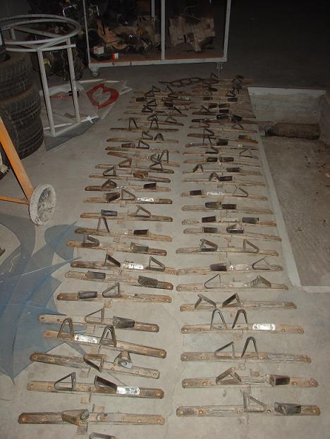

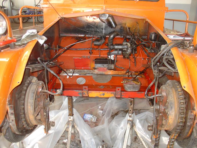

As i am in process to belting the tracs in the next days pics 132 & 133.
I need your opinions.

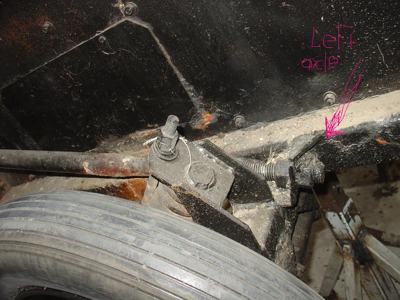

Can someone tell me, about the level that takes the axle sprocket, in the process when you have to start tension the Belts.
I have a dissagreement with my friend, and i need your opinion and some pics if it is posible
In my ST4 there are different levels in the right - left axle Sprockets.pics 44 1 & 44

Does anyone Knew HOW Dangerous ( Fuel - tank, etc ), or not, is to Worm the cabin with this German gadget.
Any suggestion, how to worm the place, example with some other extra electric machine.
The two indents from the VW is still working, but i m thinking smthing more clean, about the hot air, probably with the smells-faints of the exhaust pipes in front the machine
if your j box heaters are working right a fuel burning heater is un necessary irun mine in a t-shirt at -20 f
It would be nice if you stop and shut down the engine. That is the only time I wuold want one. But from what I have read, those gasoline heaters were more trouble than they were worth in terms of safety as well as reliabilty. There was a pic of an ST with an LP heater with a fan set in the rear corner of the cab. The LP bottle was out side on the racks.. Just need to cut a hole in the floor and put in a hinged door. A second battery for the heater and you could ice fish, from the cab....After you back over your hole.:brows:
Regards, Kirk

I am not a Junky in Restoration, but i had to change the wooden floor, and refresh the color from the rust in the chassis.
RED color or smthing else, Red color or Black,

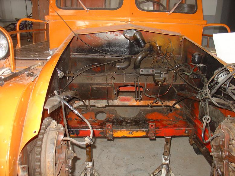

The floor under, rust, dirt, dust - faded paint on the chassis.(before- after).
And the front engine frame. (before -after with the foam Shock-deadening material - deadening composite sheet consisting of two sheets of polyethylene foam with the aluminum sheet)

JimVT Is the original V belt but in some parts, the inserts are in bud contition, so i had to replace the belt with the new one (Good Year).
i like the sound proofing you did don't forget under the hood as a large amount of noise escaping from under the hood wil be transmitted through the glass in the wind shield i had a hard time swalling it till i sound proofed the hood under my cummins powered pickup
Hey dds thanks for your, very interesting informations.
:clap:I appreciate your opinion, and always the opinion of others has gravity, and is reckoned when needed to solve a problem.
The large amount of noise escaping from under the hood through the glass is a problem.:unsure:
Whats your opinion about the insulation - deadening polyethylene foam for the cover the engine bonnet.
Does anyone has posted the cover of the engine bonnet with polyethylene deadening foam. Are there any photos.

in my experiance the best soundproofing will have led in it this gives you a weight pennalty so the next best thing would have to be some kind of acustic foam i have some stuff i can't seem to get any glue to stick to i want to use on my interior it has seemed to work good on my dodge ctd its about 1 inch thick so it sounds like what you have should work fine for what you are doing

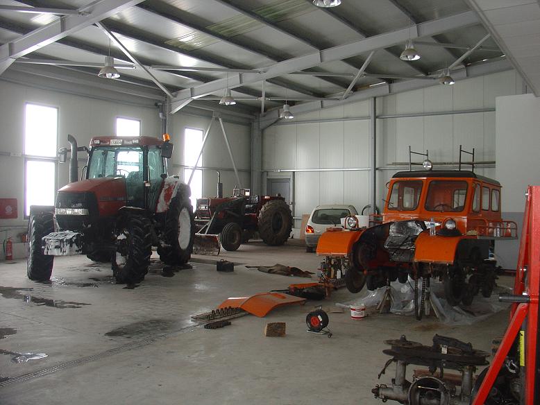

Τhe progress of the work is steady, working out in the engine, and when the work permit repairs and maintains the interior of the cabin. The black color chassis is mixed with primer paint for rust protection.
The black metal parts side of Cabin think to cover it with wood to prevent transfer the cold inside.
I want to improve the internal heat, because the metal surface of the cabinet should emit very cold masses and affect the overall temperature inside the cabin.One reason I do not enter the maintenance process in red cab is that, i am thinking to solve the problem of cooling and insulating the inside.
just finished work on the floor the next day, (the association of seating, tank, handbrake lever, and the coating of plastic floor coated, cables for lights) will begin to work through the cabin roof and side items.

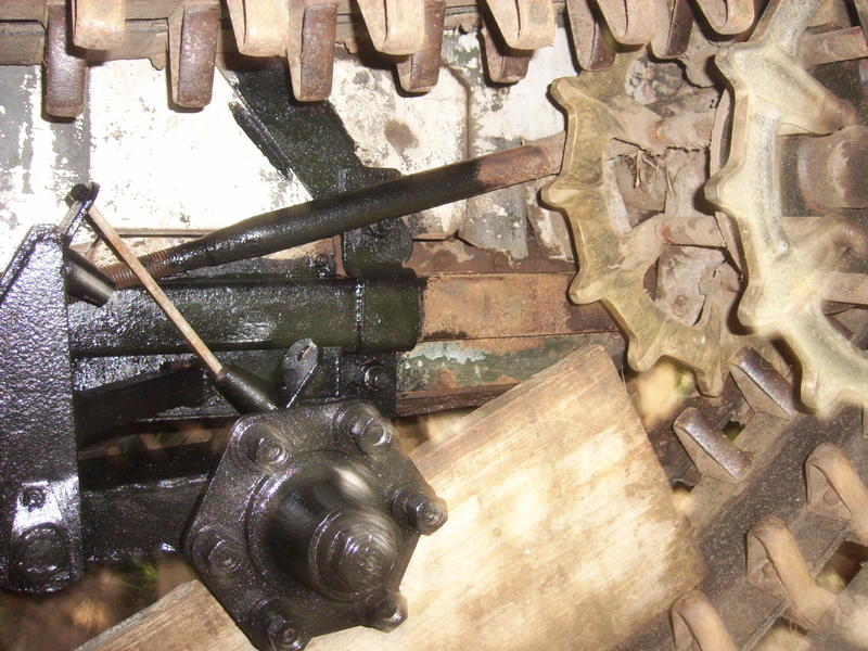

start walking
The marathon has just started - screwing
