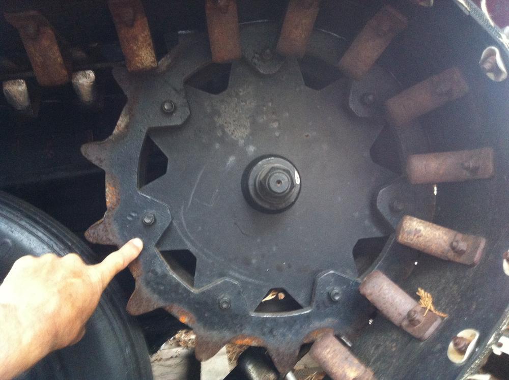

This is what I have. It's some kind of aftermarket version that is just steel and too hard. I have disk brakes and a big wheel in the front but this is a two band machine.
