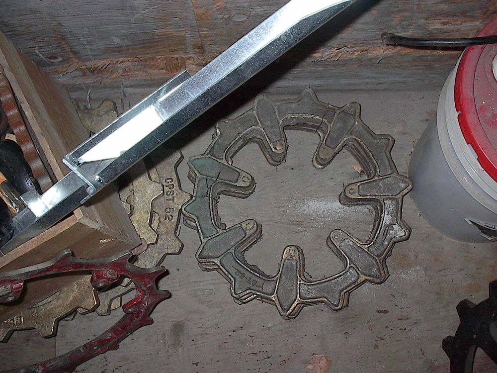

I have both two and three band to compare to. These are the thicker ones.
Alright my ignorance and inexperience is going to come shining through....
in post 43 Jims sprockets look to be wide or chamfered where they meet the rubber drum.
Kevins CPST52 sprockets look flat as compared to the red one standing there.
I assume the little knobs are for alignment.
the three band sprockets look to be quite flat as well.
