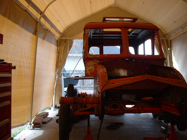

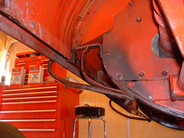

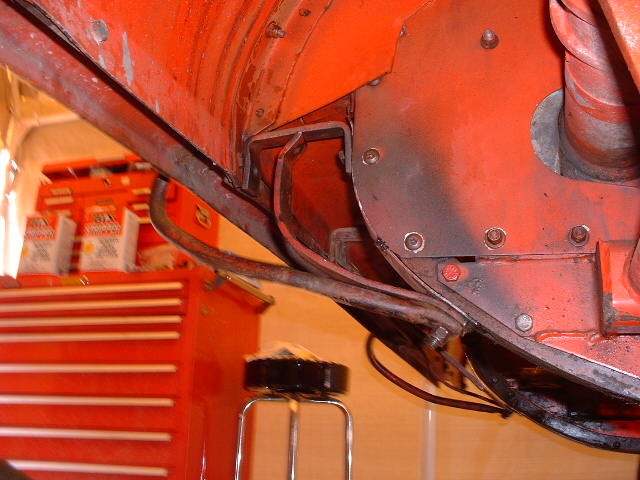

Thanks WEATHERBY! Today I removed the front bumper. What a pain in the ass that was! Had to get out the brand new Fathers day present (Dremel) and go to town on two stripped and rusted solid bolts. The Dremel made quick work of them. Then I removed the front fenders and supports. Then it was onto the emergency brake cables and handle. Had to get the old Dremel out once again to cut both ends off a cotter pin. Everything is of course tagged, bagged and boxed away. The bumper is in my truck to take to my metal fab guy. They used 1/8" steel when they should have used 3/16" or 1/4". The weak spots I have seen on every single Snow Trac / Master is where the supports bolt up to the bumper. The holes weaken the bumper and the constant up and down motion of snowcatting along with the weight of the fenders and any gear eventually bend the bumpers. NOT on my new one. I Will of course beef it up plus do a little bit diffrent design since I will now have a radiator to think of. Extra airflow!

These pictures will help me when I go back and reinstall everything. The last picture above is the emegency brake assembly. That cotter pin you can just see the spread pin is the one I had to dremel. Little bastard!

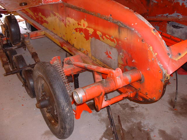

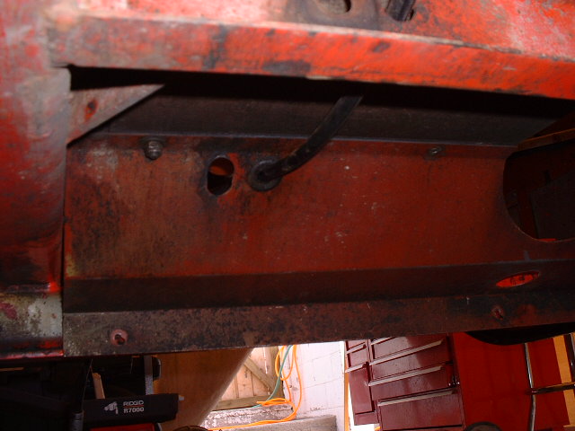

Removed the panels today and the door skin. Took them to my local fab shop. Took the bumper too but they cant bend the thickness I want. Need to go to a bigger City for that I guess. When I get those back I will install them and remove a couple more and have them done. The upper and lower cab are loosey goosy with out the supports in. Time to clean shop. Be back later.
