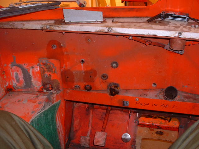

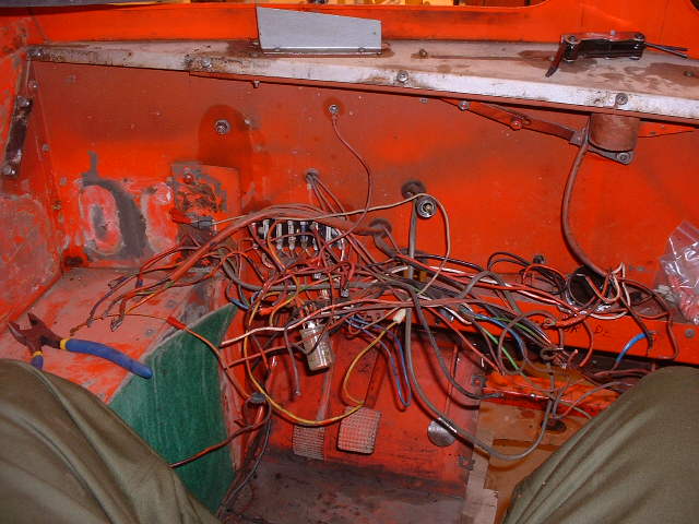

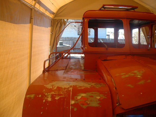

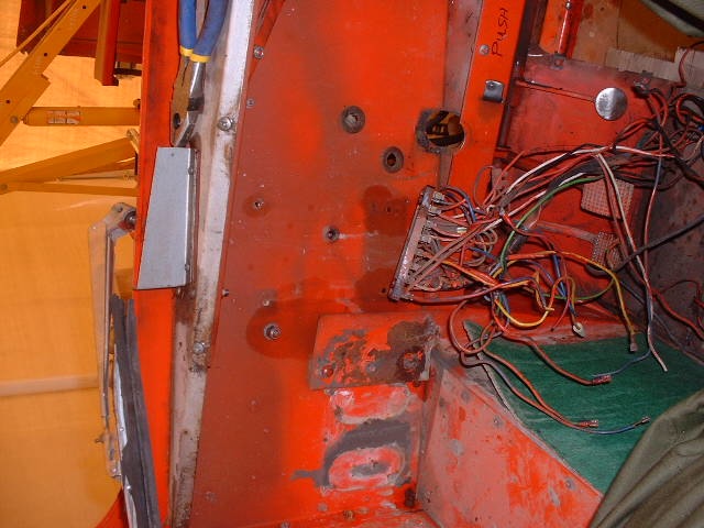

WIRE HARNESS REMOVAL
Today I decided to take on the old wire harness my goal was to completely remove it and all my gauges. Here are the pictures.
1. I KINDA CHEATED HERE I HAD ALREADY REMOVED THE DASH BUT PUT IT BACK ON LESS A COUPLE A GAUGES TO GET THE PICTURE. I USED KROIL PENETRATING OIL TO GET THE SCREWS LOOSE. (HELPFUL HINT #1 USE KROIL)
2. WHAT A RATS NEST! THIS THING HAD MORE SPLICES THAN I COULD COUNT!
3. PRETTY SMALL FUSE BLOCK. THE NEW ONE WILL HAVE AT LEAST 25 FUSES.
4. SMALL FUSE BLOCK.

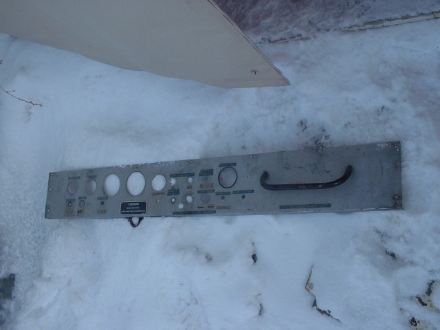

5. WIRE HARNESS REMOVED.
6. DASH COMPLETELY REMOVED. ALL GAUGES REMOVED.
7. KROIL

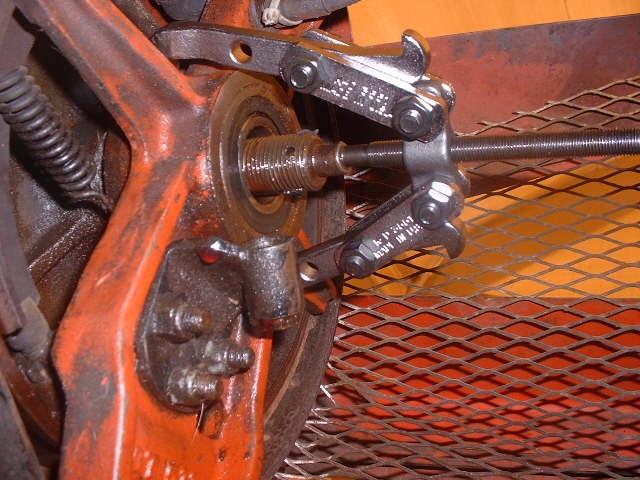

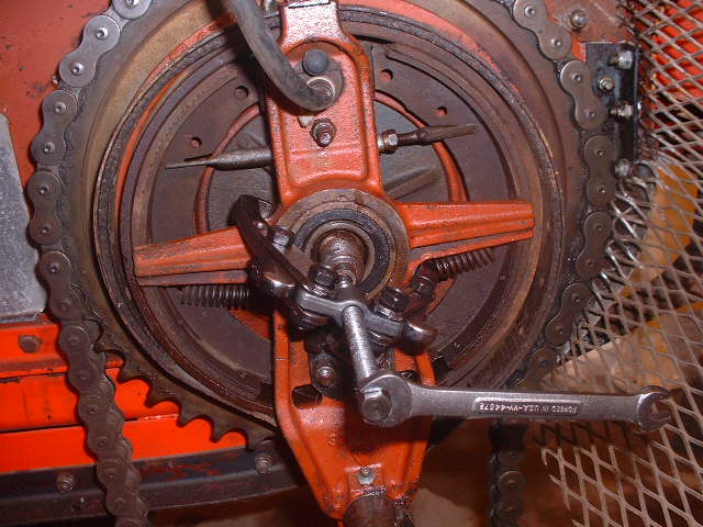

Ok. Finally after a long a bit of hard work I decided to go buy a small gear puller so I could get my drivers side brake assembly off. The gear puller I bought was really to small. The arms needed to be about 1/2" longer on each side. BUT I was able to grab one arm behind the brake assembly and the other on the web. I have soaked the axle shaft for a few days in Kroil hoping to just pull it off like I did the other side. No go. So I bought the small gear puller, attached it and took out the slack. I turned the wrench 1/4 turn and the whole assembly slide right off! So now its off and everything is getting cleaned tagged and boxed. Here are some pictures.
Picture of the small gear puller I used. Cost me $14.39 and even though it was to small I was still able to grab one of the webs. I was not going to put alot of force on it. In fact I was going to just tighten it up about a 1/2 turn and then let it sit overnight. Came loose in 1/4 turn .

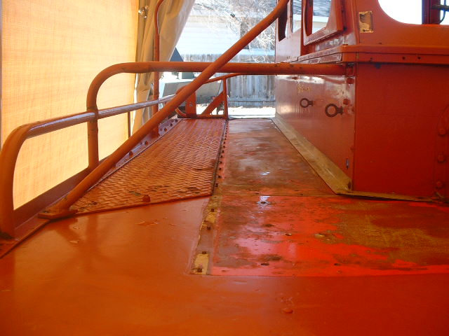

Today I went out and removed the deck Extensions someone had added on. They used 1/8" steel deck diamond plate for the extensions and welded part of that to the rear angle iron piece coming out of the rear cab area. They also riveted the botom to the edge of the aluminum deck (original piece). After all was said and done they were a pian in the arse to remove. I havent a way to weigh them but suspect they are close to 100 lbs each. That decking is way to heavy. I spent the rest of the time designing and measuring out my new decks I will build plus the rear fender I will be putting on. Here are some pictures.
