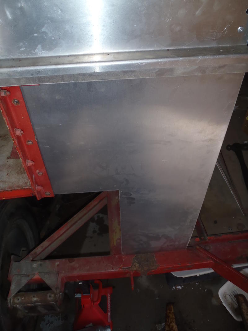

Today I test fitted some rear cab panels I had made about 3 years ago before I started my then new job. 3 years later Im ready to restart the rebuild. The panels fit pretty good but one needs. a little trimming. I will take pics tomorrow. Work keeps me away most of the year.
And Rum Keeps me dizzy the rest of the year !!!!!:yum:
I also had a new outer door skin made. This one has a window as well.
