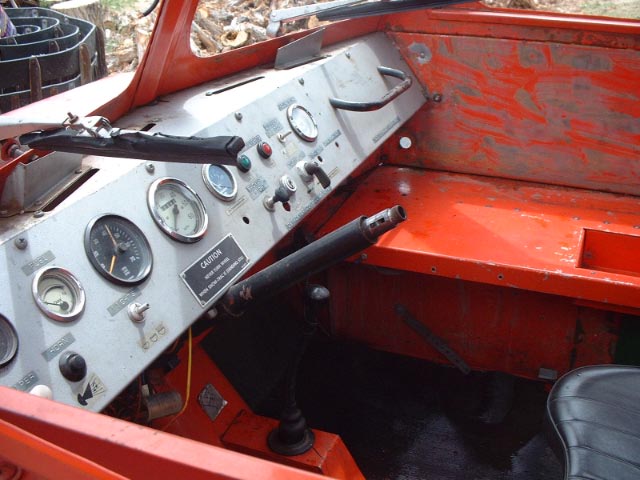

Steering column today
My goal today will be to pull the steering column as well as the dash and wire harness. My question is has anybody removed a column before? I am not sure how to do it so I just wanted some pointers. I will go through my manuals to see if there are some detailed pictures / diagrams that may give more of an insite. BUT first hand knowledge is always better.
Re: Steering column today
Once you get it unbolted from the Variator the only thing holding it in place is the 2 hole pipe clamp under the dash. You must remove the steering wheel in order to slide it out.
Thanks Lyndon. Will do. It needs to be repainted as well as the whole interior. I'm just going to paint it another color or I would just leave it in.
Heres another question. Do you know off hand what size that steering wheel nut is. If not no big deal. I just dont have anything big enough and was going to have my wife pick up a socket on her way home. Thanks.
Mike
How about some step by step photos?
:nopics:
Mike ,
You may need a "steering wheel puller" also if the wheel is swedged in place . I have one here if you do and we can pull it real quick .
Allen
I just re-fixed my digital camera. So I will be able to take pictures. I didnt do anything today since I dont have the proper size socket yet. I Also have to build a fence Saturday so Sunday should see me doing quite a bit on the snow cat. I will post photos of all work. Also my kids wanted to play today at the park. So most of my day was there.
I don't know what size it is but I know that it's metric. Put a puller on it and tap the center bolt of the puller and it will pop right off. It's tapered with a woodruf key. Somewhere around 26mm.
The nut holding on the steering wheel is 27MM. I had pre soaked mine for a few days. Going out once or twice a day to re spray it. Held the steering wheel Loosened the nut wiggled the steering wheel straight back and off no problems.
