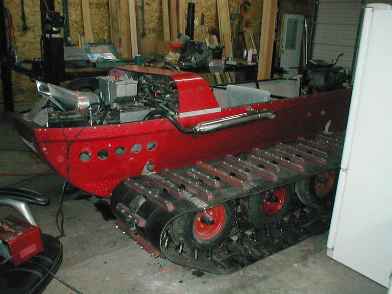

Ok .... I am back in the shop . Track lacing is installed and I am now working on petty things on the motor .
Maybe .....just maybe :unsure:it may be ready to test tomorrow
well , the new ignition is installed . Along with the new throttle linkage and the rear brackets that hold the mufflers in place . All that is left is to install the new tracks and top off the hydraulic oil .
maybe it will be test run tomorrow if it does not snow too much tonight :smile:

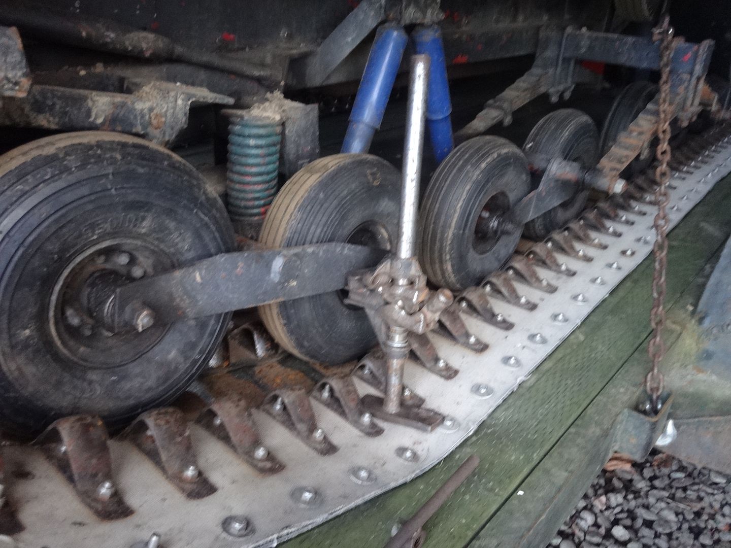

One track is now installed . Its been slow going and I still hate track rebuilding with a passion . The other one may get installed today . When that is done the KT3 will be movable under its own power for the first time in many,many years .
You will find a "2 ton come a long" and some chain , as great help in getting the track in place to reattached the lacing ( Flexco Fastners) .
Many folks use a Track Jack and they are wonderful if you have one . Mine that came with my KT3 seems to be lost in the shop somewhere :unsure:. Don't forget to check tire pressure on the Boggie wheels before you tighten the new track . Also you will want to recheck the tightness of the track after a few test runs , because of stretching and break in wear .
Pictures soon .

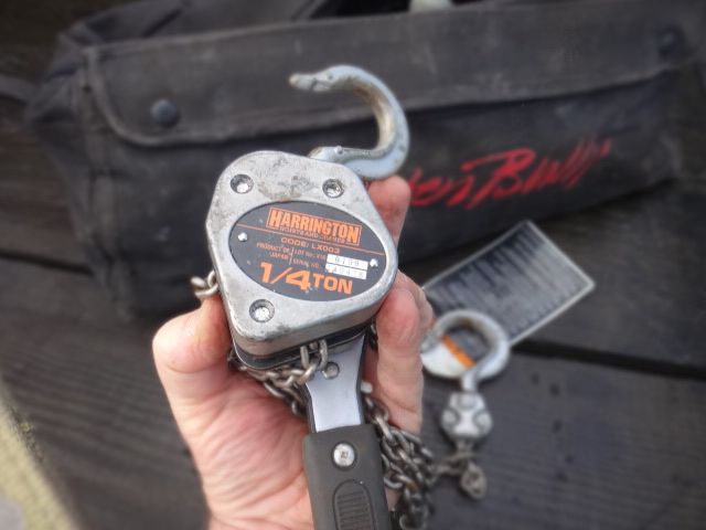

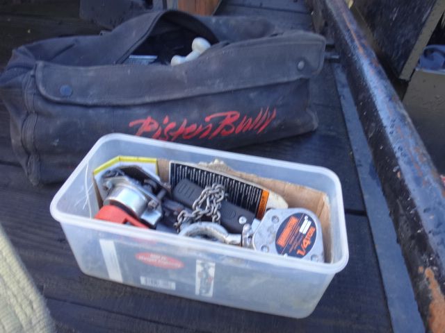

this is what I like. small and two of them fit in a shoebox size waterproof container. they are always in my snow trac. harbor freight $40
This is my handy jack a vw bug jack . we don't have lots of room in the snow trac large tools. I am missing the handle .

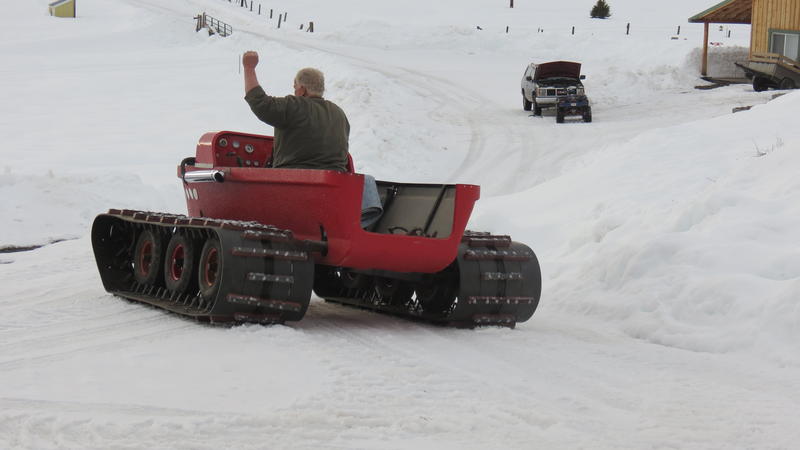

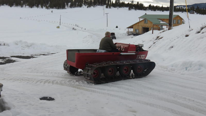

well,,,,,Its ready to take on its maiden voyage .I ran out of daylight so it will be tomorrow for the test .
Here is a few picture :

Sittin here and charging up the battery on the KT3 . Its sittin outside .
I pulled a Bob stunt . :doh:Ran it outta gas and then the battery died from lack of use . I been keeping it low on fuel as to not let the gas get too old .
Not really much to report about performace yet , other than it flat jumps when that clutch engages . Still trying to figure out this 8 speed transmission :unsure:
Pictures should get posted tonight or a video if the wife can get the video to download .
Well the damn video will not load .Its 7 1/2 minutes long
Here is my to do list after testing .
Adjust Timing
Adjust Carb
Bleed tilt system hydraulics
Remount muffler bracket I tore off .
I give it a 4.5 out of 5 stars .
The tilt system will take some getting use to
No idea what gear I was in as I misplaced the damn shift decal

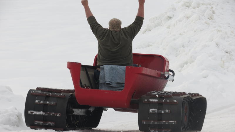

It has lots of power and climbs very well . I'll get some pictures of it tilting and the hill climb until we can fix the video problem . Damn thing is too fast for me to run long . I need more than a piece of plywood to sit on .
Here is a few shots the wife did take .
