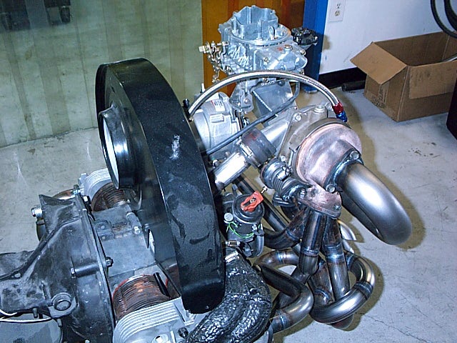

Al, if you keep adding weight to the tracks you will need one of these
I think it's 135hp:w00t2:makes a vw run 11's in a quarter mile
The original wear bars were 1 1/4"x 1/8" flat bar . So I added a little weight :whistling: BUT the lite weight plastic cleats offsets this !!!!!!
Besides, I think my twin turbo motor will more than offset the weight factor:brows: .*I think its punching just over 200HP:w00t2:..
