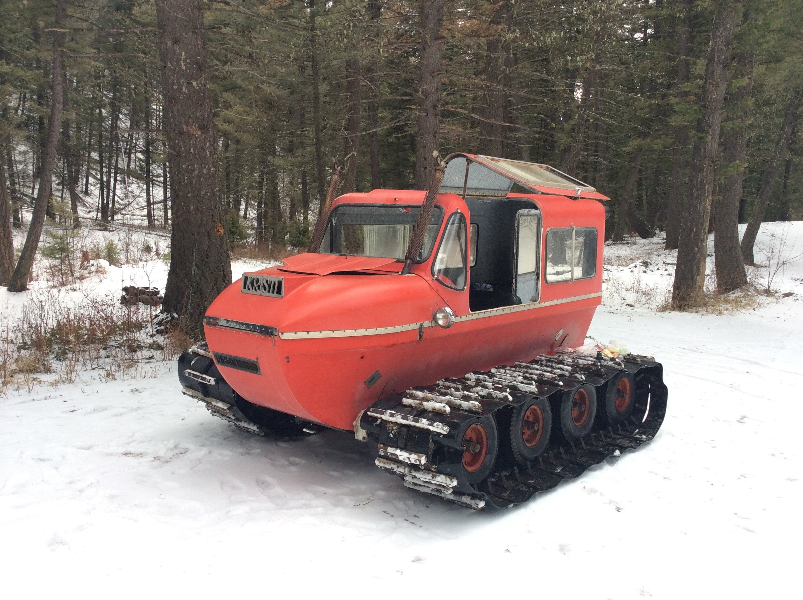

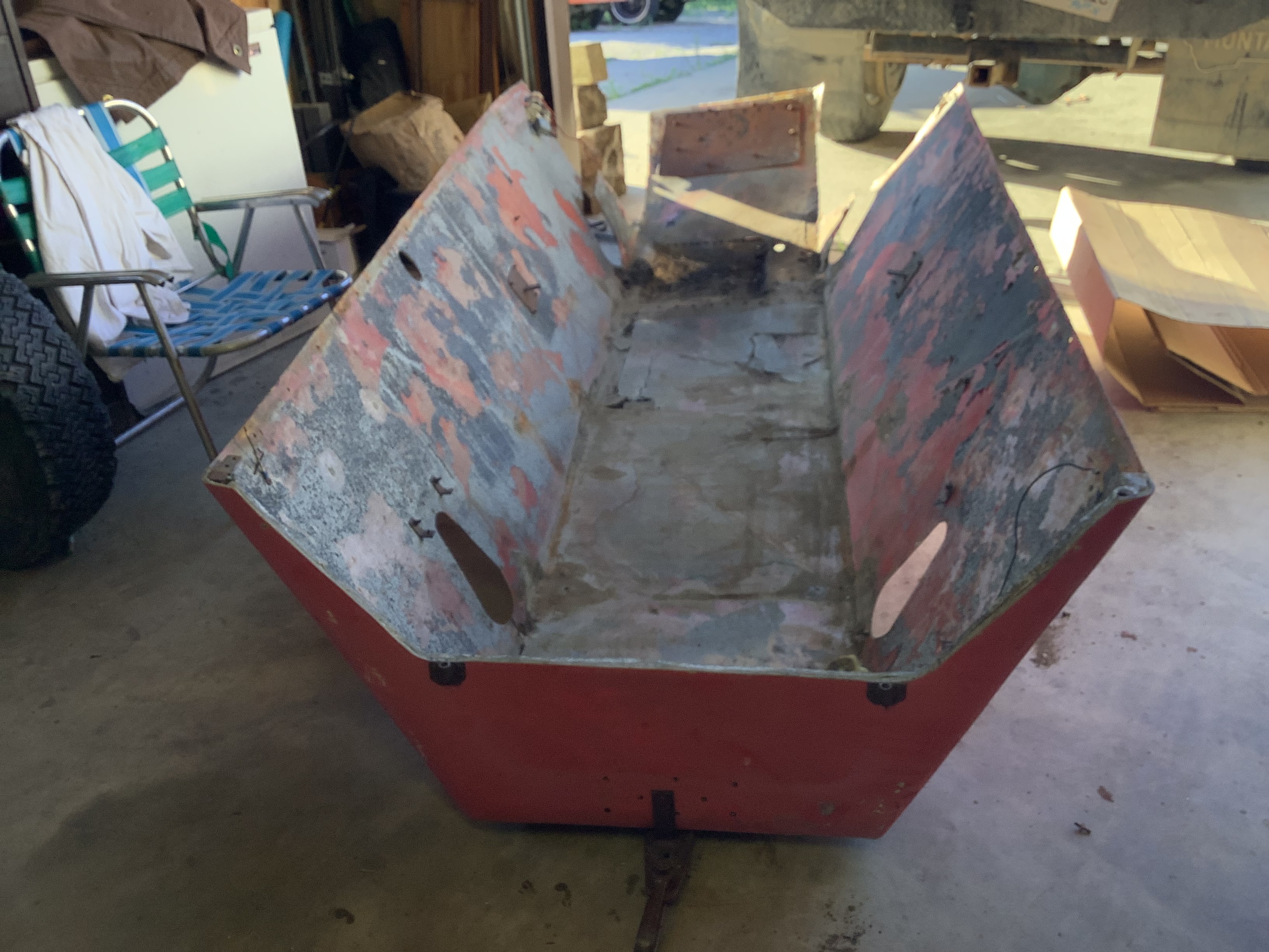

As a Kristi KT3 owner, I am always on the lookout for these little units here in Montana. Found this junked KT2A couple years ago and finally made a deal w/ the owner and retrieved it last week.
It is in very tough condition and had been out in the elements for a very long time. According to the SN, it dates to 1960. All the hydraulics had been stripped. Engine (1300 cc) is frozen. Front end had been damaged years ago and the nose repaired with a wooden laminate that clearly failed. Trans, diff, clamshells and other drive components seem good as does the cockpit frame. Tub and top marginal at best. Grousers may be recoverable from the track. Sprockets are the narrow old style.
I am very open to advice on possible avenues to proceed. Keeping my KT3 in reliable running condition is challenge enough w/o taking on a major restoration.
Thanks for any ideas or interest.

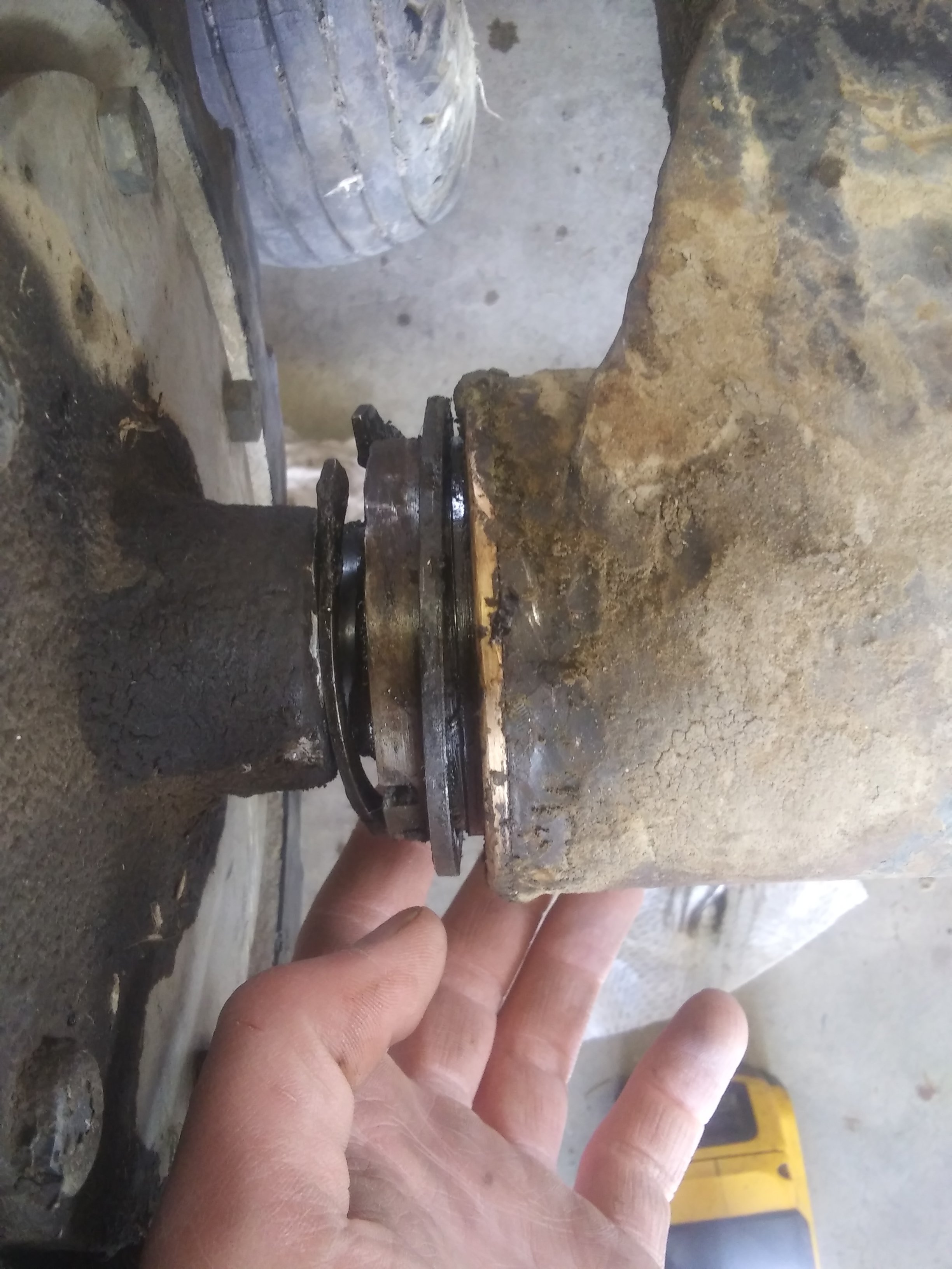

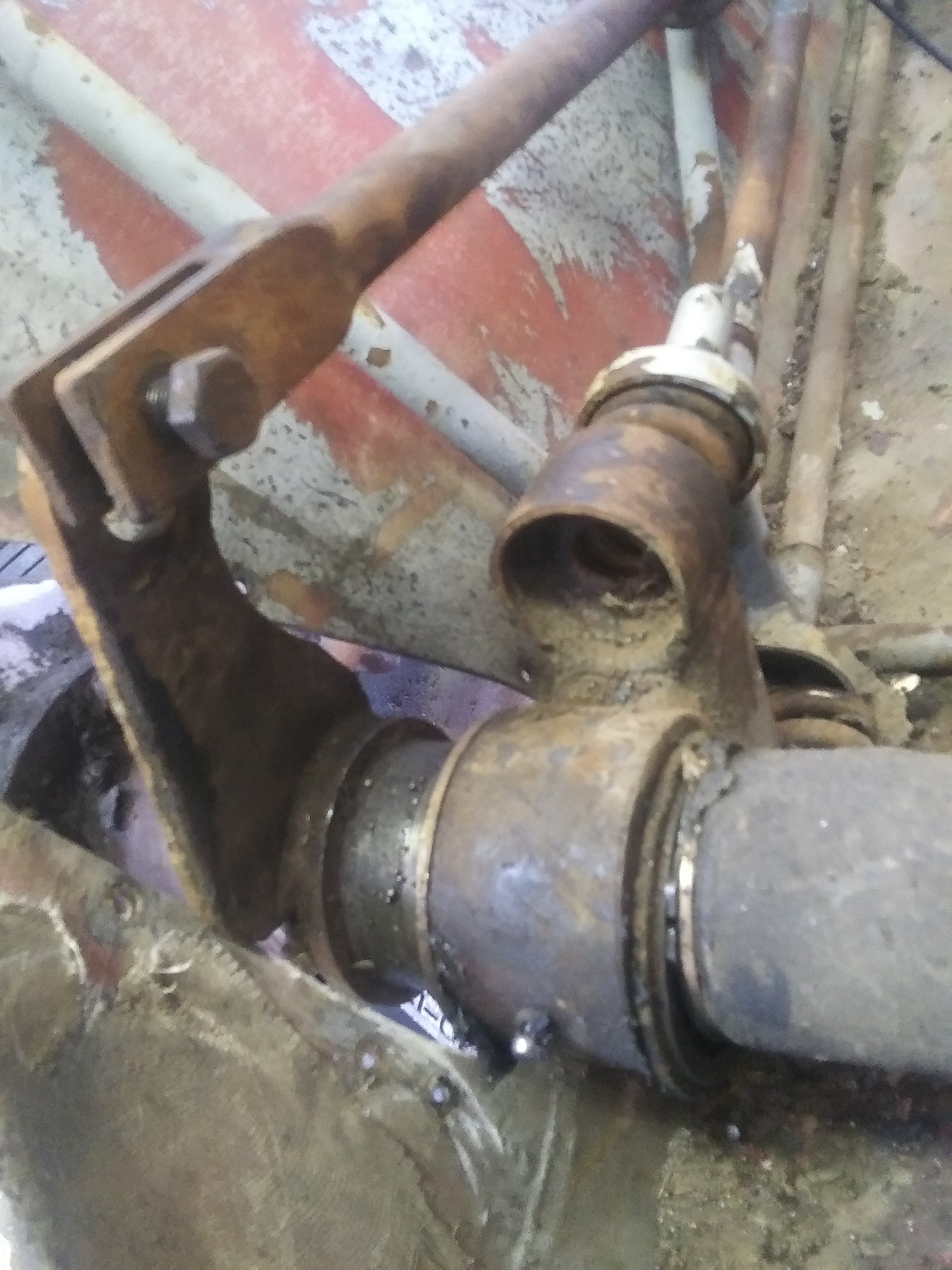

In the dismantling process. As per Big Al’s recommendation, put heat to the sprocket nut and plenty of penetrating oil. Used a conventional wheel puller. Nonetheless, one sprocket broke and the other shows a hairline crack. Both may have
Rover’n
Both may have been compromised from decades of service.
The engine is hopelessly seized and will be set aside for later disassembly and inspection.
Plan for now is to break the thing down into manageable pieces and arrange for proper storage. Temps in Helena today may hit 100 F. Perfect for snowcat projects.

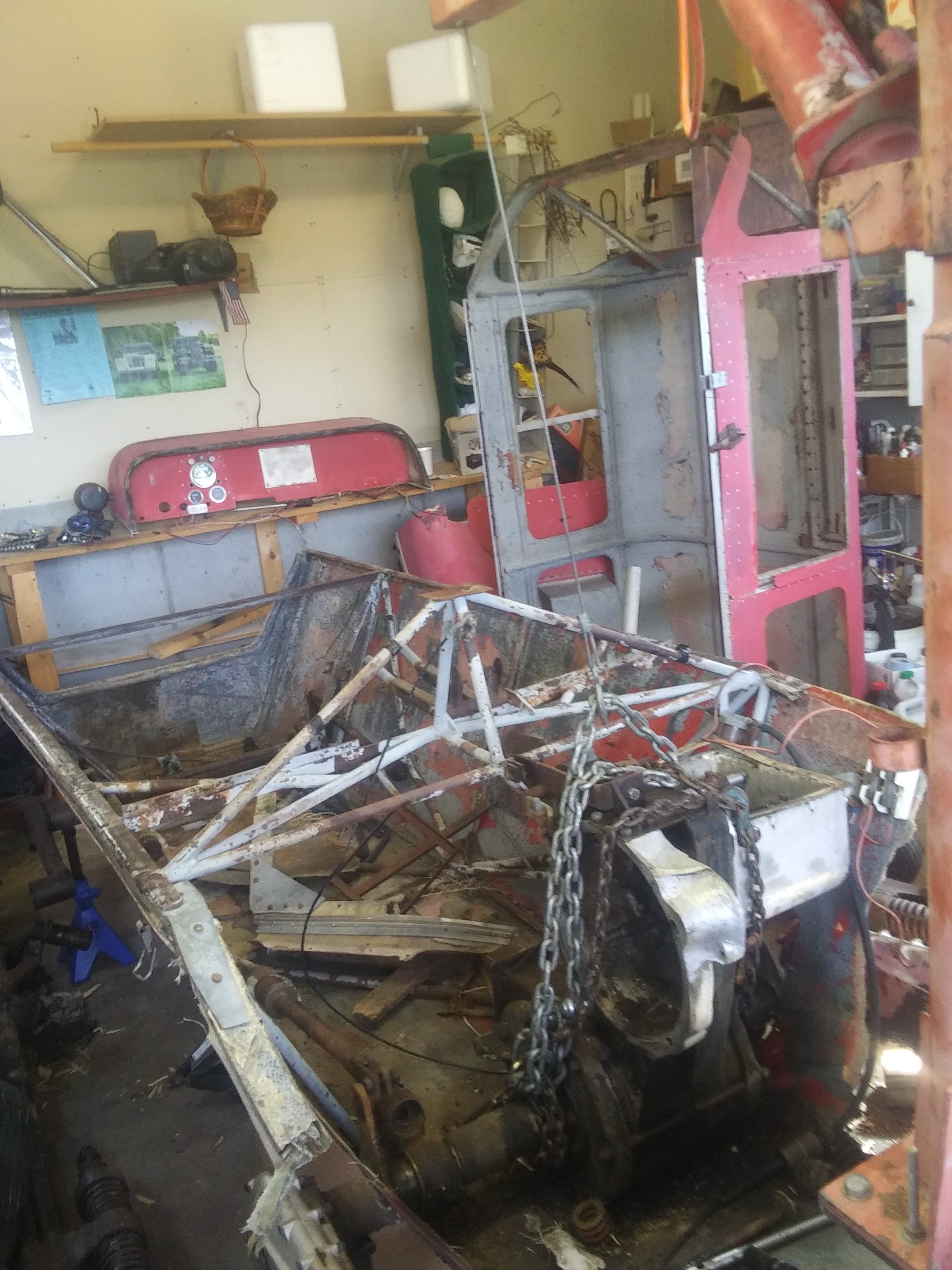

Hey there, am new to forum, but am working on the KT2A project with Rover'n. Here's some pictures of how mess up removing a cast aluminum drive pulley. Haste is waste, a rented puller didnt allow the time for proper penetration of oil. The solution in retrospect was more heat, more oil, but mostly more heat. Shouldnt even need a puller next time, just deadblow hammer or wood block and hammer. Also pictured is the partially cracked pulley. I don't think we cracked it on removal, it looked like an old crack. Will be looking into a replacement for these.

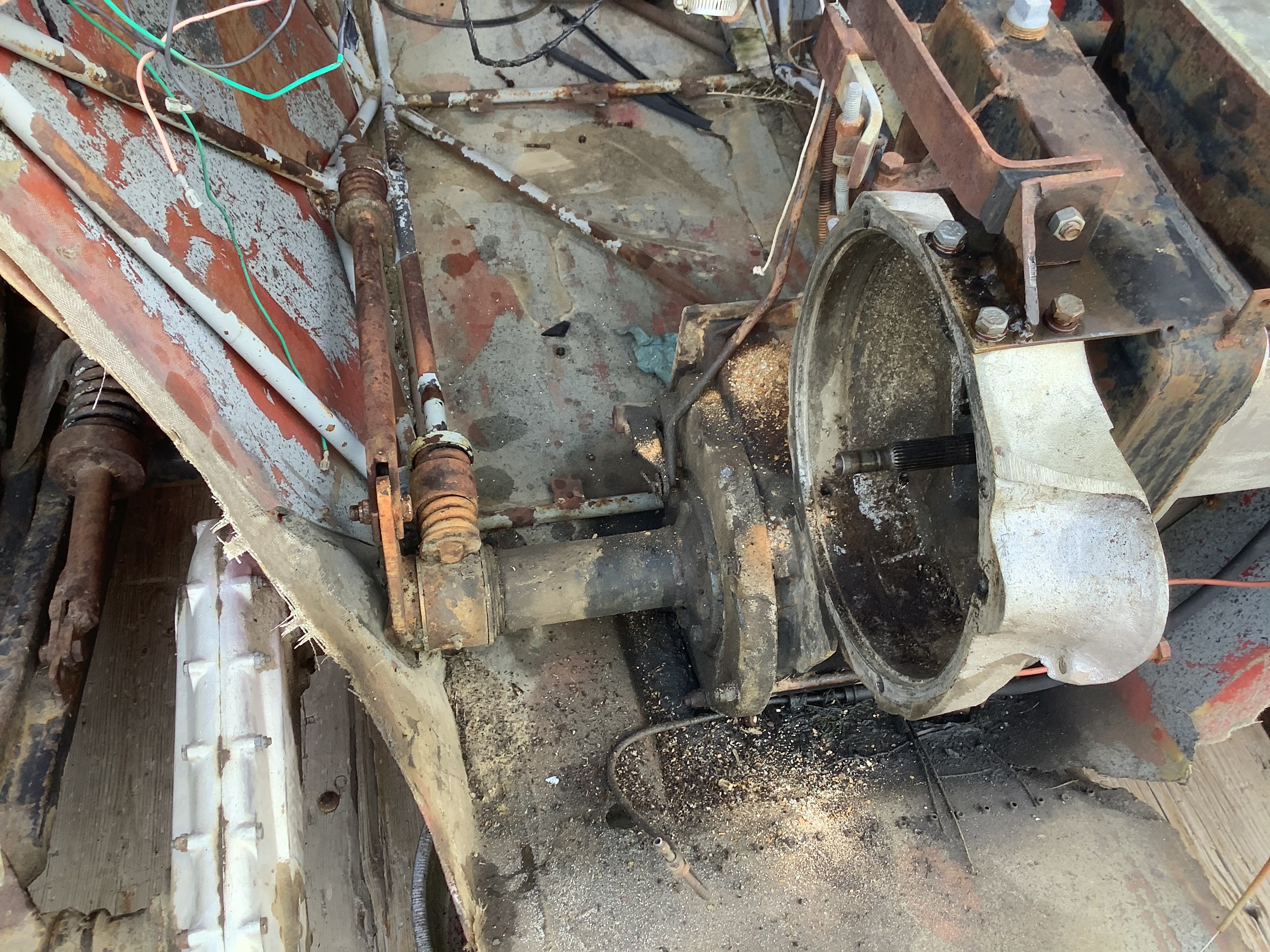

The inside of the transmission had only a touch of light rust, transfer case looked intact and full of oil, am looking to pull diff+transmission together, at the same time pulling clamshell arrangement complete with axles. I think these clamshells should also pull off with a single circlip removed on each side, near to where the hydraulic ram attaches.

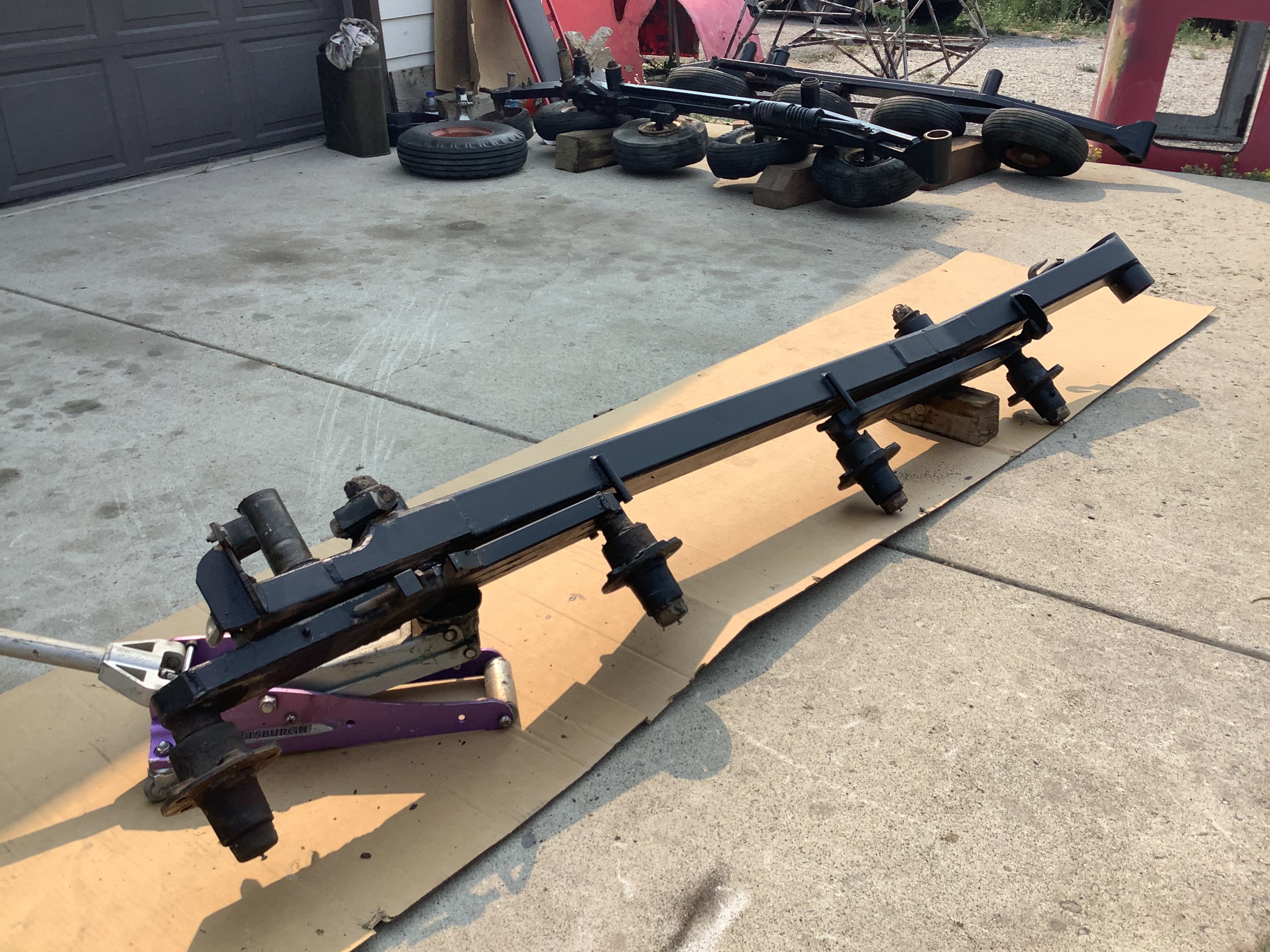

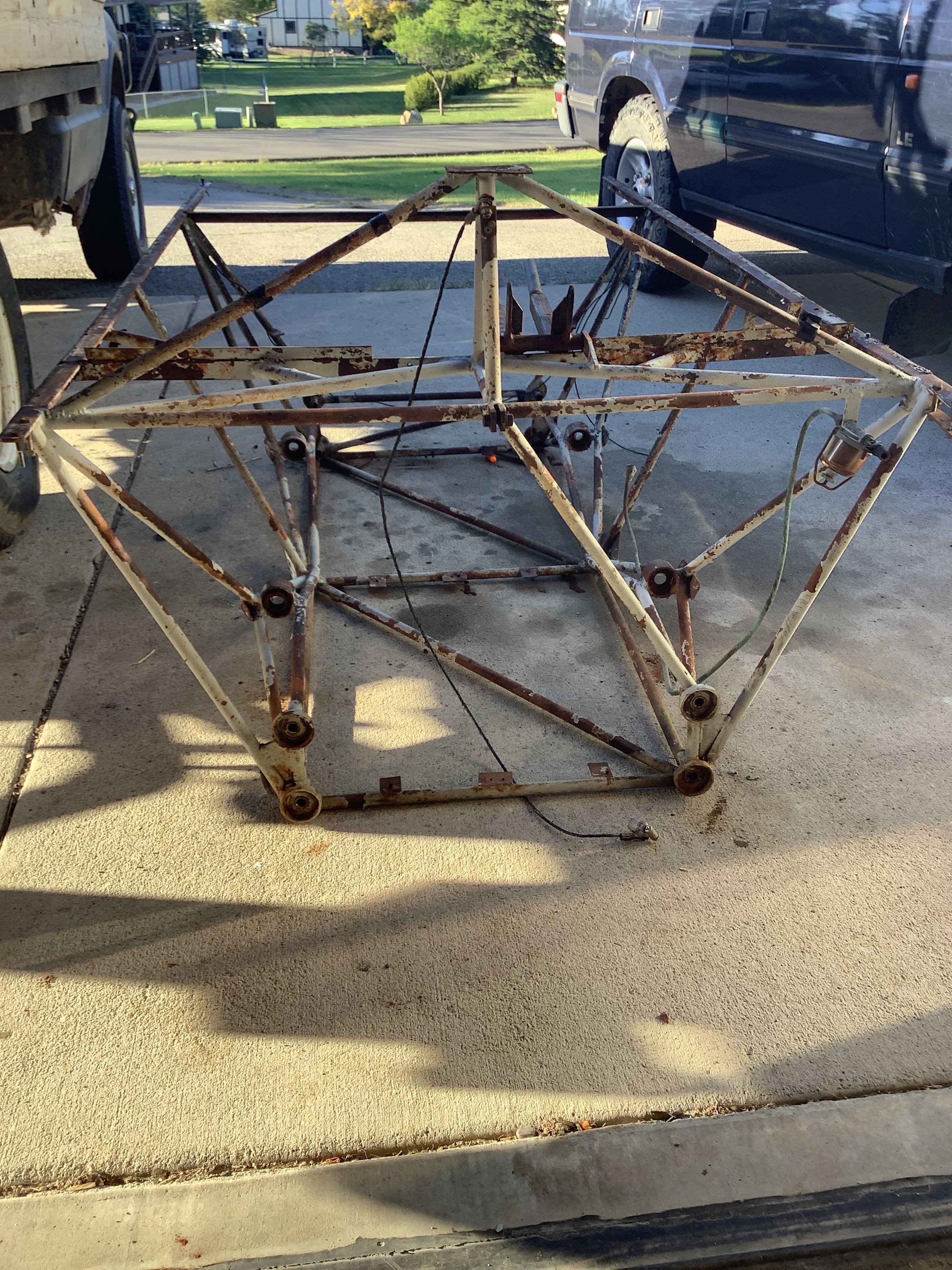

The KT2A is pretty well broken down into its various components and cleaned up for storage. A few comments based on what my son and I have learned thus far:
A faithful restoration would entail sourcing quite a few component parts, such as a hydraulic system (pump, reservoir, pistons, lines and couplings); rear door; full track build-out; considerable fiberglass fabrication and window detail work.
The coach frame is a combination of angle steel and tube construction and is rather delicate in that most of the drive train weight is borne by the axles, rails, and tracks.
Again, would be very interested in advice, comments, and other observations on possible directions for this old KRISTI KT2A. Have wondered if a mold could be pulled from the nose pieces of my KT3 for fiberglass fabrication on the wrecked front of the KT2A. They would seem to be pretty close.
And, of course, the running KT3 needs a bit of work. Will have it out of summer storage in mid-July and will develop a separate posting on that.

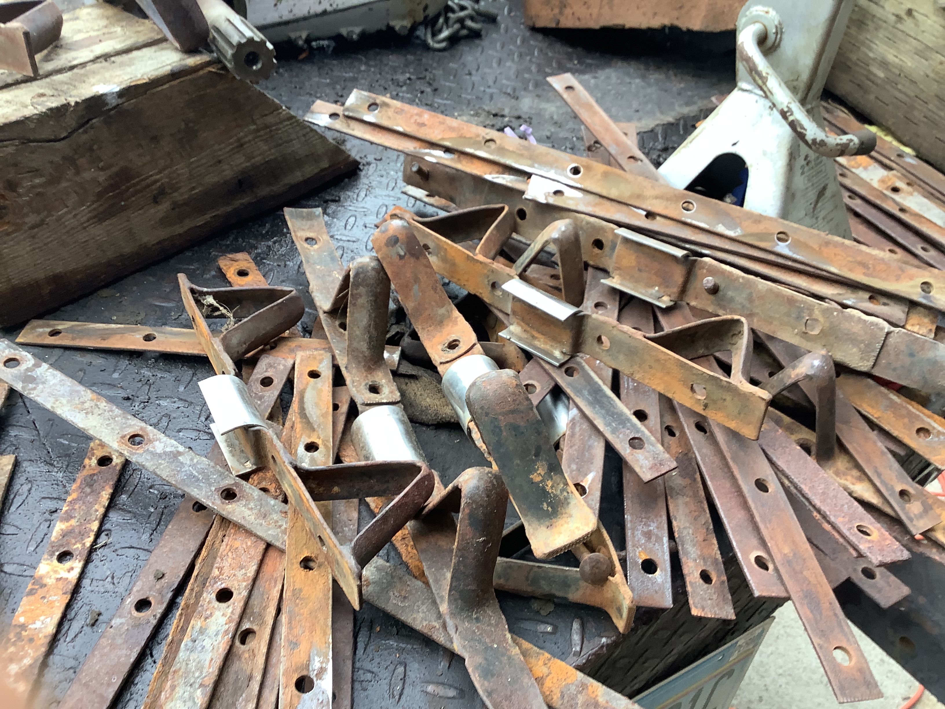

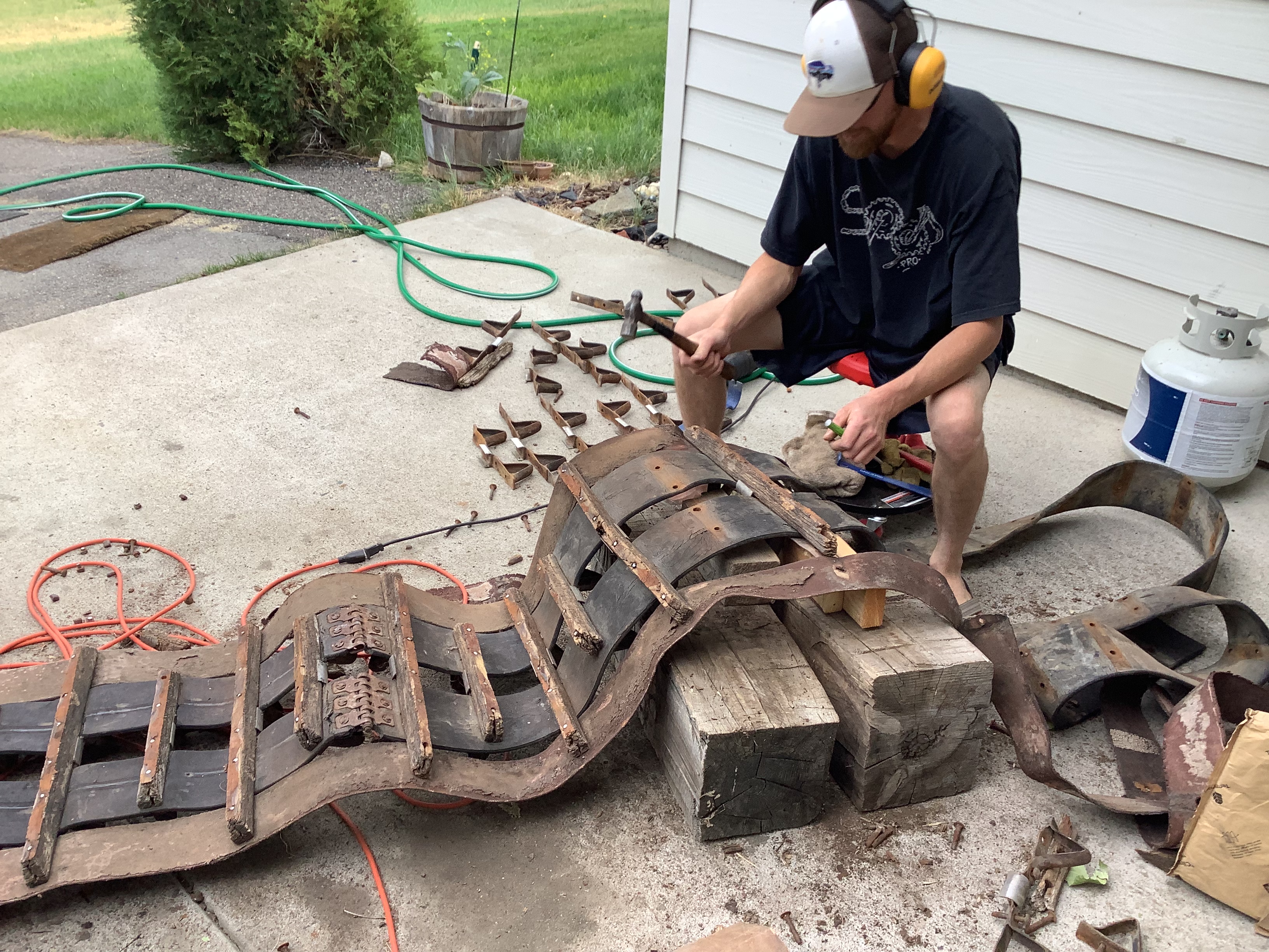

Tearing apart the old rotted track on the KT2A to salvage the wheel guides and flat caps of the grousers. The hickory tread is all hopelessly decayed, of course. The four-ply rubber track is also of no worth. The outside floating track was some type of canvass, and again too rotted. The Flexco fasteners seem of possible re-use, though. Our most successful approach was to test the nuts with an impact gun, which oftentimes broke the rust bond of the carriage bolts to the guides. Still, a lot of bolts had to be ground off or hit with a Saws-All. Temperature about 94 F.
Nice work if you can get it!

Wondering about rust treatment for all these track components. Has anyone tried electrolysis on big amounts like this? I have successfully treated gas tanks this way, and small specialty parts. I do have a pretty large plastic tank. Something tells me to just store the things in a dry location and address each piece on the bench when the track build-out happens.

The KT2A transmission is cleaning up nicely with WD40. That’s the linkage box to the left sitting upside-down.

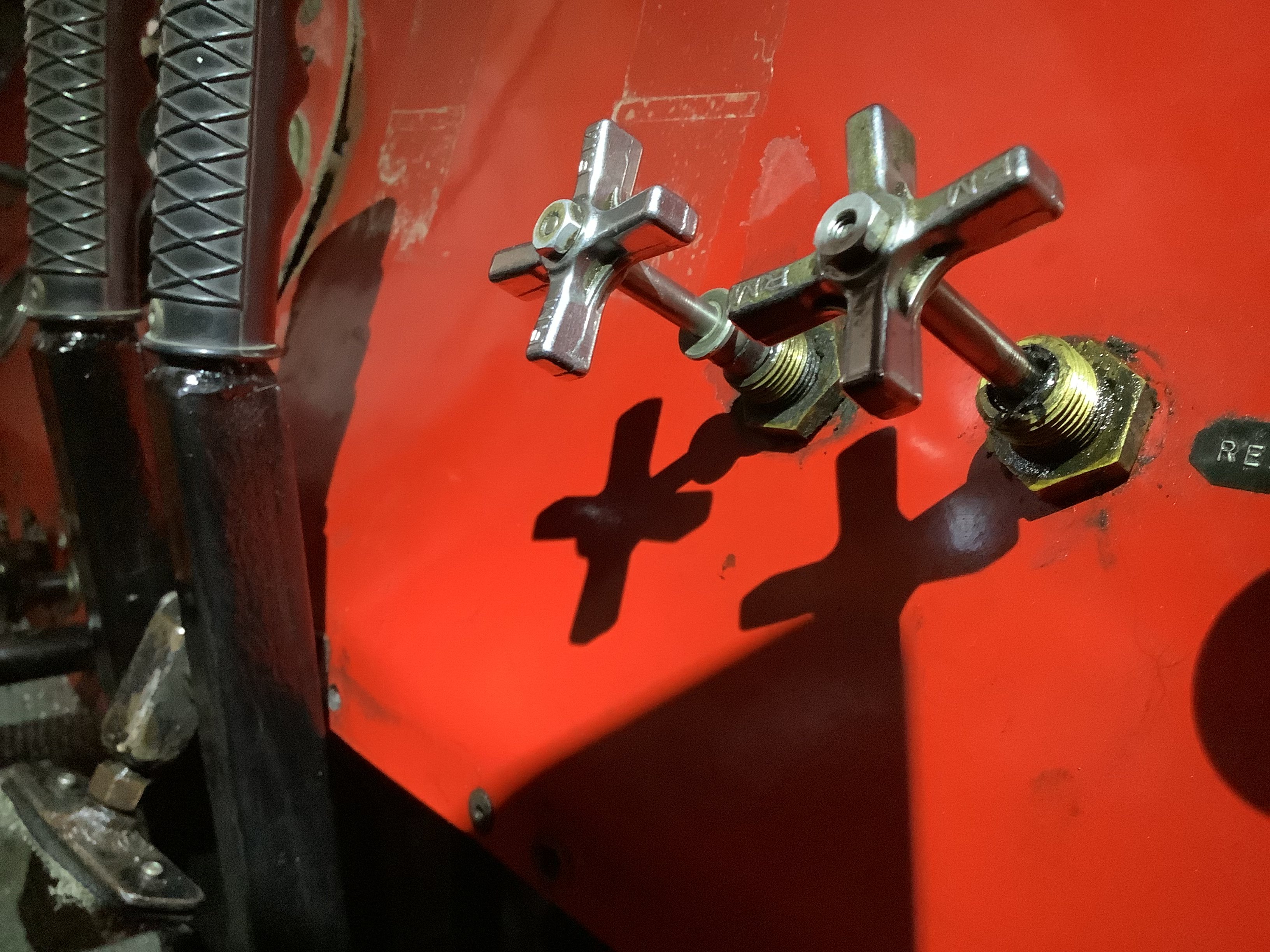

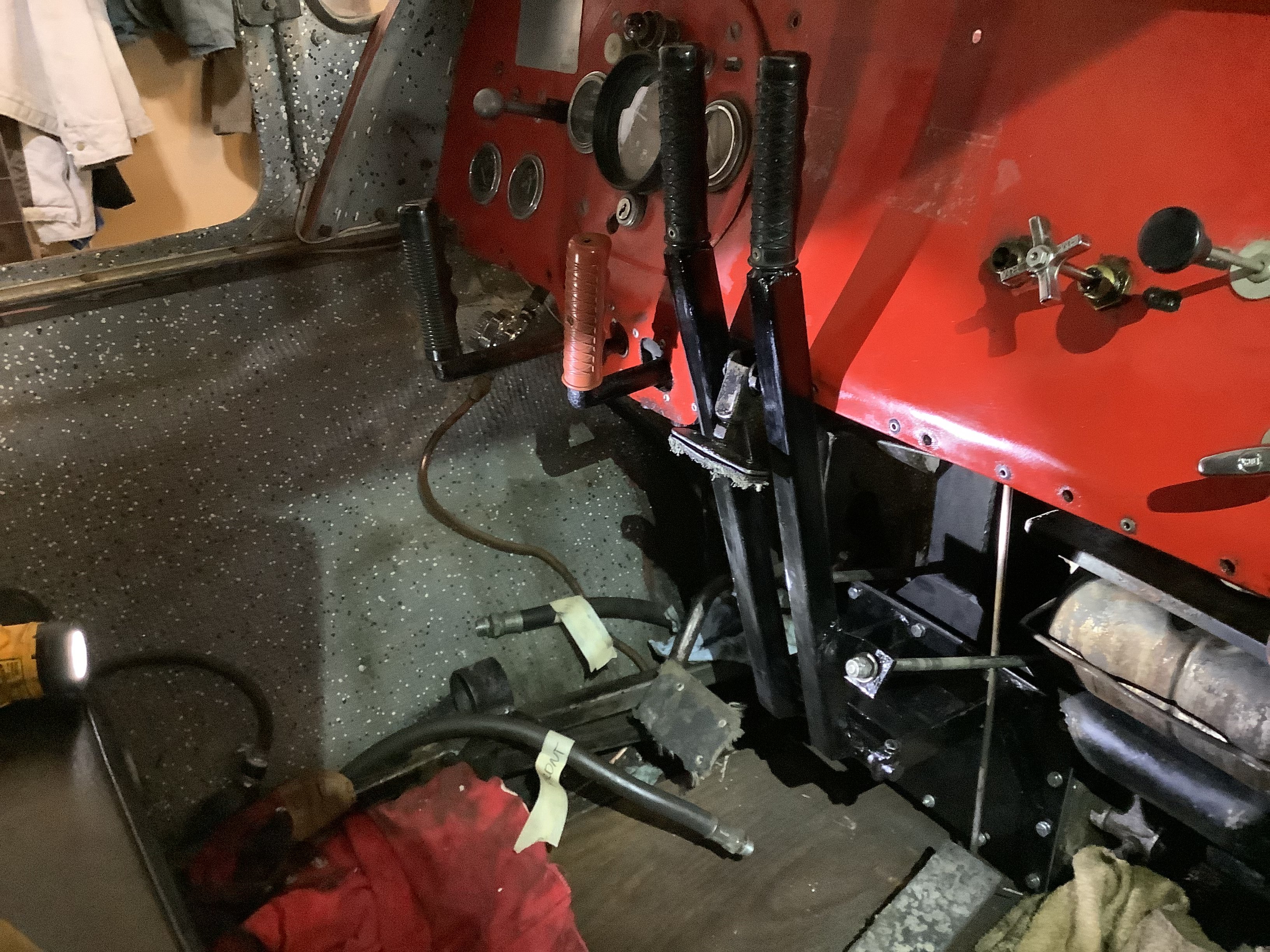

Pulled the diff inspection plate on the KT3 and sucked out fluid. After only about 30 hours of service last winter it seemed rather dirty w/ possibly some water infiltration. Brakes seem good. Cut a new rubberized gasket; the felt one I used last time leaked a bit. Will try a mineral oil 90 wt that might be a bit more friendly to the wet brake system.
Pulled the four hydraulic pistons. Only one seems to be leaky. Springs seem good; I thought at least one was broken.
A lot of leakage occurred from the needle valves up on the dash, though. Since the leaking is so high up in the system, it makes a big mess as the hydro fluid finds every pathway to the tub floor and eventually onto the shop floor. I would like to keep those fixtures, but am having a hard time finding gaskets to fit them. Might try standard old-school faucet washers and see how they hold up. They are easy to access and change out as necessary.
