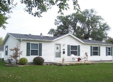

I live in a manufactured home. These things can burn to the ground in 5 minutes once they get fired up, I am told.
God, I am so happy nothing bad came from this.
they can and cant. once again its pride in worksmanship. if the company and its employees care about their job and their customers' safety, then a manufactured home can be about as high quality as ay other house.
if all they care about is money, different story :sad:
The newer ones with drywall instead of paneling on the walls are much better. The old ones had aluminum wiring and it overheated at outlets and switches from oxidation creating loose connections. They are built to much stricter codes now.
Mine is 7 years old. I bought it new and paid cash for it.
It's my home and I'd like to keep it.
