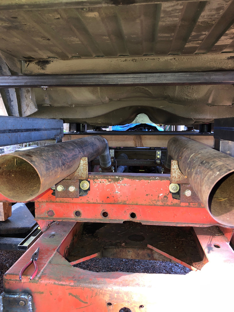

Very easy to mount the fuel lines away from the exhaust as that stuff is in the belly of the chassis..
The ledge along the top of the 2100 chassis is perfect for mounting the fuel lines.....Good distance from the heat..Slip the lines in some heat reflective sleeve.... or ????

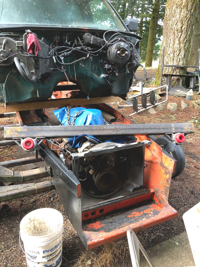

THE PIX
Looking from the rear....Loads of air space under the bodies.
From the front....Front clip goes back on with a tilt forward mod.....Plenty of room under the bodies for air flow.

THE PIX

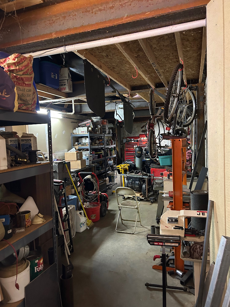

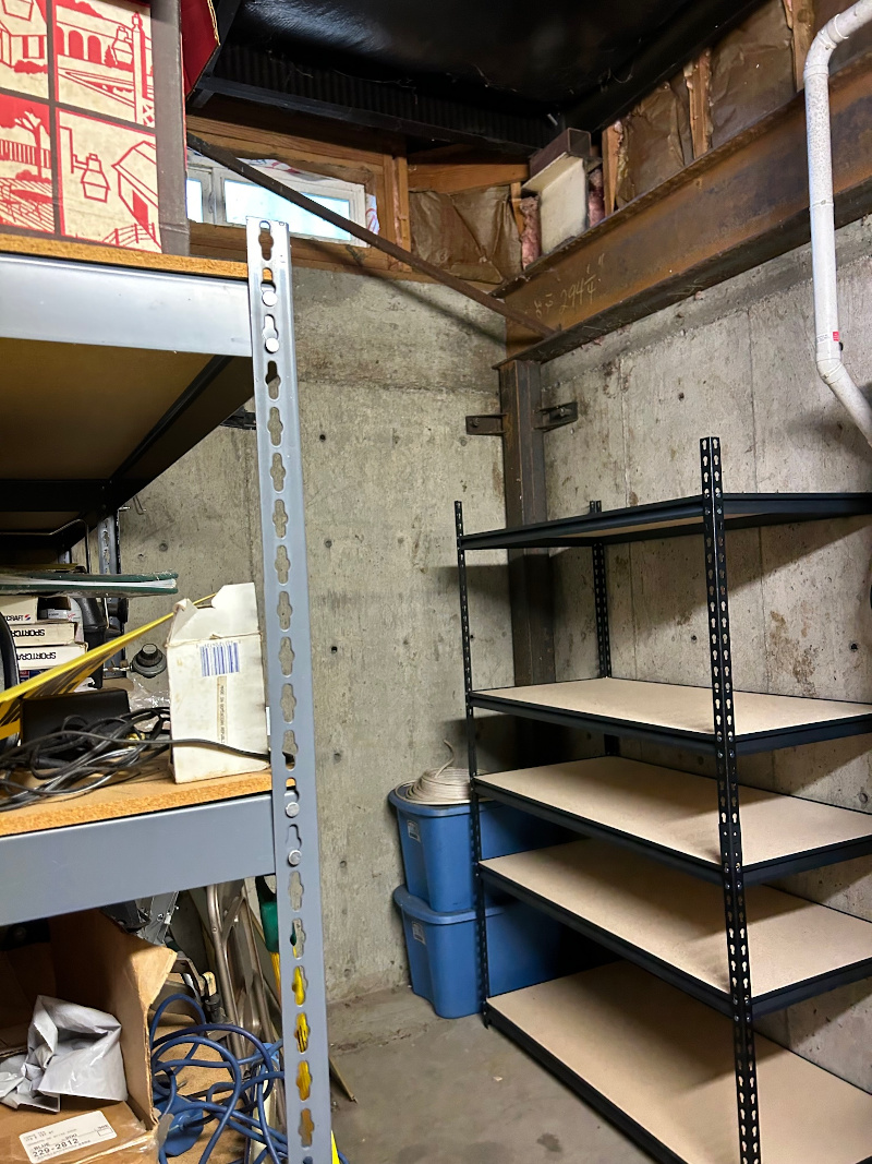

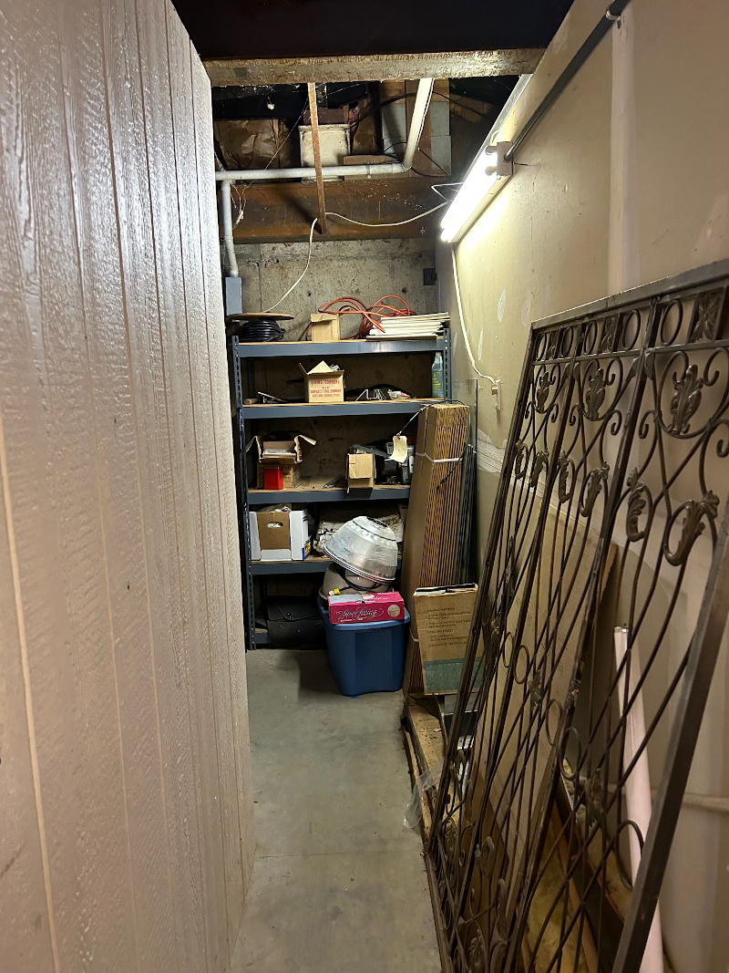

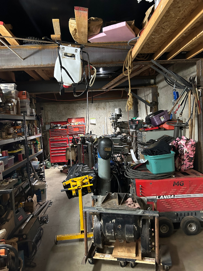

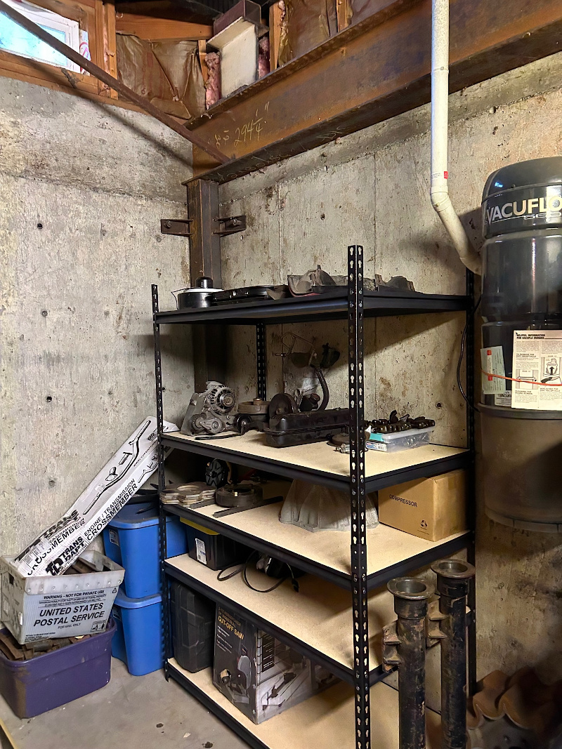

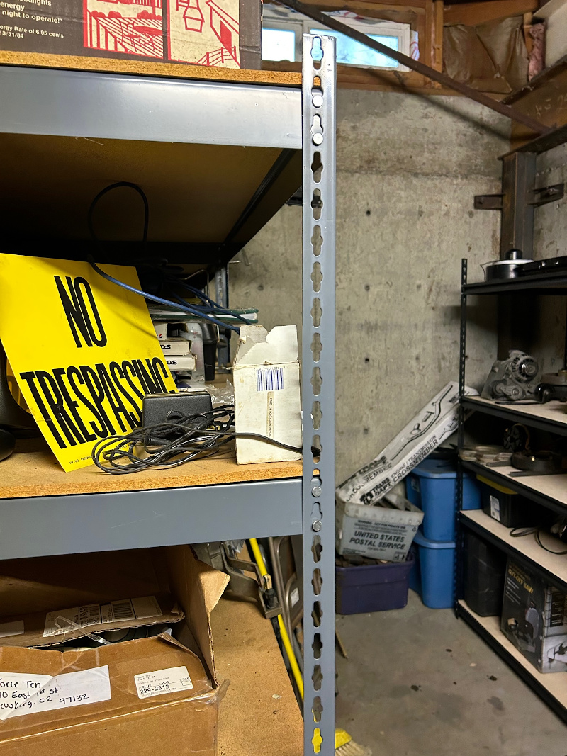

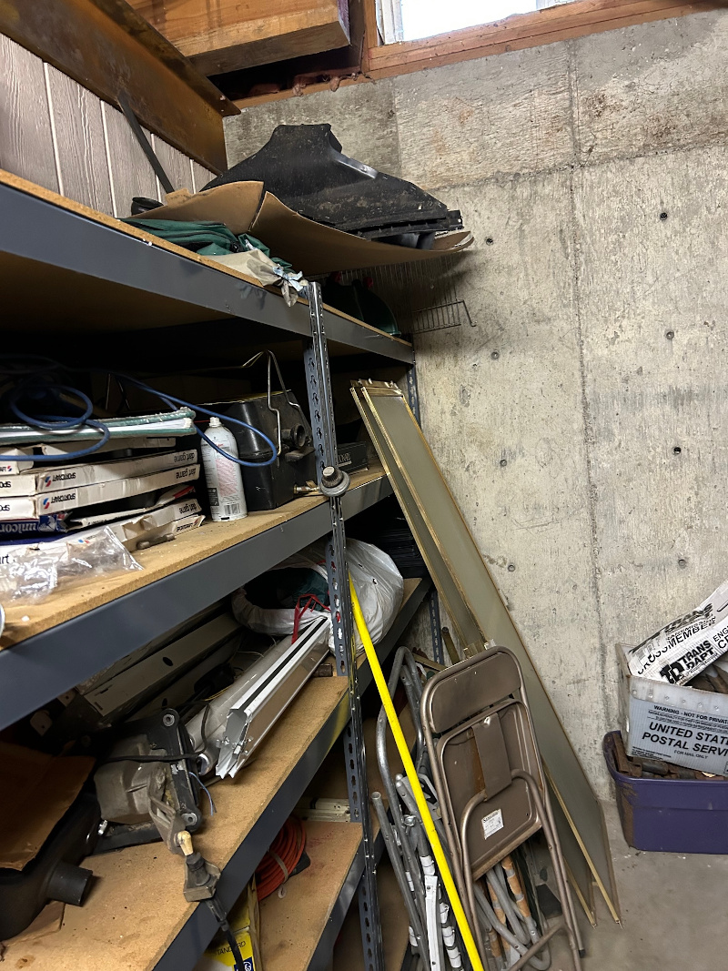

Getting ready to clean out the shop and get my work area organized and all the engine parts off my work bench.
When I ripped that L31 Vortec apart I scavenged all the parts to use the Serpentine drive and the heads and just put the bolts and such in containers and tossed the entire lot of the stuff in a pile on the bench.
I want to clean off some shelves of old crap from ages past that really needs to go away.....Then organize all the new stuff.
There are boxes with such stuff as carburetor, air compressor, pistons and rods. The crank is sitting in the corner too....
Just no organization at all.......
I do not want to open up the big baggy with the block in it until I have stuff ready to work....
Also I want a clean spot to put the heads when they come home too..........

Finally got started on cleaning up the shop this weekend......
Stopped of at the Home depot and grabbed some metal shelving units.
In the process of cleaning up I discovered a pair of nice metal halide light fixtures......Gonna yank out the ballasts and convert these bad boys to run the CORN COB type LED lamps........
The shop area has 4 foot tube type lights on the walls and a couple over the lathe and the mill......But more light will be nice......
I'm thinking seriously about swapping out the Fluorescent tubes to the plug and play LED.....Better light and all around better lamps
The two MH fixtures have nice all glass refractive covers that really get things lit up......
The back part of the shop has a couple storage rooms that we put in and waaaaaaaaay back in a corner there was a huge metal desk that a friend thought would be handy.....NOT....
Sadly the additional rooms were built in with a walkway along one wall and the damned desk would not come out.....So we had to disassemble that beast completely and carry it out in pieces.........
Now with the area cleaned up we can get going on assembling the shelving and then sorting out CAT PARTS and such....
Get the lights wired in and good to go......
Gonna be nice having an overhead light directly over the engine assembly area ....

We went after "Project Cat shelf" earlier today....
Got the shelf assembled and in place......Felt obligated to start filling it up with cat parts..
Got the drive sprockets tucked neatly between the two shelf units as well as the axle tubes and shafts for the OC12
Lots of engine parts on the new shelf...
Still cleaning off the other shelf units of old junk that needs to go away......
The official cat parts place now.....
For the curious folks the are wondering what the big azz steel beam is overhead......
We took a triple wide manufactured home a set that bad boy on a full daylight basement.....
There are nine 12" wide flange beams sitting on square steel tube posts that are welded to anchors in 1 cubic yard concrete piers....That are then surrounded by the 6" thick concrete slab......
The Wide flange beams support several 6x12 wood beams that sit across the steel beams at right angles.....These are wedged at about 6 foot spacing under the steel frame of the house sections......
A crazy idea....Worked sweet....
The picture looking down the long hall way...The wall on the RH side is part of the downstairs apartment.
1000 Sq ft apartment that was my folks years ago....We rent it out now.
The rear section is my shop and place to hide chit........
Concrete walls are 9 feet high and 8 inches thick...(Had to meet industrial code....Cause the county was not sure...so we went heavy)
Was an interesting set for sure.....
I moved a lot of goodies to the new shelf area.....Hardly notice it out front by the machine tools....
After we finish mucking out the other shelves there will be a lot more room for Cat parts.

We did more cleaning and moving yesterday and found a couple more "Gold mines" (Piles of Chit) that got tossed.....
Unboxed the last of the 12" wheels I got for the cat and got them neatly stacked on the new shelf ready to cut the centers and weld in the new 5 x 5.5 centers.....
Son in law had dragged in a 50 gallon air compressor with a blown compressor....Oiless Devilbiss
Rod broke......BUT IT WAS FREE..
May see if we can repair it......
Got the 0C-12 moved out of the way (On a roll cart) and the 406 sbc thats on the stand moved....Now we have access to a large wall section to put a second shelf unit......
The shop area is like 6 pounds of Chit in a 2 pound sack.......But we are gaining on it.....
Image 5842 is looking the opposite direction from image 5835 and looks back towards the machine tools
Nice bare wall area is where the next shelf is gonna go....
Got started assembling the shelf and had a customer show up ....so that ended the shop cleanup.....
Today we will see if time permits us to get that shelf in and FILL IT UP :clap:
Getting this shelf in will give a designated place to store the fresh cylinder heads for the cat engine.
Once there is enough floor space to do more than plant my feet ...Then a ladder will fit and the new lighting can get hung...
Another plus....Once things are better organized the Big Landa Hot washer can be rolled out and the cat can get a good wash off ....At present there is simply not enough room to roll that beast out... But that is changing......

We got the second shelf all assembled and looking good.....Took less than 10 minutes to fill the damned thing up...
But we saved a place for the heads to go...
I need about 6 more of those shelves.....ARRRRRRRGH..
Or maybe less stuff......
I am finally seeing the concrete again.....
