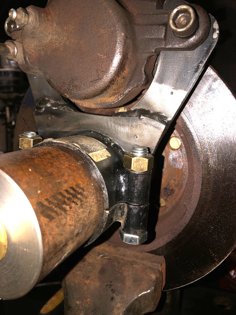

The other guys disc brake setup.....Mine is a spin on the same idea....
I am excited to have a foot brake that does not use the diffy bands to stop with.
This will save the bands me thinks.......

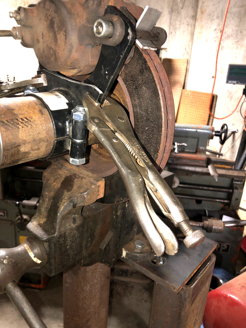

The new outboard brake brackets are all finished.....(Accept for paint...and that can come after the brackets are welded to the pivot tubes)
Got after this little project this morning and carefully aligned the pieces of the brackets with the calipers aired up to keep everything clamped correctly and then got the assembly outside and welded the parts.
Keeping things from moving while welding can be a challenge.
Tacked things up well and swapped sides with the welding until it was done.
Let things cool and bolted the parts back together.
Yessssssssssssssssssssssssssssss.....about as good as one can expect..
Once the caliper assemblies go onto the cat a new set of pads will be installed to allow setting the brackets such that there is a little bit of slack with the new pad in place and the pistons fully collapsed......
A guess at best...but as long as new pads can slip in...WE'RE GOLDEN.
Glad to have this little project done.......

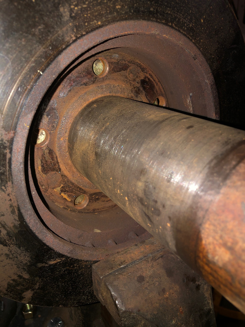

Still need to fabricate and machine the adapters to bolt the rotors to the Sprockets though.
Gotta check out the sizes of things and and decide exactly what materials will work.
I need to figure out the size bearings needed to pilot the pivot tube into the adapter......
All in good time...

Nicely done. Whats the plans for powering the brakes, manual or power assisted?
Also the photo you have of the "other guys setup" any feedback on how well it works? I can tell ya we do alot of snow wheeling with our trucks up here and when the wheels pack full of snow brakes suck real bad. I realize they are "secondary" brakes but curious as to how well they actually work when packed full of snow trying to stop a huge track on a heavy machine, and the S10 calipers your using are significantly smaller than the other guys dual piston caliper setup which looks like a Ford SD caliper? its 1ton for sure and a dually rear disc. I think its a great idea:punk: like you said, save a lot of wear on the bands if it works.
Thanks for the compliments.
Gonna go with a single system mid 60's era GM 1" bore master cylinder on the S10 vacuum booster.
The S10 BLAZER is no 7000# beast, but the cat goes 15 MPH max and the Blazer is gonna be able to do way faster....
From what I heard about the other guys 2100 van cat was that it got away from him coming down a steep grade and he grabbed the steering levers and things got hinky...Damned near tossed it off a cliff.
Serious need of fresh shorts......
The 2100 originally had a foot brake in the hydraulic system to run both bands at the same time for stopping.
I assume that had been removed as has mine.
The hydraulic power controls to the bands are great, but the ON / OFF does not give any really good brake control.
The smaller cats like a Spryte with the hand levers are a different story.
I am gonna go with aggressive pads and that should be enough to provide a reliable way to anchor the beast.
Grab the tranny shifter and roll it down into the gears....then use the brakes if need be.

The brakes on that other cat had GMC 3500 dually rotors and calipers.
I did the research and am pretty sure on that..
The cost for the calipers and rotors is pretty heady $$$$$$$$$$$$$$$$$$$$$$$$$$$$$$$$$$$$$$$$$$$$$$$$
The two calipers, rotors and the new brackets set me back $114 total
Brackets were $36 for the pair and the used S10 rotors and calipers were $78
Snow cats are like boats....they don't coast much.....
Do I know exactly how this will work ??? NO....But we will be the first to find out. :lmao:
At least the calipers and rotors were meant to work together...

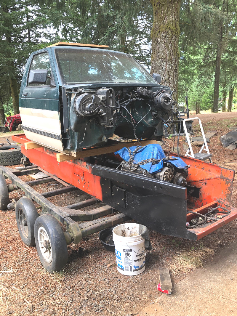

I THINK (Subjective) that the basics are pretty well coming together now, and as far as any major CHANGE ORDERS go I hope things can continue to move along on the current direction and not need any major changes
The Cab from the S10 and the pickup box are pretty well chiseled in stone now.
This plan makes repairs and access easy......
The hydraulic steering and losing the air system just makes good sense....
As long as we stay with the small block Chevy and the TH350 tranny anything can pretty much work.
The one thing that is still sitting in the wings though is the idea of replacing the little 305 with a small block 400.
The 305 will be fine and get things up and running so the package can be wrung out and bugs worked through.
Do I need a 400....NO but it's an I want.

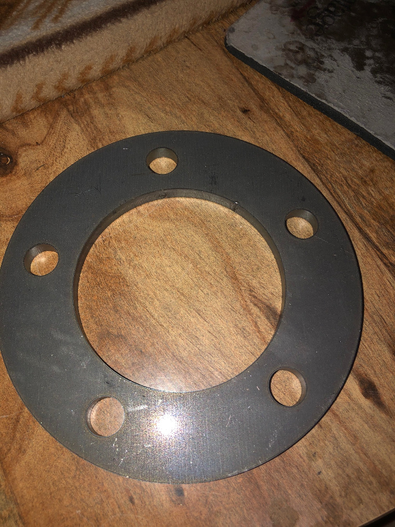

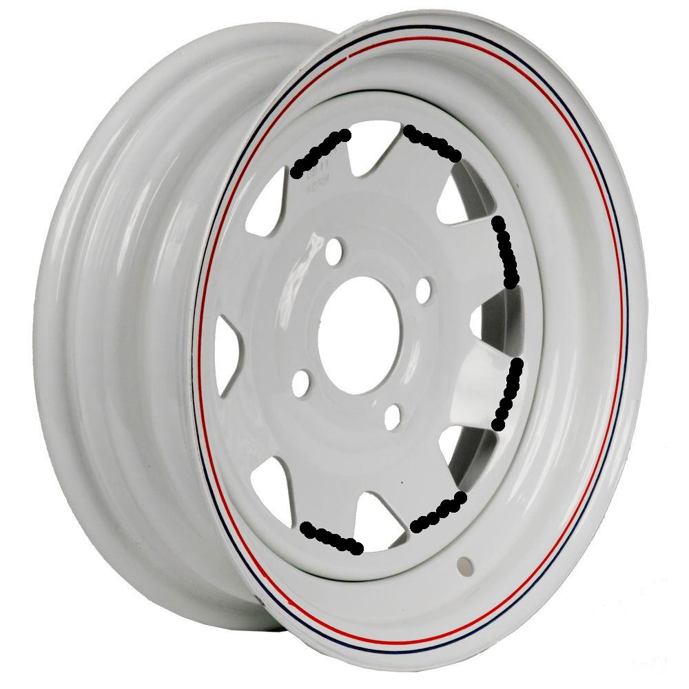

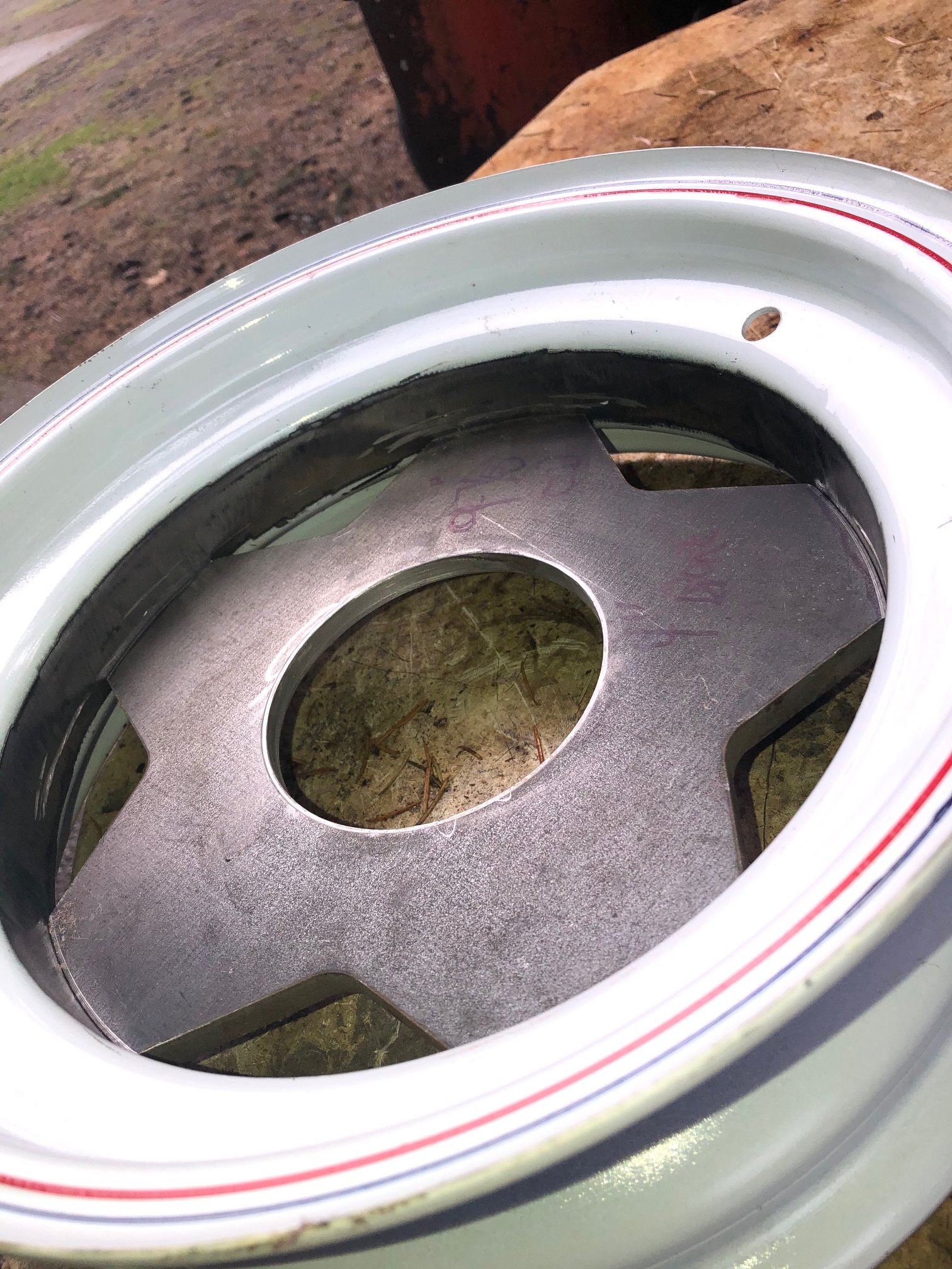

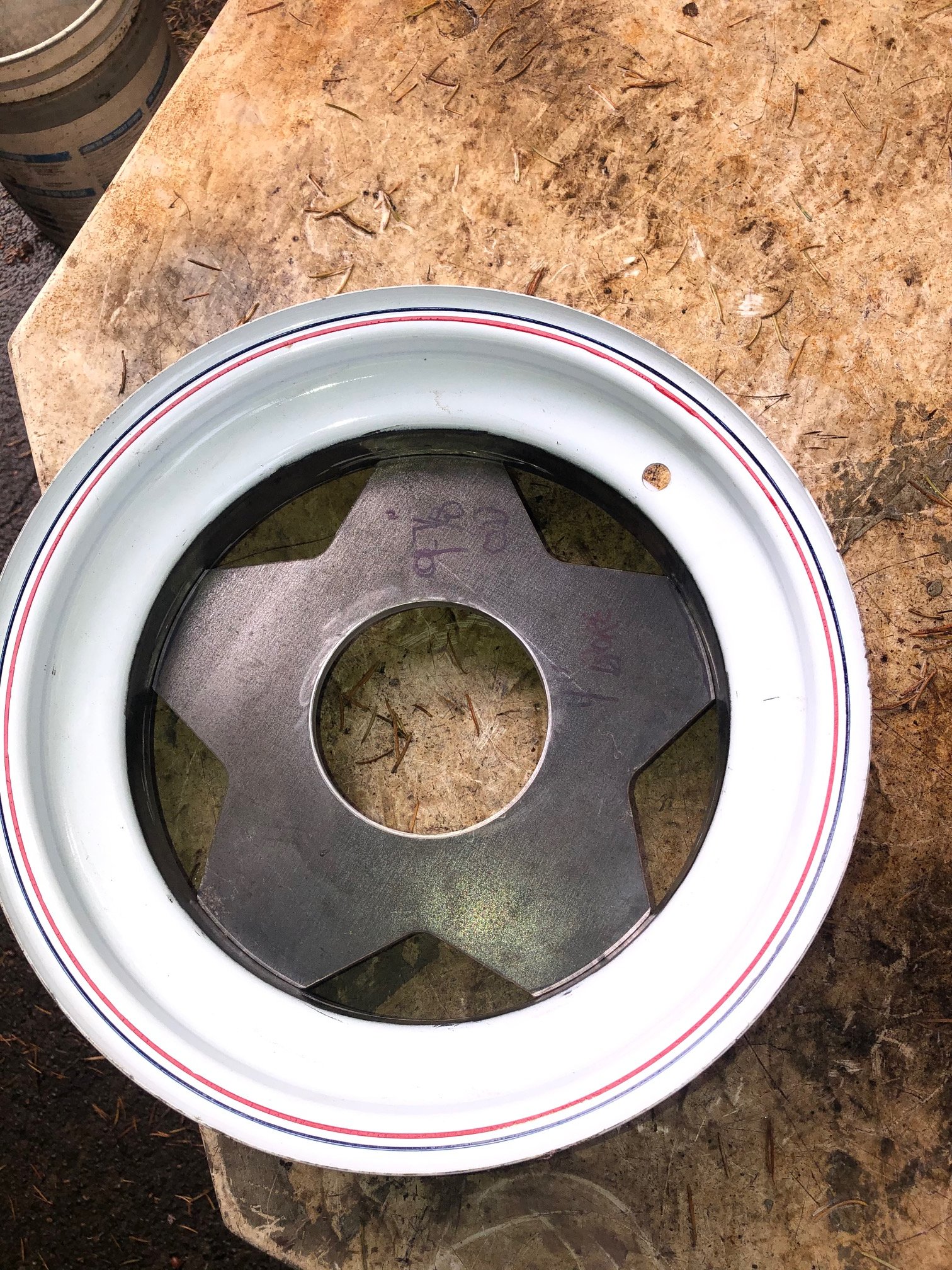

Just got off the phone with the outfit that water cut the snowflake centers for the new cat wheels.
I made a CHANGE ORDER
The new wheels are a tad smaller in the center than what I had originally expected and the finish is so clean that I am having the center bore on the part opened up to just a few thou over 4 inches.
I will be able to toss the part in the lathe and machine off less than 3/16" and then bring the fit up to where the centers will just tap into the wheel.
This will make life far easier.
I have a 5 on 5-1/2 heavy center coming from the derby shop to become my JIG to locate the lug holes.
Once I get the new sample piece then we can do a bit of machining and things should fall into place and wheels can be made fairly quick.
I ordered 4 more wheels from the depot the other day.....
These heavy center wheels should be rugged as all get out.
I am excited to get this critter a reality and things ready to start making 8 wheels and maybe 10.
If this works out well...If anyone needs wheels for there Thiokol...let me know and I can get the centers cut and you can weld them into wheel blanks.
At $20 each for the 12" wheels almost like Christmas.....

Got the one new wheel center out and in the lathe this morning.......Cut the OD of the center plate to fit the wheel rim.
This was the first center I had water cut....and I spec'd it a tad too big....BIG TAD TOO BIG
Chewed it down to size so it fits the wheel ring.
Then tossed it in the mill and bored the center out to 4.030"
The next time these will have the center water cut to size and the OD at 9-7/8" so it only needs to be trimmed a little to tap into the wheels.

The 5 x 5-1/2" pattern ring showed up today.
This bad boy will allow me to get a nice accurate set of holes in the new center plates.
The outfit that is cutting the center plates on the water jet called up and the revised piece is ready.
MONDAY.....we will get it and see where we go.

Stopped off at the Steel shop and picked up the revised "Snowflake" wheel center (The second one to be cut)
The modifications turned out to be quite nice.
These mods are going to make finishing the part a lot easier.....AS IN MUCH LESS MACHINE TIME FINISHING THE PART.
The next step is to go ahead and finish up the jig to drill the lug stud holes and the tool to locate the center plate in the wheel for welding.
