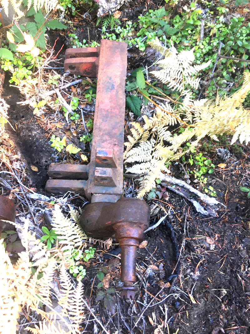

The actual slider track adjuster tubes are still in the cat along with the old bent axle.
I need to remove the axle and the adjusters so I can measure up the slider tubes.
This cat has the Hydraulic (Grease filled) Cylinders to adjust the tracks.....I will remove that entire assembly and while they are out they can be checked over.

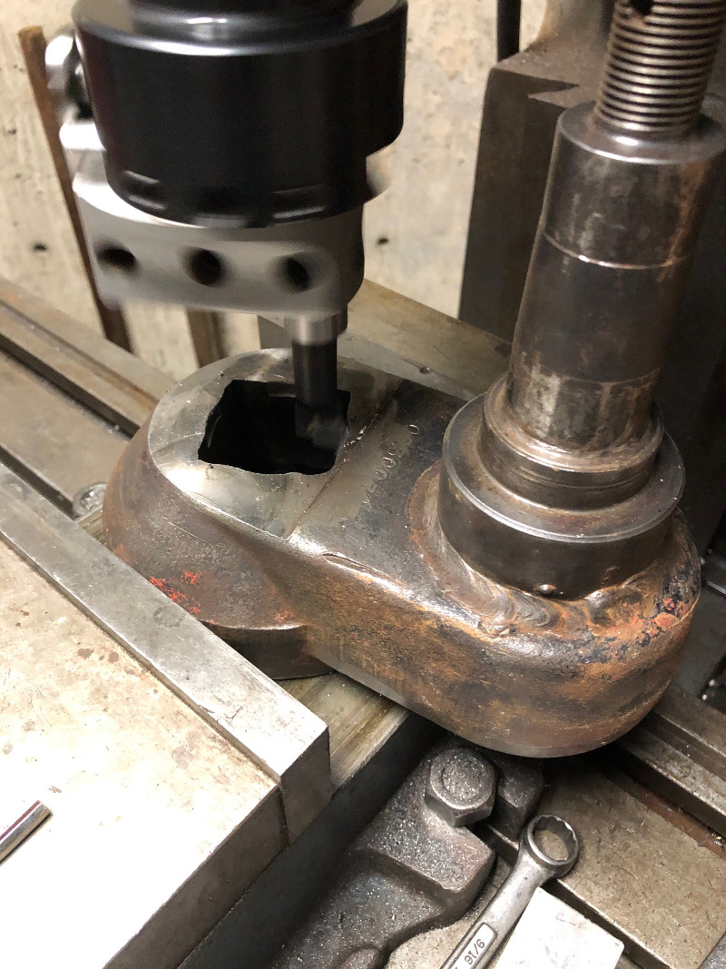

The new slider/adjuster/axle mounts will need to be machined to allow the adjuster cylinders connect as they did to the factory parts.....
The plan is to keep the factory parts intact so if at some point they are needed they will be available.

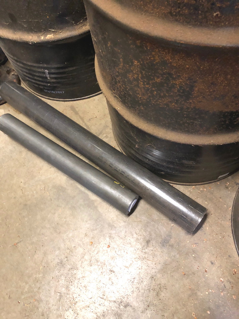

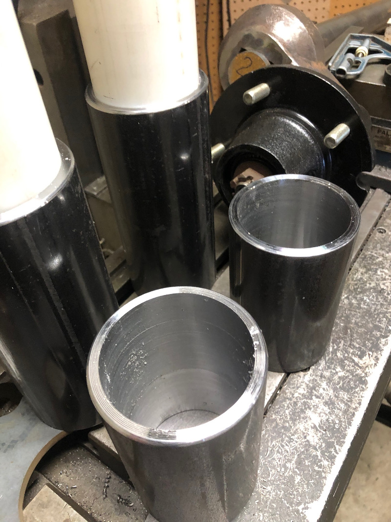

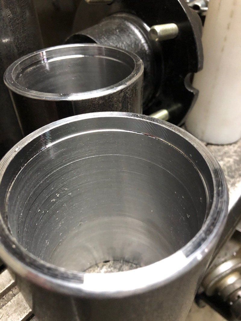

Got the materials to start building the new axle support tubes today.....
3" Schedule 80 pipe in the back and the 3" DOM in front....
Need to cut to length and machine the ends.....

Got the UHMW Bushing materials for the new front axles on it's way.
Did a bit of snooping in the grease seal handbook and found some seals that will go into the axle bushing tubes to keep water and debris out.
Normally UHMW is not used with grease....but after a chat with the folks that make the stuff they informed me that grease will not hurt the polymer.....The grease will however keep the axle shaft from rusting...
I got seals coming that use a "VH" type seal lip (Lip facing outward to keep water and dirt out and let grease purge through.
This is the same arrangement that was/is in the hubs on the 2100 bogies.
As soon as the materials arrive things can get to going on the new axle assemblies.

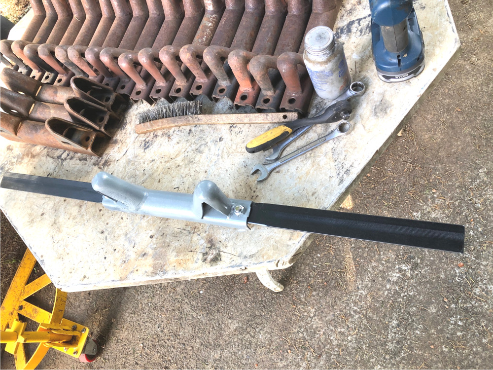

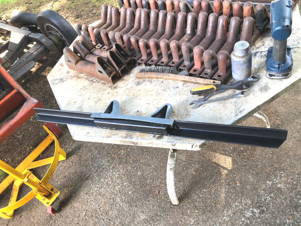

More pics
More pics

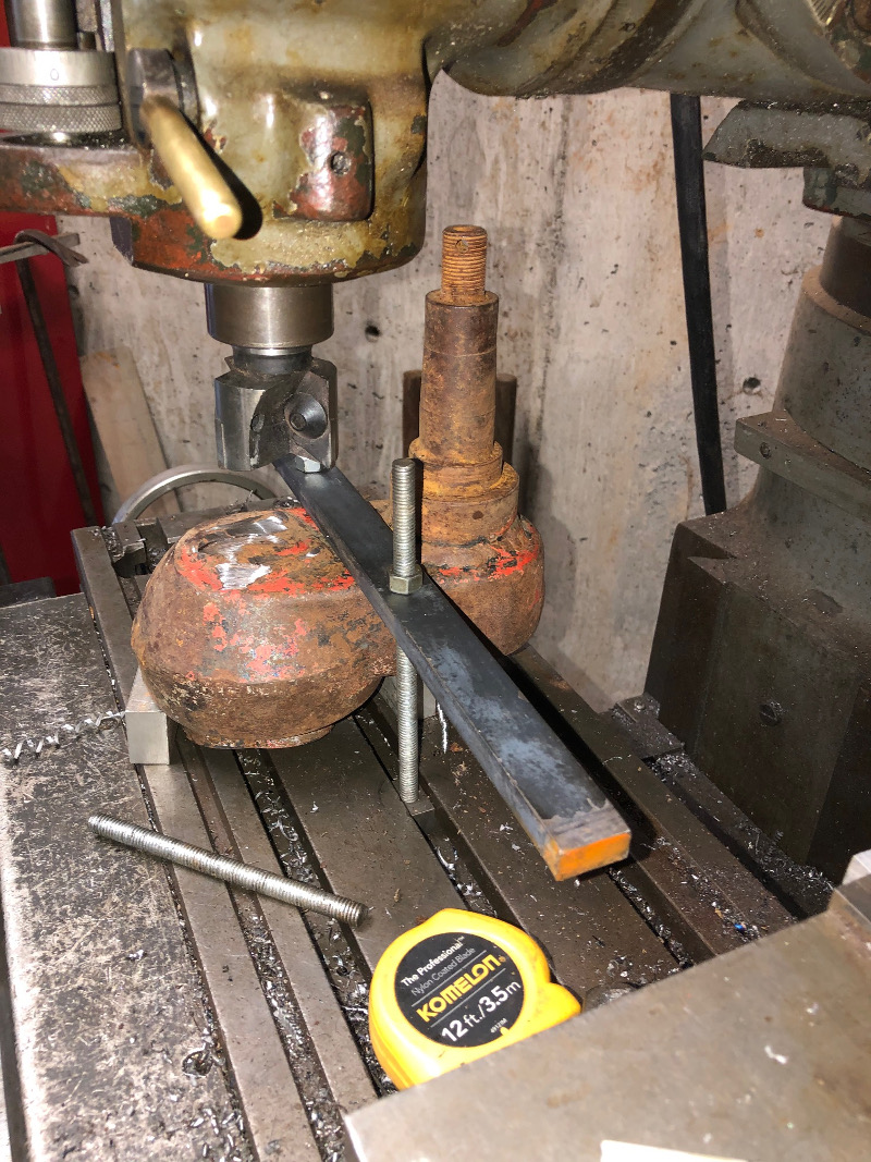

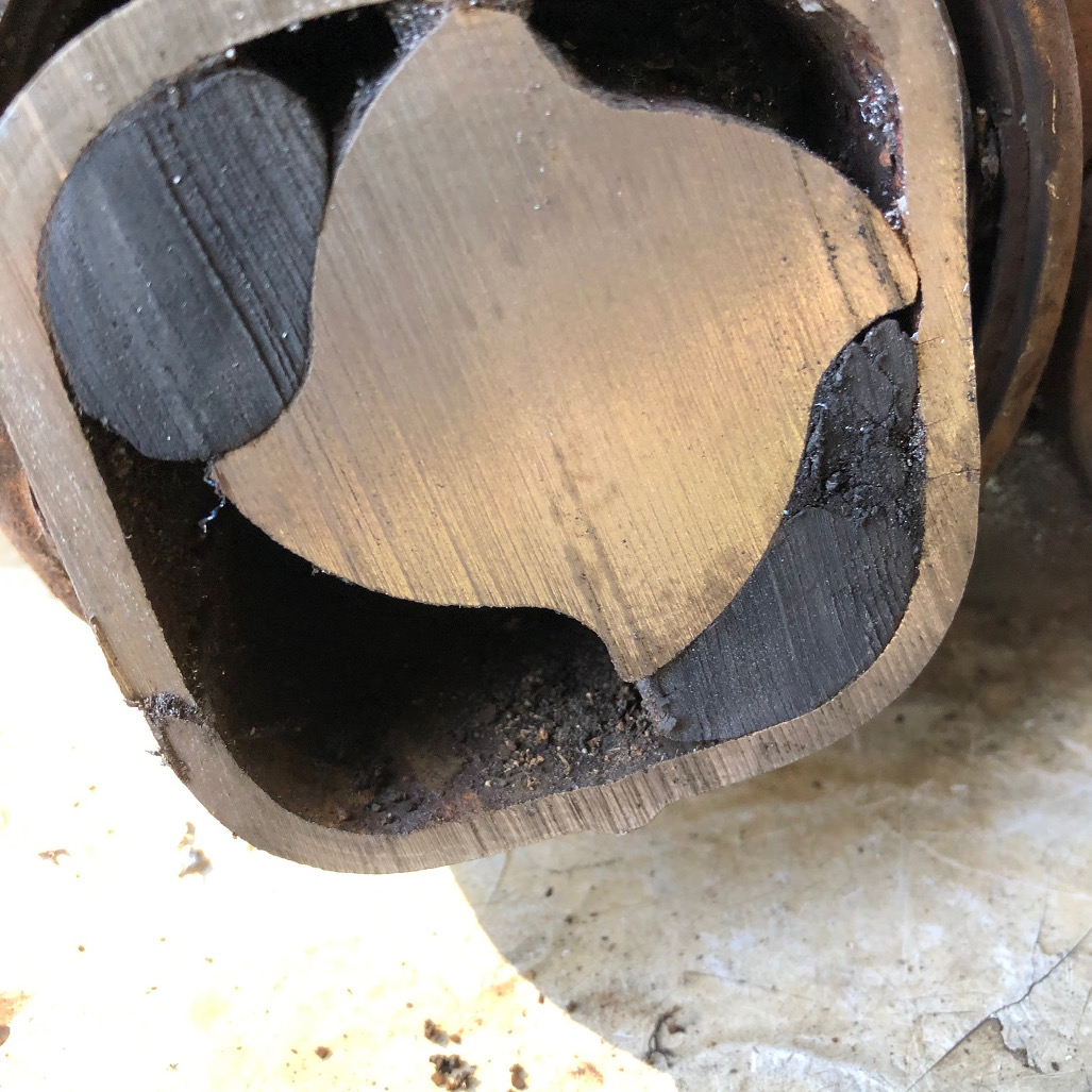

Axle spindle arms and such

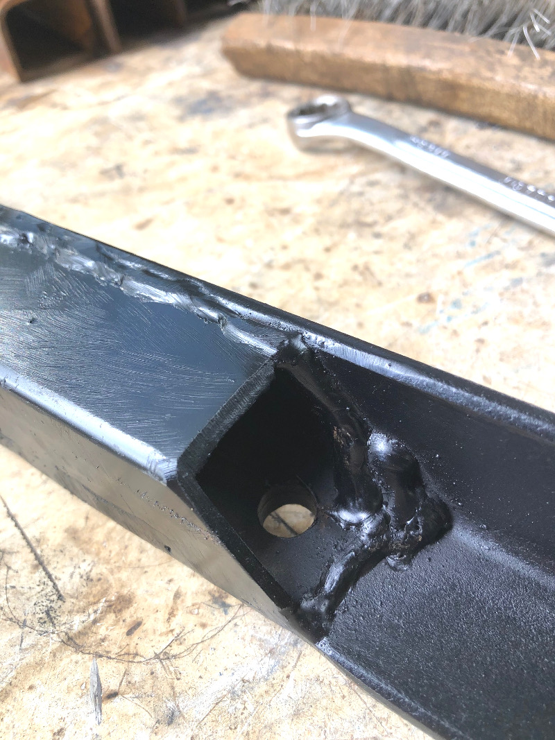

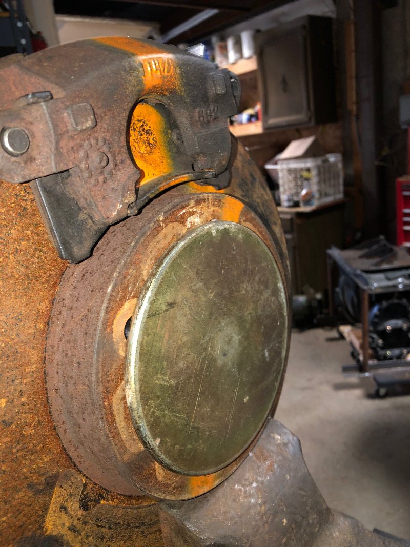

A shot of the worn seal area.
A speedi sleeve will deal with this issue

I plan on getting going on getting the old front axle out of the cat soon......This will allow me to check out the track adjusters and the cylinders.
Once this is done we will have the final measurements needed to start cutting and machining the parts for the new axles.

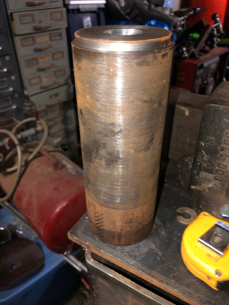

Stropped off at the post office and picked up the UHMW tube for the axle bushings.
Also got the seals I ordered for the ends of the bushing housings......

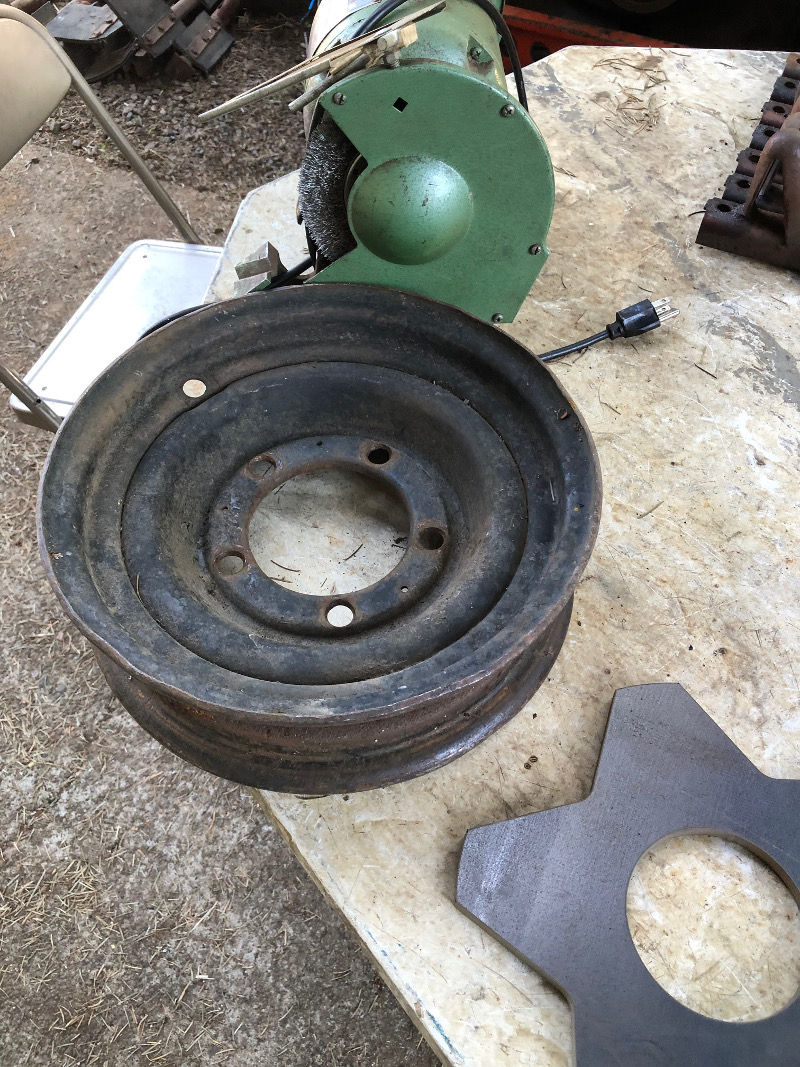

OK.....Sooooooooooooooooo...The unlikely supplier was HOME DEPOT.
12" SPOKE'D WHEELS FOR $20 EACH....Hot Damn....
I can get the custom centers I designed a while back for $40 each....
So $60 per wheel.
The other outfit wants $29 per wheel ring, $38 per center....Plus a hefty shipping cost.
Be near $100 per wheel.

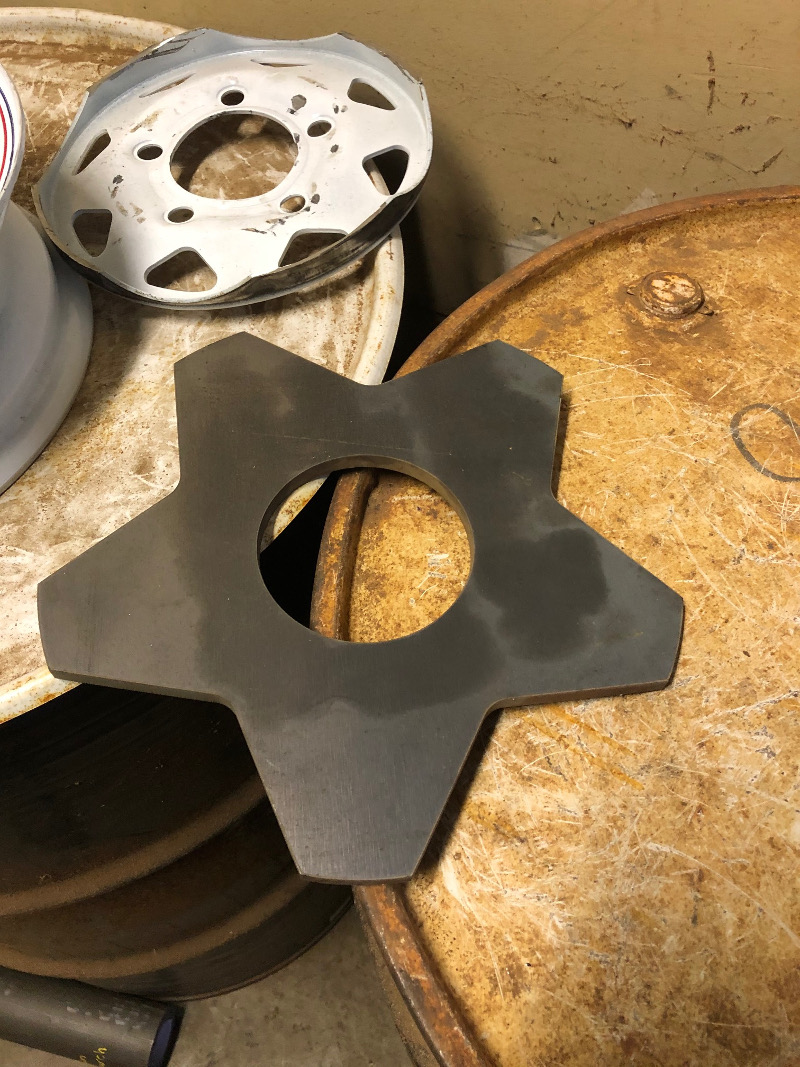

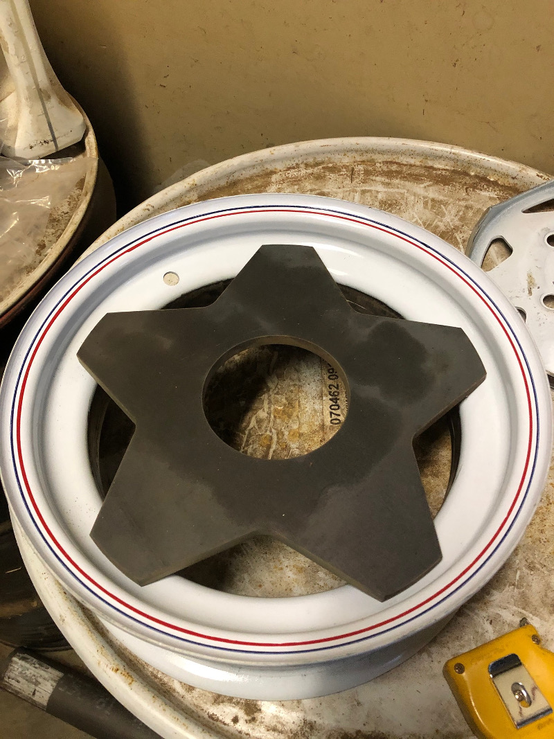

So..Remove the centers on the wheels from HD and weld in my custom centers.
The one thing that adds complexity is the NEGATIVE offset on the original wheels....3/4" negative that has to be there so the tracks will run correctly.
Most standard wheels are Zero offset.
So...Got a couple wheels coming to make up a a pair of prototypes.....

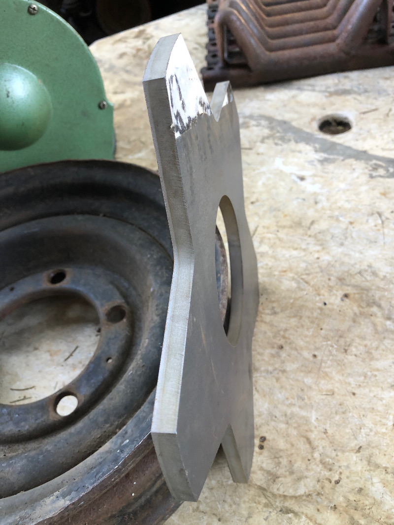

The plan is to simply cut the centers at the triangle openings and leave the remainder of the ring. The ring is welded 100% and would be a tough slog to cut without compromising the wheels integrity.
I have the material coming to build a jig to align the center ring with the wheel at the correct offset to allow welding.....
Piccy shows the point of cut....the remaining ring can remain and will hurt nothing.
The new 3/8" center plate is ready to drill and countersink the lug stud holes....the locate and weld into the wheel.
There is a possibility of adding a piece of steel between the original ring ( spokes cut off) and the 5 spoke 3/8" center plate
My air reciprocating saw will make quick work of the spokes.
I am anxious to get the wheels in my paws and see wassssssup.
I had given thought to machining the center ring out....Way too much and no safe way to grab the wheels in the lathe (That I have anyway.....)

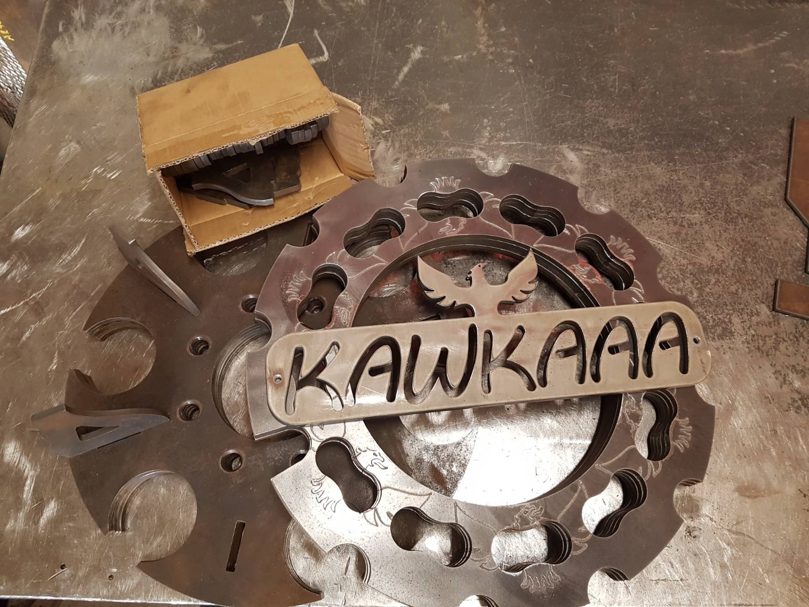

Some decent pics of the water cut centers.
A local shop did this one and they have the details on their machine for subsequent parts.
Adding the extra support might help.....

The other piccy is one of the stock Thiokol wheels.
Bead area has been welded up in several places...some places more than once.
The rust is terrible too....JUNK...ALMOST ALL OF THEM.

Local shop charges me $40 per piece for the snowflake wheel center in my piccy in 3/8" plate
The issue is when the tire goes flat and the tire guides get after the rim.....the edges of the rim just get beat to Rat Crap
Not just the valve stem. the actual rim gets dented up.
I am not sure that a weld on ring is going to fix the problem.
The alloy wheels like whats up front (Many Thiokols can be seen with the alloy wheel/hub combo in all 10 positions) have a wide flat face that is shaped such that if there is a tire guide strike the wheels seem to shrug it off pretty well.
The steel wheels seem to get hit directly on the edge of the lip area.
Several of mine are just well dented up..
Big huge dents.
I think the solution is keeping the tires from going flat... ??????
I would love a full set of the spoke'd aluminum wheels....but my pay grade will not deal with the cost..
The one downside to the wheel/hub combo is the extra work and tools needed to change the beast in the field.

Finally got over my funk and headed downstairs to the shop.
Grabbed the steel tube for the new front axle bushing brackets and tossed it in the saw.
Got the inner and outer tubes cut to length..
Next they go to the lathe to get the ends faced off, the bore cleaned up at 3" (2-7/8" rough now) and the ends bored for the seals to press in.
The plan is to have the 3" UHMW be able to "just tap in" Two drilled and tapped holes in the side of the tube will have 1/2" brass bolts threaded in through the UHMW bushing to retain the bushing (Bolts will be 1/16" to 1/8" from the shaft surface)
This plan will allow easy replacement of the bushings at a time in the future when/if they need replacing......
I will get some pics when the tools hit the tubing and things look like Cat parts...
Good things happening.
I got the new front axle pivot tubes in the lathe this morning and machined them for length and then bored them for the UHMW tube to just slip inside...Maybe with a bit of tapping from the Orange dead blow club.
The bushings will be retained in the housings with a couple 1/2" brass bolts that thread through the tube and UHMW
The brass bolts will be short enough that they won't hit the shaft....and even if the bushings wear some the bras will not hurt the shaft.....
Got some new carbide inserts for the boring bar....OH BOY...THESE ARE SWEET.....The overseas bars are fine....but the carbide inserts are rat crap....
A few pics
The lathe is running...not just sloppy picture taking ....:lmao:
I need to bore each end of the tubes for the seals now.....then they will be ready to weld on the mounting plates..
I need to get the old front axle out of thew cat and remove the adjuster brackets so I can design the new ones.
Fun fun fun

More machine work done today. Got the seal counter bores done on each end of the new axle pivot tubes.
These went well.
Welded steel heavy wall pipe is not bad to work with....just does not machine as nice as some materials though....

The little wheels I ordered showed up today too.
Got them bad boys outta the box and to my delight they are welded in 4 places . Thought about cutting the welds in the lathe....but the "Grab" in the chuck was sketchy at best....Decided against it....too much danger of a bad wreck...
Cut the wheel center welds with the die grinder and a cutoff wheel.
A swat with a 5 pound club and the center was out.
Measured the thickness of the wheel material.....1/8" thick rim and 1/8" center
The stock wheels on the cat are about the same....After the rust gets scraped off....Yeah buddy
Several wheels I looked at were spec'd at .097" thick material....so the .125" is a good thing.
NOW....THE NEW 3/8" THICK "SNOFLAKE" CENTERS ARE GONNA BE TOUGH TO BEAT....They are not gonna bend like the stock stuff does.
5 welds (Both sides of the plate)
If these go away something is not going as planned.....
I ordered the 4 hole wheels as they were cheaper, and the material is the same....but 5 hole ones came...oh well.

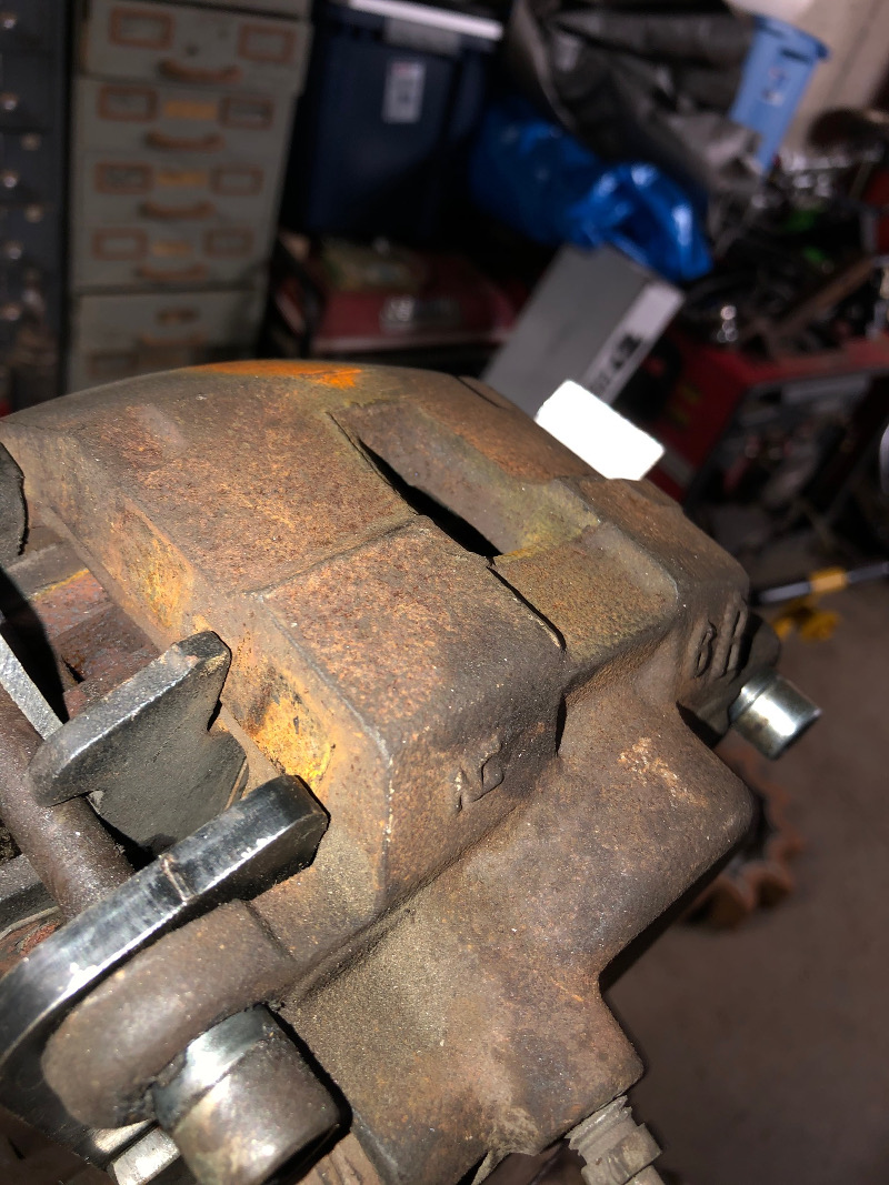

Got a chance today to head to the bone yard....Snooped up a set of the proper Disc brake calipers and rotors for the rear of the cat.
So we find a 96 S10 Blazer with calipers and rotors that looks nearly fresh.
10 minutes and them bad boys are on the ground....Into my 5 gallon bucket and heading to the check out.
Two rotors, calipers and the pads are not light to pack about a quarter mile up hill back to the office...Plus the tool bag..
Get home and try assembling the new brackets.
Wellllllllllllllllllllllllllllllll......Some tweaking was needed to get the anchor pins to thread into the new brackets.
Squeezed the bracket in the vise a tiny bit and thing were sweet.
Then it became obvious that things were a tad askew .
Dug through the info on the caliper brackets and in very tiny print it says use 11-3/4" rotors.
The ad online did not mention this tid bit.
So the nice 10-1/2" rotors will not work.....Huh....You betcha they will.
Brackets will get shortened a bit and the stock S10 Blazer rotors will do fine.
Been nice if they had been a tad more obvious with the requirements.....
This is why a lathe, mill and a welder are so stinking handy....if it don't fit....Hold my beer....watch this.....IT WILL WHEN I'M DONE WITH IT......
Snow cat parts are like hot rod stuff....some modifications are necessary for proper fit...:lmao:
I want to keep with very easy to find parts.......The 11-3/4" rotors that work with the small metric caliper are not one thats gonna be found at the corner parts house easily......
The 10-1/2" rotors will be quite adequate to reign in the FrankenCat......
Gonna be great to have a separate braking system that is stand alone....

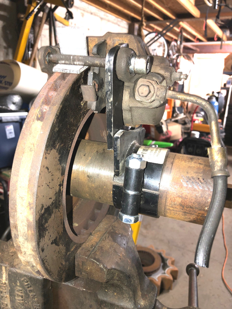

Did some measuring this morning and made shopping list.
I needed to make a "Tool" to fit into the disc brake rotors pilot bore and be able to secure it solid.
Once the tool was secure the New caliper bracket could be located....marked and cut.
The bracket needed to be shortened about 3/4" to allow the 10-1/2" rotors to be used.
The bracket is supposed to be used with a 11-3/4" rotor.
These are a hard one to source....and not a local parts house dash in and grab one thing.
Got the pilot shaft machined to just fit in the rotor....Drilled it full length and then needed a way to secure it to the rotor so the assembly can be lined up and welded....AND KEEP THINGS STRAIGHT.
I had a left over style 30 brake chamber rod/piston on the shelf and it was a perfect fit to act as a clamp to hold the "Tool" in solid.
With the new bracket cut and finished up.....just a matter of getting the slide bolts and the new bracket arms in position and then sliding the lower portion up and behind the arms.
All fit and two little aluminum angle pieces 1/8" thick slipped in to position the caliper correctly and locate the pads at the top of the rotor..
A couple picks of the other new one that still needs cutting.
The assembly ready to weld.
The completed assembly will clamp to the pivot arm that has two pilot bearings to allow the caliper assembly to remain stationary.
A short arm will connect from the pivot to the cat frame....and likely ride in a slot in a frame bracket....
