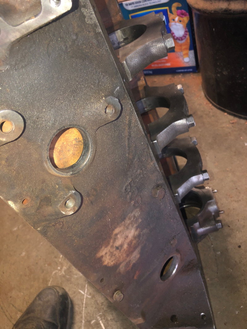

Dragged the engine block outside and went after removing ALL the Core plugs (Freeze plugs) and the oil galley plugs.
Some other yahoooooo had been worrying on the galley plugs and had F'D up two of the square sockets in the 1/4" pipe plugs.
The one in the top of the LH deck was really messed up.
Took some patience and a bit of ELBOW Grease to get that bad boy out.
The front oil galley plugs almost fell out when I ran a piece of 3/8" rod down the galley and pushed on them.
I will stake the holes going back in......
I may add a small Allen Screw with the head slightly over the holes to keep the plugs from getting loose.
The hole is a touch too large for tapping to 1/4" NPT.
Takes very little to hold the plugs in.....but if one gets out....GAME OVER.....
There is also one down under the rear main cap that blocks the oil passage so oil flows to the filter and then reenters the passage above the plug.
This block is so grungy that every orifice must be cleaned out well.
The Freeze plugs were actually fine.
The coolant had been maintained well.
But ya can't see how they are.....and getting them out is a one way trip.....
This bad boy is now ready to head over to the machine shop and get tanked.

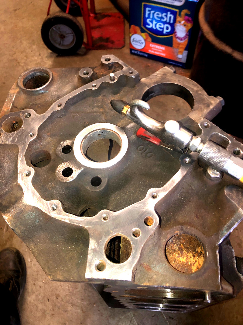

Fooling around with the Front oil galley plugs in the BLOCK later yesterday.
I picked through some left over plugs from previous builds.....the new plugs do NOT even tap into the oil galleys snug....let alone tight.
NOT going to fool with the cup plugs....
Going to tap the holes with 1/4' NPT (Same as rear plugs)
The only thing that's important is to tap slowly...checking the depth and make sure not to go too deep...
The plug needs to be tight as it approaches FLUSH with the block.
Too deep on the upper (Center) passage will result in the plug blocking the oil feed to the front cam bearing AND the front main bearing and rods.
Stick a small object (Drill or ???) up through the main bearing oil feed hole and make sure the plug does not obstruct the oil feed hole..
Add blue loctite to the threads JUST TO BE SURE THE LITTLE BUGGERS STAY PUT.
Out back the loctite will seal the threads up nicely and keep them from leaking too.
DO NOT USE ***RED***
You may want to get these out some time.....Red requires heat to remove .....The Allen plugs do not have a very large hex size.... Once you rip it out....then comes more work.
The internal plug in the pump feed passage is fine with the cup plug...This is a pressure balanced galley and so ...no worries.

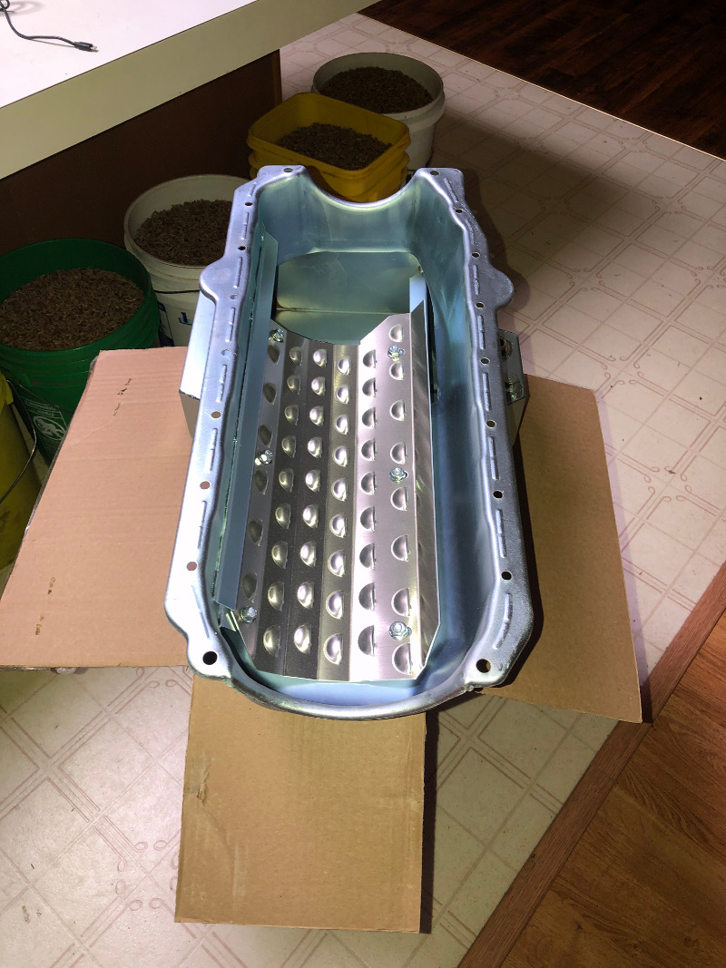

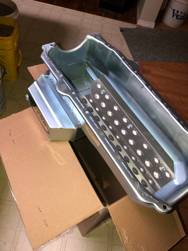

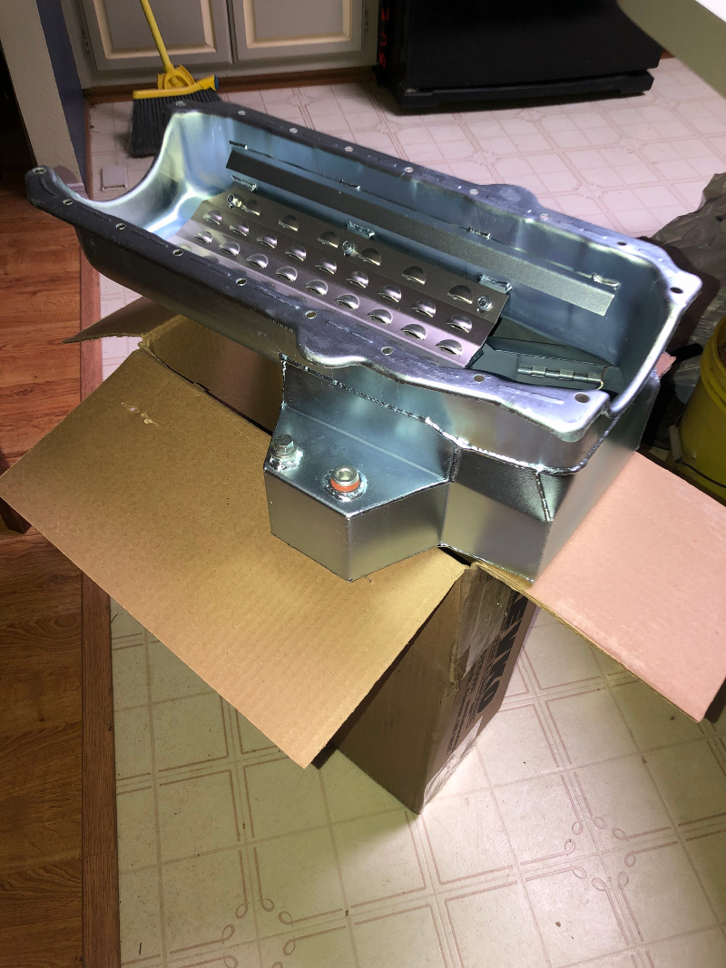

Jumping for joy.....GOT THE NEW "FrankenPan" for the Cat....Will fit any small block Chevy with two piece rear main seal.
3 gates, designed for "ROAD RACE" application.....7 quart capacity should be fine for a hobby cat.
Arrived about 30 minutes ago via FEDEX.....
Box was a tad thrashed....but the pan is fine
Lovely windage tray system too.
This will certainly help keep the oil in the sump.
Running 3500-to 4000 RPM at max road speed will churn a froth in the pan for sure......nice to be able to keep it controlled.
Well made too.
Drain plug on the RH rear,
Plugs for a flex dip stick on the LH SIDE....and a plug for oil temp sender or ??????
Getting at the drain plug will be tough.
Likely suck it out with a pump......

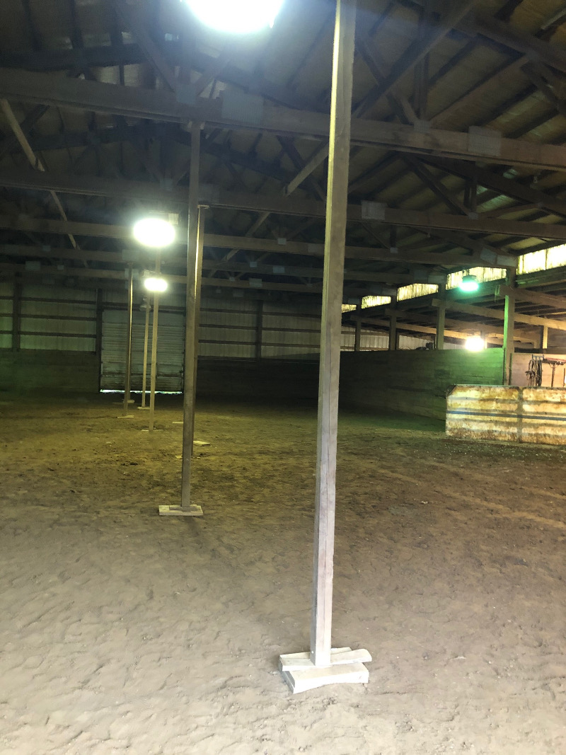

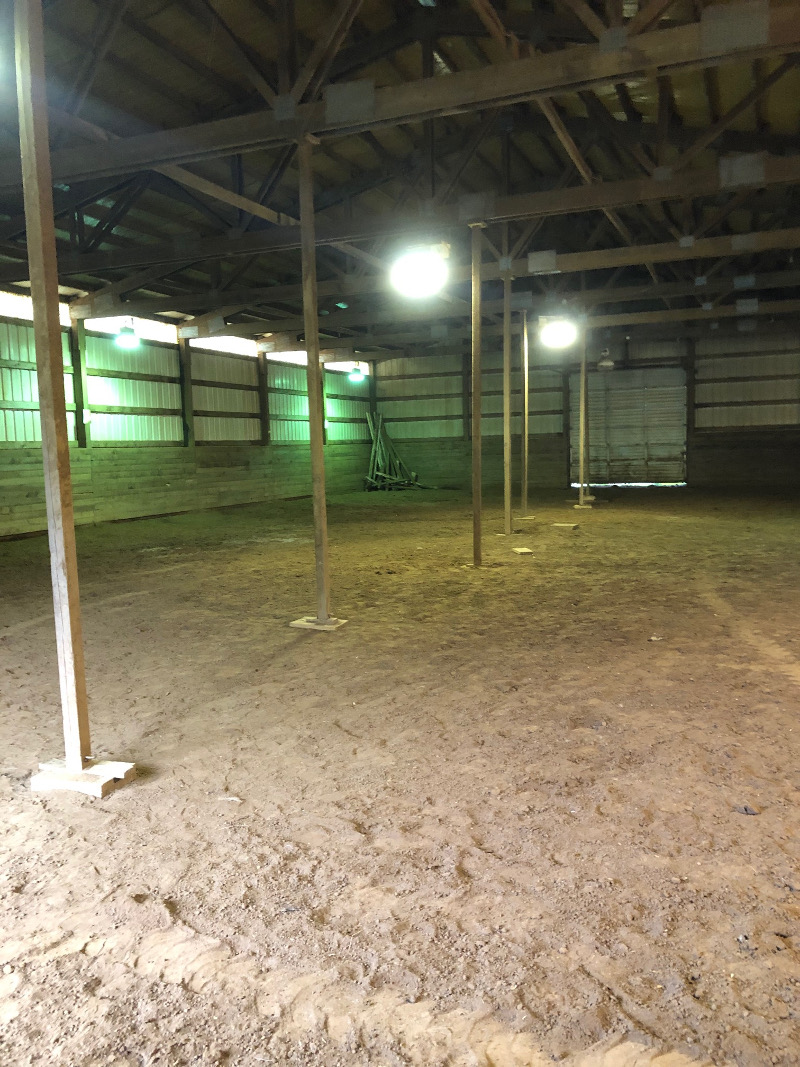

Spent several hours today getting hay in for the horses.
Dropped the snow poles down in the big arena (Center posts that can be tightened up under the king pins on the 60' wide trusses.)
But just finished dinner.....let it rip....

Weather dudes laid it on us with possibly 2 feet of snow.....
OK
The Son in law was handy so we set the safety poles in the Arena.
Back in 2008 we had nearly 4 feet of snow on that roof and it held.
Every other arena in the area went flat...
Takes about an hour to unhook the poles and swing them down.
Then lay down some 2 x 12 on the dirt and wedge things up tight.
We put the poles under (Or nearly so) the trusses king pin.....
The holding capacity soars with this trick.
After doing the math on what sort of weight was on that roof back in 08 it is scary.
A couple really lovely barns were destroyed in 08.....
It did not have to happen.....a couple hundred bucks and a bit of time rigging things
