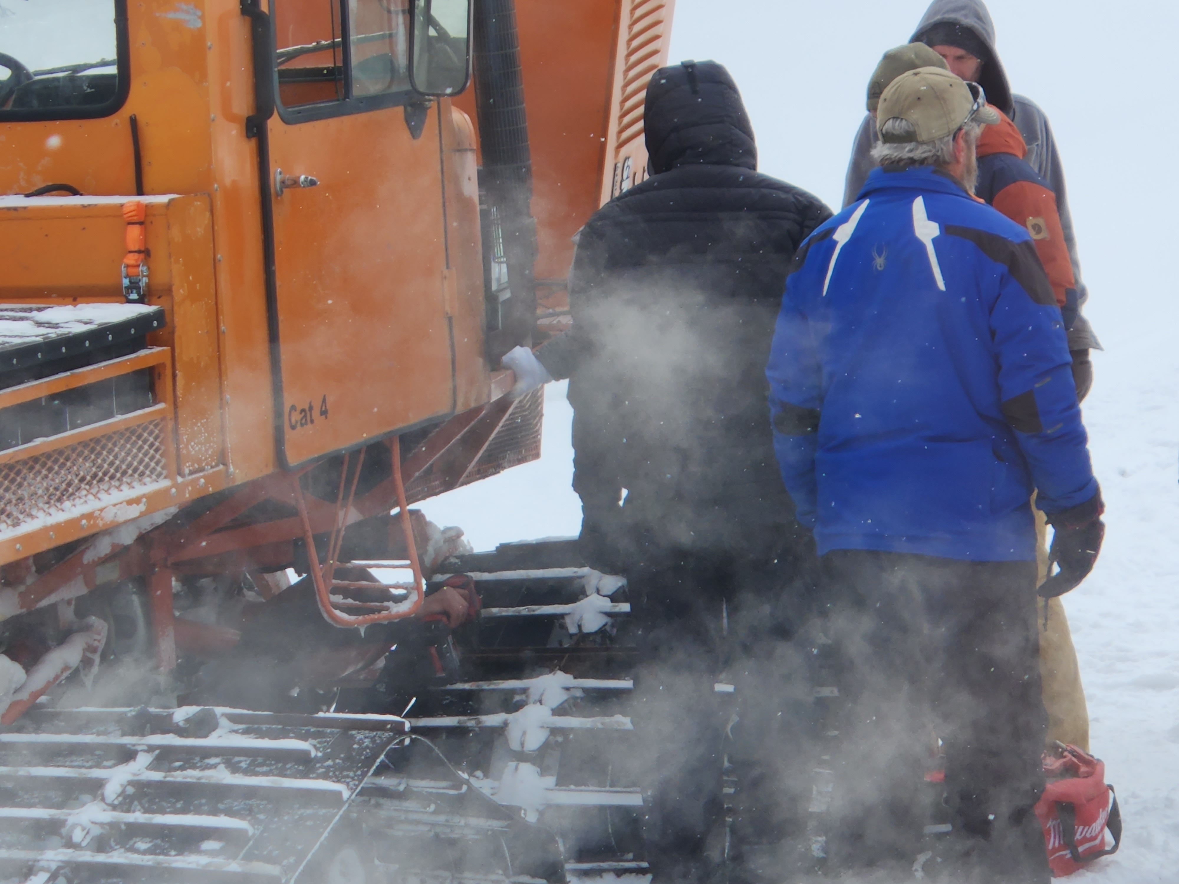

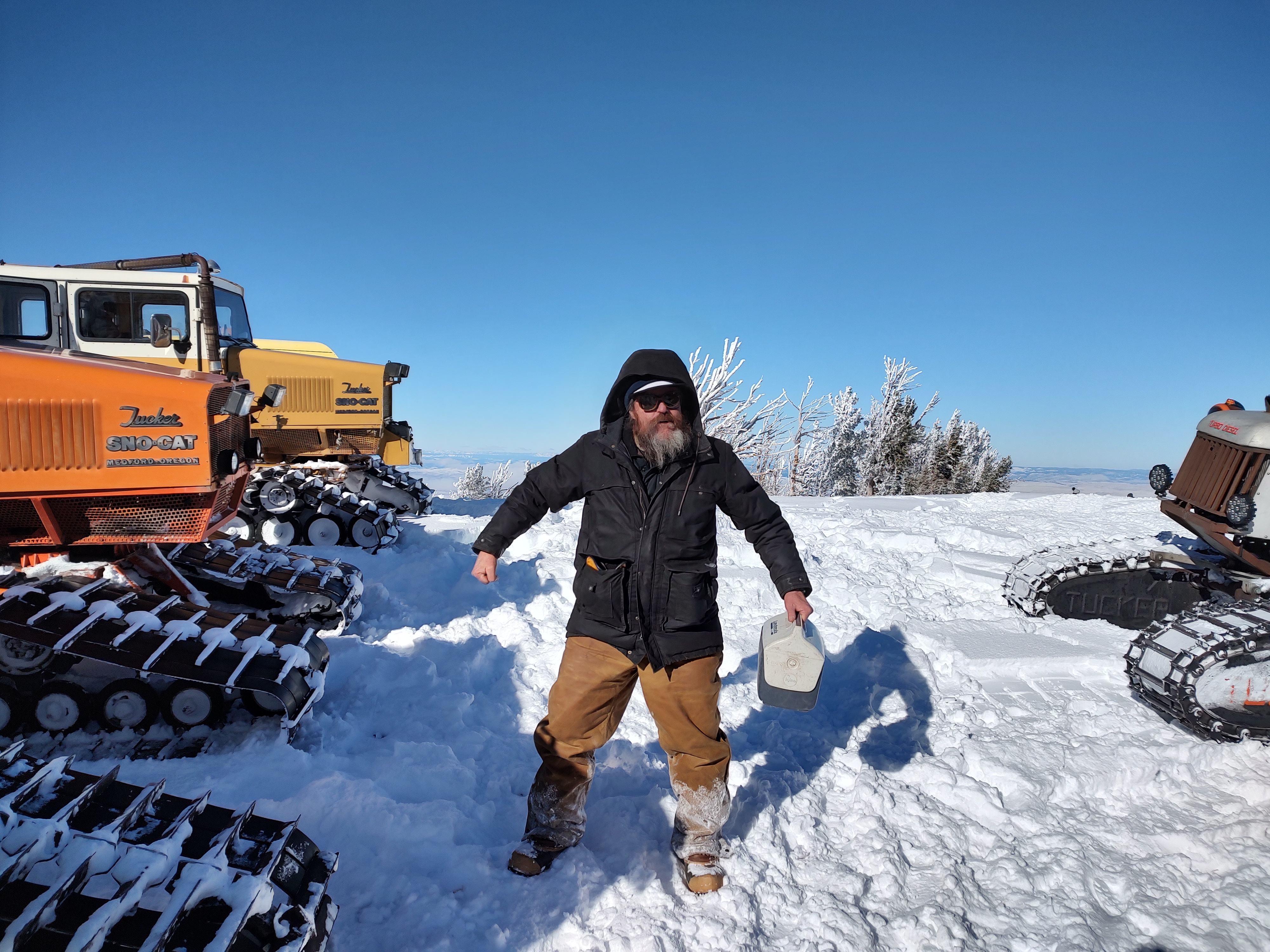

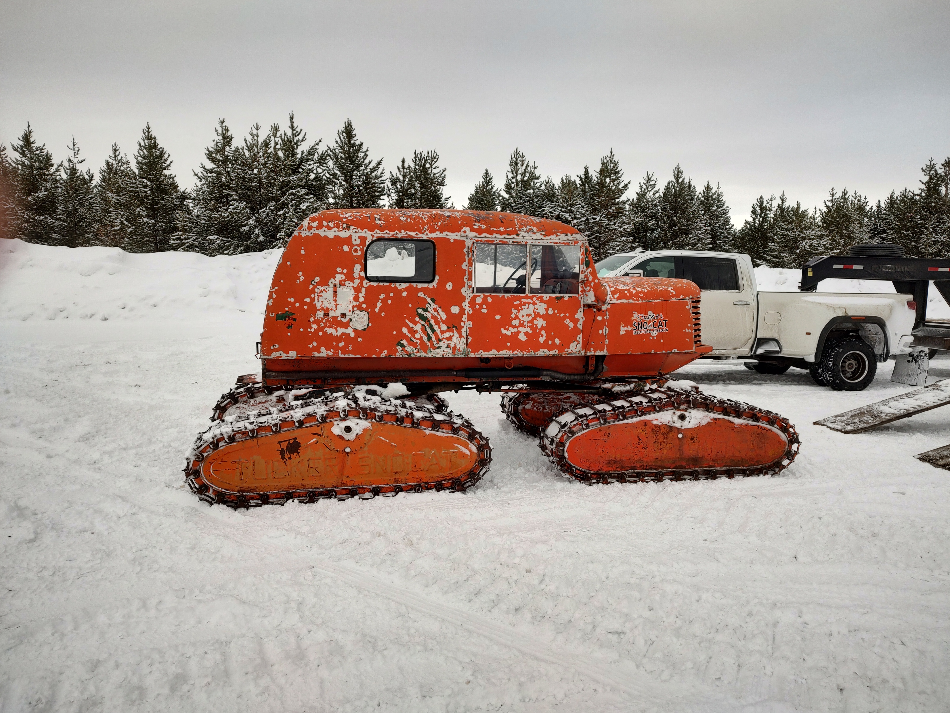

Which cat are you working on there? That looks like the six belt set up and same style grousers as Squatch. I thought I had the only wide track Tucker in the pack.
I was wondering myself, The curve in the next grouser kind of answered my question, but I am wondering how that style is holding up over all.
