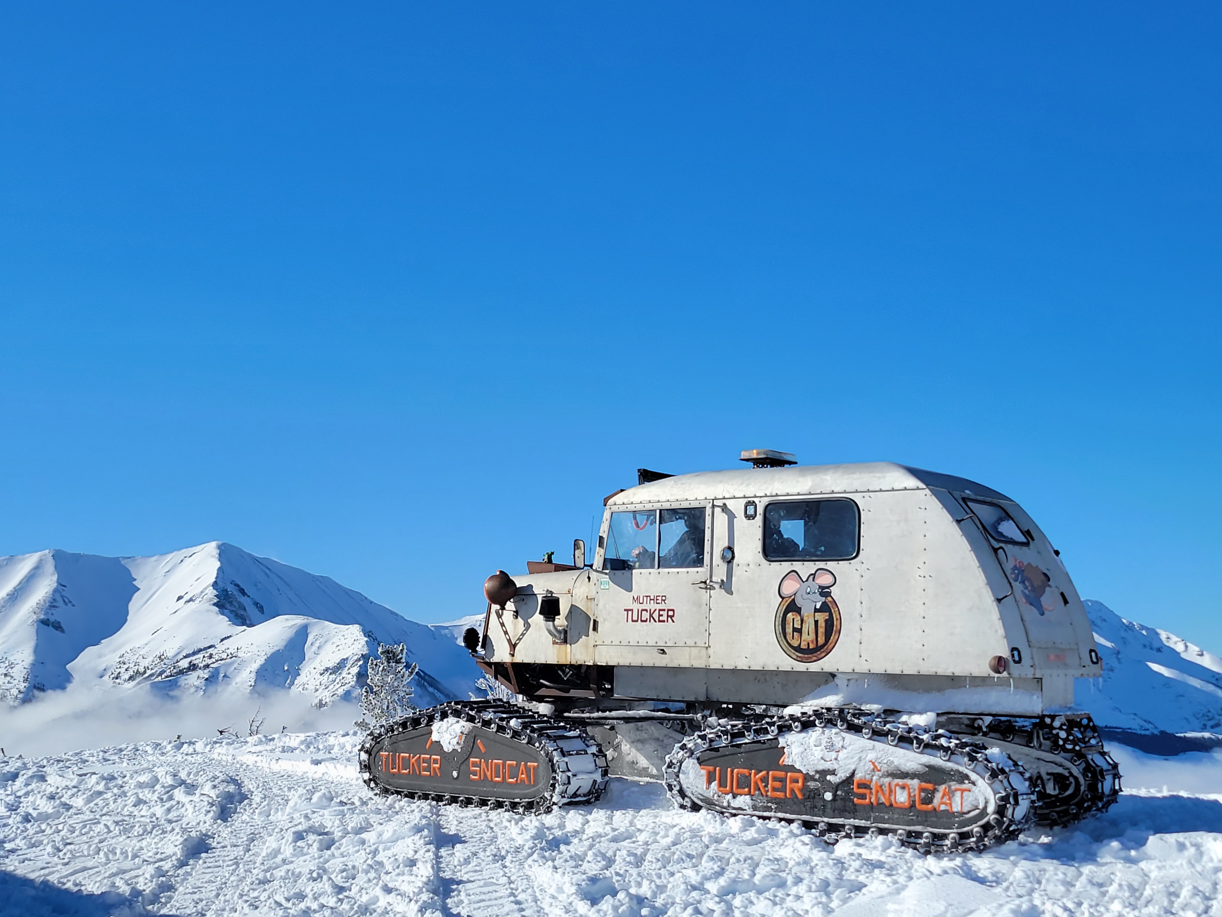

How can you own a Tucker like Muther TUcker and not have a smile on your face all the time?

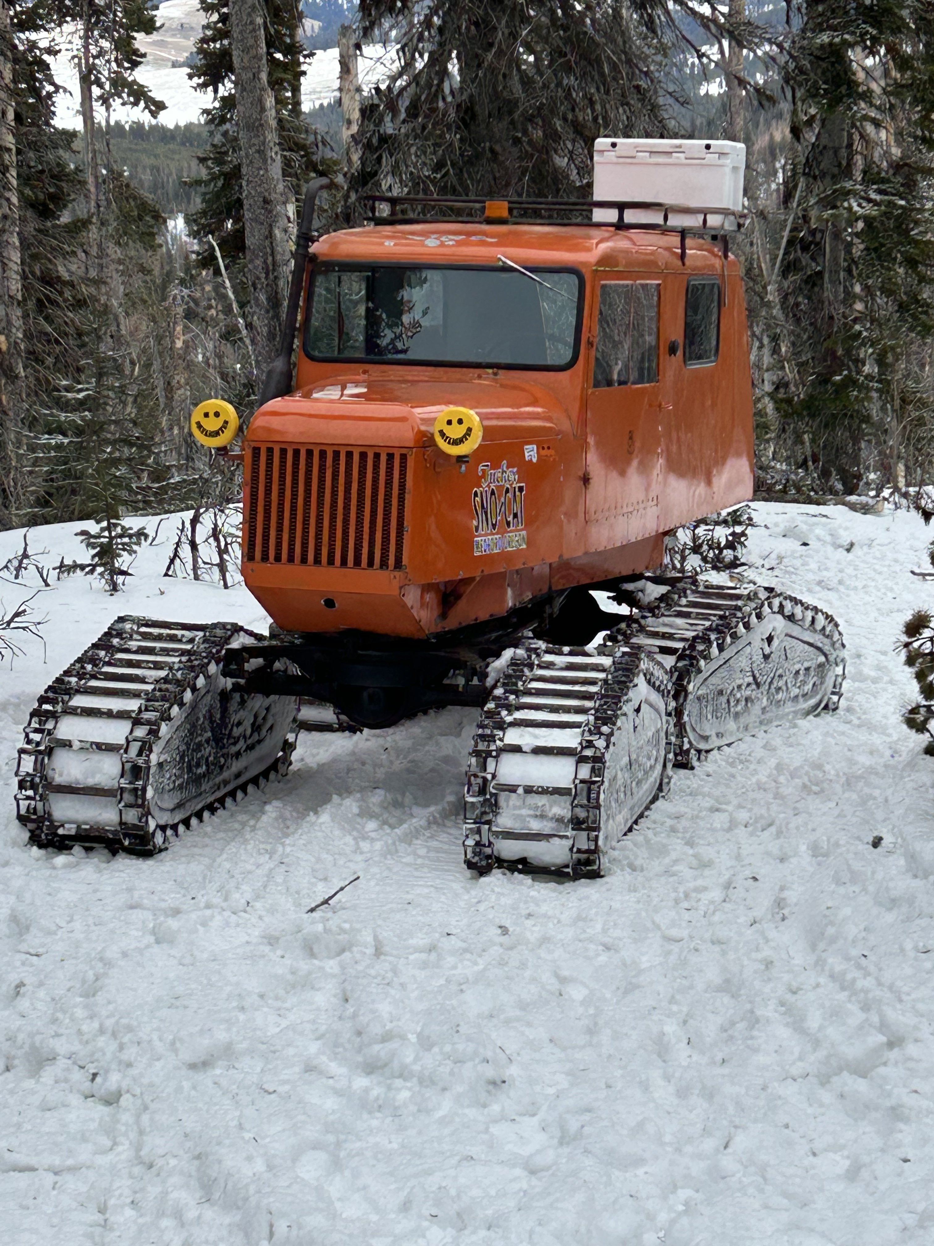

I will start with the Rockin' BK, this cat was impressive this year, had a newly rebuilt rear axle housing, much better than the one that was determined to be bent and tracking crocked last year. Sure tracked well this time. This cat also found out that proper tensioned tracks sure make a difference. I had a track tightening tool in the Kitten I had made and lent to them, from what I heard they got those tracks a rolling much better. However, I heard that at one stop they noticed one roller had been donated to the snow gods, good thing he had a spare to pop on. If anyone is driving up Mt. Howard next summer, keep your eyes open for a 3/4" roller with a missing nut. I also heard that his 3 on the tree stopped working, luckily he brought along his master mechanic and in just a few minutes they found that a pin had dropped out of the shifting linkage and a repair was completed.

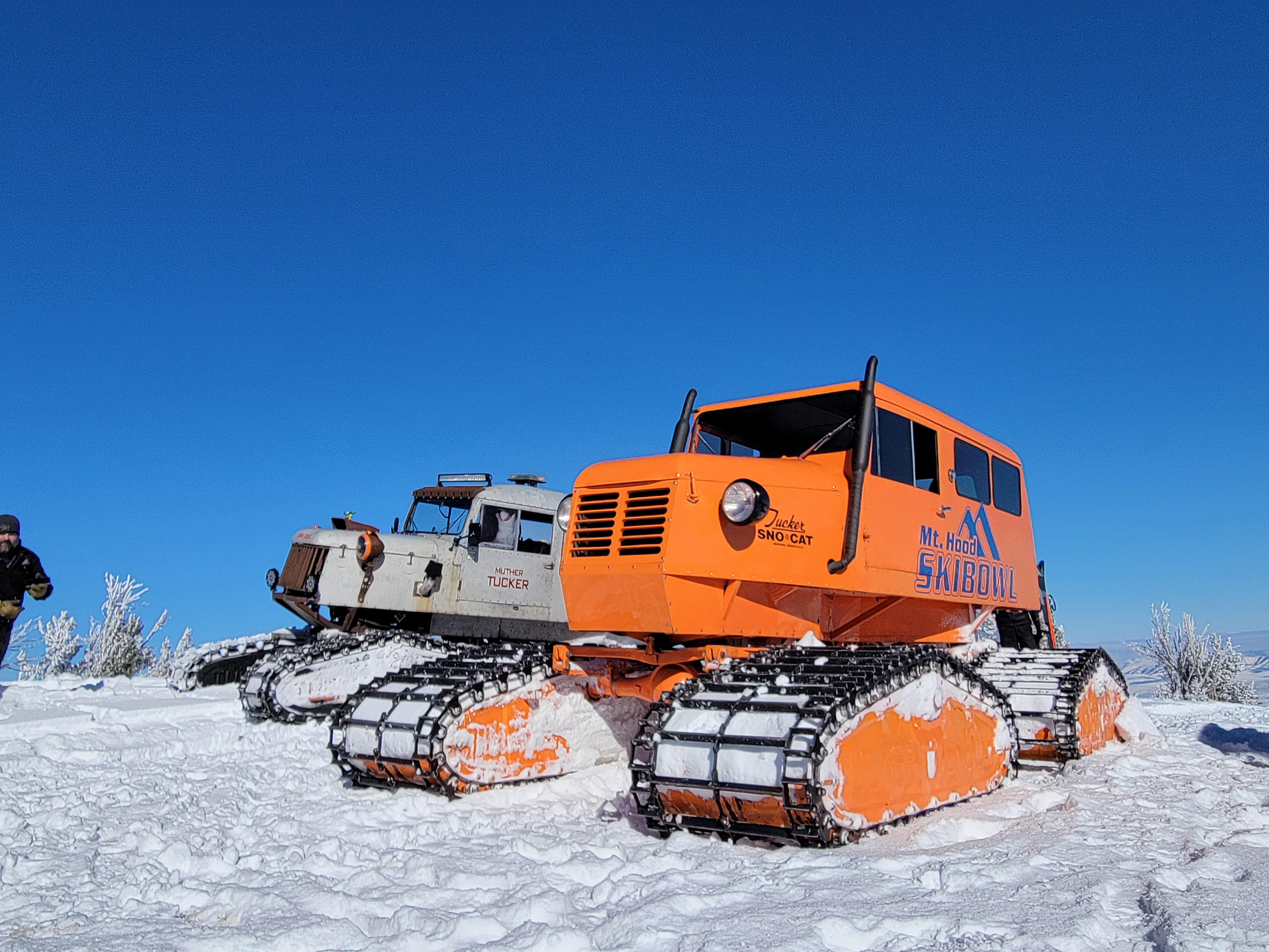

Jakes Tucker broke a grouser going up Mt. Howard, and luckily he had a spare with him. We stopped the Cat Train and did a quick changeout, thanks to a bag full of cordless impact wrenches (man are they a life saver). I heard he had another one break, but it did not cause a problem. From my understanding this cat is a one off proto-type, I had never seen grousers like these before, but they sure seemed to work just fine.

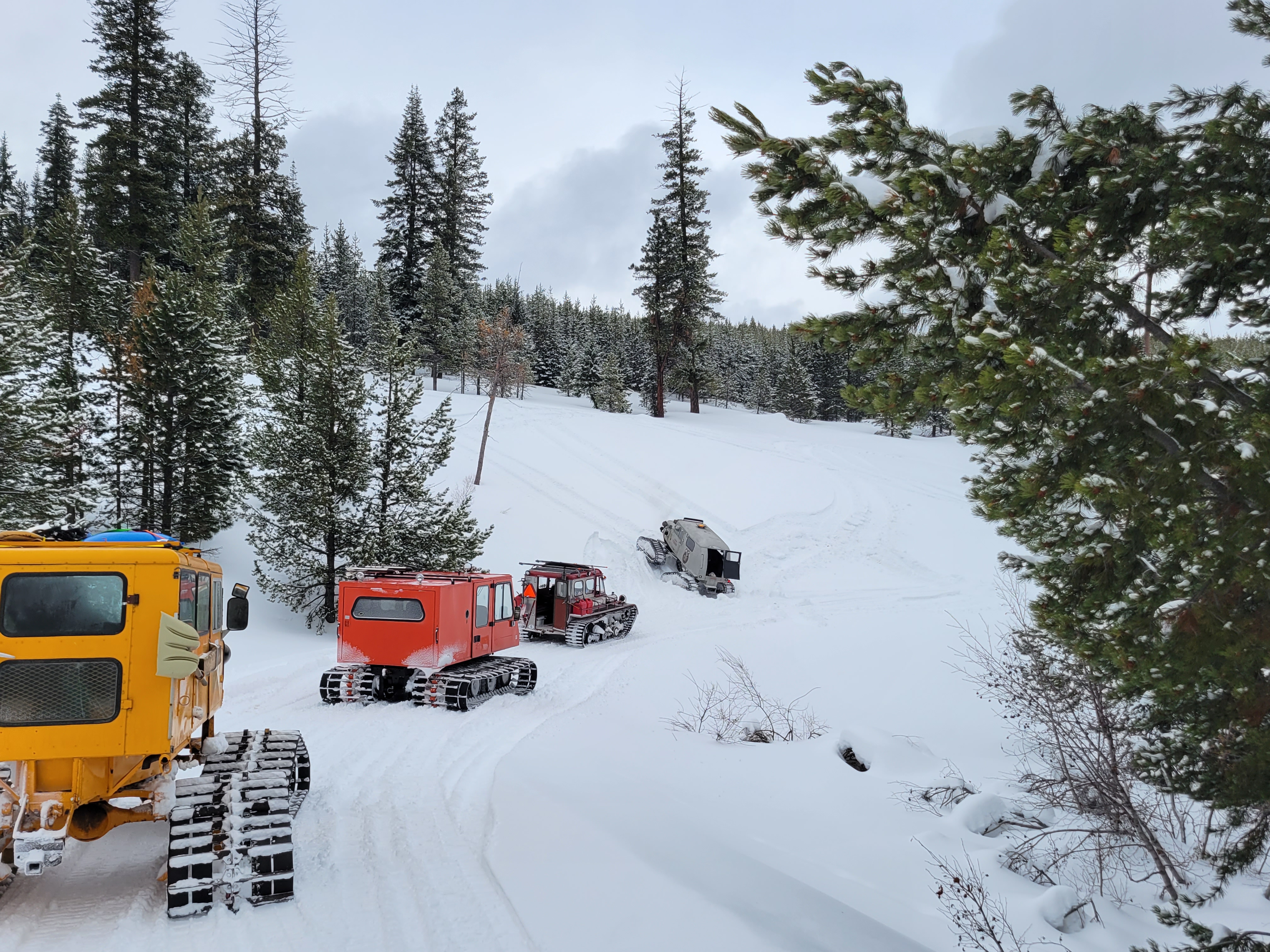

Seths SnowMaster. Wednesday night before leaving for the Jamboree Thursday morning he had just completed rebuilding and installing the engine. He maybe had 15 minutes run time on this cat before heading for the Jamboree. First day out and within a couple miles the cat just completely died. Issue was a failed brand new electronic ignition. Seth and the family abandoned the cat and road up Mt. Howard in other cats. Then on the way back Dan's kick ass Tucker towed him back to the trailer and helped get it loaded. Well that is not the end of the story, Seth comes prepared, he had a complete spare cat on his trailer and that night in the parking lot he and several others (mostly Jim the VW expert) pulled the points distributor out of the spare cat and installed it in the newly rebuilt engine. Problem solved and Seth had a great time the next two days tracking up the powder.
