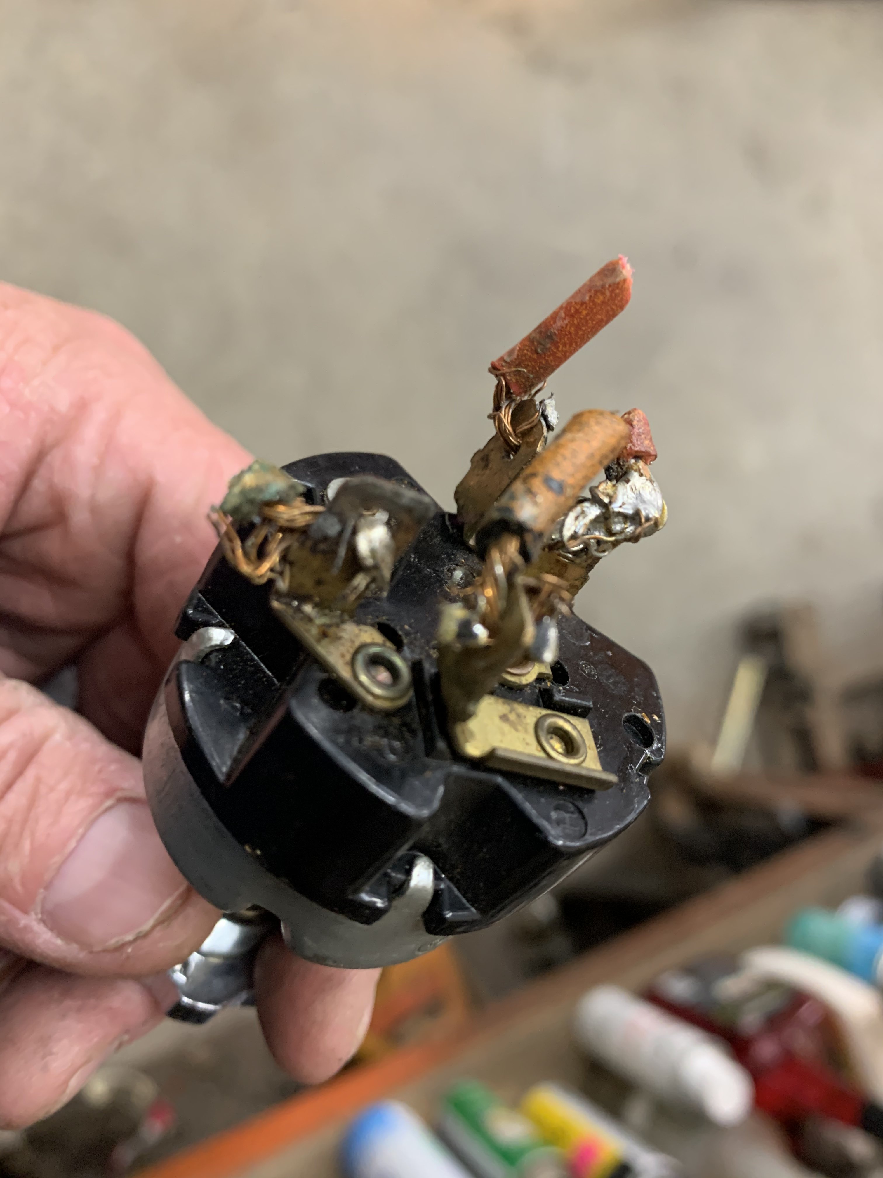

New wiper switch installed and the motor is still drawing. Very little leakage from the park circuit. Low speed also doesn't work motor moves a little when wet window but won't dry. The motor is tired and has an issue. I left park wire off and the draw is gone for now. Poor solder job also.
If anybody has the motor part number in advance of the hunt I'd appreciate it.

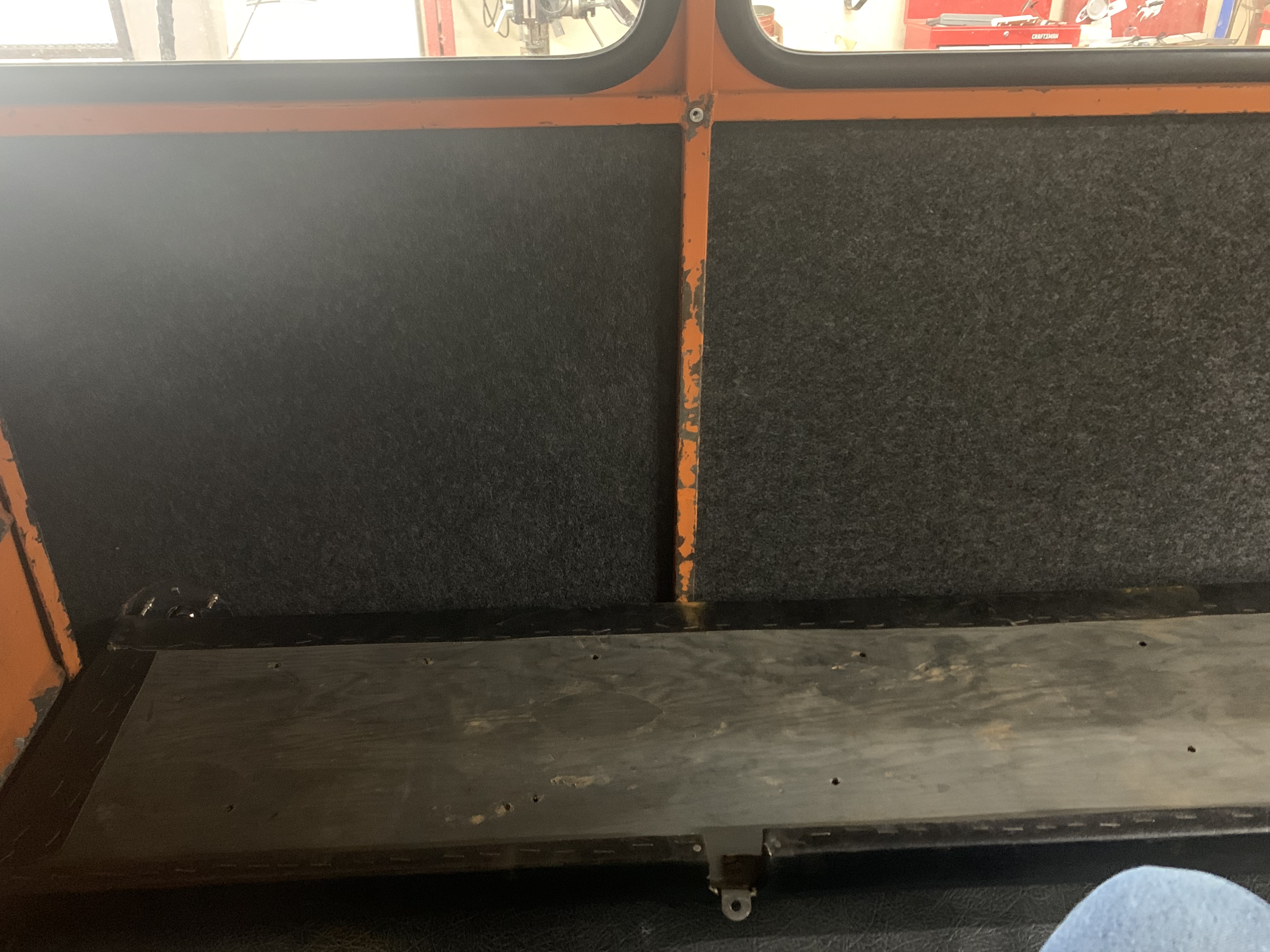

Fixed the rear seats with a rivet rivet nut utilizing the economical factory mount. Setup also sits nicely up on the frame and would have been a better design. Don't like adding holes so put back as built

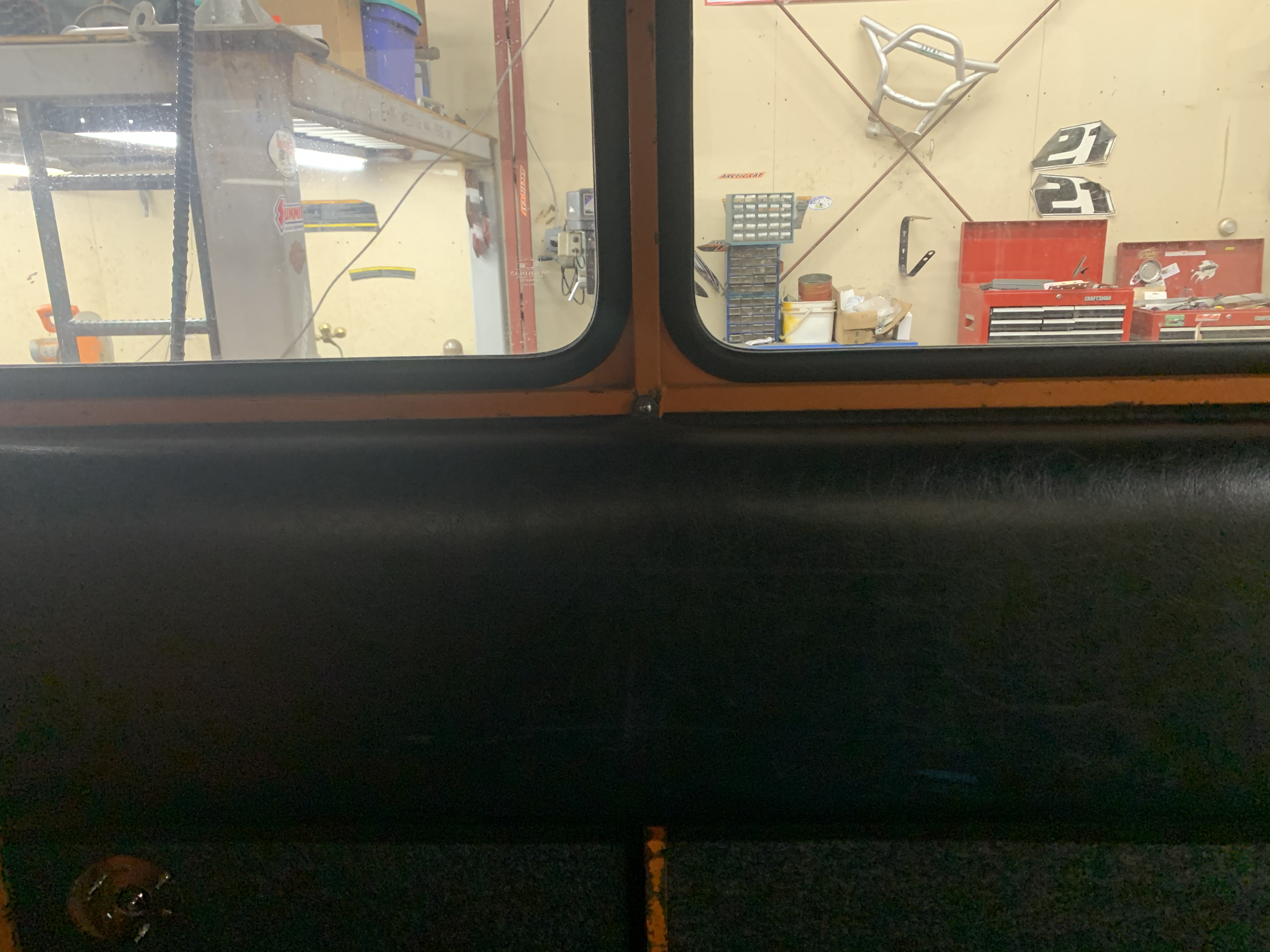

I have removed the rear steat backs and glued 3/4 inch refrigeration closed cell ( Armaflex) between the 3/4 steel tubing. Makes for much better seating comfort, more cheek on seat. More cab room.

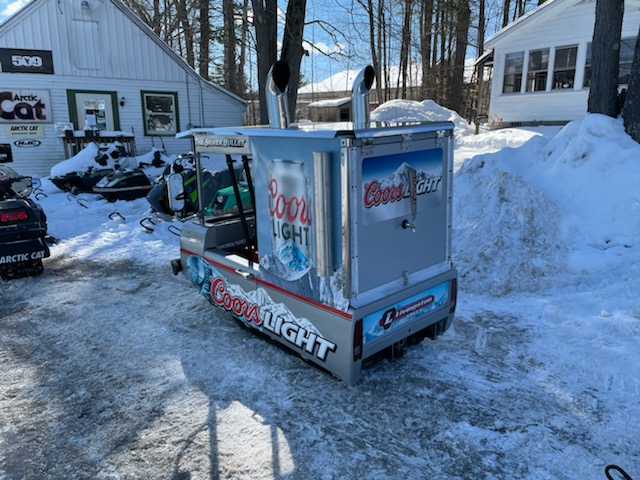

Mercury 3 cylinder turbo diesel sled was interesting. The mobile kegerator served us well.

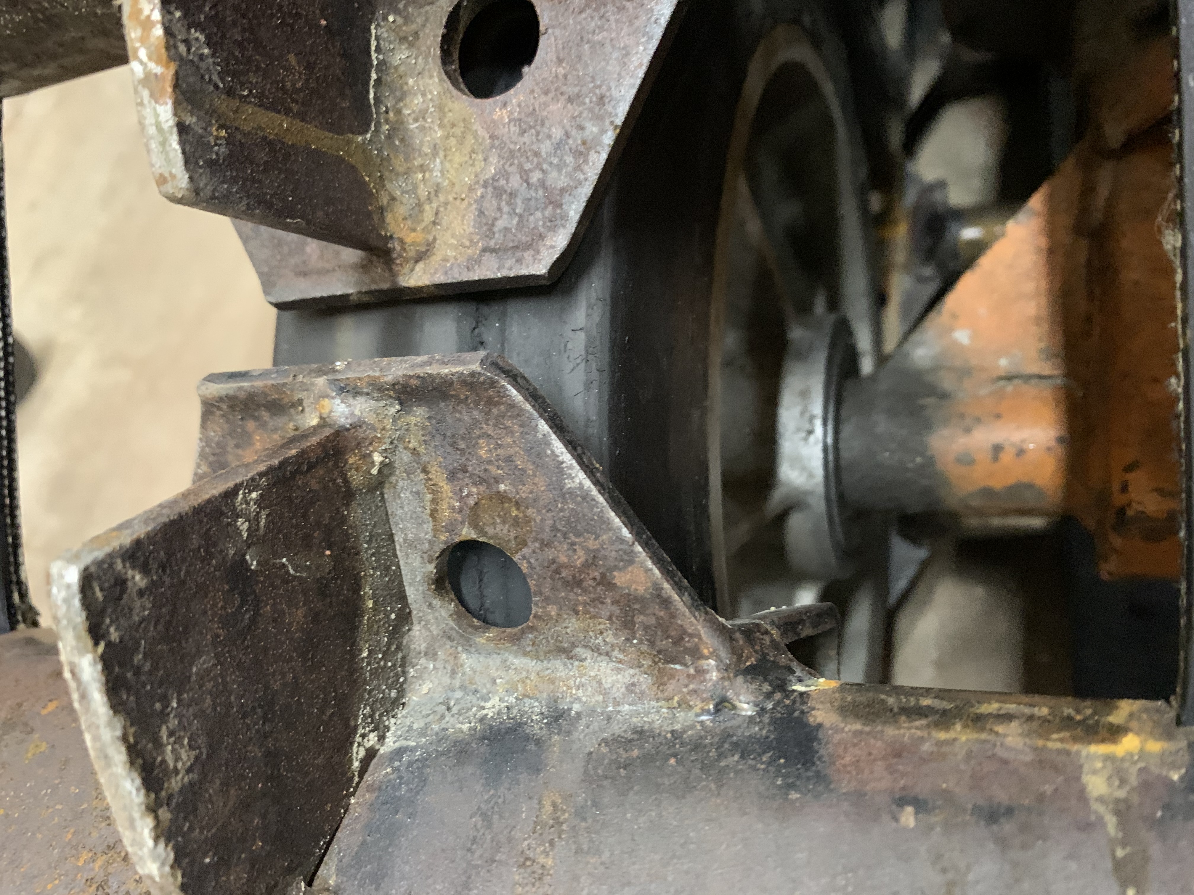

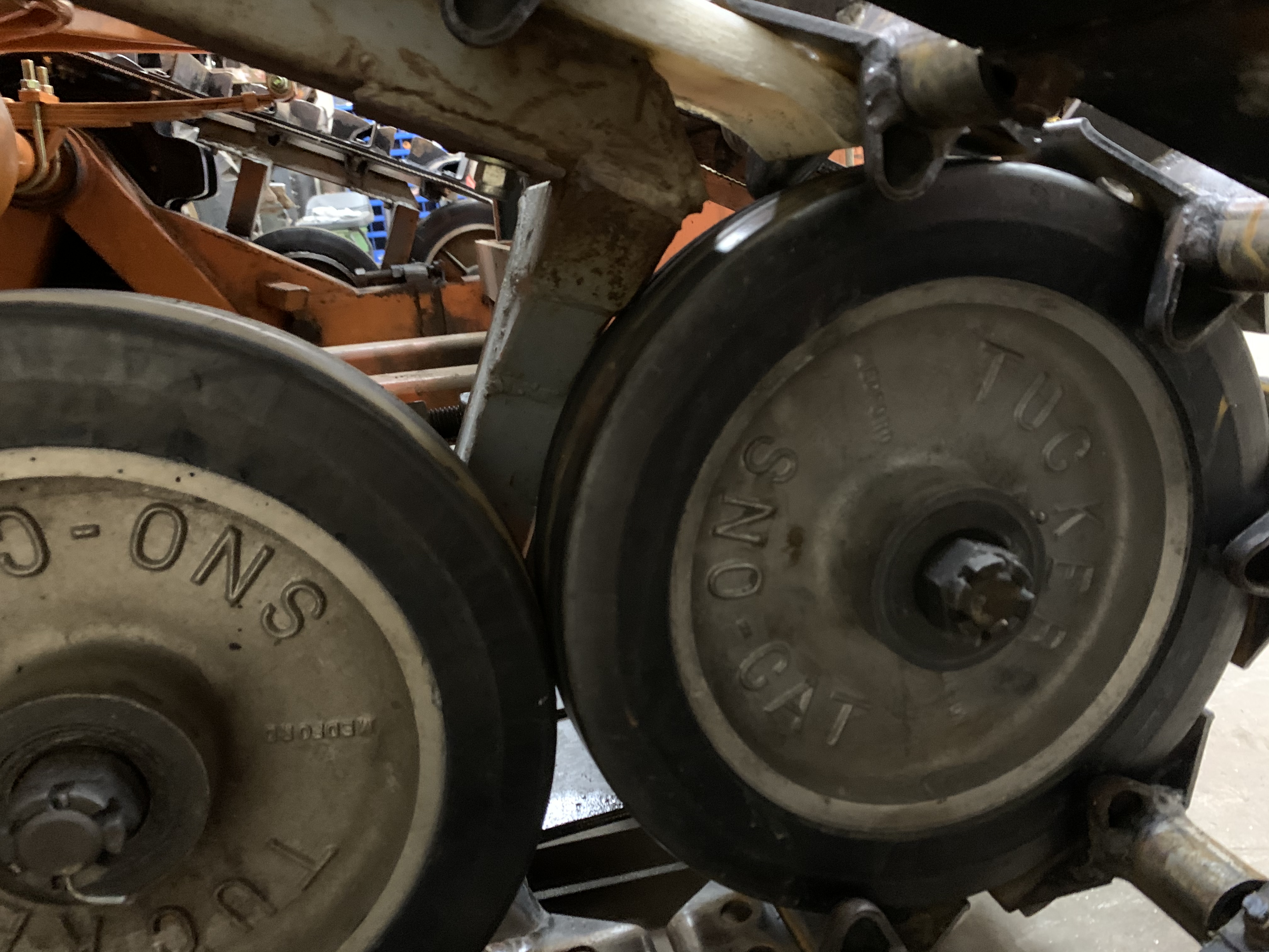

Winter motors sports season is wrapping up with the recent warmth. Looking the cat over after last trip the passenger front adjuster idler is hitting the hyfax support and the other wheel. A weld splatter grooved the wheel.
Will have to investigate further.

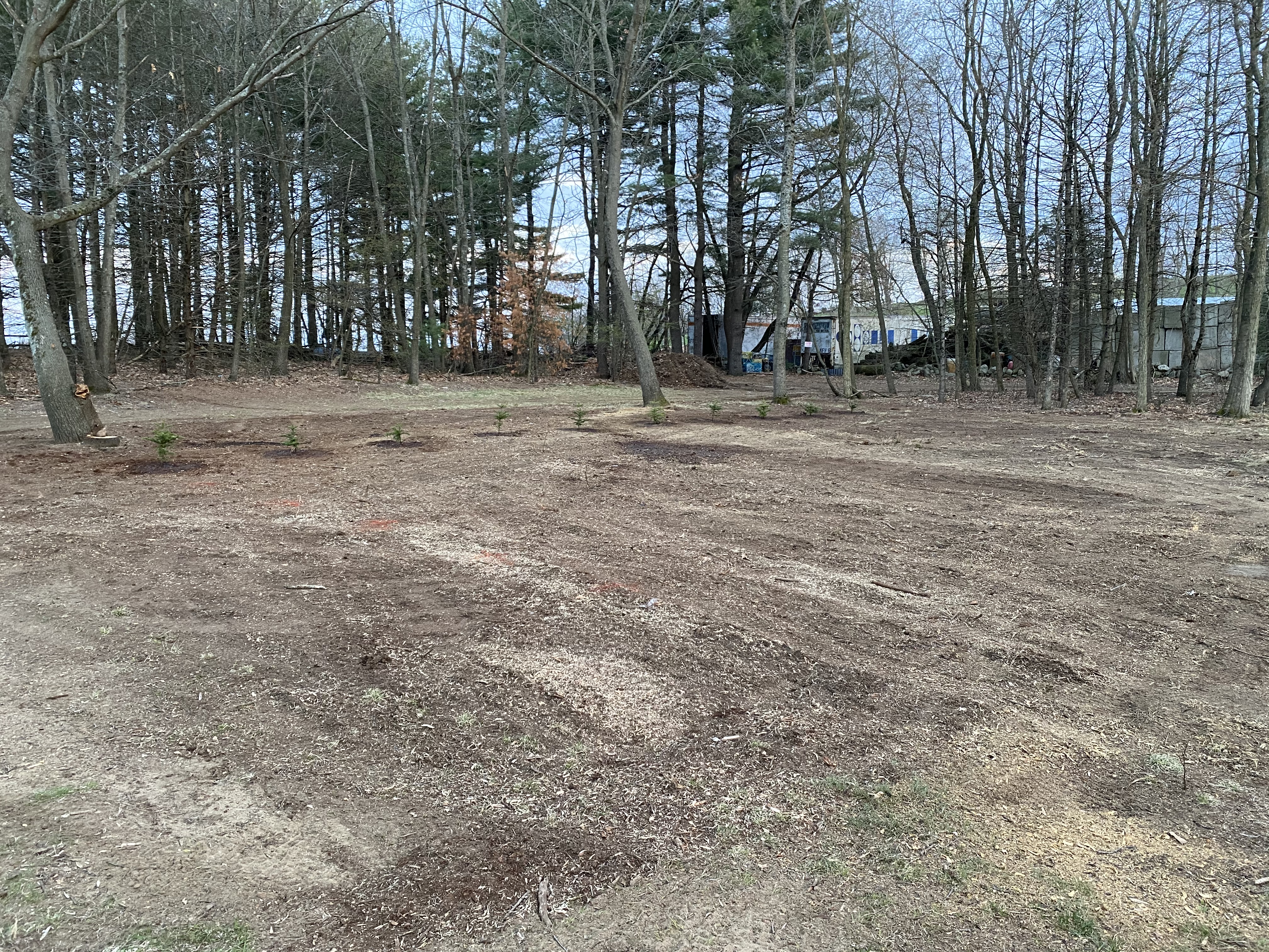

The lonely donor cat has been forced move as progress happens around it. Replanting great grandfathers Christmas Tree Farm that has been long dormant.
He died before I was born and the farm stood still from 1977 on. For many decades we were able to harvest trees until it became over grown. I have since cleared hundreds upon hundred of trees abandoned in seedling rows.
Finally cleared enough land to start with 60 Fraser Fir and White Spruce and have sourced enough child labor. White Spruce is not used much any more but was common back then and what remains on the property.
This investment will provide more visual cover crop for Tucker Sno Cat and vintage grooming implements while keeping the wife happy. As her vision declines I can start adding the junk closer to the house!
