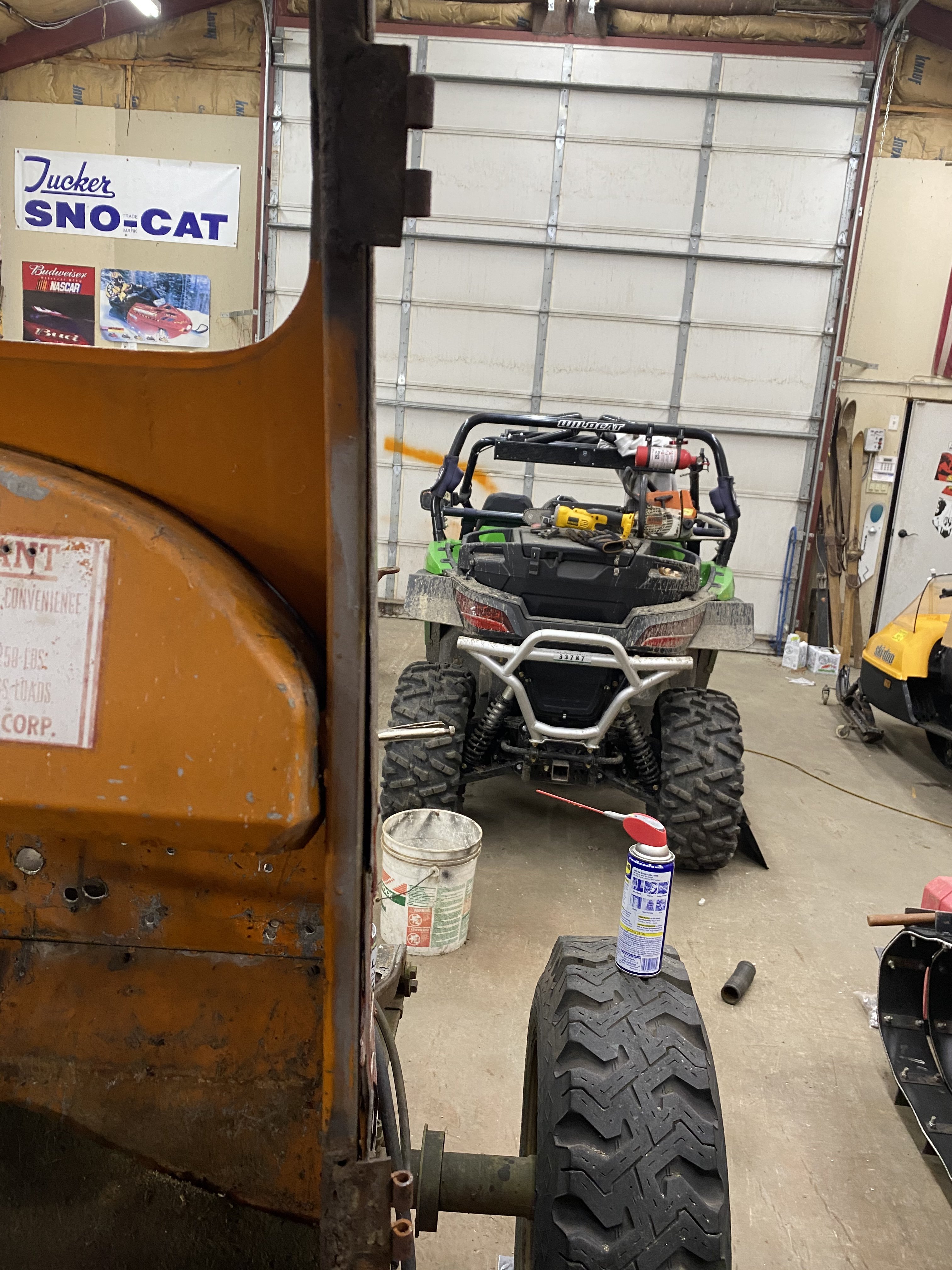

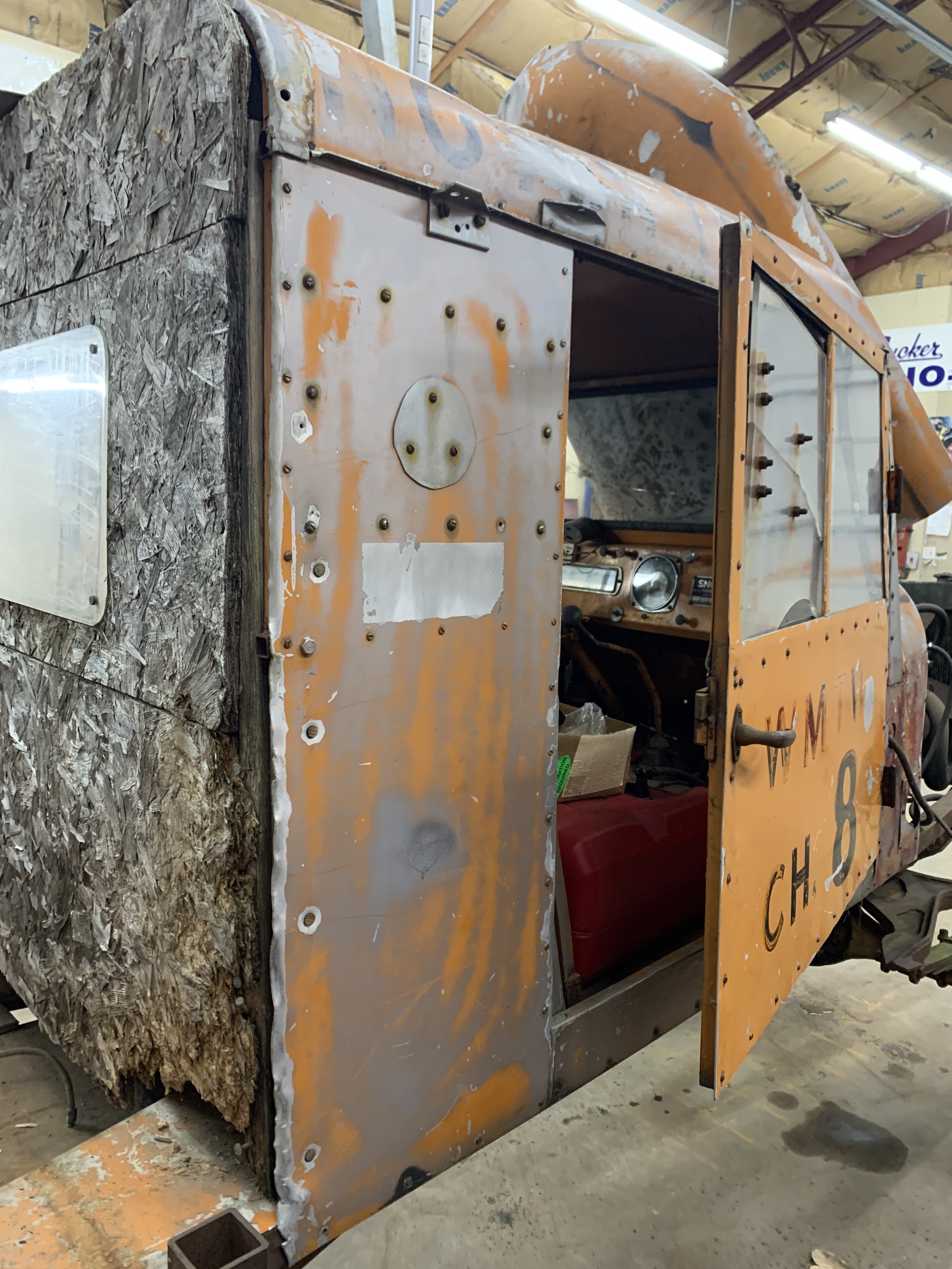

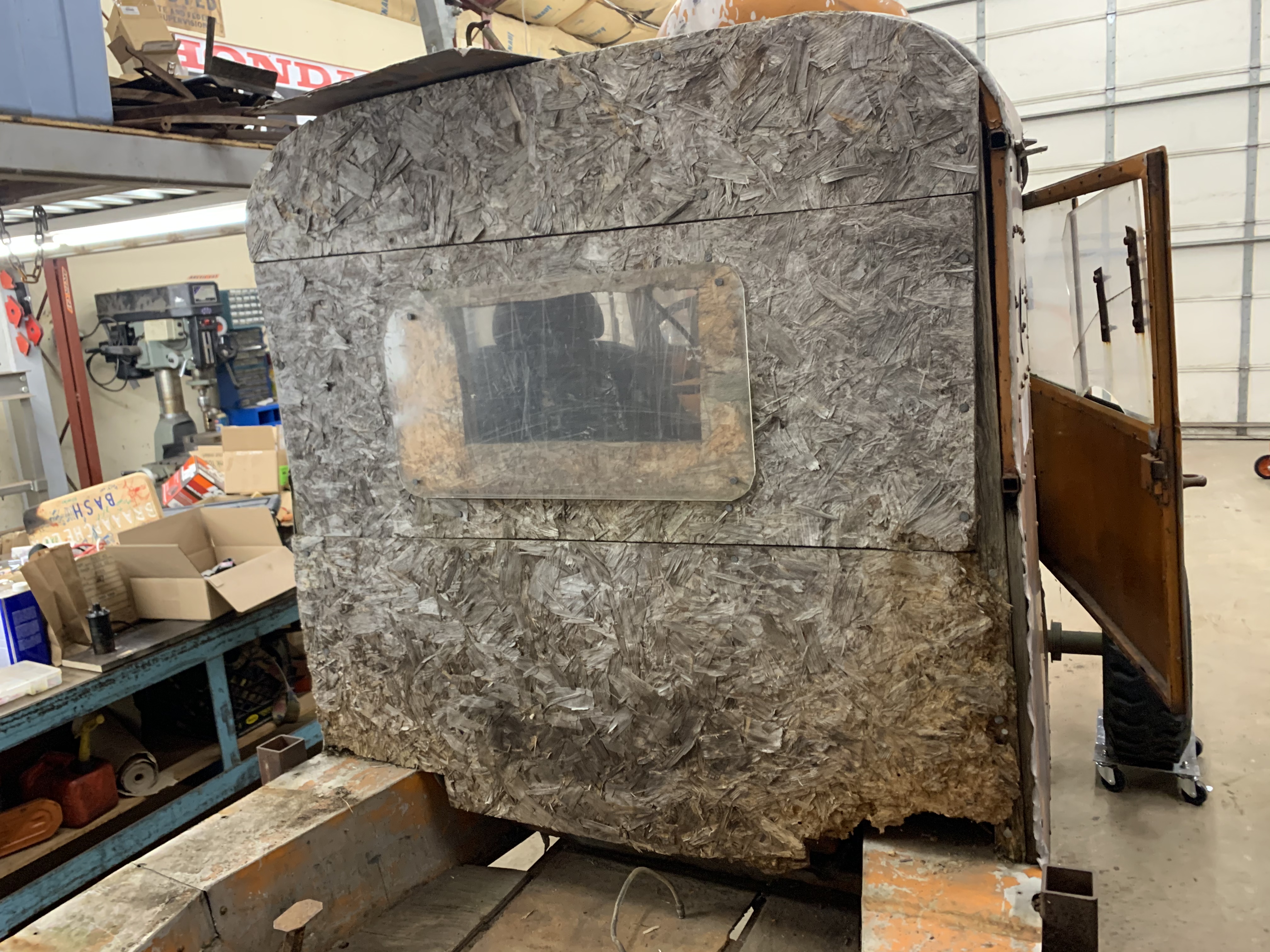

Moved the project into a better working position.
Notice the roofing nails holding panels and the sweet OSB back. Shotgun slug through the hood and firewall.
Plan is to strip it down bare bones and deal with the frame them start making it a restored rolling chassis going through the running gear. I'll rebuild the motor as that happens overtime. By the time that's done hoping the body tracks and pontoons will appear!
Frame will need some significant repairs due to typical rot.

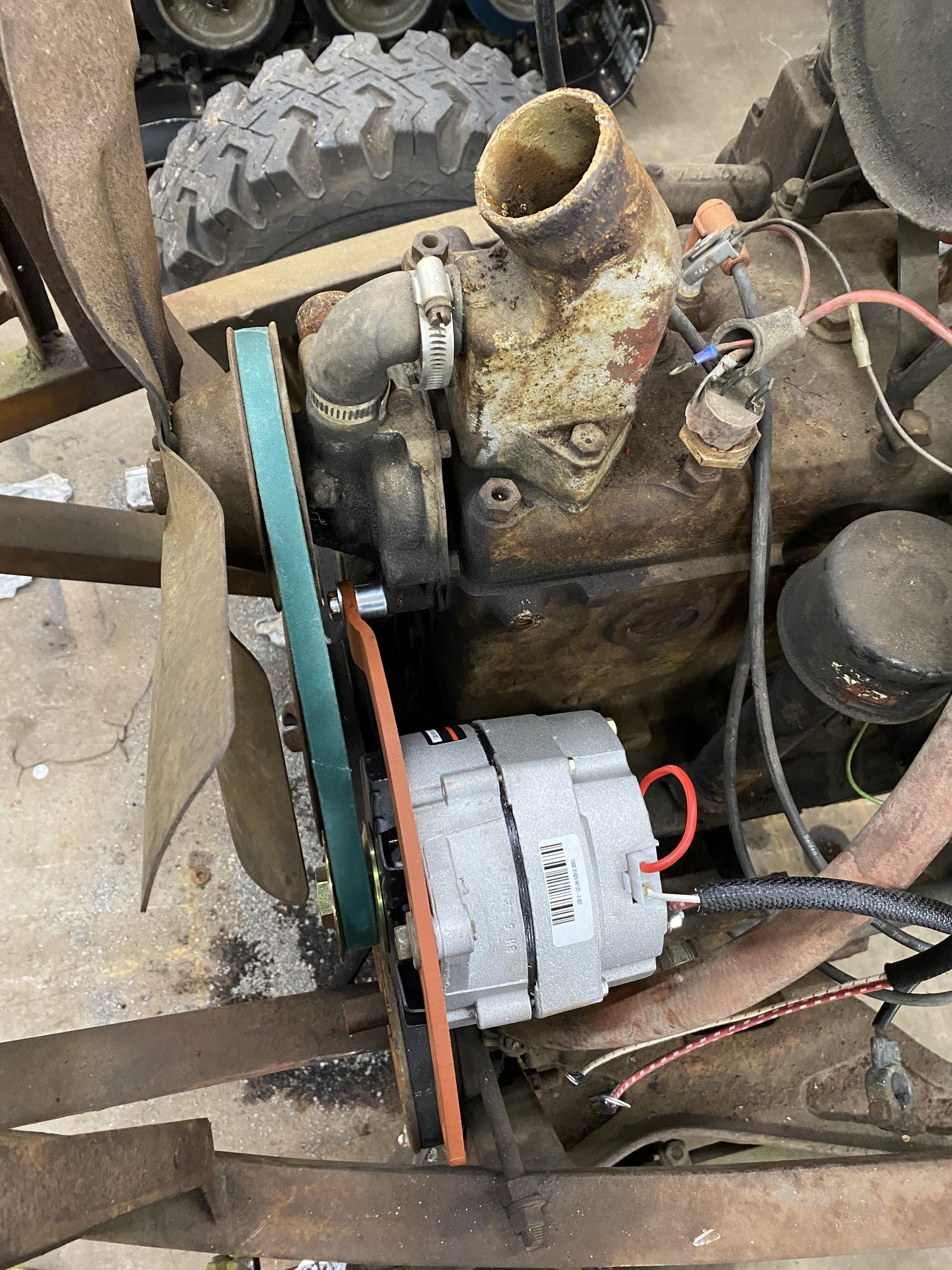

Vintage Power Wagons has solution that uses clean brackets and internally regulated alternator. Now with correct 5/8 pulley. Swapped the junkyard brackets out for this one.
Need to make a spacer for the upper mount but great solution.
Alternator mock up complete. Clean and simple with correct pulley size and belt. Needed to add 5/8 spacer to align from the intended power wagon application.
The water pump bolt holding the adjuster bracket is in the water jacket so will need sealant. When adjustment for the belt is needed, that bolt needs to be loosened and tightened which is probably ok but...
A better setup would be a stud and nut maybe welded, then a washer. then adjuster bracket and nut/lock washer for final product and belt tensioning.
Clearance behind the pulley is tight with the setup. Will finalize during engine rebuild but should be workable.
Was able to shorten the belt to gain clearance from the suction hose. My guess is the generator originally was not as wide. 5/8 x 50" final belt length for this setup.

Pulled the OSB mess out, removed the hacked in incorrect cab heater, fuel tank, and more body panels and screws.
There was a radio/CB antenna on the passenger side and brackets that must have held the WIP. This cat had a roof rack which one bracket may have supported?
No viseable holes in the fuel tank or areas that indicate a leak. Looks like the nipple broke off at some point and the tie down brackets were loose so somebody did something Looks to be repairable.
The panel below the door shows the result of years of untreated steel and aluminum making contact. We will fix all that.
The dash, and firewall frame can be reused. Swiss queso firewall will be replaced.

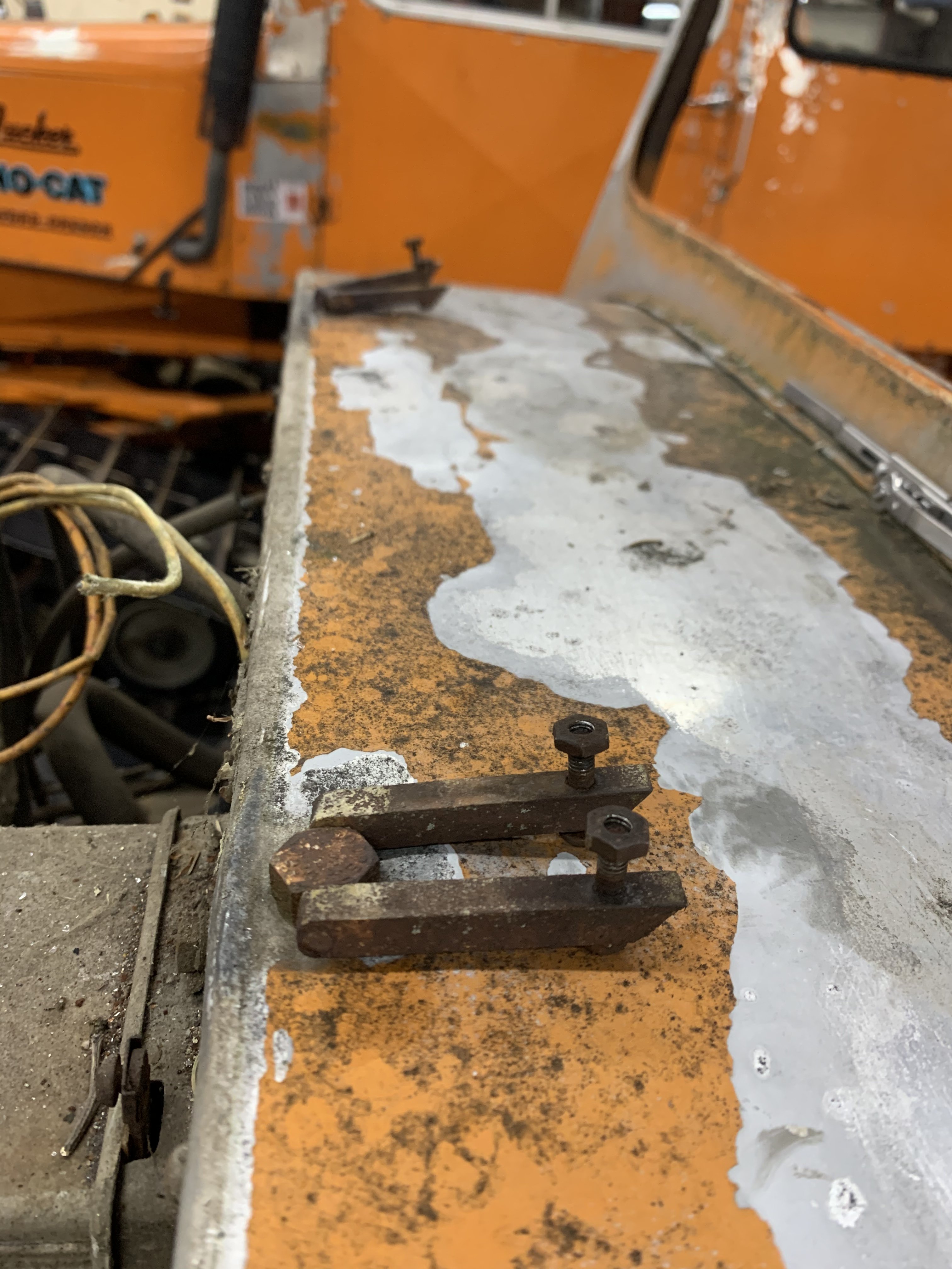

Requesting input from our resident Tucker experts....
It would appear that the original hood had no latches on each side and instead used this center latch. Looking at the hood damage the center latch froze/stuck/broke in life causing the damage from heavy winds up on the mountain or trailering like others have experienced or frustrated hood openings.
Traditional Tucker hood latches must have been added later if not redundant and damage was caused by lazy.

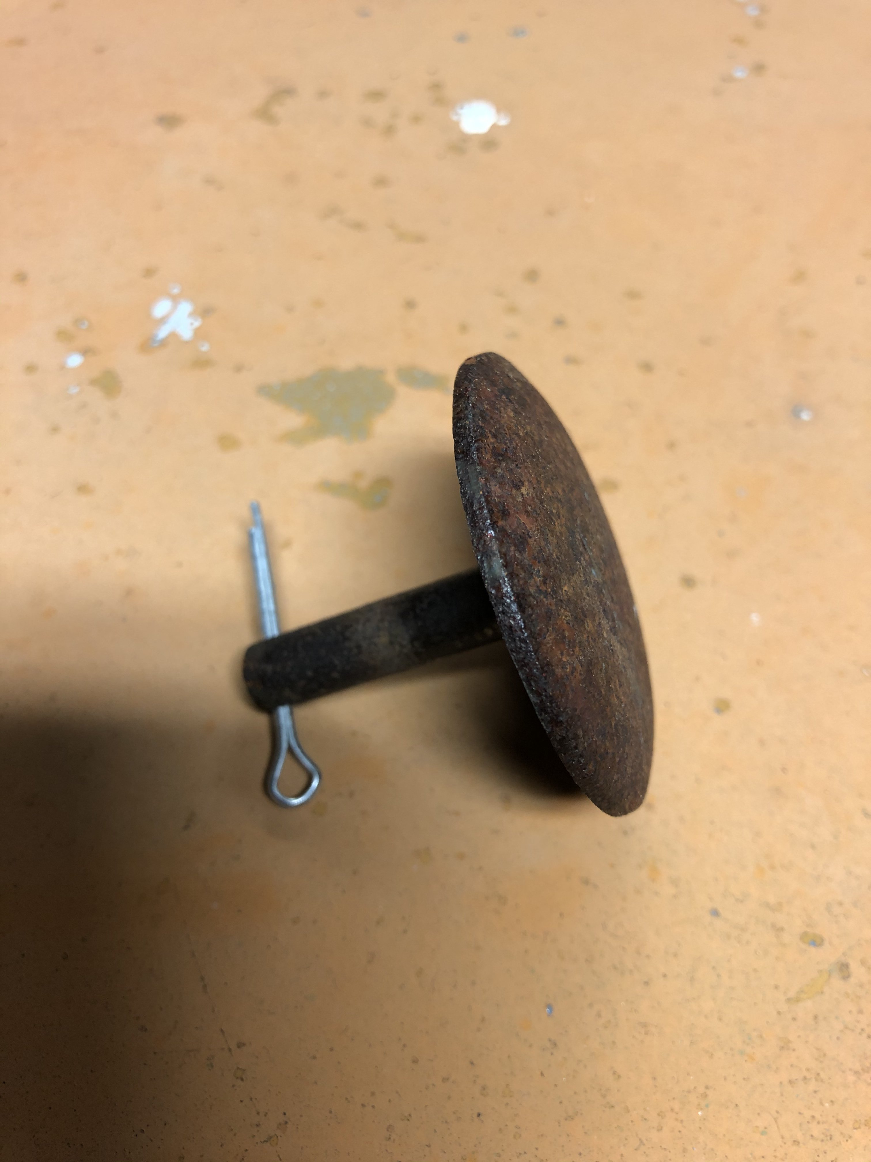

The latch seems simple but I can't figure out what the release should be. Spring loaded bolt with a nut welded on the end fits the style?
Here’s the latch on a 54 kitten
Your design looks a little different - looks like it’s already sprung to return and you just need a bolt with a button on it to cycle it - looks like your bolt is broken off right at the face of the bar
