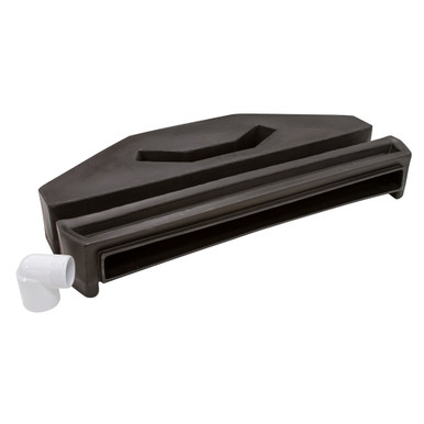

Here is one I'm considering
Product Details​
Blue Thumb Elite Spillways are great for starting a pondless waterfall or meandering stream. Unlike waterfall filters, this spillway is designed to only provide a pooling area for water; this is not a biological filter. Made with strong, durable construction, the internal baffles spread the water evenly over the spillway so you enjoy the sights and sounds of falling water. This spillway is compact so you can easily disguise it using rocks, boulders or mulch.
Elite Spillway 28 Inch
ApplicationSpillway
Box Dimensions32"W x 15"D x 5"H
Spillway Width28 Inches
Max Pump FlowUp to 7,500 GPH
Inlet2-Inch
Model No.PB2866

Is there any kind of slope to where you want this placed?
If so I have shown how to do this very easily for a reader. Is there a self contained "catch pool?" Assuming this has no "catch" pool you have to dig down for the one you choose.
7500 GPH is a lot of water. You might want a fairly large catch pool. And a lot of noisy water. Or is it 7.50 GPH? Tha's a soft dribble. I have a 60 GPH on my water feature. Plenty of sound. Not much effect on the electric bill.
Establish the center of where you want it placed and find a high point. Dig down to 6" or 8" below grade and then affect another 5"to 10" ( depending on you catch pool size) for the unit. Place the unit forward leaving room for decorative rock behind it up to original grade. Place your catch pool underneath. Then place the decorative rock aside and below the unit. plug it in, fill it and enjoy.
If the spot is level, use the removed soil to raise the back gravel a bit.
For a natural look, remember this landscaping tip,,,; Water should never be above grade. That's called a fountain.

I thought 7500 gph was a lot also. No clue if it can be turned down for less flow, but will have to find out.

I have a 6500 GPH pump for my 6000 gallon koi pond. That was like an $800 pump! 75 would probably work for you.

7500 gph is the "rated max" capacity of the 'kool spillway'
envision a 50 gallon barrel of water being dumped . . .
done in 30 seconds? = 6000 gph
done in 60 seconds? = 3000 gph
size&dimensions matter - here's some help

"I thought 7500 gph was a lot also. No clue if it can be turned down for less flow,"
for less flow, that is controlled at the pump output (i.e. a globe valve)
within reason, one can 'throttle' the gpm output of the pump to achieve 'just right' waterfall flow.
you cannot throttle a 6000 gph pump to 1500 gph - uh,,, for long term - so it is important to size the pump capacity to the width & noise you want.
