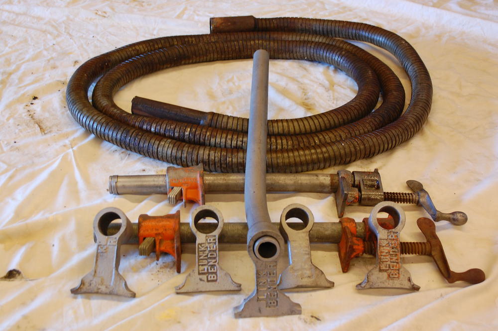

Jack pot.:wow:
To a thiokol owner that would be like finding............
Ah nothing in particular.....
:yum:
Seriously?? :biggrin:
They all look to be the old style rebuildable rollers? Also, why would they have had five link benders??:unsure: (if too many of those benders are taking up space in your shop, and you are willing to part with one, I would be interested in making a purchase in about eight weeks . . .:whistling:)
They all look to be the old style rebuildable rollers? Also, why would they have had five link benders??:unsure: (if too many of those benders are taking up space in your shop, and you are willing to part with one, I would be interested in making a purchase in about eight weeks . . .:whistling:)[/QUOTE]
:smile::smile::smile: only issue is; had to buy a tucker to get the track link bend, how many tuckers do you want?

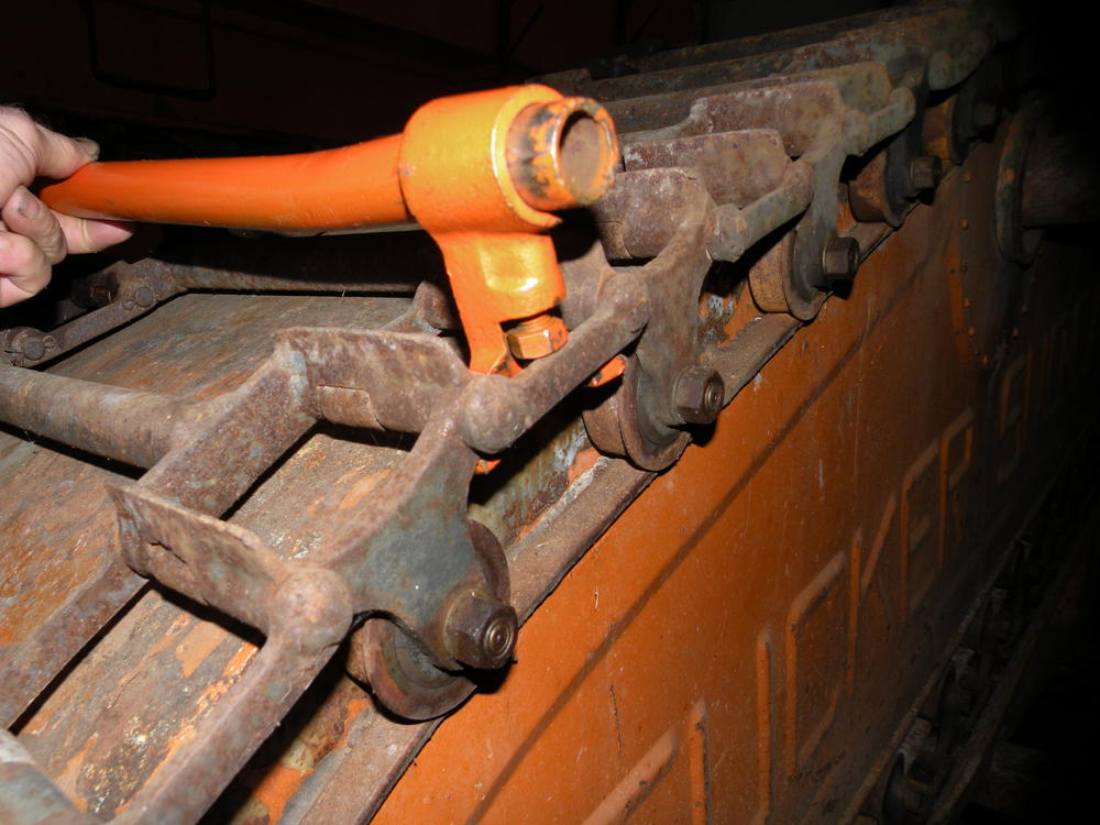

Got to Restoration & mods, look at 1957 Tucker Sno-Kitten post #13

The casting forms an inverted "T" with the outer tips hooked under each of the adjacent grouser castings the bolt head then is able to drive down the steel pivot link when you pull the pipe handle up- this shortens the distance between the pivot link pins and draws the grousers closer together.
