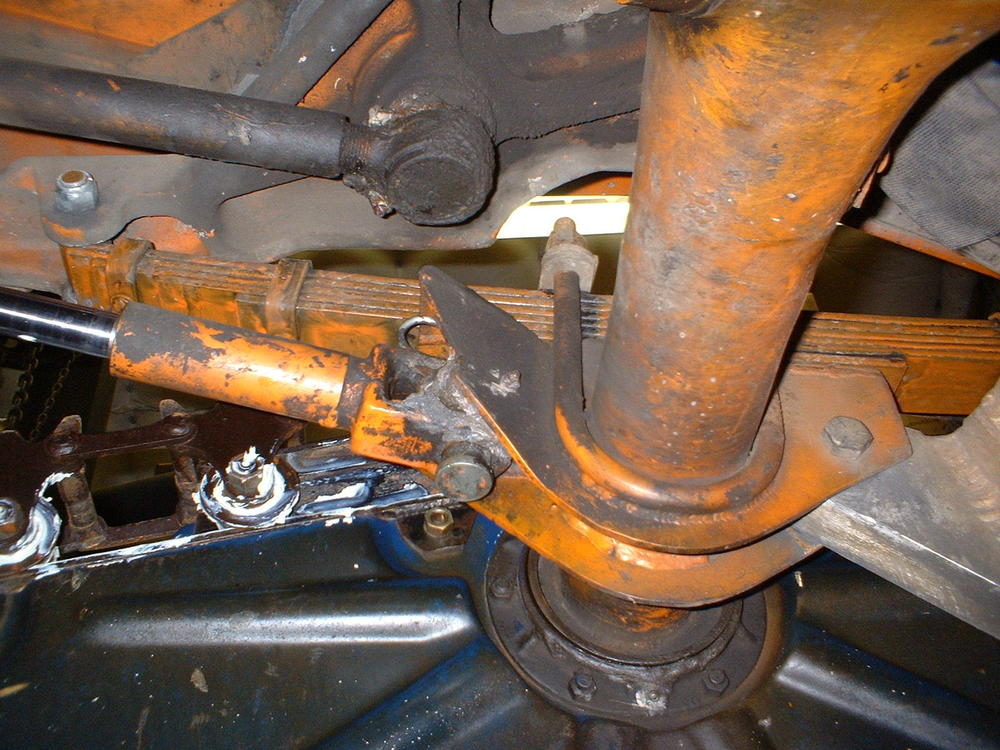

Here is the six way blade for 543. Note that the blade push arms are attached to the U-Bolt bracket in the front and two hyd. cyls. to the rear of the bracket. Rear end of cyls. has frame bracket. Stock swing frame and tie rods are retained with out the stock steering cyl.
