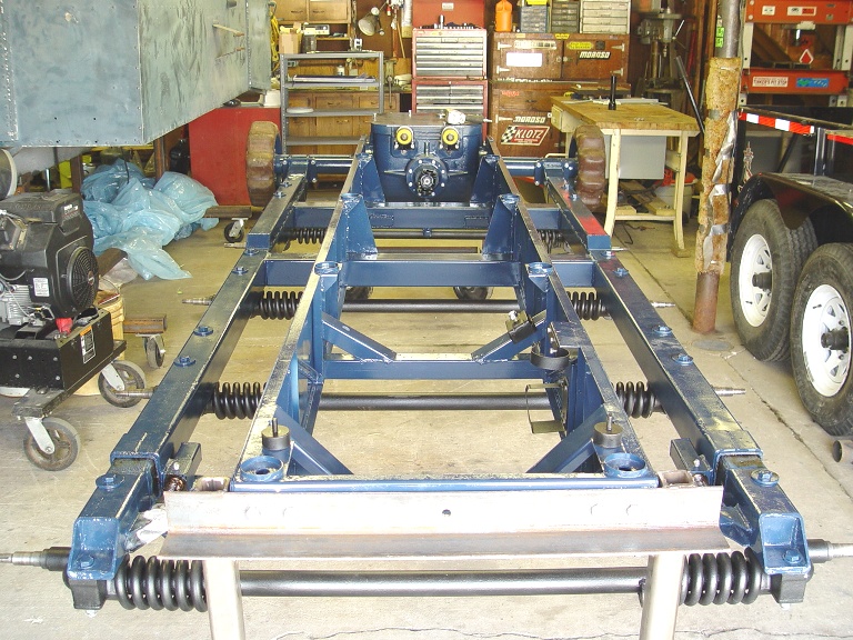

Well I started putting the frame back together,wile doing so I ran into a small problem. Several weeks back when the frame was still bare and lacking paint I welded a tow hook on the rear frame cross member, now I knew it would be close to the axle but not THAT close, so wouldn't you know it when I mounted that axle it hit the hook. So I had to get back under the frame to burn a notch in the hook so the axle clears as you can see in my pic.

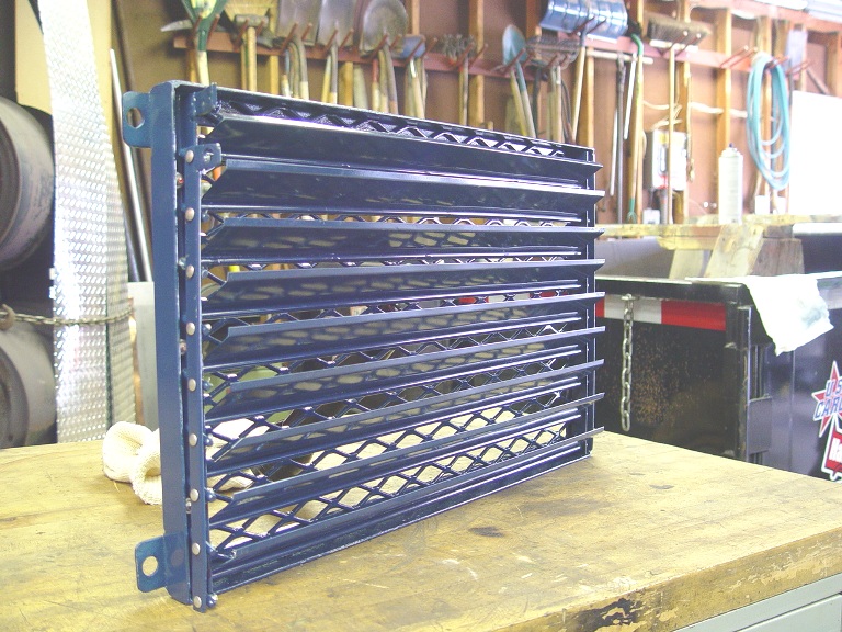

I also repaired and put back together the shutters for the radiator, and had the radiator cleaned out and checked for leaks and repaired at the local radiator shop.

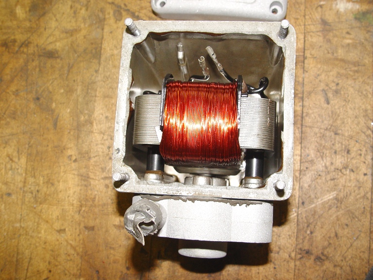

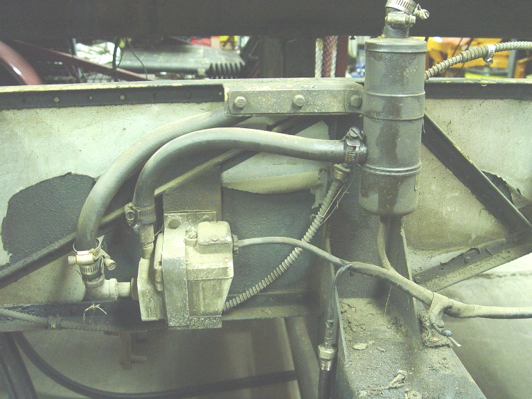

I have been building the frame back up. I took the 110v AC electric coolant circulating pump apart to reseal it because it was leaking oil that little motor runs in oil. So wile I had it apart I changed the oil also the last pic. is after I dumped the oil out so you can see what it looks like on the inside. Also in the last pic. you can see those 4 posts sticking out of all 4 corners, well those are the screws that held the top on after I broke the heads off of each one, come to find out they were glued in with something. I did get the out after some heat.

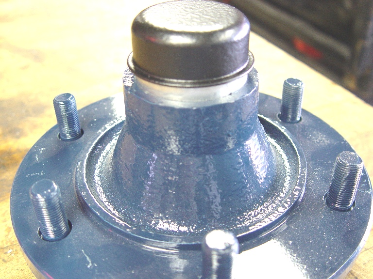

I also had a problem finding the correct size dust cap to fit the hubs they are a very uncommon size come to find out, I,am not saying they don,t exist it,s just that I can,t find them any ware. So I had them (the hubs) bored out to fit the next most popular bigger size.

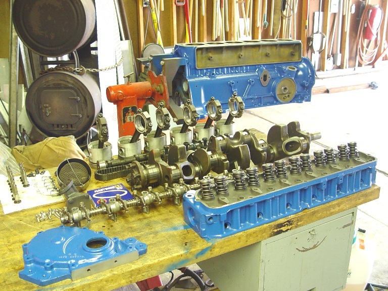

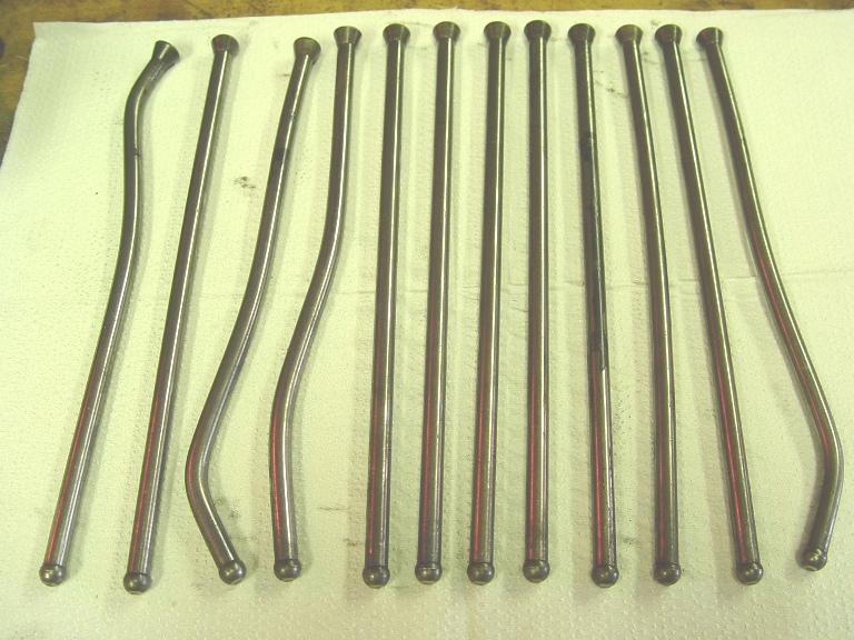

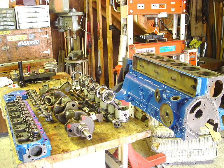

Well I know It,s been awhile but I,ve been very busy with work so I haven't had much time to spend on the cat, but I am working on the engine with what little time and energy I have left at the end of some of my good days. The engine is back from the machine shop and I have all the parts to start putting it back together. The pic. of the bent push rods are what came out of the motor when I took it apart I have no idea as of yet what caused this problem. I could find nothing wrong with anything to have caused this problem, so as I put this motor back together I will try and figure it out because something had to cause it. Maybe when I check the lash I will find it there. Any ideas will be appreciated. Also if anybody may know where I can find a new exhaust manifold for this 1963 223 ford, I can,t find one any ware

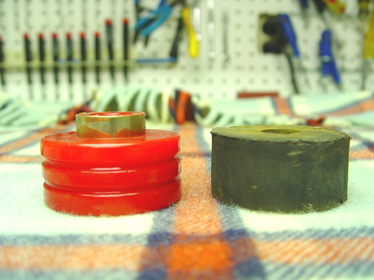

Also I finally found a body mount that will match up with the original mounts I just have to cut that collar off of all the new ones. I looked & looked and could not find a mount that was exact to the original mounts so I had to settle for these .

Wow! Those push rods aren't pretty! What shape are the crank and cam in. I don't have much knowledge about the internal parts of an engine but I'm wondering if the engine not being timed right would cause this? Somethings definately amiss to cause push rods to bend like that. I'd be checking and re-checking everything for clearances and tolerances before putting it back together. The last thing you'd want is to throw it together and take the machine out on its maiden voyage only to leave you stranded out in the middle of nowhere.
Could be stuck valves too.........
Well in the beginning I thought for sure it would be the timing, but it turned out to be correct.There also were no marks on top of the pistons from the valves hitting. I also should mention that somebody had this motor apart very shortly before it stopped running because the inside of the motor looked like it just came out of the machine shop and probably did not run no more than just a couple of seconds or if at all with push rods bent like that and then probably just gave up on it and parked it. So with that said it could be possible the cam or the rocker arm assy. may be wrong. I am going to have that looked into to find out for sure one way or the other. Also before the motor goes back in the frame I will run it on a test stand that I am building for it so any problems can be found and fixed before going back in
Also thanks for the web site on the manifold but I all ready talked to those guys and all they MIGHT be able to get is a used one that will probably be cracked just like mine all ready is. I know I can get it welded but that will be a last resort if I can,t find a new one .
Have a metal fab shop build you a custom header if worse comes to worse. Also make sure you have the correct cam shaft. Someone may have swapped in a 200 or something like that. Something was put back together wrong then fired up!
That's kinda what it looks like.........incorrect camshaft and pushrod combination.:smileywac
Agree with you but doesn't that seem odd for someone to do that even by accident? I agree and think it's that as well... but keep thinking that it seems outrageous.
For that to be the case then the previous owner(s) must have been replacing the original parts (that were worn/broken/bent) with parts that they thought weren't correct but they couldn't find the exact right part and thought it might be close enough. What do you think? If so then they should have realized that applies only in horse shoes and hand grenades. :pat:
If it's not that what else could it be ?????
Weathby, in some rare cases we have seen that when a machine has had a severe backfire that it has bent the push rods and cracked a manifold all at the same time. the owner was using starting fuel and the exhaust was partially pluged with a chipmunk nest and yes the chipmunk did not like it either.
