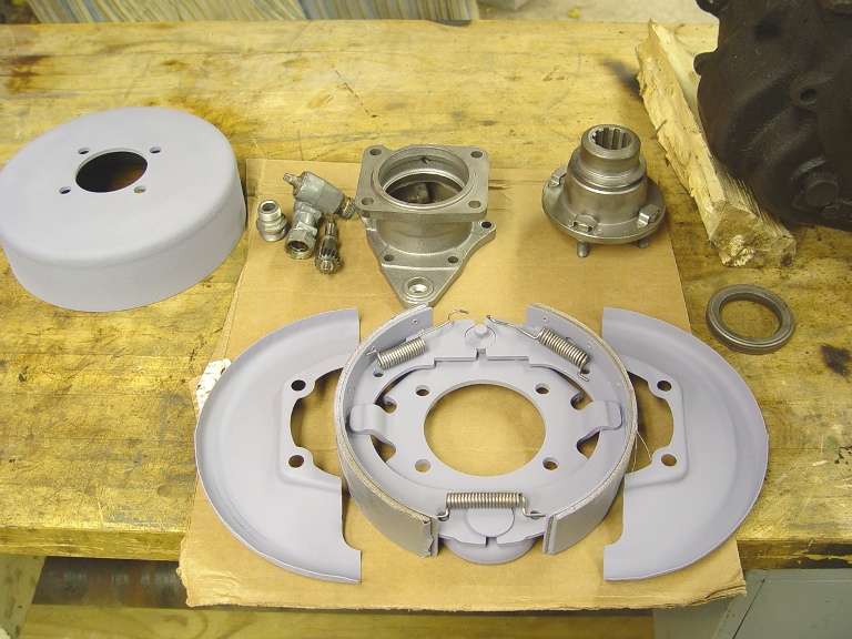

I been working on the transmission. I removed the DRIVE LINE BRAKE assembly's and the speedo assembly. Checking for any problems, replacing gaskets & seals, bead blasting, then primering all parts. I,am using a two part primer from IMRON. I,m going to start going through the trans next along with removing the axles from the frame for sand blasting

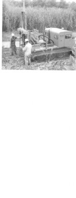

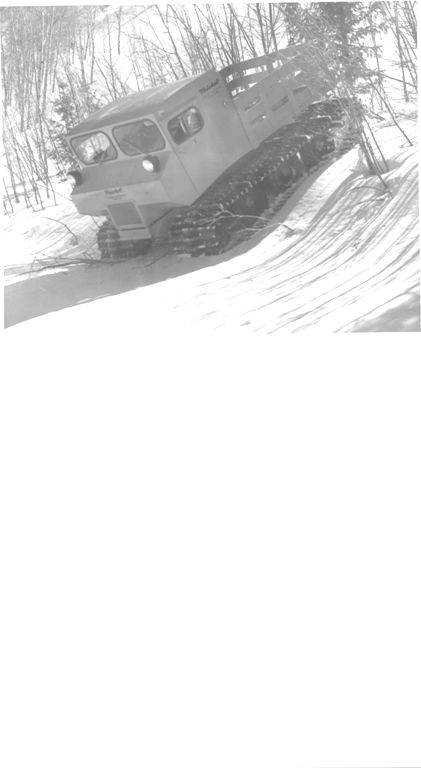

Since nobody else asked, and since I know I'm not the only one who doesn't know . . . in that first photo, what is the thing mounted on top of the snowcat?
It looks like a rock drill to me , but they are usually ran off air and it takes a big compressor . I wonder if it just towed the compressor behind it ??? The motor on the rear does not look big enough . Maybe .........
Yes BIG AL is rite that is some type of drill. I should of add this pic. also to help explain:pat:
What about a hydraulic pump to run the drill?

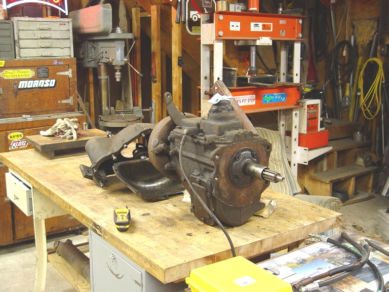

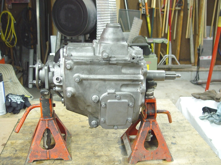

I just finished going through the trans. every thing looked normal (for a trans with miles on it) Notice the teeth on first gear (the biggest gear) they are ground back a bit on the left side of the teeth. this is what happens when you hear that grinding noise when putting it in first gear to fast after pushing the clutch in and not giving the trans. time to stop rotating. Though this will not effect the performance of the trans. it will contaminate the gear oil with all that metal it ground off of those teeth

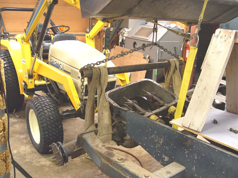

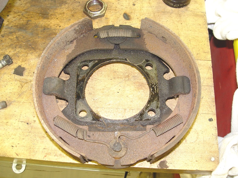

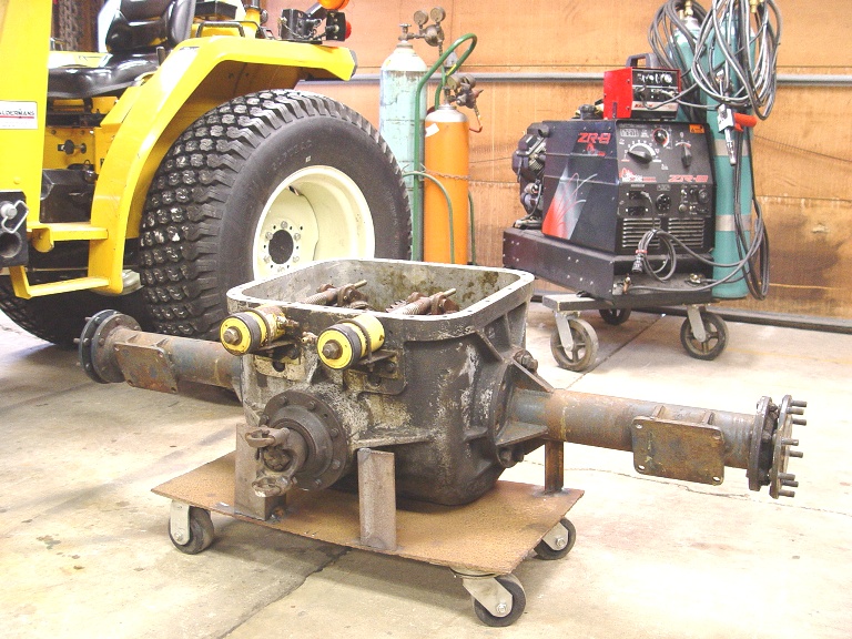

Well I removed the rear drive unit. I will look it over close clean it & repair if need be. Though It looks to be in very good condition (I hope ) there should be no repair work needed just a good cleaning inside & out
