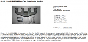

OUCH! thats pretty bad. I have hod ZERO luck in finding one for you. Not sure what else to do. Maybe you can have one fabbed up? Custom built. That thing is history! I do not belive welding it will work for long.

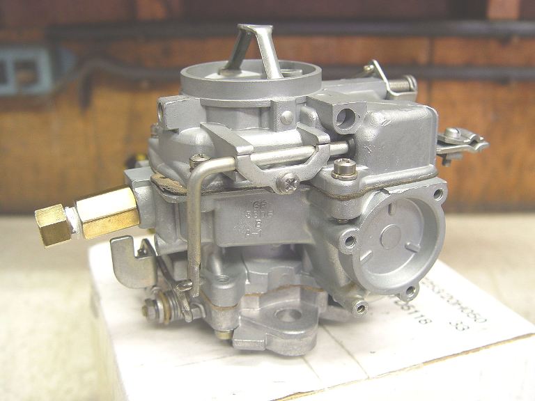

HI everybody I know It,s been awhile again but It's been slow going for me but I'am getting better. I still can only use my right hand, my left arm & wrist just received It's second cast so it will be non-usable for sometime yet which makes it nearly imposable to even button a shirt or tie shoes, so working on my cat is very hard these days.:frustrado and I'am not very pleasant to be around at times SO I AM TOLD. I have managed to do a few things though, I did get my exhaust manifold welded and the carburetor gone through, also made the bracket to mount the alternator. Thanks snowcat opp. and everybody else on trying to locate a exhaust manifold to replace mine with but I ended up having it welded then coated with POR-15 which is some pretty amazing stuff.

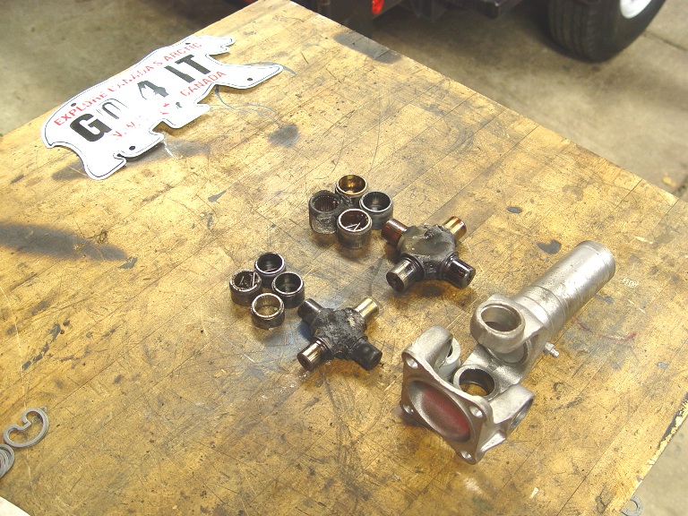

Well I got around to doing a few things that I,ve been putting off for awhile. One was to work on the distributor, I am buying a conversion kit to change it to a electronic or (pointless) distributor, waiting for the parts on that. The second is I removed the U-Joints from the drive shaft ends so I could bead blast & get them ready to paint. The U-Joints were in very good condition so I tried to get them out of the shaft with out harming them, but needless to say I could not get them out without damage though I don't know if it is even possible to get u-joints out without damage after they have been installed

U joints are always best replaced anyway. There really cheap and can save you a huge headache in the field if one should fail. That pointless distributer will do wonders for the engine! Electronic ignitions rock!

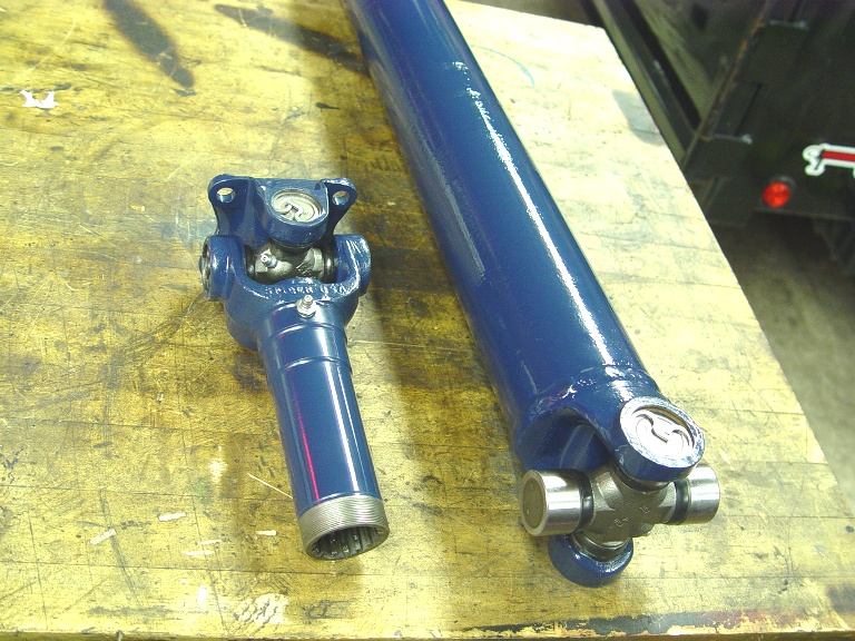

Well I bead blasted the drive shaft then painted it & pressed in the new U-Joints

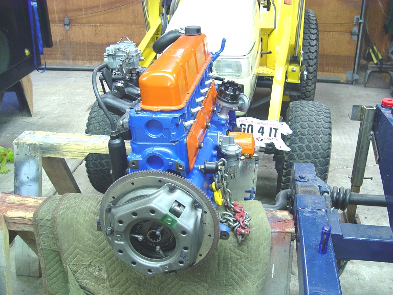

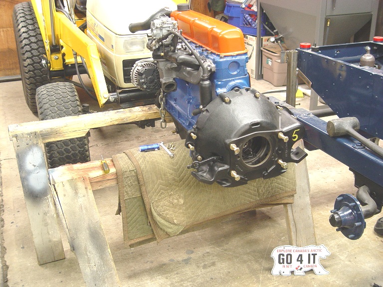

I have been away for the last three weeks deer hunting in northern Michigan and was lucky enough this year to get a five point as you will see in the pic below. I have been working on the cat since I've been home. I now have the motor & trans back in the frame and will start to get it ready to start it. But I gotta tell ya the pics. below only tell have of the story, let me tell you what happened. For the last two days we have been working on getting the engine all ready to put in the the frame, SO after it's all in with the trans. and even the drive shaft bolted up, the last thing I'am going to do is go under the engine to tighten the bolts on the pressure plate that were left loose so we could get the trans lined up with the clutch disk & pilot bearing when we installed the trans. on the back of the engine, so I start to tighten the bolts on the pressure plate and when I try to rotate the engine to get to the rest of the bolts on the pressure plate the engine wont turn, so I put a piece of pipe on the end of my ratchet and tried to turn the motor over again with the more leverage and it did move but it was very very tight I was even scared I was going to snap the the bolt off on the end of the crank it was so hard to turn, so I knew something was way wrong, BUT WHAT. So after about a day of going over & over and rethinking everything we decide to take the engine back out and take the transmission back off to see if there is something wrong with it, and of course there was not. So I tried to turn the engine again with the trans off of it and still it wont turn, So as much as I hated to think of it I'm thinking there has to be something wrong with either the piston rod bearings or crank bearings even though I checked all that stuff as I was putting the engine together or maybe something fell inside the engine as it was sitting on the engine stand for the last several months. So I decided to put it back on the engine stand and that meant taking back off the clutch & pressure plate and the fly wheel so I could bolt it back up to the engine stand but just before we were going to bolt it to the stand my buddy said let me try one more time to turn it over, (and I'm thinking to my self why would it turn over now when we haven't even done anything to it yet) so he goes at it one more time and he says HEY it's turning, and as soon as he said that a light came on :idea: (in my head that is) and I said to him before I even check I know what it is, and he says WHAT and I say I bet It's those new fly wheel bolts that I bought, I BET THERE TOO LONG and sure enough they were (they were 3/32 longer than the original bolts and that was long enough to screw them right up tight to the back of the block when the fly wheel was bolted on:pat: :pat: :pat:. SO the pics. that you will be looking at are of the second time the engine & trans. was being put in
