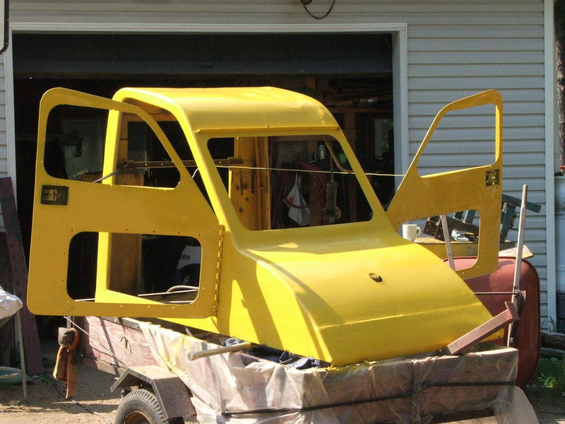

Well, back from holidays, and got a few updates to post on my SW-48. After sandblasting all the rust off the cab, I primed it and gave it one coat of yellow. All my friends and family all said the same thing, I should do the Bondo putty stuff to make it look good. My wife was supposed to do it but she got caught up with work (as always) and didn't have time. I'm no expert, but I'll give anything a try.

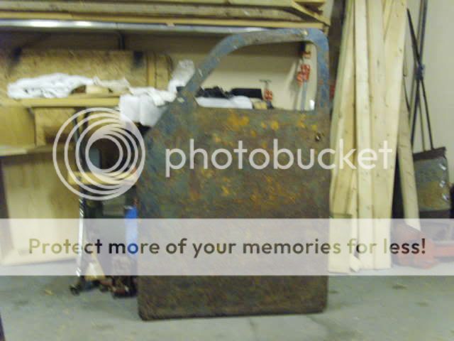

Pic 1 - My attempt at Bondo. The door is primed with Tremclad gray primer, the rest of the cab is painted with 1 coat of Tremclad yellow. Bondo is on it's second coat in this picture.

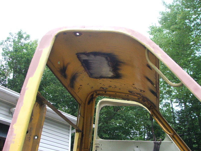

Pic 2 - Some of the cab was repairable but there were holes everywhere. I filled most of them with the MIG welder but the top of the cab was just too thin and had too many holes to try and fix. I used some of that stainless steel I got from the job to patch what IMO was scrap.

machine is looking good, here is some advice on your primer, I found out the hard way that if you use tremclad primer, use tremclad paint to finish, I used tremclad on one machine to cover some bare metal, when I went to paint with reg automotive paint, got a reaction to tremclad and had to stip off all paint and start over
Mr F, of course I'm using Tremclad, on everything!
This last gallon I bought of Gloss Yellow is such a close match to the original paint that I didn't even bother asking to have it mixed. This is the first coat exterior, will give it another two over the long weekend. Should be able to complete the interior next week and I just need to complete the installation of the new hydraulic hoses before I drop the cab back on the SW-48.

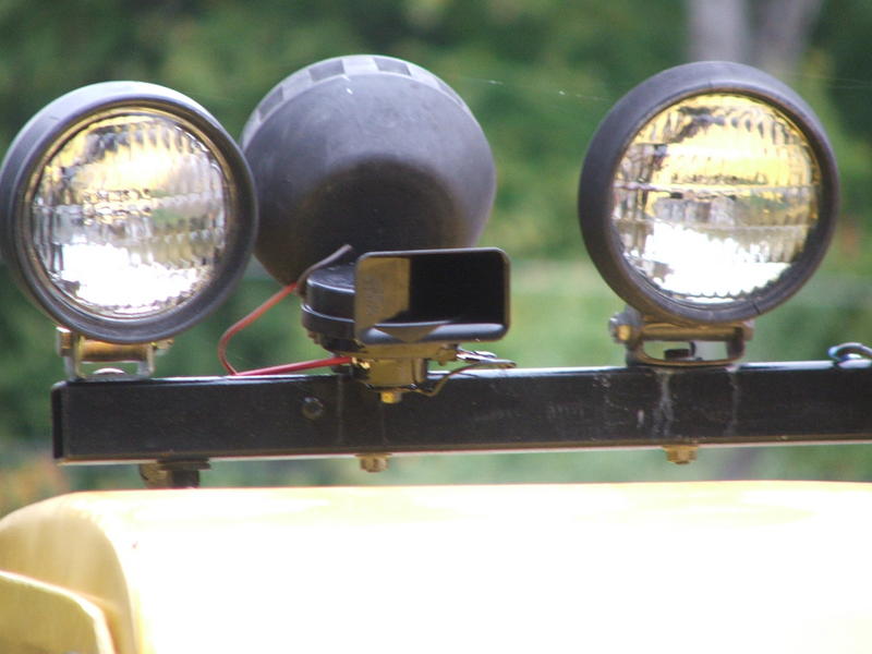

Pic 1 - Where I was at this morning. I've actually added 2 more front lights on the top light bar since. It's so much easier to work on the SW-48 in the warm weather (my garage is full of tools, no room to work on vehicles), so I took all the wires apart and soldered them all, then covered in heat shrink tubing, then with a protective plastic wire cover and finally, a double coat of exterior vinyl tape.
Pic 2 - with the new light bar arrangement. Lights are on special at Princess Auto for 6 bucks a pop.

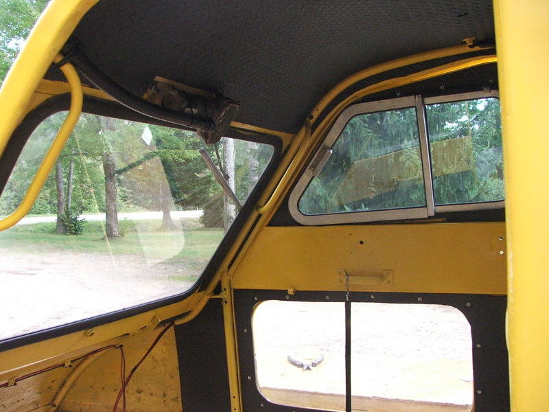

A few pics of last weekends work:
Pic 1 - gone yellow crazy after seeing J5B's machine. Sorry guy, your's looked so nice, I wanted mine to look the same.
Pic 2 - It was done once, and Weatherbys posted pictures inspired me to do better, so this is the before pic.
Pic 3 & 4 - Found some checker plate foam carpeting and thought it would be nice for wall covering. Turned out pretty good.

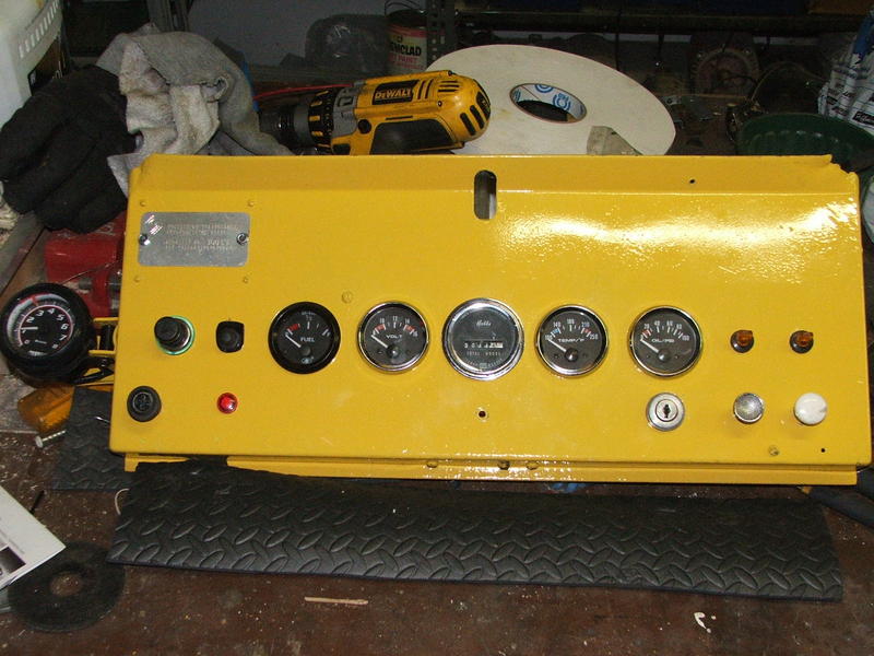

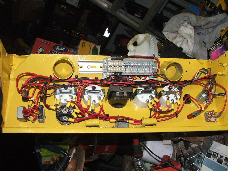

Pic 5 - After many hours of cutting, soldering, redoing and re-redoing, this is the best I could come up with. Not as cool and nice as Weatherby's but better than it was.
Pic 6 - dash completed, with two new additions to plug the holes for the original key and starter buttons. Added a cigarette lighter (no, I didn't start smoking, it's for the 12V output) and a horn button. I installed the horn late Sunday after the pictures were taken but it works! Almost done.
The cab is now back on the hull, thanks to my neighbors hunting buddies. Will have pics in the next post.
