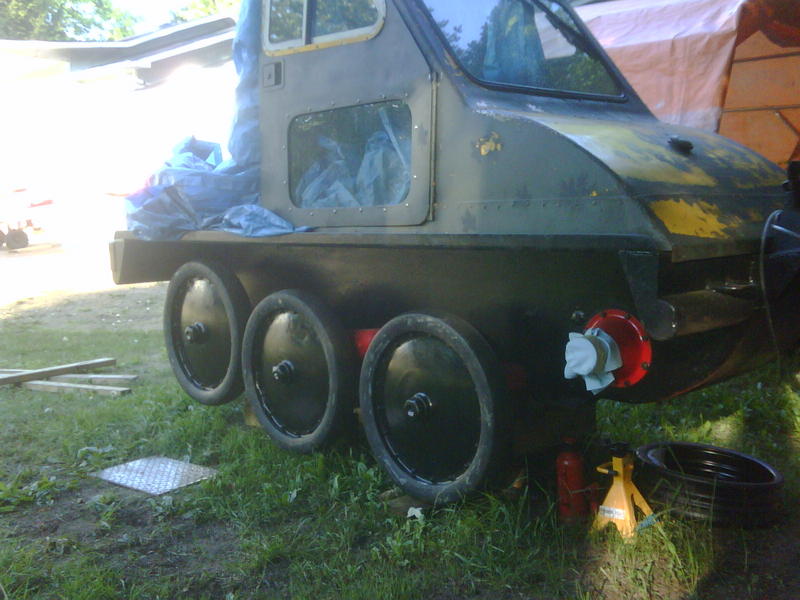

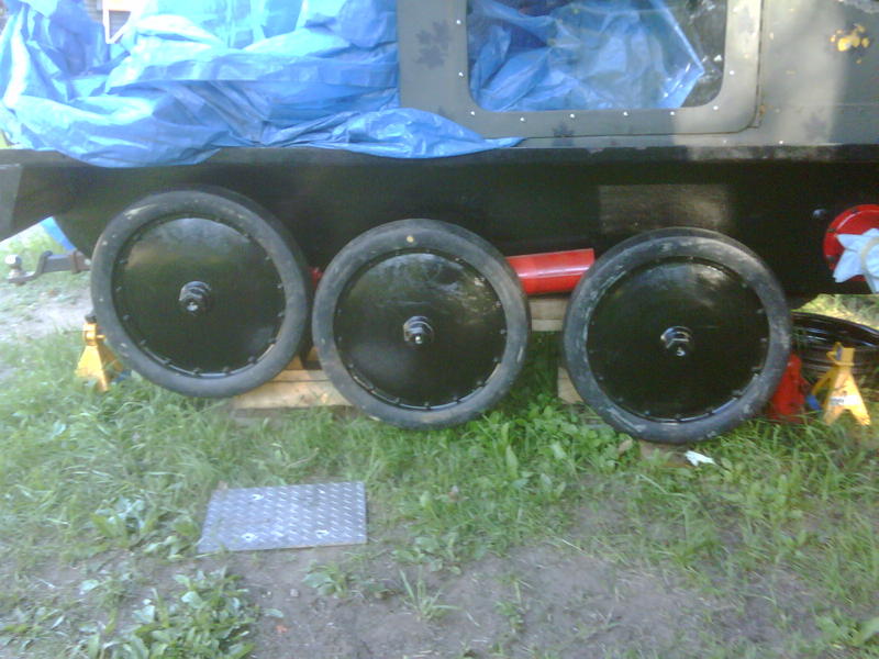

First of all, sorry for being such a lurker lately. I've followed closely most of the threads going on. I've been busy since the snow disapeared early here in Canada...taking apart my SW-48 and finding what 35 years of no proper maintenance can do to a machine. After removing all the wheels and finding most of the bearings rusted or half rusted (water line...), figured the suspension would be the same. Took the suspension apart too and found seized bearing, missing seals, rusted cups... Here are a couple of pics, just got so into it that I forgot a some points to take pictures. First pic shows where I drew the line --> no more disassembly, gonna go over budget!

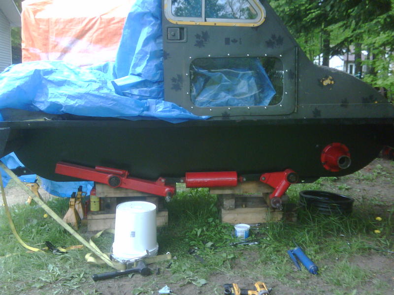

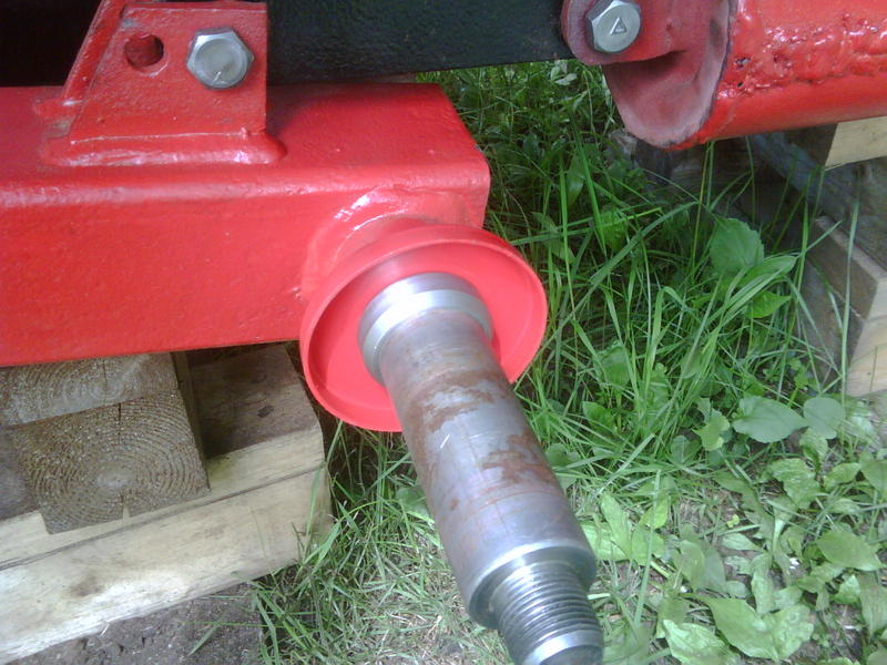

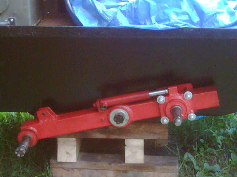

Second pic shows wheels and suspension parts, sandblasted down to bare metal, primed and 3 coats of paint! Third, close-ups of suspension parts, some still needing repair (front wheel arm). Fourth pic shows the intake/exhaust manifold before sandblasting and fifth, after. More to come...

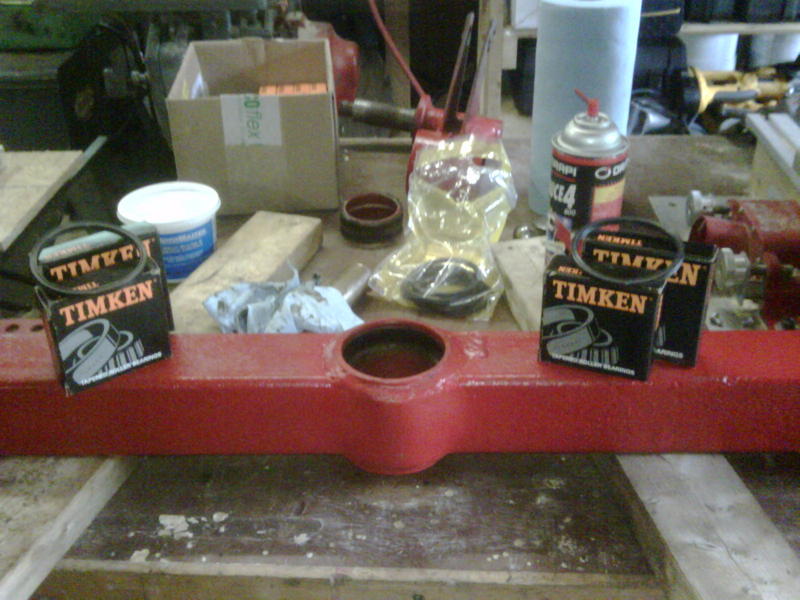

Try this again... Posting more pics :

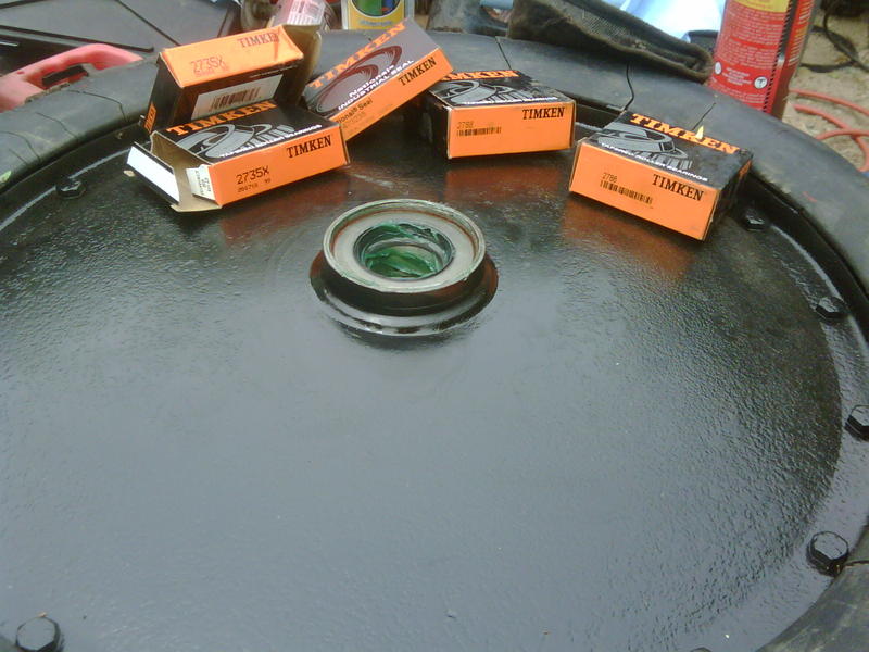

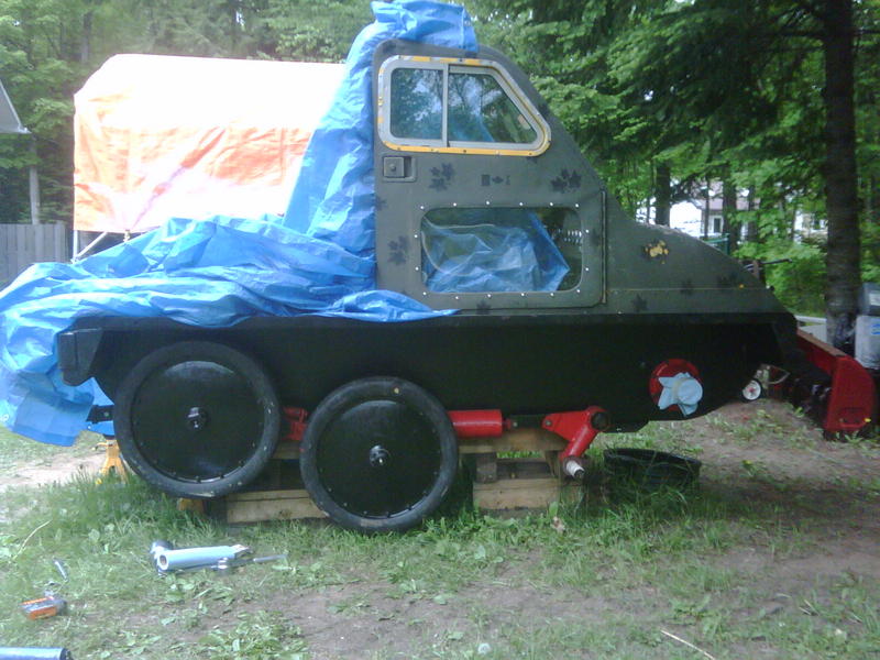

1 - Starting reassembly of suspension with seals, cups, and cones;
2 - One side done, looking good, can't wait to see wheels;

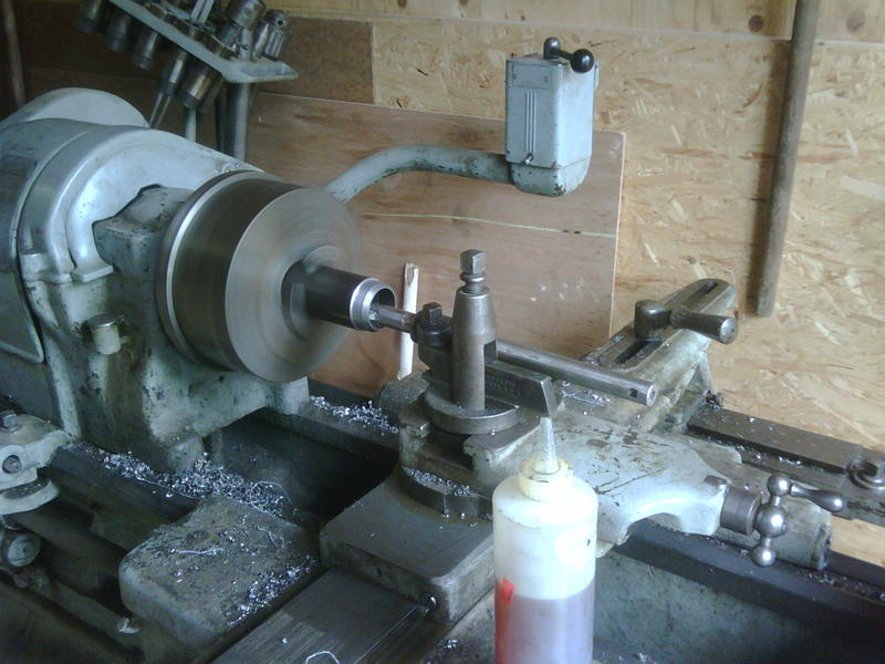

3 - Had to machine quite a few parts, this is the spacer behind the wheel;
4 - Ahhhh, just about ready for a wheel;
5 - Same as the suspension, seals, cups, and cones;
6 - Got two of them on! :clap:

It is hard work and it's kept me from smoking so far. It's been almost 5 months now. Yesterday I put on the last wheel (front) on that side and repacked the "flower pot" with new cups, cones and seals. I don't know if the J5 had that aluminum cap on the "flower pot" but no one had the double seals that fit in that hole other than Prinoth/Plannord. So instead of paying a lot, slapped the puppies on the lathe and removed about 25/1000 " so the new seals would fit snuggly in. Almost ready for reinstall of the Sprocket assy. But I'm gonna flush the diff first (thanks for the tips Pixie) before I seal those "flower pots back to the hull. I'm also picking up belting next week, found some 3ply 330 for about 3.25$/ft @ 4.5" wide. It will be a nice machine once I'm done.:brows:

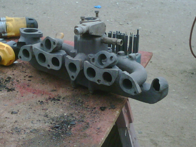

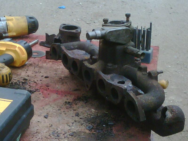

Well the manifold left today for Montreal to get welded. I left it in the hands of my father in-law, a 35+ years millwright who took a very big load off my shoulders because I've looked and shopped and have even been asked if I had some manifolds. They are rare items.
Has anybody had problems finding the strainer/rubber gasket assy for the fuel pump on the 6 inline flathead? All the suppliers I've been to show me a picture of the part (got the p.n. out of the book Chrysler Industial Engines) and it is now a paper cartridge that doesn't fit in the bowl. I've thought about an electric pump and an inline filter, but I'm sure the screen strainer is cheaper??? Any help on this would be appreciated. Will post more pics this week as more parts get installed on the machine. The winch is also in pieces so when I have all the wheels back on and the tracks rebuilt, I'll work on the winch until the manifold comes back from the weld shop. Until then, let's enjoy summer:w00t2:.
Benz9 keep your eye out for a manifold off M37 dodge,M43 radio trucks, I used that on mine. The exhaust exits out the bottom,I did a u turn with the pipe and up and out. Could be a little tight on the narrow hull of a sw48,but it's an idea. Fuel pump I went electric with in line fuel filters on both sides of the pump, and a carb off a 250 chev in line 6,single barrel Rochester worked for me, no more govenor,I just keep an eye on the tach 2200 rpm tops.

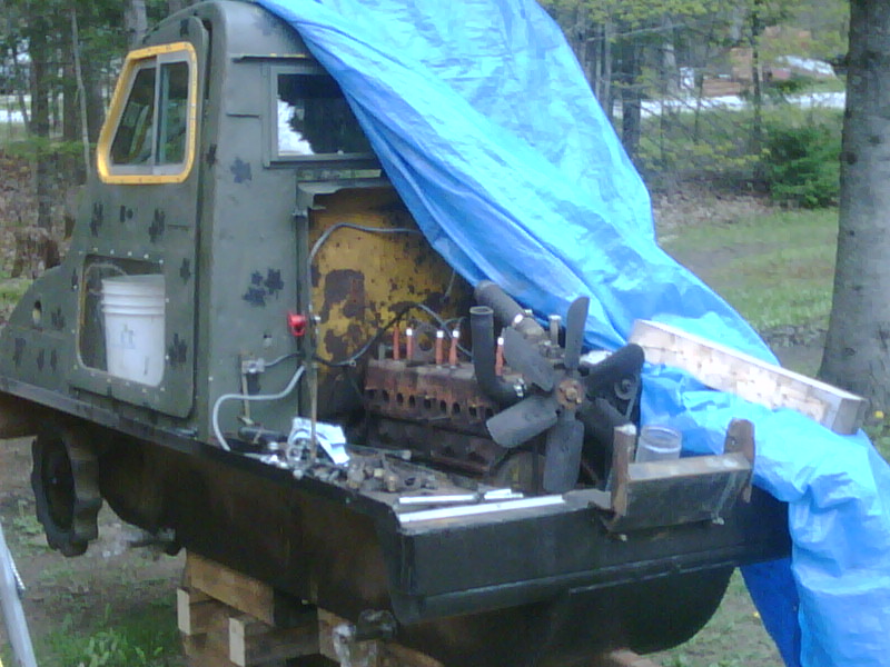

While waiting for chemical gasket to dry this afternoon, started to work on the winch. I just love the gunk that replaces grease in there when dudes go in the swamp with a SW and don't wash it off after. It's just swamp water and fine sand, eating away at all the steel parts (and alum too). So it's all cleaned up, planetary assy, clutch and all. ready for repacking and paint. At least there are no parts to replace so far.

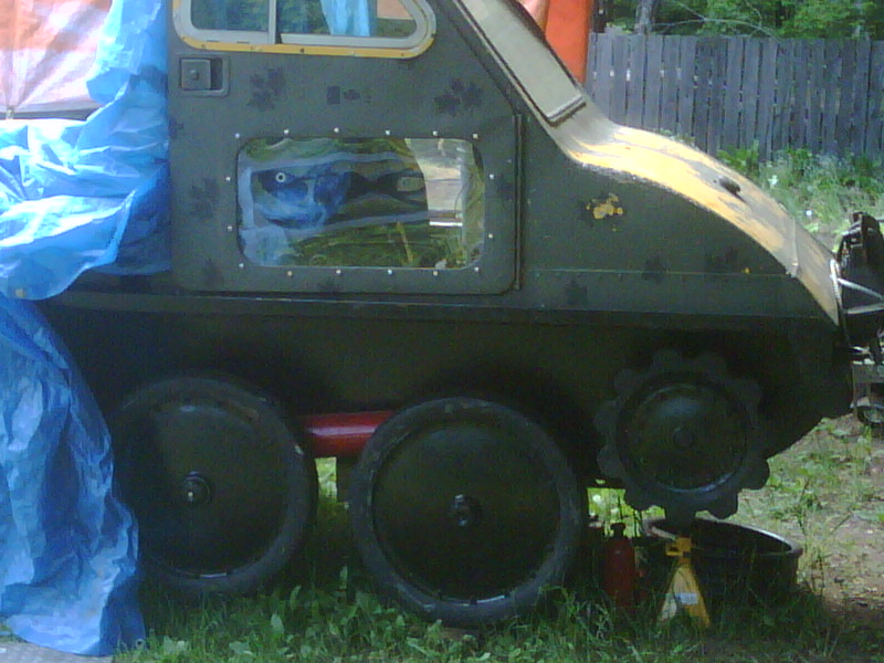

Sorry guys, a day late with the pics...
basically it's just the third wheel installed and then putting new bearings in the "flower pot" and reinstalling the sprocket. It's on the SW so we don't get moisture in the diff. I still have to clean out the water residue in the bottom of that huge enclosure the diff sits in. I can only imagine it must be bigger on a J5 and Muskeg, therefore take even more oil??? Wow. Started to take the track apart today...long process when 1 out of 5 bolt actually unscrews. the others have to be grinded or drilled (I prefer grinding, much faster). Catch y'all later.

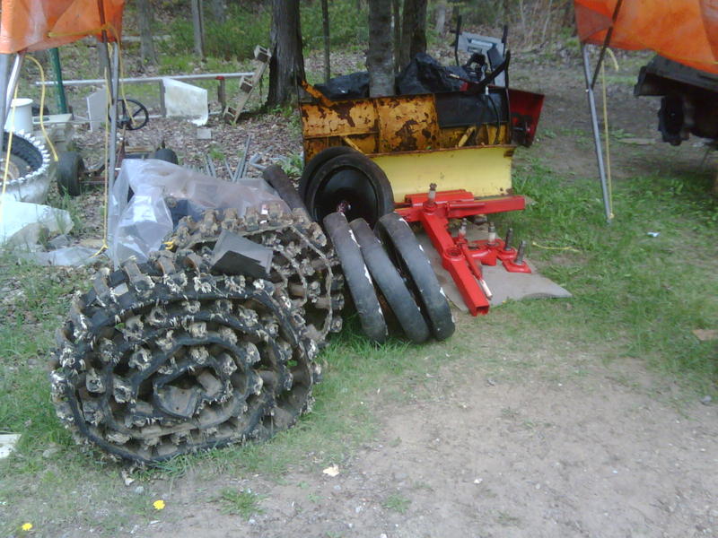

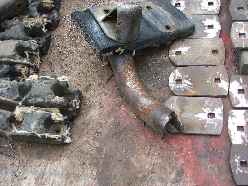

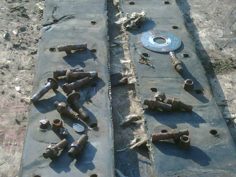

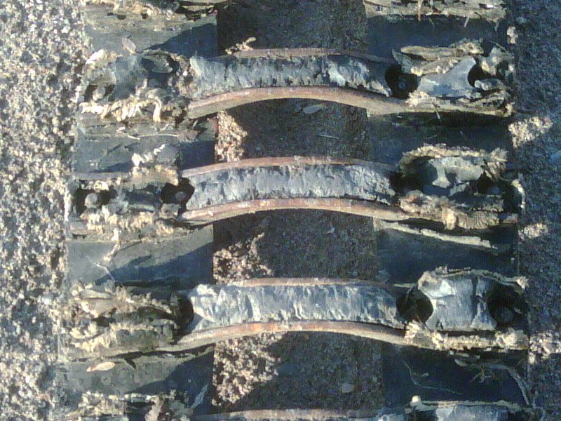

The bolts in my track were 1/2". The ones that wouldn't come apart I just broke :smile: ( About one in five ! )

ok partner try this those bolts look to be 5/16 inch center punch and drill through the heads if the heads don't fall right off 1 blow from a chisel should remove itwhen you are done pick up your grousers and go

Don, I haven't tried your trick yet, the wife had me do a bunch of house work on Sunday but I plan on taking the drill press outside and trying it.

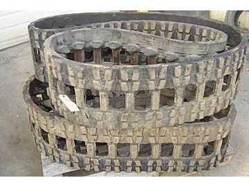

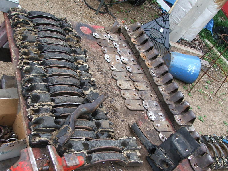

Here's a question to y'all, there is a machinery shop in Laval that (I'm guessing here) services the SWs for the city of Montreal/Laval and is selling used Camoplast tracks for the SW. Has anybody run these tracks before? Are they heavier than the standard tracks? How much less traction will I get with a used track as opposed to the steel grousers bolted to a new rubber belt? Things to think about...

called the guy up yesterday after posting the picture and asked him the price for the used belts (new ones go for 1900$ each + tax, so over 4G:w00t2:). He said that he has two types, used and really used, so 1000$ for the first (set of two) and 500$ for the later (set of two).
Here's my question. How would a flat track compare to a track made with steel 2.5" grousers and converyor belting? When I asked him this, I don't think he understood, he started talking about guys that bought his used tracks for skidding wood in the forest and added angle iron to the belts??? Cost wise, it's still cheaper to rebuild original but man, it's a lot of work. I don't like the easy road, but in this case, after taking 6 grousers off the first track, I get discouraged and have to do something else for a while before starting on the next six.:w00t2: So unless (1) I win the lotto, (2) get free tracks or (3) some fall from the sky (not too close to the house I hope) then I'll continue to take my tracks apart all summer and rebuild them in the fall!
Benz9,
Tracks seem to be the Achilles Heal to making a snow cat affordable. Once they are worn out they are either a pain to work on or expensive but usually both. However once you rebuild/replace yours they will last a long time with proper care and usage.
I once found a brand new track for a Thiokol Spryte at the local metal recycling yard that still had the tag on it. I paid $50 for it and then stored it for over 10 years as the tracks on my Spryte were in good shape. I tried selling it locally and on places like this forum and finally sold it at an auction for $25. The thing was worth thousands.....to the right person at the right time.
Depending on what you plan on doing with your SW would kind of decide if you need grousers or not. If you are just plowing your driveway or going off road in the summer than the all rubber track would give you a better ride and do less damage to you drive way. Deep snow fresh snow with any kind of hills will require some type of cleat or a winch and shovel.
Oh one more thing, once you invest in new tracks, rebuild the ones you have, or sell your SW, you will find tracks all the time usually for free..guaranteed!

I remember years ago replacing a bunch of those. Before you go to far, call around to anybody who works for a city garage or parks & rec dept to see if maybe they have some left hanging around. We had purchased two machines from the parks dept and they had spare pieces to rebuild one complete side, 2 spare wheels, lots of bearings, spare tranny and all kinds of stuff.
