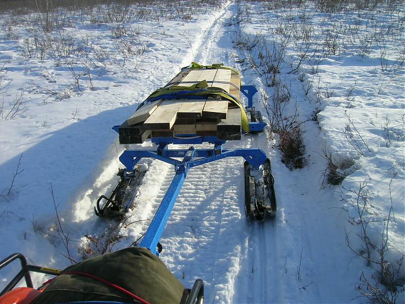

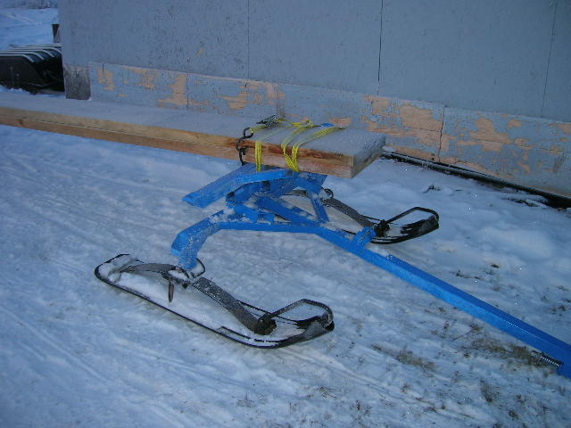

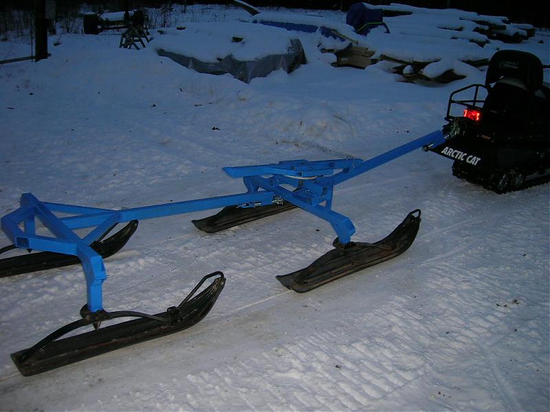

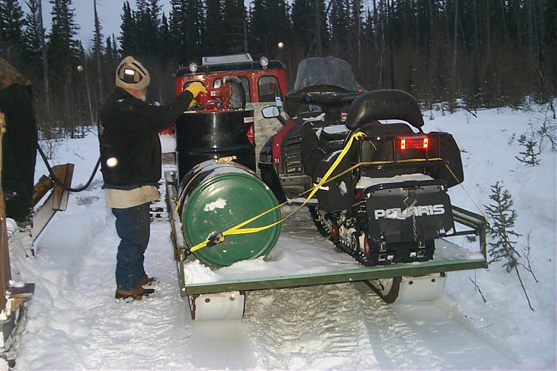

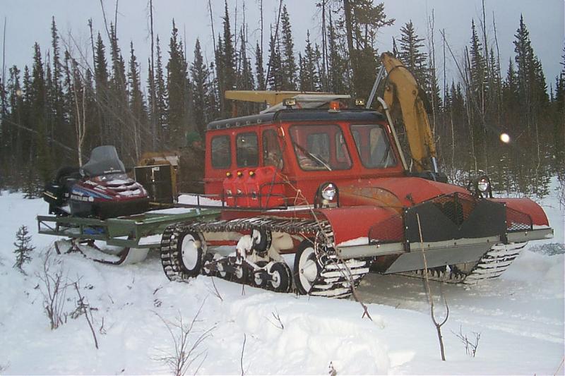

I built the lumber sled with two parts so that I could haul any length lumber. The front sled has a "Fifth Wheel" to turn and follow the snowmachine/Imp when I was pulling, the rear sled is strapped to the load and the load acts as the frame between the two sleds. When the sleds are empty, the rear one hooks to the front one and they pull as "Doubles". The skis are the same width as the Bearcat Widetrack snowmachine so I could break trail and tow a load at the same time. The Imp pulls the load with no effort at all. The loads ranged from a few hundred pounds to in excess of a thousand with lumber and everything else that could be strapped to it.
Have a bunch more photos if you want to be bored with them. Took photos of the constuction process also. The skis came off two old snowmachines and I put wide plastic ski skins on them for ease of pulling and floatation. If I was to build new ones, there is a few changes I would make, but to build them to sell would cost more than most folks would want to pay. When I designed them there was nothing on the market that could do what I wanted to haul my lumber to the cabin.

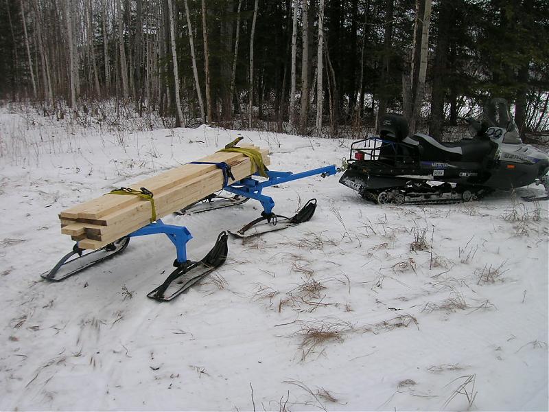

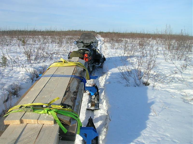

Here is a few more shot of the blue sleds. I built them because I needed something to haul materials out to my cabin site and there wasn't anything on the market that would work for me. I built it with the ideal of both the snowmachine and Imp pulling it. The ski width is the same as the snowmachine to allow me to break trail and tow freight.
I can also haul any length of lumber and/or use one sled to take bulk stuff, like my wood stove at the cabin.
Anyway, weight is a problem on both the Imp and snowmachine loads. The Imp is rated at about 1500 lbs for towing, although I have pulled a "Bit" more than than now and then. The sled assembly weighs about 100+- pounds, and I have put as much as 1500 lbs in lumber on it. I figured I want to pull as much freight as possible instead of sled.

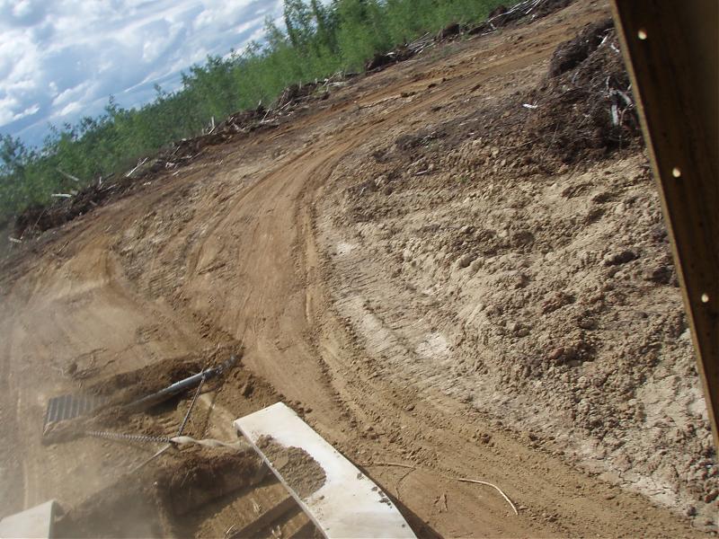

Here is a "Joint" sled that Larry and I have that hauls freight and can be used on the back haul as a trail drag. In these photos I am using it to drag my runway at the cabin on sandy dirt behind the dozer, it worked really well.
Larry used this one for hauling logs to his cabin this last winter, and it did a really good job, little heavy for flipping over unless you have a winch or block and cable setup....
In one of the photos you can see the "Herring bone" design that when flipped over, has about a 1/4" lip to dig up the snow and leaves a pretty nice trail without shoving the snow off the trail. Even though I was using it in dirt, it works pretty well in snow...if we get any....
