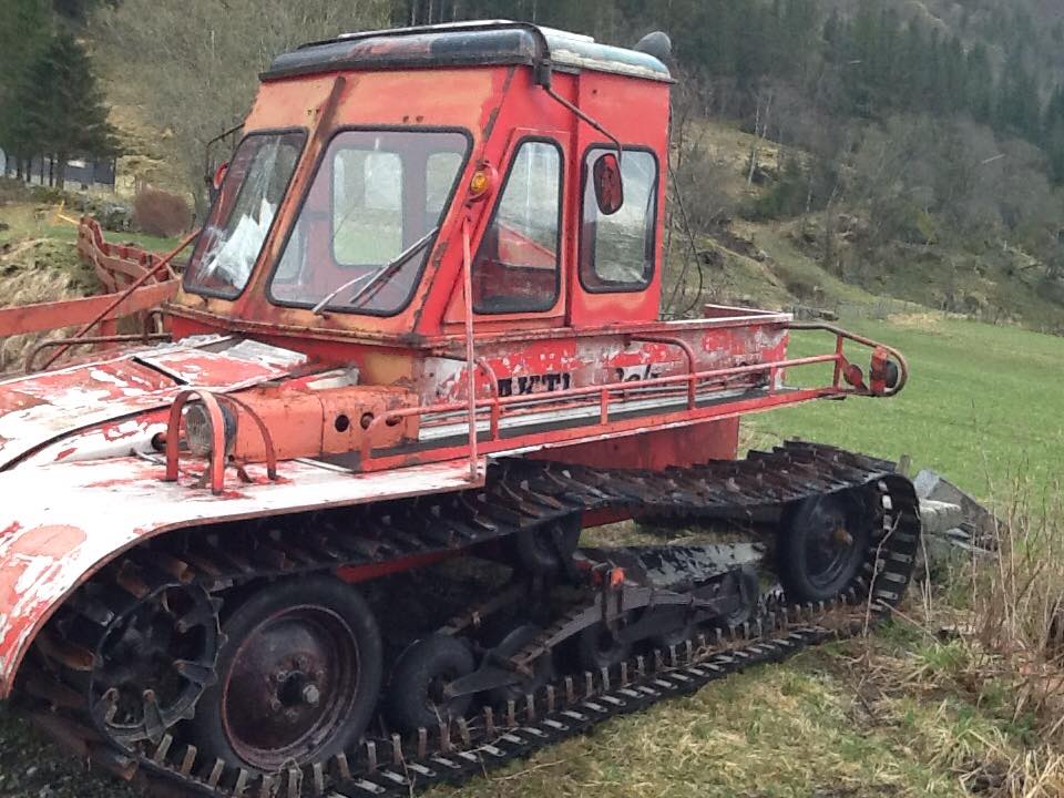

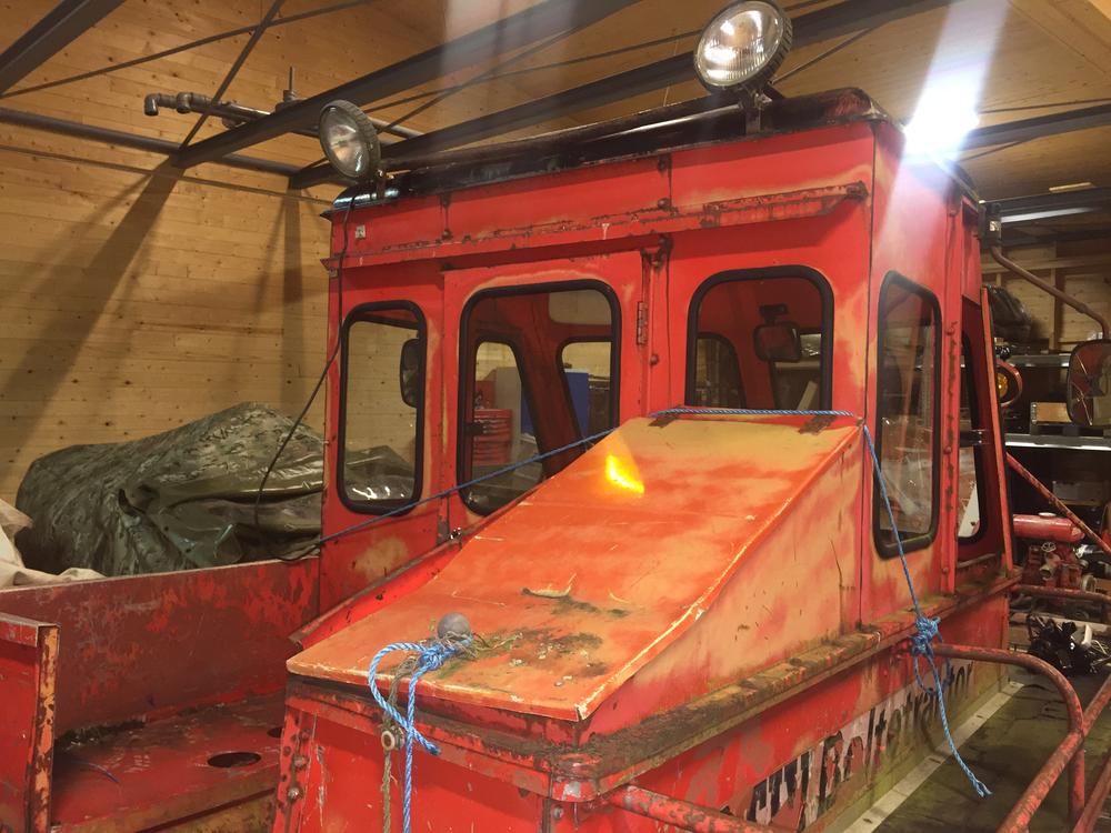

That is not butchered Don, that is a factory cab- like the ones used in the Sapporo winter Olympics. I also think those tall cabs are great! looking forward to following this build:smile:
Nwering, if you have a chance could you post some pictures of the back of the cab and how it joins on to the machine? I have always wondered how hard it would be to remove the "top" on one of these half cabs, I assume the back wall is one piece all the way to the floor on each side of the door?
That's correct. This was a factory option, actually also for the standard SnowTrac. Both high and low roof versions, and sometimes with a triangular toolbox on each rear bench. One thing that make them not so smart.. is that there is a tendency for the tracks to throw up snow that settles behind the entrance door. This makes the door allmost impossible to open from the innside ? Looks darn silly when you are trapped innside.
All the panels are bolt on. Many small panels.. I'll post photos later.

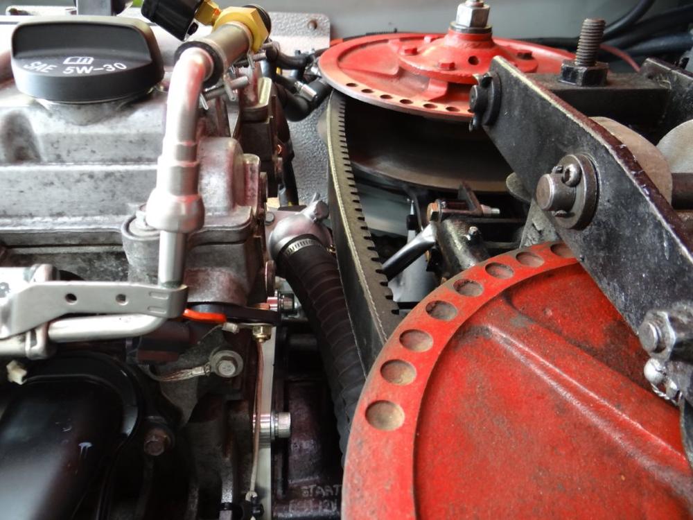

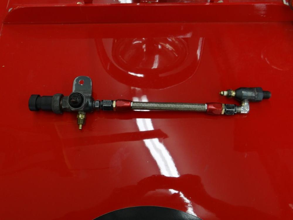

A - ENGINE " GM ECOTEC 2.4 LE 5 "
First picture:
You see the intake and exhaust cam position transmeter (with the green tape)
With the electrical connector in place, the clearance with the strap was not perfect
Second picture:
Red brackets i have made to hold the cam position transmeter in new 180 degrees position
Third picture:
You see the new position of the cam transmeter with the custom brackets
Fourth picture:
View of the clearance between the connector and the strap (intake side); you can also see the thermostat housing (the overflow port has been welded closed) NOTE: you must install a new ground wire ( braided ) in the original mounting bolt hole
Fifth picture:
View of the clearance between the connector and the strap (exhaust side)
Sixth picture:
Custom adaptor for oil information: oil temperature (gage), mechanical oil pressure ( gauge ) , low oil pressure light ( VW type ) and computer oil temperature
Seventh picture:
Opening in bottom pan for engine oil drain plug
NOTE: the Ecotec engine in the Snowtrack is not in the same position as of the GM front wheel drive car; it is almost vertical now ; you must re-mark the deep stick to make sure you have the right quantity of oil in the engine
to be continued ..............

F - Custom adaptor for oil information

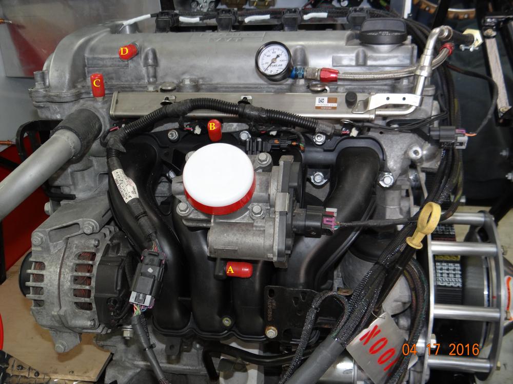

In the picture of my last post, #190, i forgot to specify there is a clearance issue with the two bottom bolts fixing the adaptor plate to the Ecotec engine; i replaced the two sockets head cap screws by two 90* countersunk flat head screws!
In this picture, ECOTEC engine intake side
A- Vacuum port for brake booster : permanently shut off
B- Vacuum port : permanently shut off
C- Cooling system port : i have installed a valve to remove air bubble from . . the cooling system
D- Crank case vent port : must be open all the time

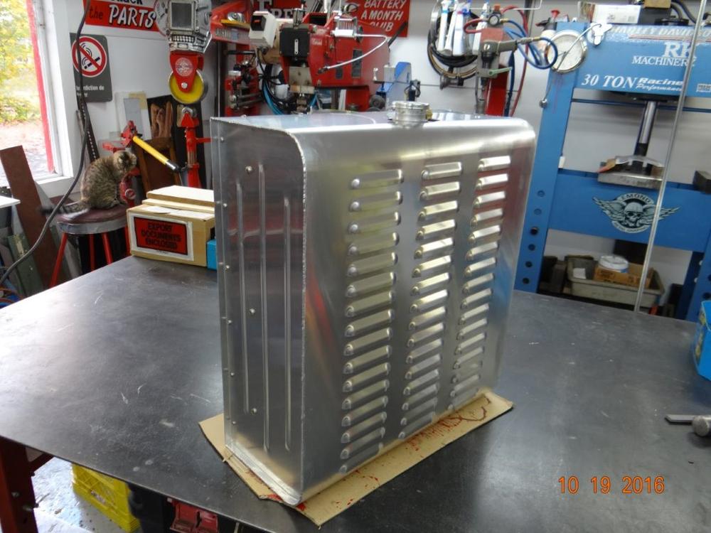

In the SNOWTRAC ECOTEC Conversion there is no adequate place in the engine compartment with the front engine mount to install the radiator , so a rear position was selected
The use of heat exchanger ; the black tubings that carry the “ Prestone “ from the engine to the radiator and diffuse by the splash of the snow at least 35% of the heat are an important part in the complex cooling system ( see VIDEO page 5 post 81 )
To install and protect the radiator and electric fans I have made an aluminium capsule

You can see a video during the fabrication of a radiator capsule for an other snowmobile project ( the process is the same for the SNOWTRAC application):whistling:
[ame="http://www.youtube.com/watch?v=3K72C_NJw_o"]http://www.youtube.com/watch?v=3K72C_NJw_o[/ame]

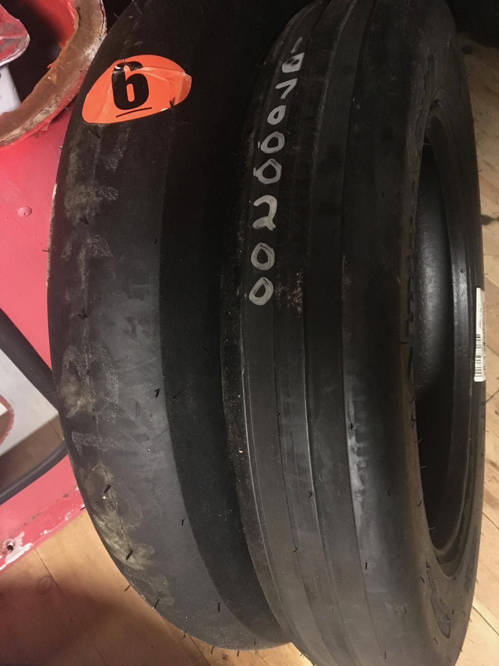

Hi Louis, The more I see of your project, the more impressed I get. My own Ecotec conversion is coming along slowly. Before starting the conversion though, I want the rest of the Snow Trac to be 100% ok. I´m in the process of changing all the bushings, bearings, tires, renovating transmission etc etc. Hopefully I´ll get there in the end :-)
What tyres are you using for the big wheels? I have some Alpine-Guide tires, but they look a little to wide... I also have some Bombardier (?) slick tires. they look very good, but I would like to try the Alpine-Guide tires if they fit inside the track guides..
Alpine-Guide on the right in the photo..
Hi nwerring ,
I will use this occasion to give you and all members of Forums Forums, my best wishes for 2017
You will see on the picture I've used four Alpine guide tires for my big wheels.
In my opinion, they do the job very well !!
Here are some comments for the installation of the Alpine guide:
1) If you are planing to do business with a tire company and they say they have a $ 10 000 computer assist machine , please do yourself a favor and run away as fast as you can ! A new technology tire machine will surely damage the tire, the tube or the rim and they will say the $ 10 000 machine is OK and your tire and rim set up are wrong.
2) The only way to have a successful installation is to use a vintage manual machine
3) During the installation, you should use powder between the tube and the tire. Between the tire and the rim, you should use soap.
4) The temperature in the shop must be at least 25 degrees Celcius and your assistant must apply heat with a heat gun on the tire
The three most important things are: HEAT, HEAT, HEAT
If the tire reaches the right temperature it will go easily!
Hope you will have a success with the installation !!!!!!!!!!!!!!!
