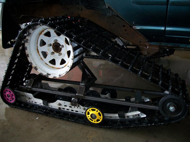

Did you build the rear tracks or were those pre-made bolt on units like Mattracks?

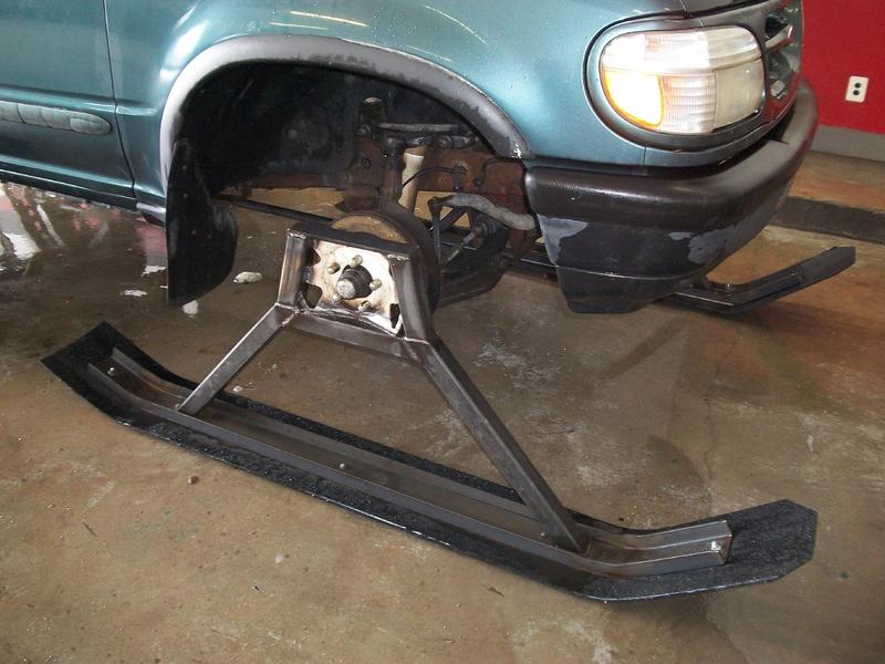

How about some close up photos of the ski-construction? Ditto close up photos of the tracks!!!

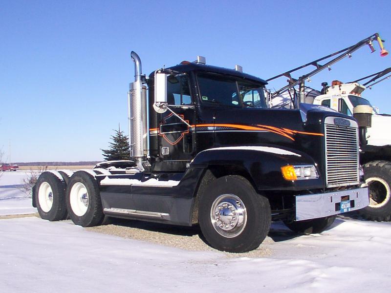

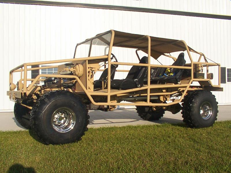

Ive also built This....

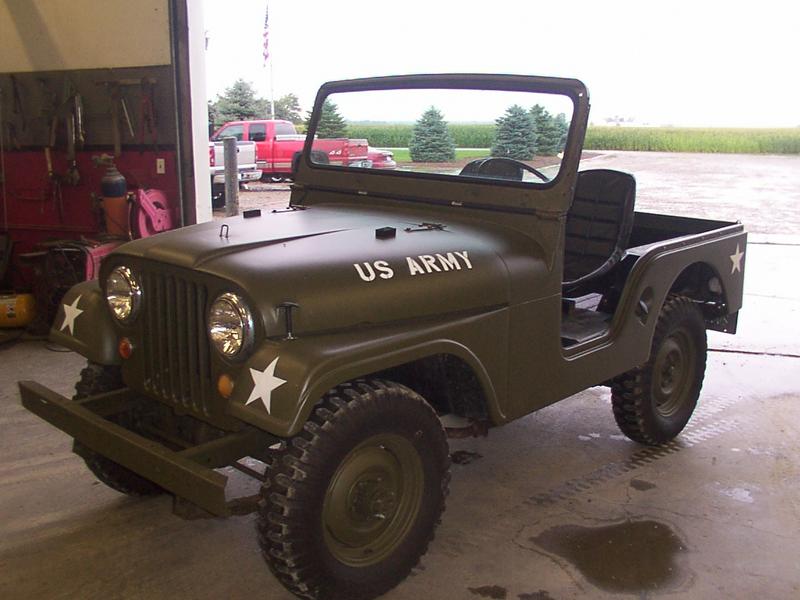

and rebuilt these...

How's it steer? Did you have to put a rib on the bottom of the skis to get some bite while turning?
Also, I call dibs on the army jeep!!!!!!!!!!!

The skis are really simple, They are a 4 inch channell with the ends bent up under that I used a piece of 3/8" plastic that we use on the bottom of semi trailers (kind if a bed liner on royds) it is sandwiched in place by a 1"x3/4" piece of flat stock. It will turn in its normall radious in most cases, I would say it turns better than my sled.

Can you give me the details on the tracks???
The skis look pretty easy to fabricate. The drive wheel looks like it is a wider
than stock wheel with bars(???) welded across it. And a track (belt) from a
snowmobile. Track adjustment with the magenta boogies on the rear??

The tracks are 138" snowmobile tracks on standard 121 frames. you need to add front bogies, yes tension with the rear set. The wheels are or were 15 x 8, you need to turn them down a little and weld on 20 1/2" round stock bars.
I thought about using a 4x4 unit for this thing but after building this one I see no need for four wheel drive. we were in 2 feet of undisturbed snow in the video on the trail and have no truble with it.

I am sure it works on a flat trail with 2 feet or less snow. But less sure it would work in a wide road ditch full of snow 4-5 or more feet deep. What keeps the front ski's from coming around if they are bolted onto the hubs? That would be nasty of you nosed it over into a ditch full of snow and they caught, rolling them into the rocker panels.:ermm::doh: If you weigh it and divide it by it's foot print in inches, to get PSI, I am betting 5lb/in sq. and that is good for say mud, but so good in snow, especially deep non reactionary snow. ( deep enough it doesn't put the weight to the actual ground under the cat) Good "snow cat" territory is more like 1.5lb/in.sq. and less....

Actually I weighed it before we ever started (another reason to go 2wd) The Tracks put down 900 Sq Inch while the skis only put down 720. Times that by 2 and get 3,240 sq inchs ... put a 3,970# vehicle on top and your putting down 1.2253086419 Lbs/sq in. about . :whistling:
While I do agree that Im not exacly distributing the weight properly (but I could with bigger skis) I Am running down the trail at up to 50 mph while most sno cats go about 12 mph while trying to remove your fillings and cost $15,000 for a piece of $#!t.
I have also welded a piece of steel to the back of the brake roter wher the caliper used to be to limit travel.

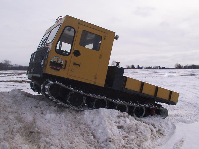

As for your ride, I don't think this would do well against a machine with 1.5 lb. ground preasure, as most groomers are in this area of down preasure. The true snow cat is not pushing ski's, all the area is under powered tracks, not ski's. A 40 some year old Snow Trac is at .75 psi. and goes 20 mph (nearly 30 mph with gears) and the ride is smooth if the snow is 6" deep. And it will go places in deep snow your creation will not go....:whistling::doh:
