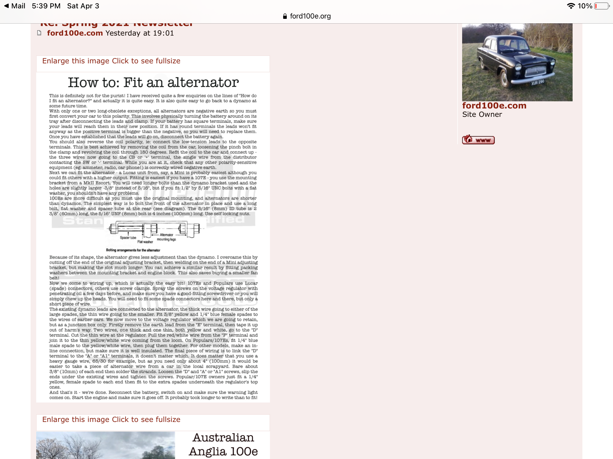

Our 57 Kitten has a 12 volt battery , Starter and Generator. It looks like the Ford Anglia 100e , the source of the kitten engine, had a 12 volt system from 1955.
Pontoon Princess
Cattitute
What are your thoughts on the ‘54 12v generator? Could it have had a 12v generator in it originally?
NO, all of the round door kittens were 6 volt from the factory, but, that did not stop someone from changing it to 12 volt, best reason for the change, was it spin the engine faster on those cold days

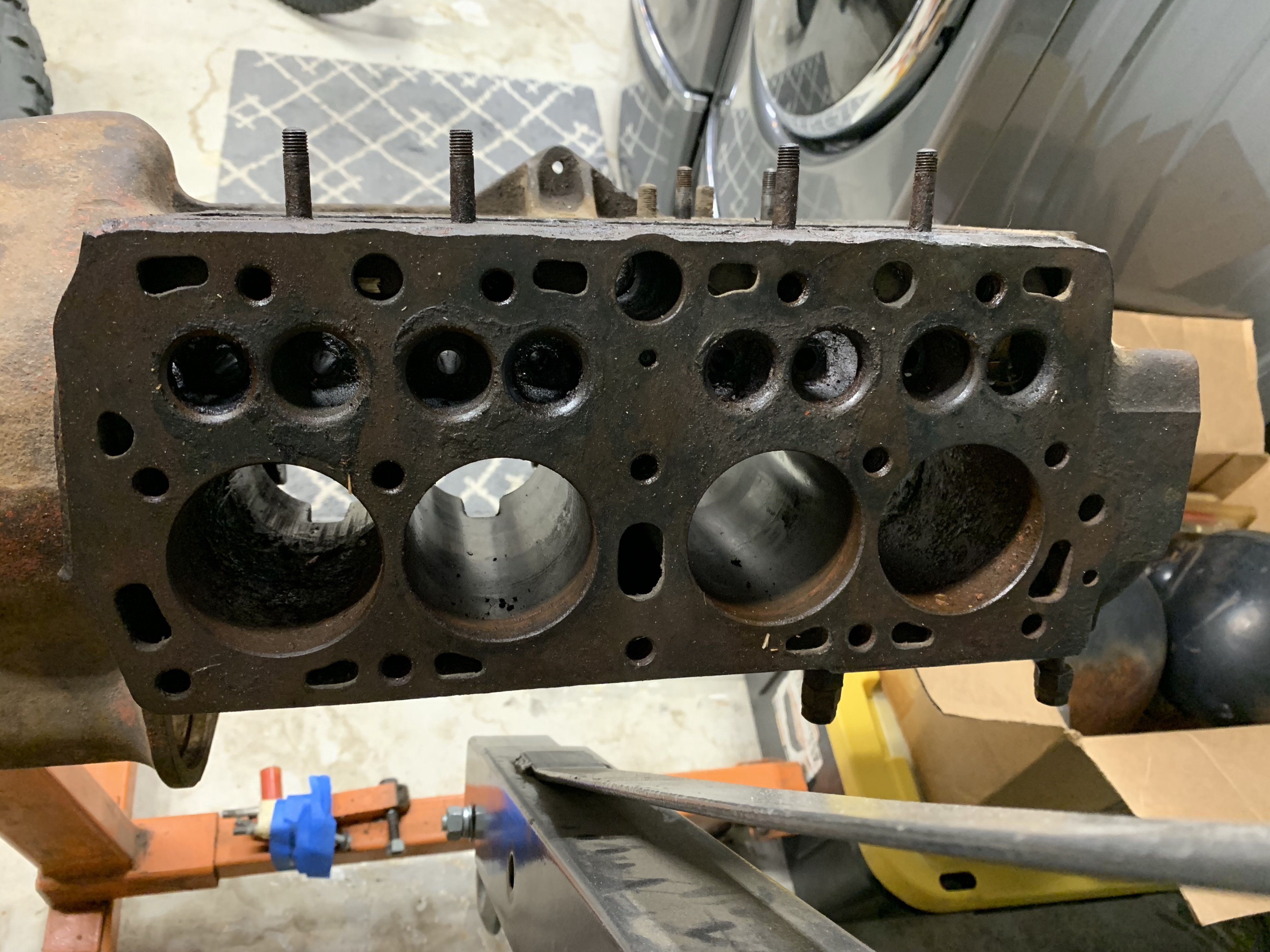

Started tearing the motor down today. Just have to get the valves out and it will be ready for the machine shop.
Figured out why the motor was pulled - found a broken cam follower

I’m pretty sure all the parts are available. I know there is a place local to me that specializes in Anglias. I gotta get it over to the machine shop to make the sure the block is salvageable.
GMoose
Could you place a quarter by those pistons and post another picture of them so we can see just how small they are.

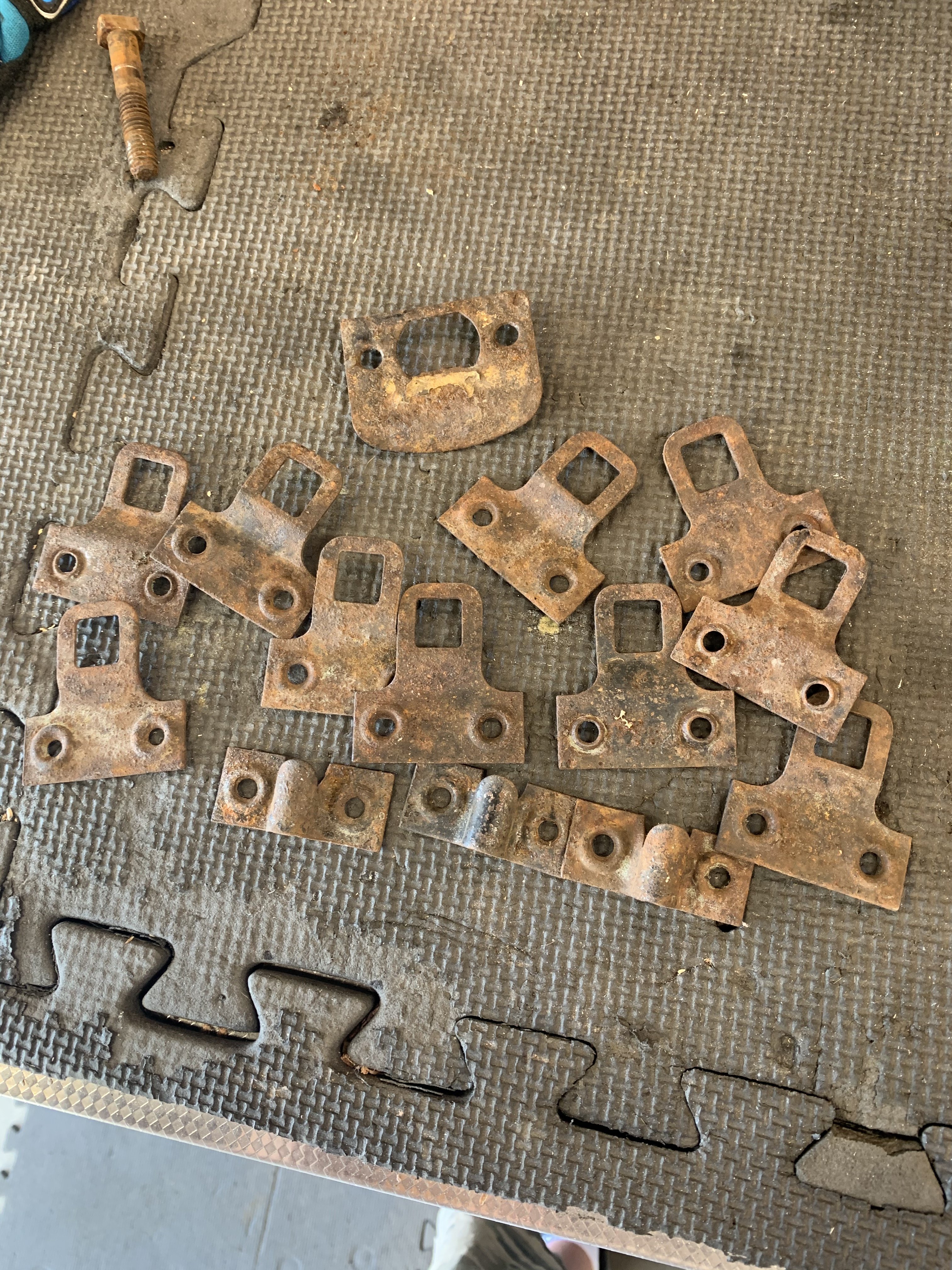

I just found all of these in the debris inside my pontoons. Obviously I recognize the house door latch - but does anyone recognize the other pieces?
Track Addict
Seatbelt ends and hood latch catches? The narrow pontoons were tippy so keep your arms and legs inside the vehicle.

just about every thing that was 6 volt would be changed over to 12 volt and that would include tucker kittens that were built in '54 that had a newer engine put in... no surprises
