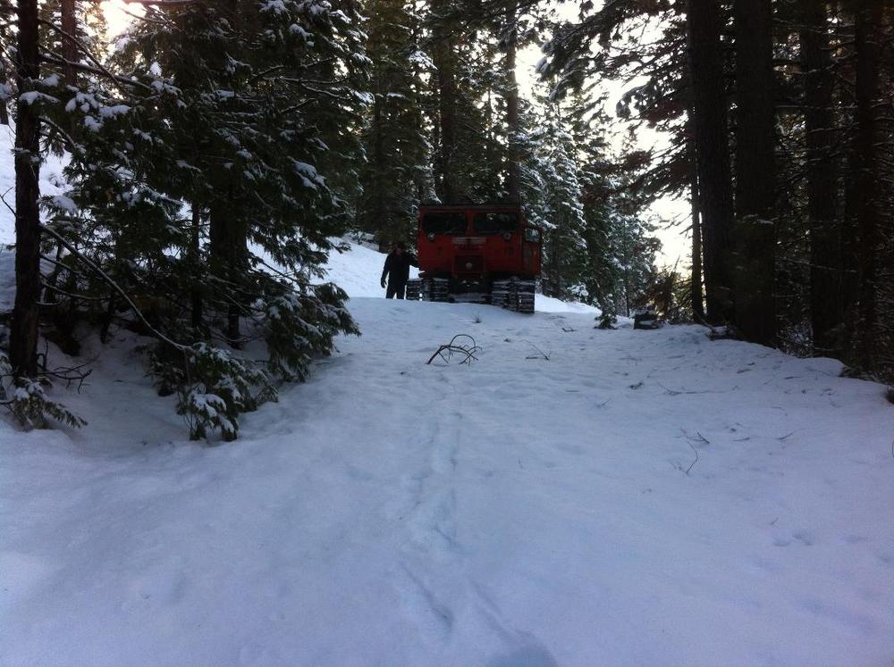

I think that statement has a lot of truth to it. I haven't scared myself yet and I don't plan on it (not on purpose anyway). But I maybe I've been in bad situations and too inexperienced to know it?? I go slow stay away of where I think the edge of the road might be, stay away from tree wells and look for water running under the snow. other than that I don't think on my trip there is anything else that could hurt me other than a breakdown.
goes down and up no problem. I didn't put an angle finder but every bit of 20 plus degrees.
