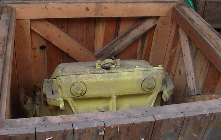

Start building LMC 1200's again. Chose an injected gasoline engine, a 5-speed automatic, and start building OC-12 differentials again. For a versatile performer you aren't going to do any better than this without using diesel hydrostatic$$$$$.
Thanks everybody:tiphat: We like to here what you have say We have designed a differential have yet to test in a snowcat it does not drag the Hp of the machine down like a convential controlled differential dont get me wrong they do work and have worked for years. The T-16 was first which actual was used in the Military Bren gun Carrier in the 30's and is what most of the Bombardiers used except the bigger ones either used OC-15 or the M-24 Tank differential we have several of these now they are used on rigs that weigh up to 48,000 pounds There was a OC-21 for awhile does any body
know of any now? The OC-15 were used also not only on the 601 but also on some of the RN-110 carriers we have one of those now rated at about 28,000
pound with cargo. We are alwas looking for more M-24 Differentials or parts for them they are getting harder to find.
We have included a picture of a M-24 controlled Differential This one is new still in the Military crate
