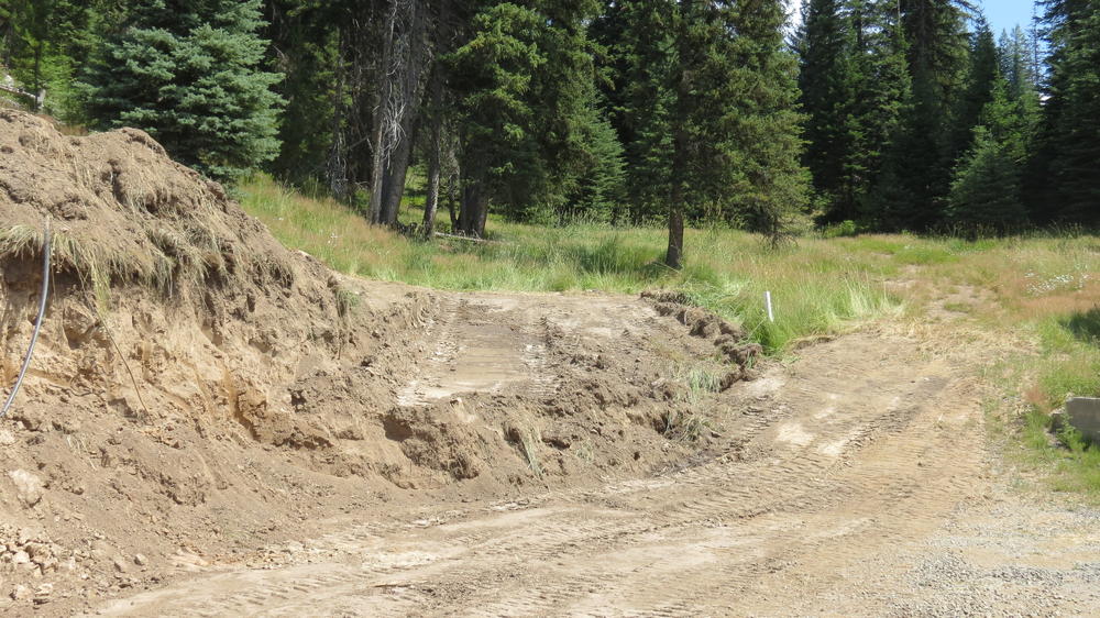

Got a excavator , 16 yard Peterbuilt dump truck and 1 small loader moving dirt for my new RV Garage . Looks like at least three more full days of digging to put it the pad behind the house . I have not ran a Pete in about 20 years . It was a fun day . All the excess dirt is going below the house to form a gentle slope to the pasture , I figure about another 125 dump loads might get us close to having a pad . We are going in 20 feet into the hillside and then sloping the grade to the pad .

Man , I was busier than a two peckered Billy Goat to day !! Dumped the truck as it was filled , Take it back to the fill site , then run for the tractor to spread the dirt in the new area after it was dumped.
Greased and fueled the tractor and Pre Oped the truck for tomorrow . Had 4 zerts refusing to take grease so that took an hour to get the grease pin holes opened again . The loader levers started acting up around noon time and I spent another hour fixin that this evening . Still managed to connect the grader box to my Tractor this evening and started finish grading the slope where the new dirt is being used . I think we are still looking at 2 days ,by the time we get the rest of the dirt moved and then go back and finish slope the cut on the hill side .
Oh ,,,,, did I mention the excavator threw a track at quitting time so guess what we are doing first thing in the morning ???

Well , progress continues . The block foundation is now finished with French drains and a 18" culvert behind the wall next to the cut bank to drain the runoff from the ditch . The lumber package is sitting on the trailer and I will start framing in the morning by myself. The boys are on another project for a few days , so I am going to set Mudsills and precut the building lumber so we can roll when they get time to be here . So far I have about 2 grand in framing lumber. Metal siding will be extra .

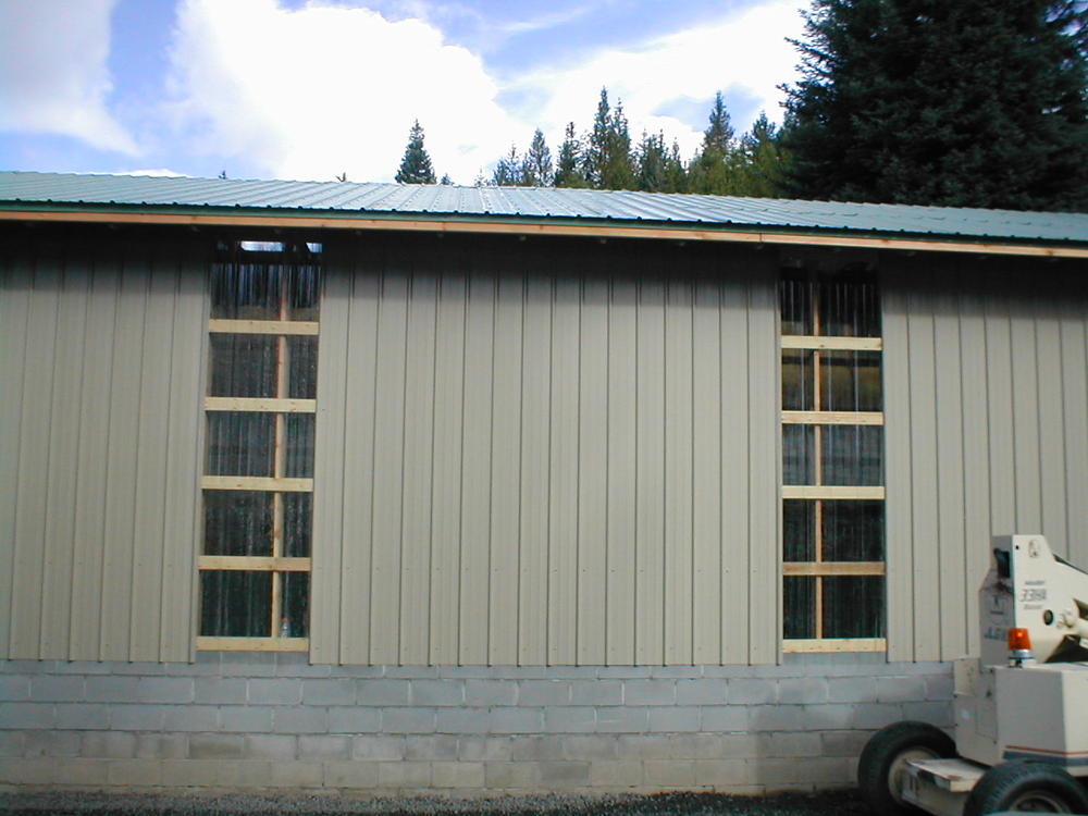

Rafters are now in place . Tomorrow I do some pickup work and get ready to sheet the roof . No way in hell I would have tried to do this without my trusty Boom lift . It was a life saver . Working with a 20" side wall is kinda tough . Had to do a little engineering to give some additional side load support . It was well worth it .Roof metal starts going up on Monday . Pictures soon .
Ta Da !!!!
My part of building my RV storage garage is done :clap:. It finished out 14'x 46' long . The door height is 14'4" and is 11'6" in width . I will be able to open the Trailer slides with it stored in the garage . Total cost to build was right at $8 K . I added a 18" drain pipe the full length of the building to catch the water as it runs off the hillside . There are also 2 - 4" French drains installed too . The front of the building gave me some concerns on side shear as the building is so long and tall without any interior cross walls . I corrected this by "double shearing" the front door opening and installing a "scissor shear system" in the ceiling joist that transfer side shear load all the way back to the sheared reinforced rear wall . I had never done a shear system design like this before , but it seems to have added the side strength to the front wall I needed .
The boys should be back next week to install the steel siding on the one remaining wall that my old bones are to old to be playing with . I used my trusty Boom lift on everything else .
