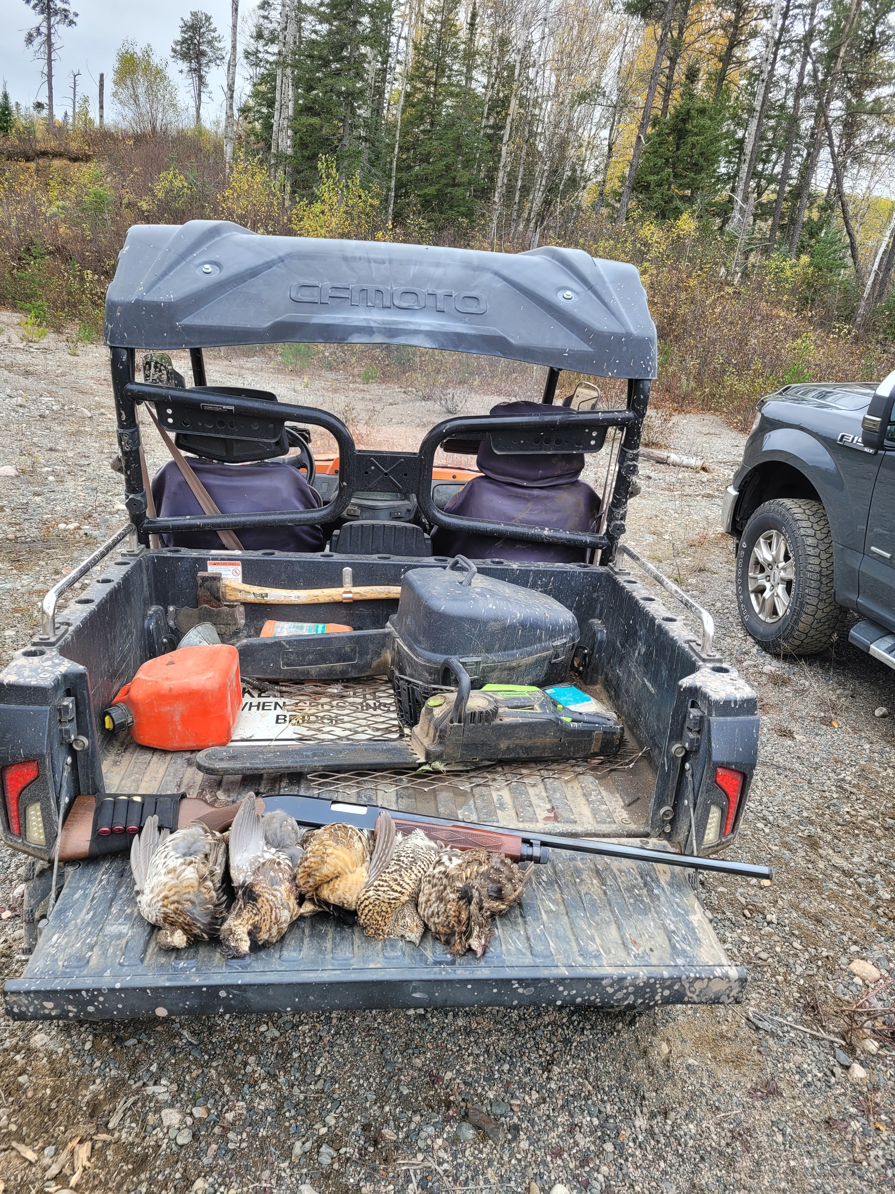

I used my trusted old Winchester 2200 12ga for old times sake.

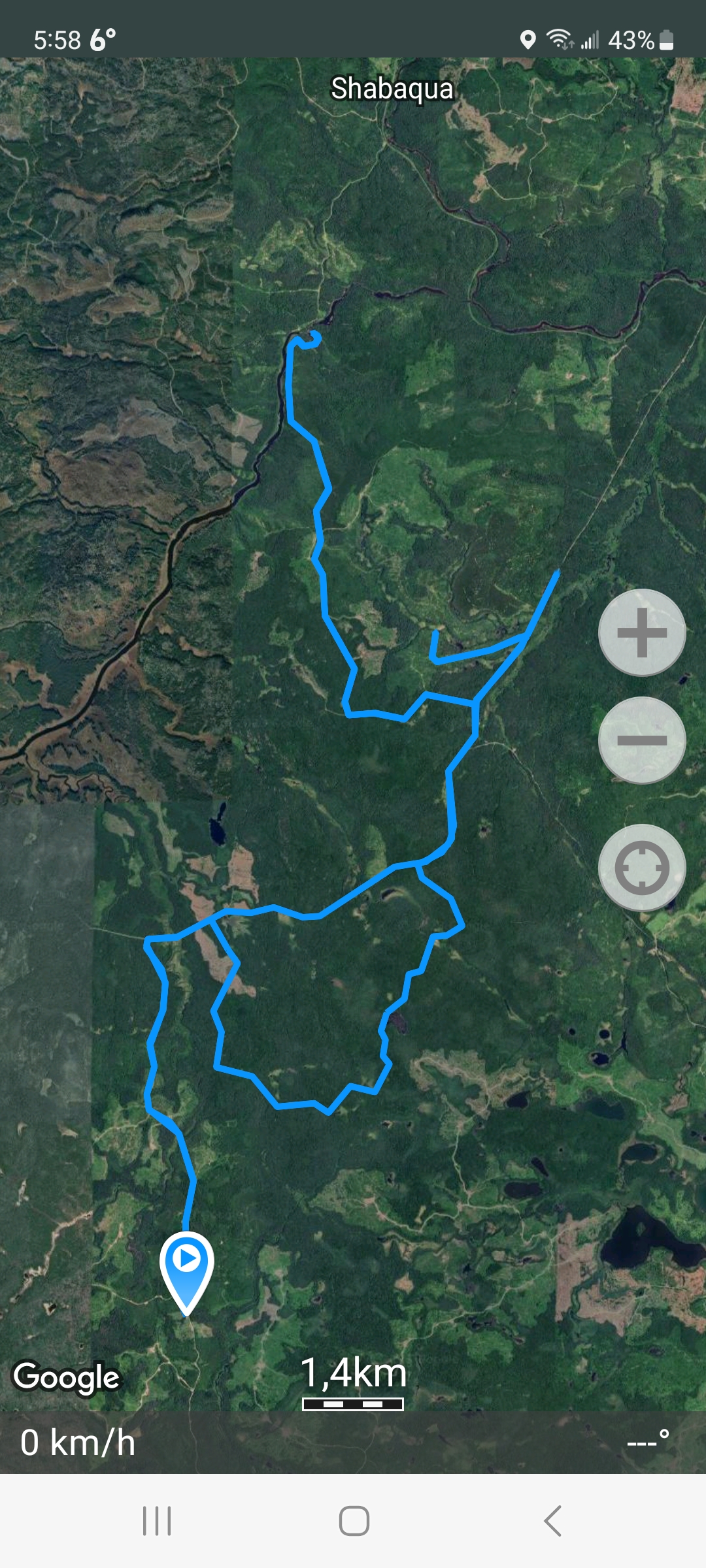

I use an app called GEOTRACKER to track my motions in the woods. Even without cell service, it works showing me exactly where I am which is a good thing as I normally cover 80 to 100km while out hunting.

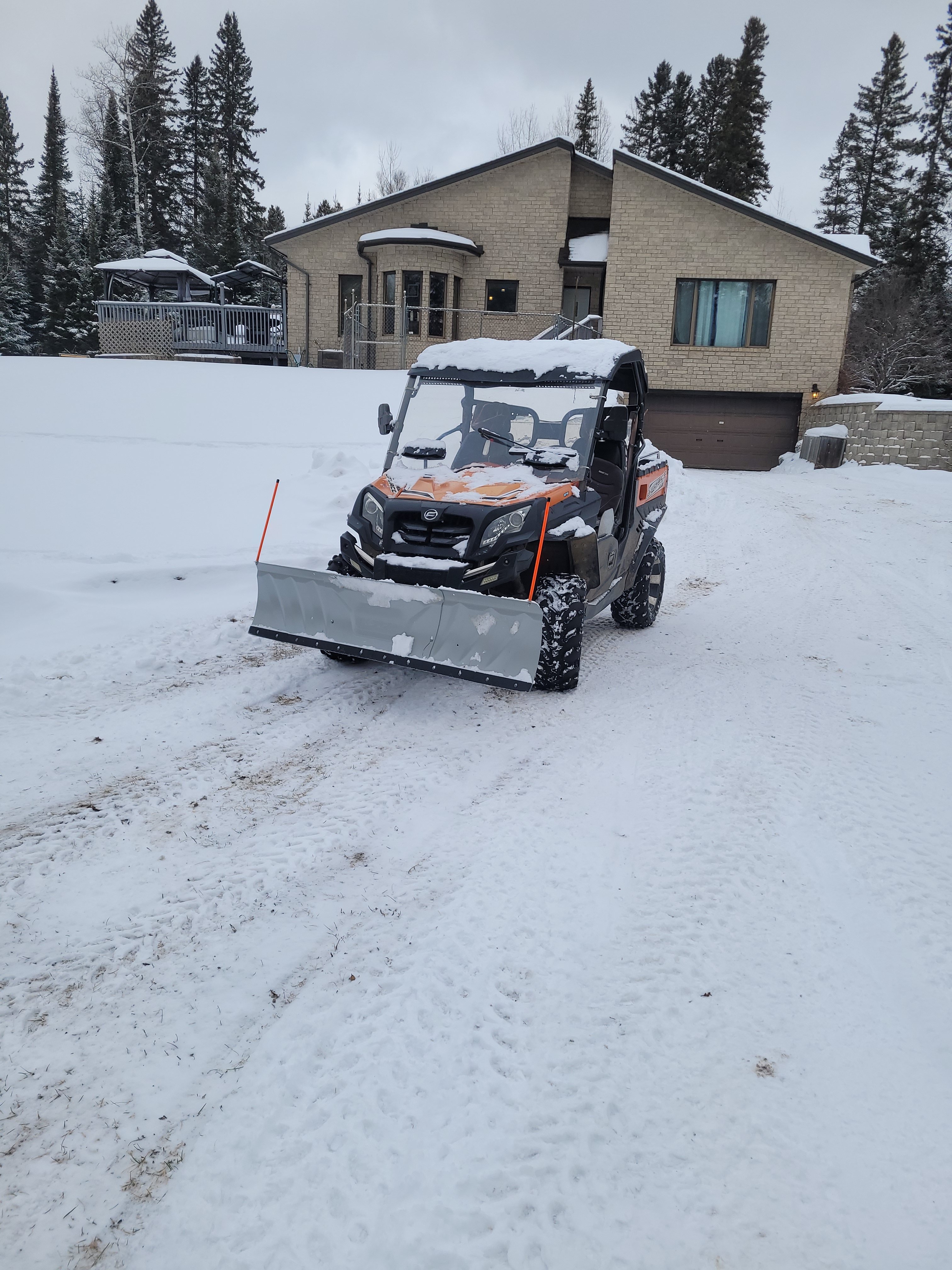

When we moved to the country, we bought an older plow truck to maintain the driveway. After 3 years, the transmission blew on it so we replaced it with another one. Dealing with an older driveline meant constant maintenance and often I'd be caught with my pants down, so to speak with my plow truck down for maintenance and a snowstorm coming. Meaning I would have to spend $70 on a loader to come in and clean up. I saw a deal on a like new used 72" kolpin plow for a utv before Christmas and picked it up for a backup plow and installed it. After 45 minutes of plowing, my winch became stuck in freewheel mode rendering it useless so I ordered a new one on Amazon and installed it the other day. I will say that I'm very impressed with it. I was of the mindset previously that it would take forever to do everything but in reality, it takes me an hour to plow with the truck and I was done in 1.5 hrs with the sxs and I can get in tighter places with it like the entrances to the garage as I back into the garage then push the snow out.
