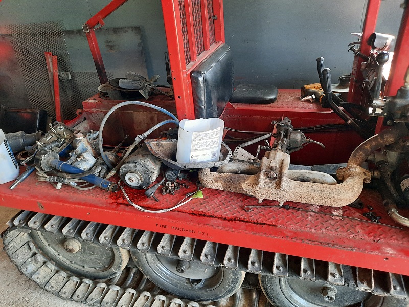

Finally got started on swapping the J5 motor, we made a few trips hauling last winter, it refused to die, but it's time has come. The candidate 265 is now on the engine stand, needs a bit of tidying up and swap the accessories.

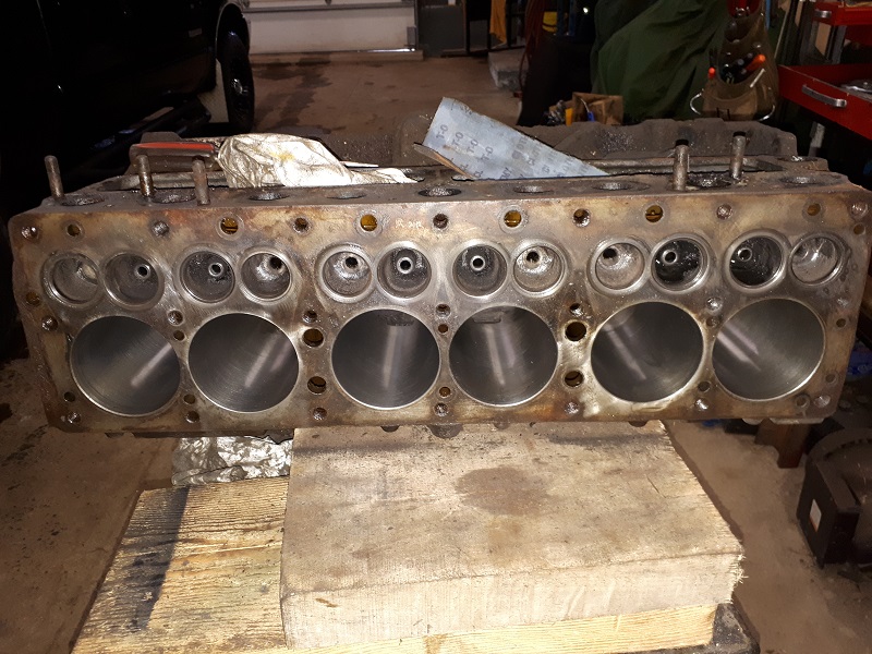

Just waiting on a pan gskt , pistons were pulled and the block a quick hone . Still have to rig the remote oil filter to the full flow ports as opposed to running the filter as a by pass , I didn't know Chrysler had that on their later production blocks , Industrial only ? . The 251 pulled from this J5 also was full flow, these are the only two out of all the flatheads I've worked on , that I've seen. Definitely would lengthen your engine life, although both of these motors were jumped at the ports with no filters , by previous owners. Yes , "Quebec Chrome" on the manifold, it won't be as flashy once it warms up !

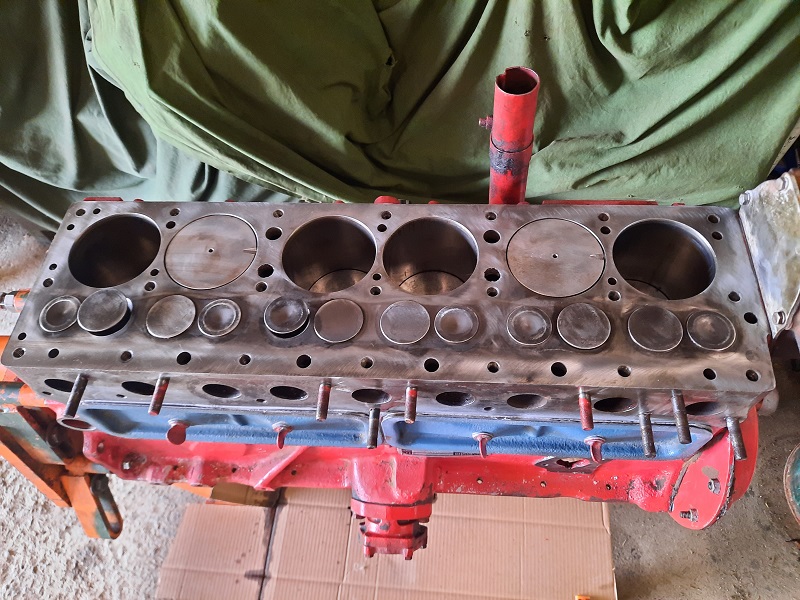

Guess the sidewalk will have to wait as our first J5 has excessive blow by , its 16 years since the motor was installed and other than a head gskt has been trouble free. The 251 is a military rebuild from 1971, compression was low on all 6cyls , so we pulled it today and pressure washed everything, tomorrow we'll open it up and have a peak.

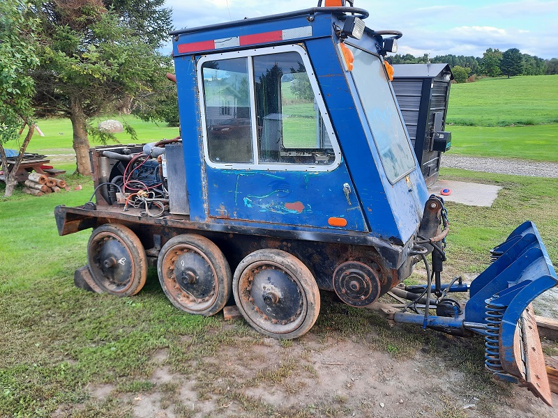

Started tearing down my SW48 Diesel, going to empty the tub , descale and paint at least . Everything goes back in and suspension installed, cab bodywork we'll see. It deserves it's own thread, but be warned, restoration work will not match Bobcatbob's pristine resto of his SW48 a couple years ago ! Talk about a tough act to follow ......... :hammer:

When I bought that unit , the diff was removed ( with a bad gear set), which sold separately 3 hours later at the Auction :confused: , Ya I got it ! . "Don't Run" was written on the windshield, which turned out to be a bad ground at the back of the head. So I had it running, trans shifted through the gears, then put it in the shed for at least 8 years. Kind of hoping to change fluids and filters on the motor /trans , with a spit shine , but we'll see how things progress.

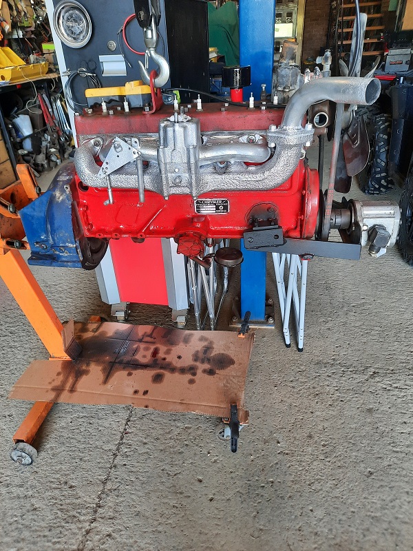

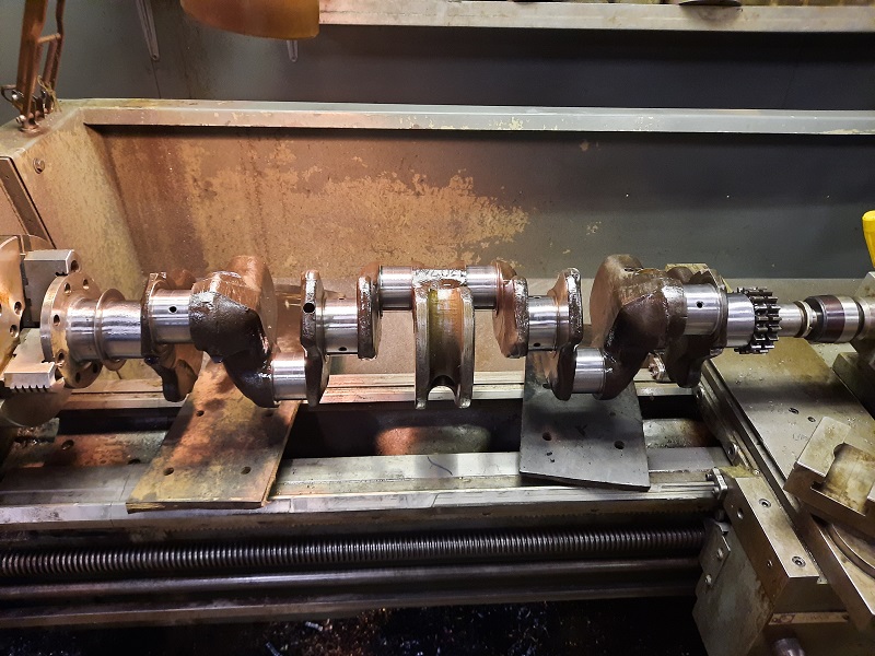

Got the crank polished and the valves cut for the 251, just waiting for some valve guides coming from Rock Auto and start to get this flathead together.

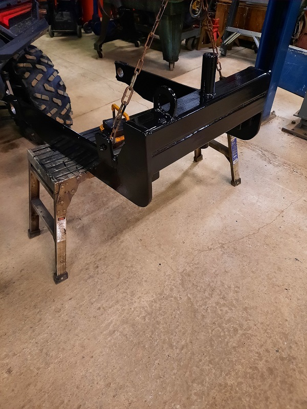

My 1959 J5 , had a shake down run this afternoon, the used 265 is running pretty good, going to need a little more carb work and a bad can on the left side replaced .Bored out a couple blocks on the lathe yesterday, cut them and finished on the mill today, it's the start point to built a hitch for this J5 . I couldn't find a used hitch and it's a must when towing a Bombardier trailer.

Got the hitch pretty well mocked up , have a few gussets to tack in and figure out how to lock it in place when not towing. Then it can come off for some welding / grinding and paint . Pretty sure it's the first time this pre 1960 J5 has been on a hoist .....

The hitch is installed, may change the locks for the side pins, but it should be good for now. The bottom hitch is removable, when towing a trailer and to mount a snatch block for skidding. Have to pick up some plate to rebuild the trailer mount and tubing to lengthen the pivot tube as the boom sticks back to far and will interfere with the load.
