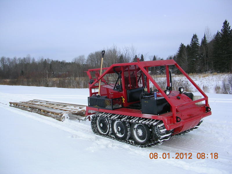

Ok ,there is no such thing as a "Quickie" when it comes to snocats ! Ended up stripping the running gear off the J5, nothing to drastic, a few beam bearings and fix the [spring in a can]. Swap a few tires and the tracks will make a couple more seasons,I replaced around 15 crossers. Rebuilt the Dash yesterday, have to change the motor mounts, water pump,tuneup , install hyd pump and winch, some minor sheet metal, paint ,other than that almost ready to go !:whistling:
J5 Bombardier

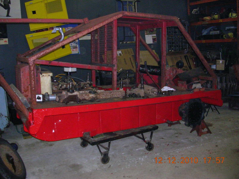

I finished welding up the back end of the hull and slapped on some paint,the motor was cleaned up and was given a quick check, then back in the hull it went.
The snow has taken a beating with the rain and high temps for the last couple of days, so I guess we'll keep playing in the garage until the white stuff comes back ! Happy New Year
J5 Bombardier

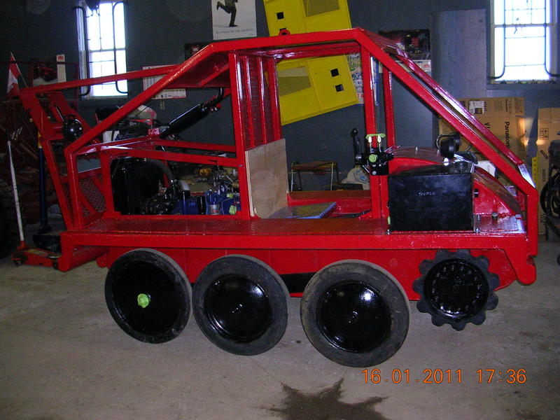

The J5 is progressing along, fast for me for me that is ! Old man winter is still not coming through in any quantity, may have to import some from south of the border !
J5 Bombardier:flagcan:

MNoutdoors RIP
Nice Work........... looks like your protected from overhead.
northeastheavy
Great picture with the engine and dash work done!!! looks real nice!!! Your at the point its really coming together!!!! Must feel good!! Now I wish I did'nt have to trade my j5 in for the new cat. Good luck!!! Get it out in the snow now!!!

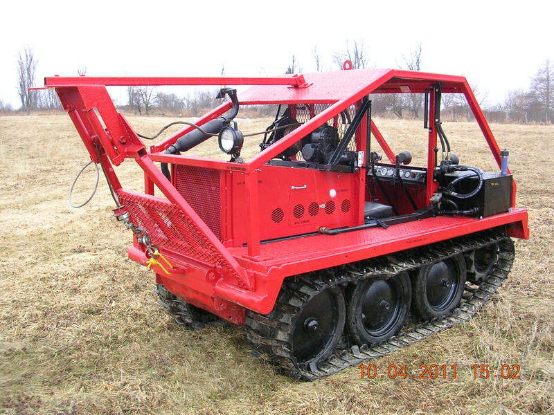

So this is it for the "Quickie" J5 Bombardier check over and out the door fast project ! It got a little more involved than that ,but four months later it's finished and ready to be parked for the summer. I finished installing the winch levers today and a few other brackets , drove it out of the garage into the rain,took a few pics and that's all she wrote !
J5 Bombardier:hammer:

pixie
Looks pretty rugged and useful !
I like the small door to check the oil !!

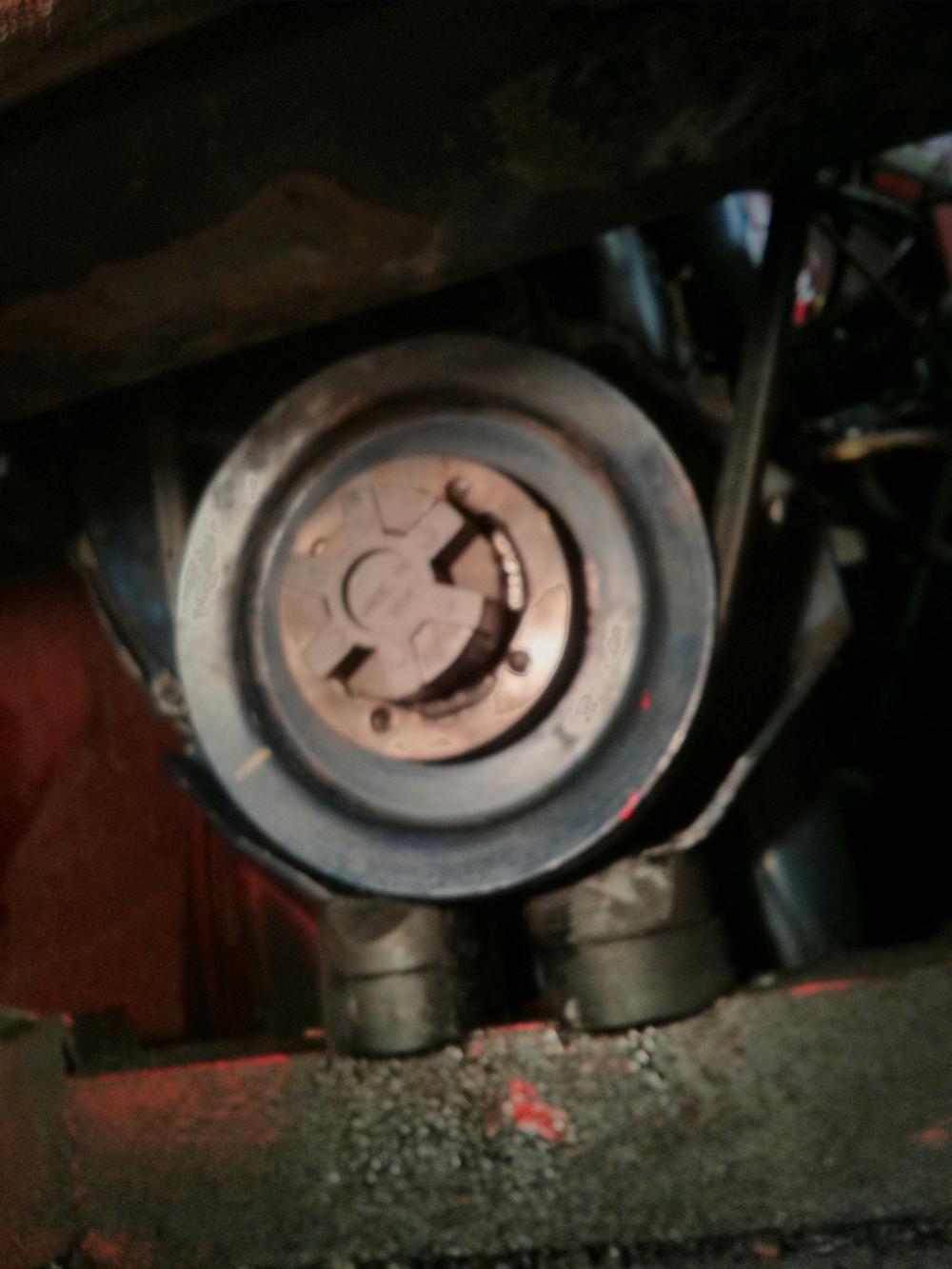

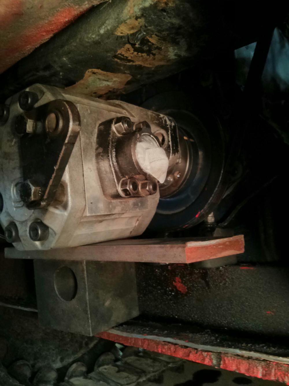

After 4 plus years, I've decided to go with a hyd pump driven off the crank . The belt driven pump ,first installed, never was satisfactory, so an access hole was cut into the hull .After raising the rad and fabbing up a drive off the crank pulley , the next step is to make a mount on the engine to hold the pump. To be continued.

pixie
I'll be checking on your progress :)
My J5 had a hydraulic pump on the crank to run the plow. The winch is run by PTO.
Whoever mounted the pump did a lousy job and I had to remove it. My plow is now run by an electric hydraulic pump.
The hydraulic pump seems to be the reason they replaced the 251 with a 230 to gain the 2" in there. They should have just cut a hole. Tub is already boxed out on the left side rear for the PTO.
