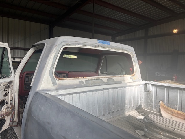

Whenever you tape around something, that’s where the edge can start to peel or chip, the wind shield and rear window are installed with a big rubber gasket and I want to paint under it. Everything else was removed for the same reason.
i have tucked a small rope under the lip of the seal with great success, just aim a little paint and clear under it at the start of your coat
That’s a good idea and have thought about doing somthing like that and may experiment, but for a hundred bucks or so having it done isn’t a deal breaker.

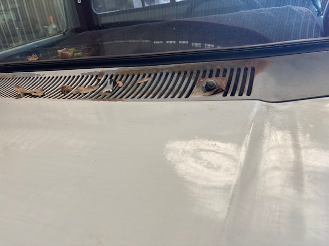

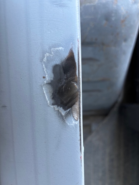

This area had been repair sometime in the passed, it’s a classic example of why you don’t put filler over holes.
The filler had cracks that extended thru the paint, when removed, it was found that the holes let in moisture that then surface rusted under the filler and separated, if your in a cold climate it can be amplified by moisture getting in then freezing, just like it splits big rocks. I welded in a patch to eliminate that. The mig and .023 wire made it easy.

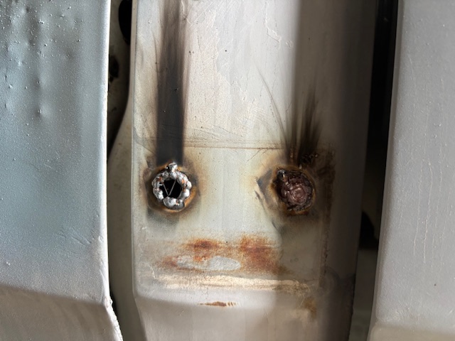

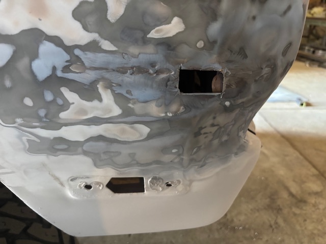

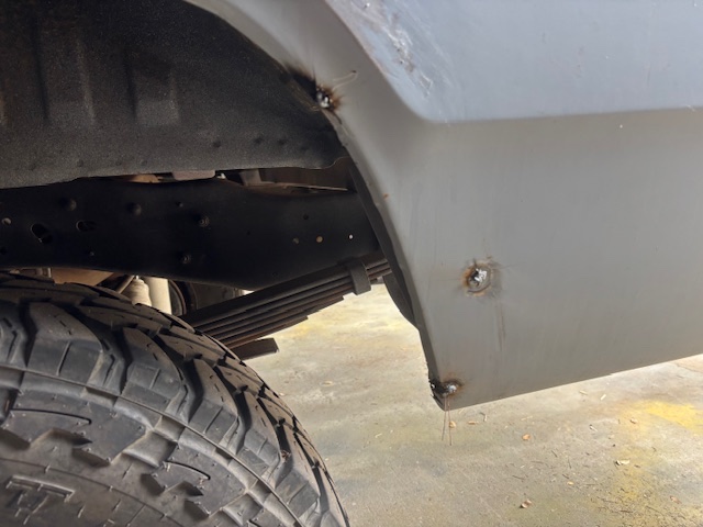

Welded up the OE holes for body trim and fender flares, I am deleting the trim and fender flares, looks cleaner to me.

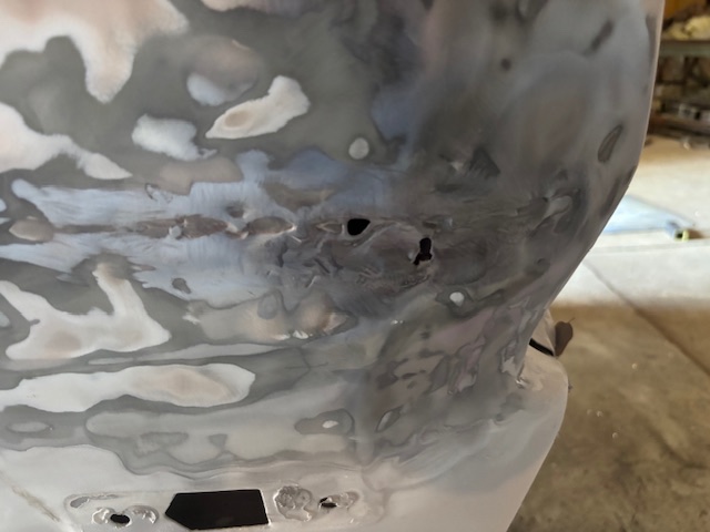

The top of the bed was Swiss cheese, I counted 16 drilled holes of various sizes ranging from 1/4” to 1/2” on both sides. That’s over 30 holes WTF.
Now that one of the long boards and sandpaper showed up, I went and got some filler and a cheese grater rasp to knock it down some before sanding. I have a little more dent pulling and then it’s time for the filler. I would like to paint it before thanksgiving.

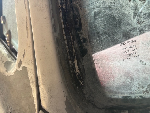

Found silicone at the top of the windshield gasket, so now it has to come out for sure, got a price today for a mobile glass guy to remove the windshield and rear glass then come back after paint and re install with new gaskets. $450.00
$100.00 in and out for each and $50.00 for the gasket.

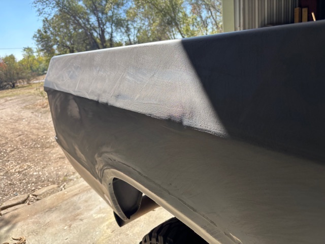

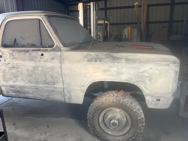

Busy day today, had a bunch of domestic to do, dump run etc. after lunch I took a few minutes to quickly sweep,the painted surfaces with a long board with 80 grit, the shiny spot on the hood is low, likely from someone’s fat ass sitting on it. The bed sides mostly small dents on the body lines, worse panel by far is the driver door. Tomorrow I have to get some materials for the last job we are finishing and drop it off in Modesto, while I’m out I plan to pick up some white primer and some flat black to fog on the primer then sand off with the board to reveal low spots. Next week I’ll be retired and can get after it. Shouldn’t be more than a couple weeks before it’s primed, blocked out and ready for paint.
Today, I spent about 6 hours fixing the worse panel on the truck, the flat panel on the driver door, after filling and blocking then using black primer for guide coat, then repeating that process a bunch of times that panel is now the straightest panel on the truck. Tomorrow I’ll fix the panel above with the window and the lower door panel. The fender and bed on this side won’t require a lot, mostly scratches and a few small dings.

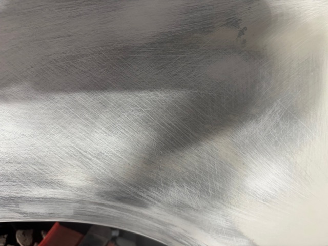

Today I started the wet block sanding with 180 grit, yesterday I hit the body work areas with primer that were done with 80 grit. The last picture up close shows the 80 grit scratches that have been filled with primer as I sanded it down with the 180 grit.
I put some more white rattle can primer on those areas to be sanded tomorrow. After sanding, I plan to roll it outside and wash it, then the next step is to pull the windshield and rear slider, prime the whole truck and begin the wet sanding on the whole thing, the goal is to block the whole thing down progressing from 180, 220, 320,400 to 600 with no burn thru so the whole truck is white sanded to 600 grit, then the paint. I’m running a little behind my self imposed schedule of getting it painted by thanksgiving. The truck has zero rust issues but its the worse vehicle I have ever done the body work on without changing fenders and doors, that would have saved a lot of work. The problem is is it’s very difficult to find parts for these trucks without buying a whole truck for the parts and when you can find doors and fenders they normally have some kind of damage on them anyway like the replacement tailgate that costed $250.00 it was a bitch but it’s straight now.
Been cold here but I managed to get the rear slider out without breaking it or ruining the gasket,then used a razor knife to cut the outside of the windshield gasket off exposing the windshield, when my son returns Monday I can lift it out, no sense taking a chance on dropping it to save a day.
