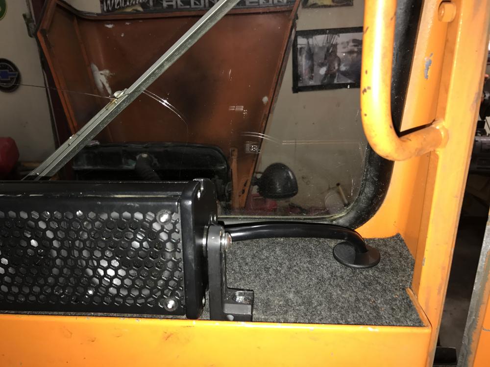

Put a CB antenna in to fill the hole and after all it is a radio cat. Installed the missing rear door bumpers and mock installed the sub woofer and sound bar. For a clean nice sounding plug and play system the stealth 10 and stealth 6 sub is tough to beat.

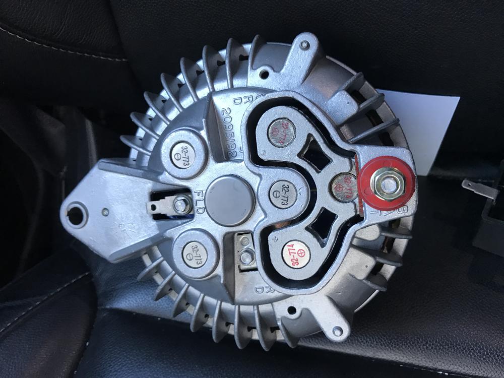

1. There is a draw the kills the battery over a few days. Everything is stock looking at the wiring. Nothing is keyed other than the ignition module from the looks of it. What could it be? I don't have the new stereo installed and haven't changed anything .

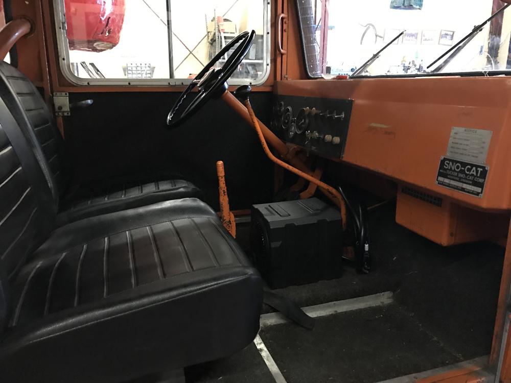

2. Three toggle switches lines up in a row. Heat/defrost/wipers have their own. One is headlight/dashlight left toggle.No high low beam from what I can tell. Middle toggle is mystery switch. Right is rear light. Dome wired direct and on a button on the light. Haven't traced middle switch but figured someone may know?
3. Wiper knob/switch has three positions one is park and stops the wipers at the same location low on the windshield. Other position is on. The third seems to
Stop the wipers at any location your turn it to this position but if you move the actual wiper arm manual and start the motion it does one swipe. Odd

Check the alternator, a bad diode can do this. If it is shorted, it will show fast, but a bad leaking diode can drain the battery over days.

Great tips. I am following Loggah's advice and seeing if I get a draw with the wire unhooked.

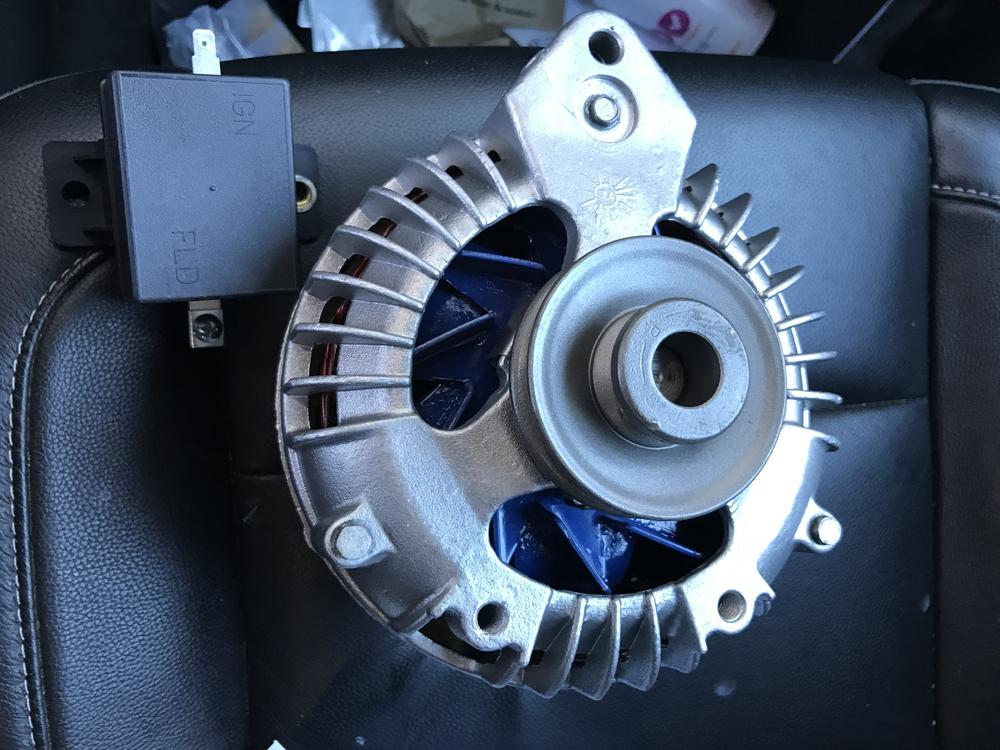

Alternator is a round back 2095191. Bearing sounds a little loud. Local shop in Lawrence can rebuild and test the voltage regulator. Thinking this is the move.
Took the alternator and voltage regulator off. Dropping off for rebuild tomorrow. Battery voltage holding strong will continue monitor but think this was the problem.

Sorted out the switch situation. One is headlight which I knew, then the middle goes to this power block which is currently spare. The right is the rear light. The block also gets continuous power for the dome which is switched on the light.
Alternator was the draw volts holding strong. Alternator and voltage limiter is at the shop.

So the diodes definitely leaking and regulator was bad so the battery also was not charging.
All rebuilt like brand new with new regulator 100$.

Alternator and new regulator all hooked up. Had to extend then ground which moved to the top on the new regulator.
Ammeter working now and we get a charge.

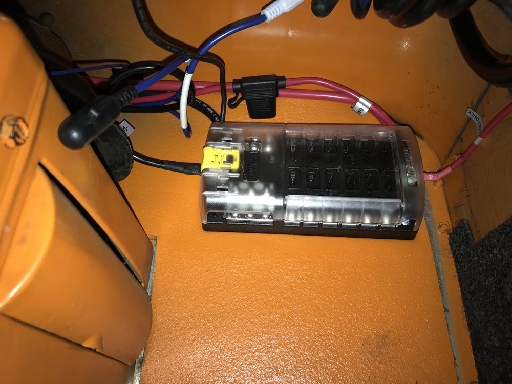

Have to add a fuse block for stereo and future power needs. Can get the 6 gauge power and ground through the existing firewall grommet.
Need to add one grommet through the top of the passenger side dash near the windshield frame and then decide driver of passenger side for new block.
Thinking passenger so I have room for the future wires?

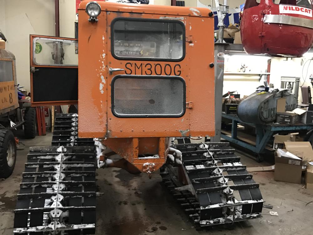

Was reviewing the manual and looking at other machines and noticed the tracks are on backwards compared to what the manual says. Must be the same guy who Tucked up the ice breakers.
Take a look at the photos and let me know. How does swapping the tracks around go? Seems pretty easy can just drive off and back on?
Came with a nice track jack tool.
Unbuckle one track and lay it out on the floor/level surface and lay a chunk of 2x12 out for the bogies to roll onto and then move the machine off the track.
Swap the track and for end and line it up, then roll the machine back onto the track.
Flop the end up over the sprocket and buckle it back up. Adjust tension then do the next one.
There is a good reason for the install direction.
I have seen tracks swapped all over with a mix and match approach, but for normal use being in the forward direction it places the least stress on the belting and helps keep from ripping the fasteners out of the belt.

Wired up the new fuse block and wired the stereo components to that. Used a 30 amp terminal fuse at the battery and 6 gauge wires to the block. Was able to use an existing firewall grommet. Had to add a cable grommet in the dash for a pass thru chase for the sound bar. Few finishing wire ties and should be done. Need to make up the new ground and starter cables also.
Plenty of room for future power needs now but at some point this 30 amp alternator becomes to small if the load increases much more. To go to a bigger alternator would also require beefing up the factory charging wiring which I'm not looking to do.
