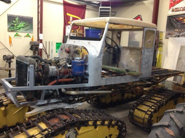

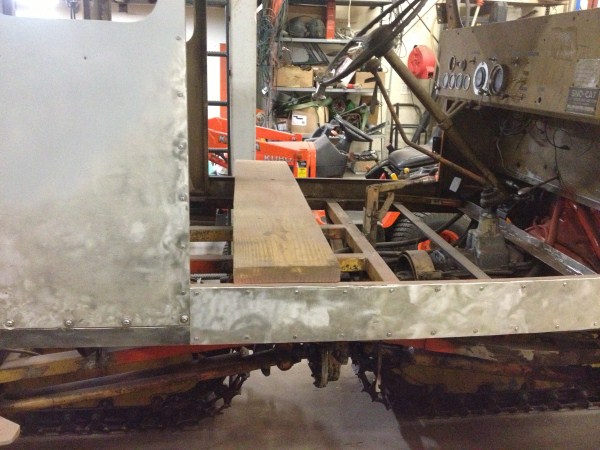

Progress. Friend made me all new 2x4 stake pockets and new aluminum side panels over the weekend. Just slapped them on for the photo. One little trim and it is an exact fit. Much better than what was on there.
Many many hours of welding and grinding on this thing. There were a number of make it happen get grooming repairs. If this was a groomer which I believe it was I am surprised the rear frame is not worse off. It has a little bow to it on the rear. Looks like they pulled it off in live and half ass repaired it. Surprised they did not destroy it.
Fixed now. Adding some supports for the diamond plate. Have a new 12" receiver tube to well on the bottom as a hitch. Almost done the metal phase.

Looks Great B4B!
I've seen some Tucker "repairs" that make you shake your head and say "What were they thinking"? Just absolute mechanical buffoonery.
NICE John Deere!
added in the angle to support the 1/8 inch aluminum diamond plate deck.
Will help stiffen the back imagine as well. The two deck top center tubes. Up by the cab it is 9 1/2 inches and at the rear it is 8 1/2 inches. Don't think that was factory and the rear hack job backs it up.
Good news is the outside is square which I can't see how but it will work.

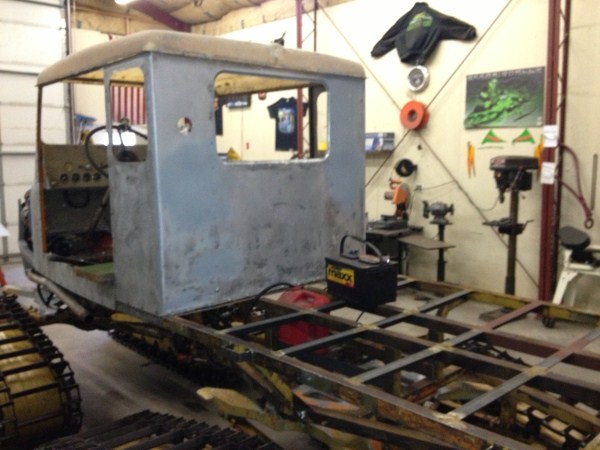

Got some more progress done last night with some help from the boys. Had to go to a wedding in Seattle, WA for a week but made up for lost time last night. Glad to be back.
Added the Diamond Plate Steel to the back to clean it up. You can see how lightly off each side is but not much I could do other than cut the back to pieces.
Added Receiver Tube for hitch.
2x4 stake pockets.
More floor supports.

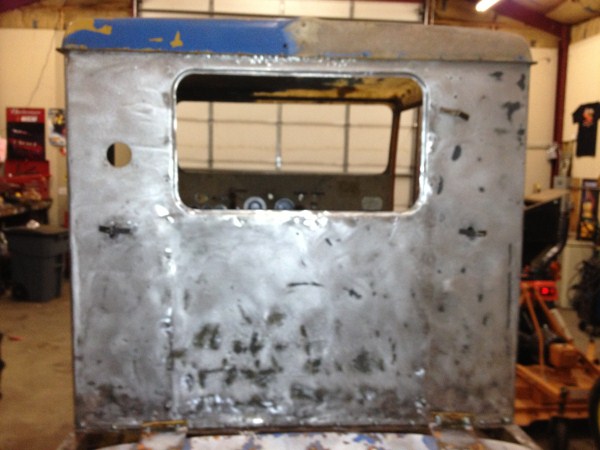

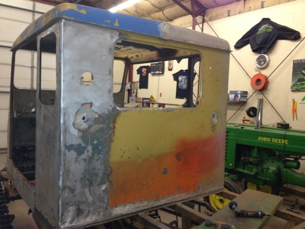

After experimenting with some sanding and priming working with the paint there it was very clear that this thing needed to be stripped down to bare metal.
Found some bondo over small dents. Used a block and hammer and got them back mint. Maybe they did not have blocks and hammers years ago?
This was orange when new. Metal is in great shape. Tried some primer over he aluminum after sanding with 120 grit and it looks good. Some wear and dings etc but I like the character and I am sure I will add some.

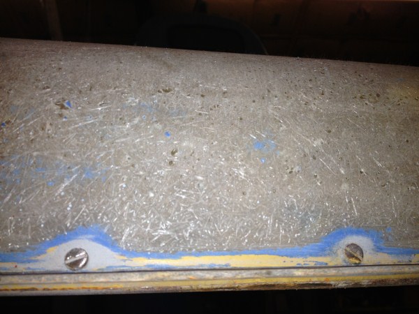

Wanted to update the progress. Sandblasting got canceled. Too much money and I got it all stripped with a wire wheel. Took the two outer layers of paint off with a twist wheel then da it down with 80 then 120. Some areas are done you can see.
The roof is another story . The gelcoat was garbage so I had to take the sides and most of the roof down to bare. I plan on priming it with the then putting this on: monstaliner: http://www.monstaliner.com/
I would paint everything else orange but keep the roof top black. Think it will look good.
As for the inside someone used truck paint so I plan on Rustoleum under coating (paintable) the inside then spraying the orange over it. Did a test area and it looks good.
Little bondo on the back. Should be painting this thing next weekend.

Hammering, pounding, sanding, and grinding this is good as I can get it. Bondo tonight.
Paint this weekend. Amazing what a hammer and block will do on aluminum. The amount of bondo they had on this body they must not have known about pounding dents back in the day.

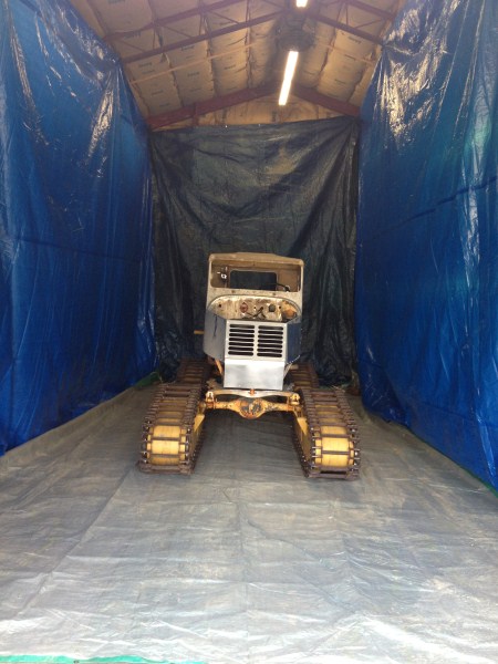

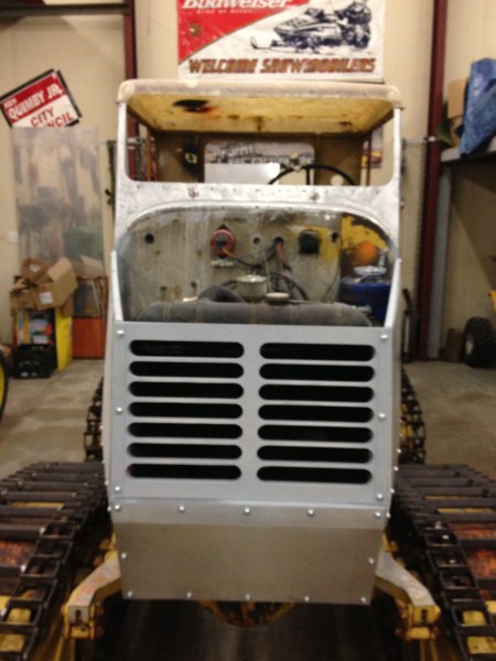

Got some major progress done in the last week. Body work. Make shift paint booth. Tins primed painted.
Used rustoleum undercoating in the cab and roof to hide the trunk paint and some of the body. Stuff works great but is tough to paint over even though it is paintable. Took a number of coats in the cab to cover the black.
Few touch up spots underneath. Tractor supply alice chalmers orange close enough for me and I can get it in brush and spray can form.
