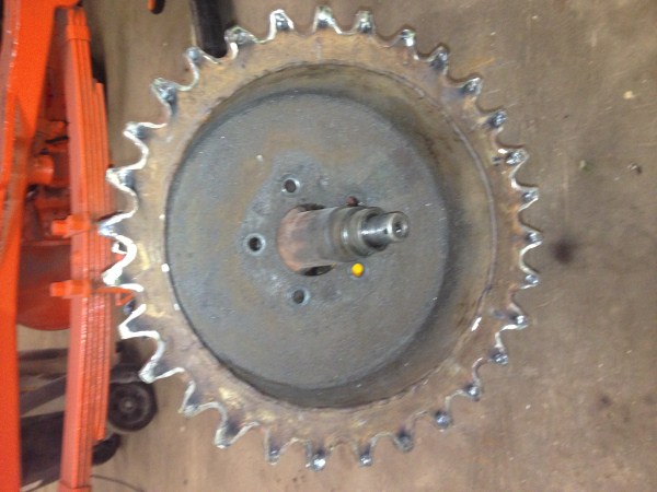

One pontoon done. Fixed the sprockets. One was welded already and one was not. Had to replace 1/4 of the teeth on this one. Seem like adding a little piece of metal and some weld makes all the difference in the world. Also it appears mine have run the same way for their lives. Putting the sprockets back on opposite sides will allow them to push on the side of the sprocket that has never been worked.
3/4 x 1/8 steel at Home Depot seemed to work well for repairing the teeth.

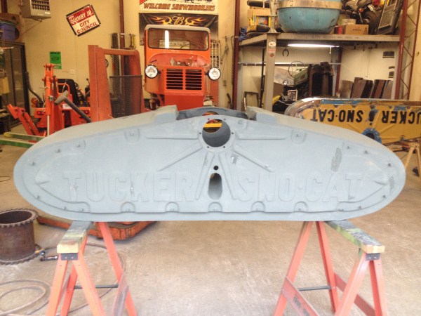

One Pontoon Primed. As I stated before this is suck part of the project. The other front pontoon is almost done as well. I am holding off the rest of the season for the back two. They seem to be in great shape compared to the front so I hope they hold up. i will continue to work on my spare and swap them but it will be time to start using it soon.

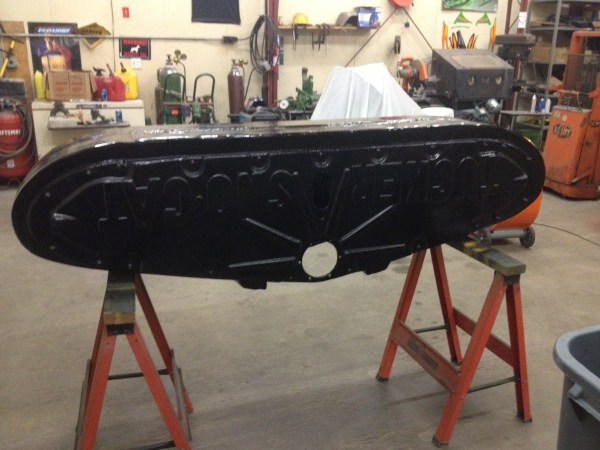

One pontoon done and painted. New bottom shoe built out of 10 gauge so should hold up for my lifetime. Had to drill the holes on the bottom rail a bit to allow for the thicker gauge and repairs to the pontoons. Test fit and ran some track and rollers around. Feels good. Hoping to have one back on Wed.

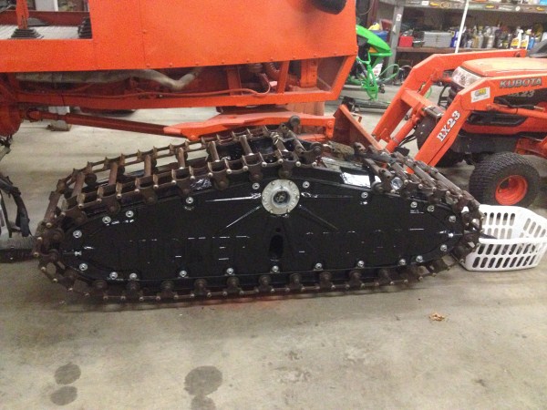

shoe and rails on. Putting on Tuck tonight. Will be off until next Wed. Heading north for some fresh powder. Snowboarding and riding my other cat this weekend.

Adding the washer to the bolt adjuster worked the nuts. Pushes on metal on the when you adjust them rails now.

This went on smooth as silk. Turns easy feels good. Think I can take both half links out add full links and drop one grouser.
