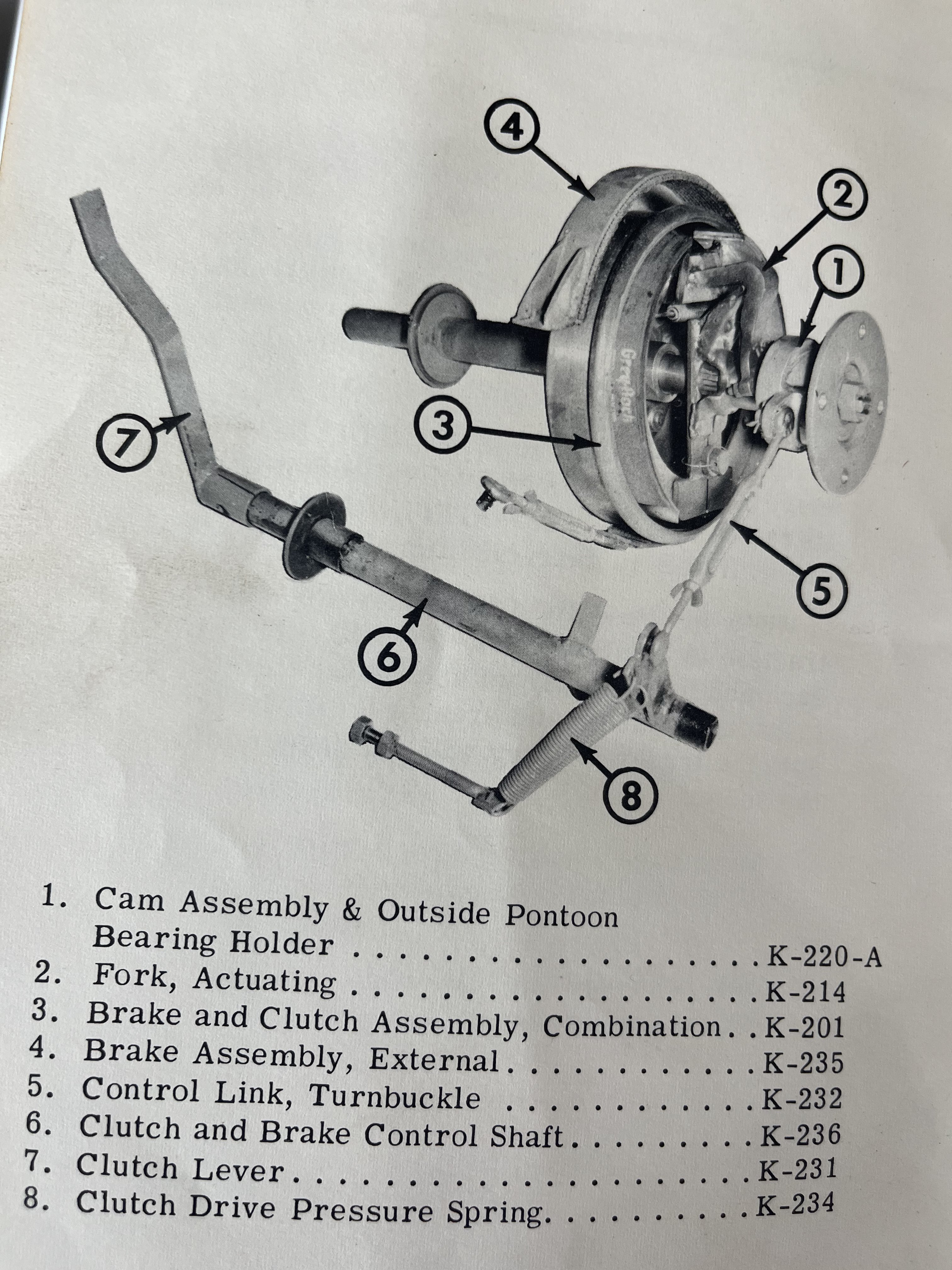

Hijack not intended, Hey kitten people. Have a question about a nut / clamp on the clutch side of the working assembly.
If you look in the detail just above item numbered 5. you will see a bolt, clamp. it is tie wired in the image. I am servicing a kitten clutch and brake assembly. the shoe return springs are different left to right. the space * set * by that clamp on the shoe holder is also different.
my thought is this clamp is a rough assembly setup piece, ( not addressed in manual as it would only be adjusted if the drum was changed) I feel it allowed a varied tolerance to the machining of the drum.
so I call the brake shoes the clutch
the external band the brake.
I can't see a reason for two different length springs, the shorter spring side will over travel the brake shoes out of the ramp. with the longer spring the travel stops with the brake shoes in their respective runs. this condition lets the Stick have some predictable free play, I feel this would help the setting of the fulcrum to the ramp out by the bearing. I have only driven a hand full of kittens, and not one of them was the same in operation feel. after playing with these clutch brake deals, I can see why.

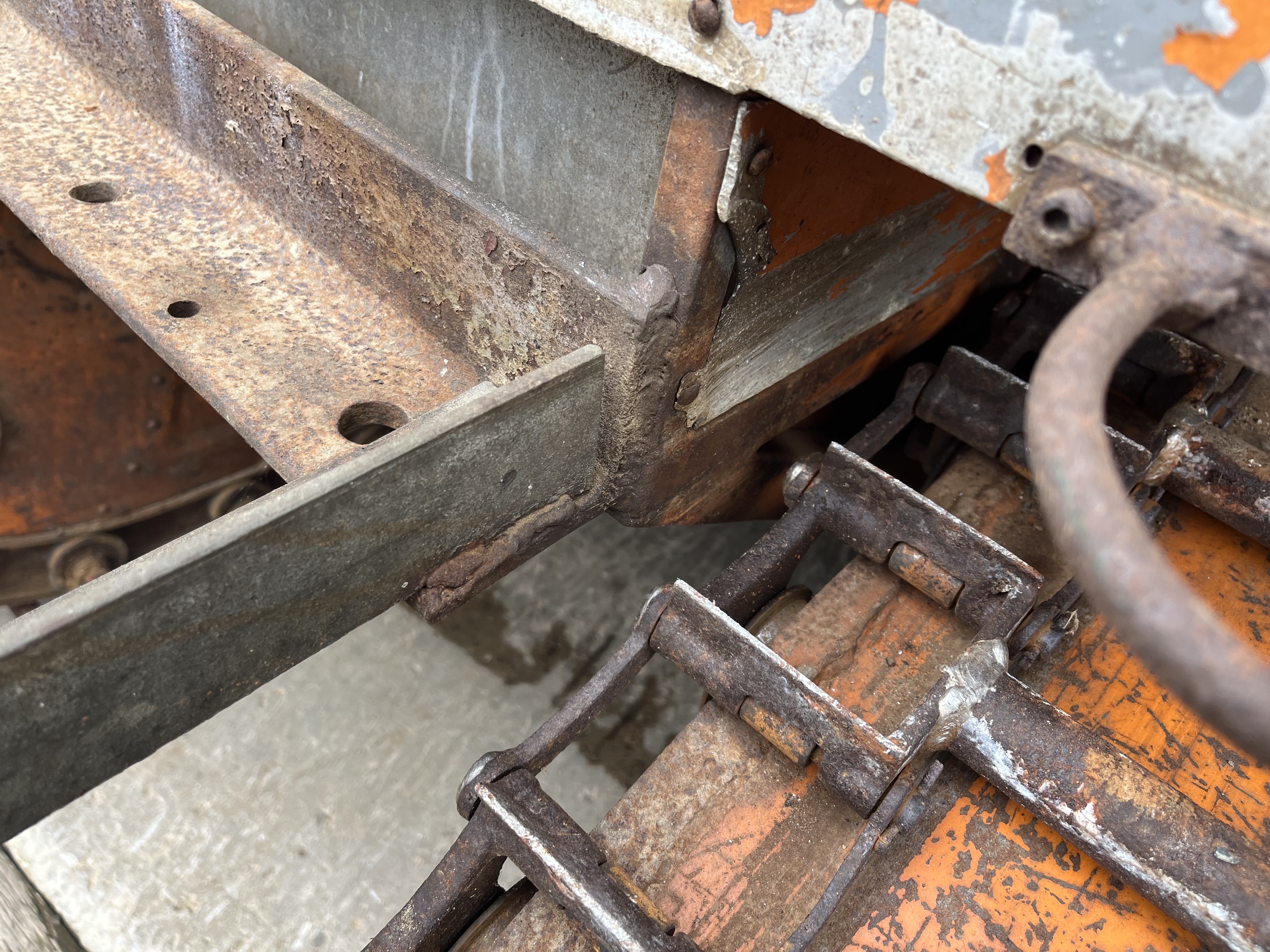

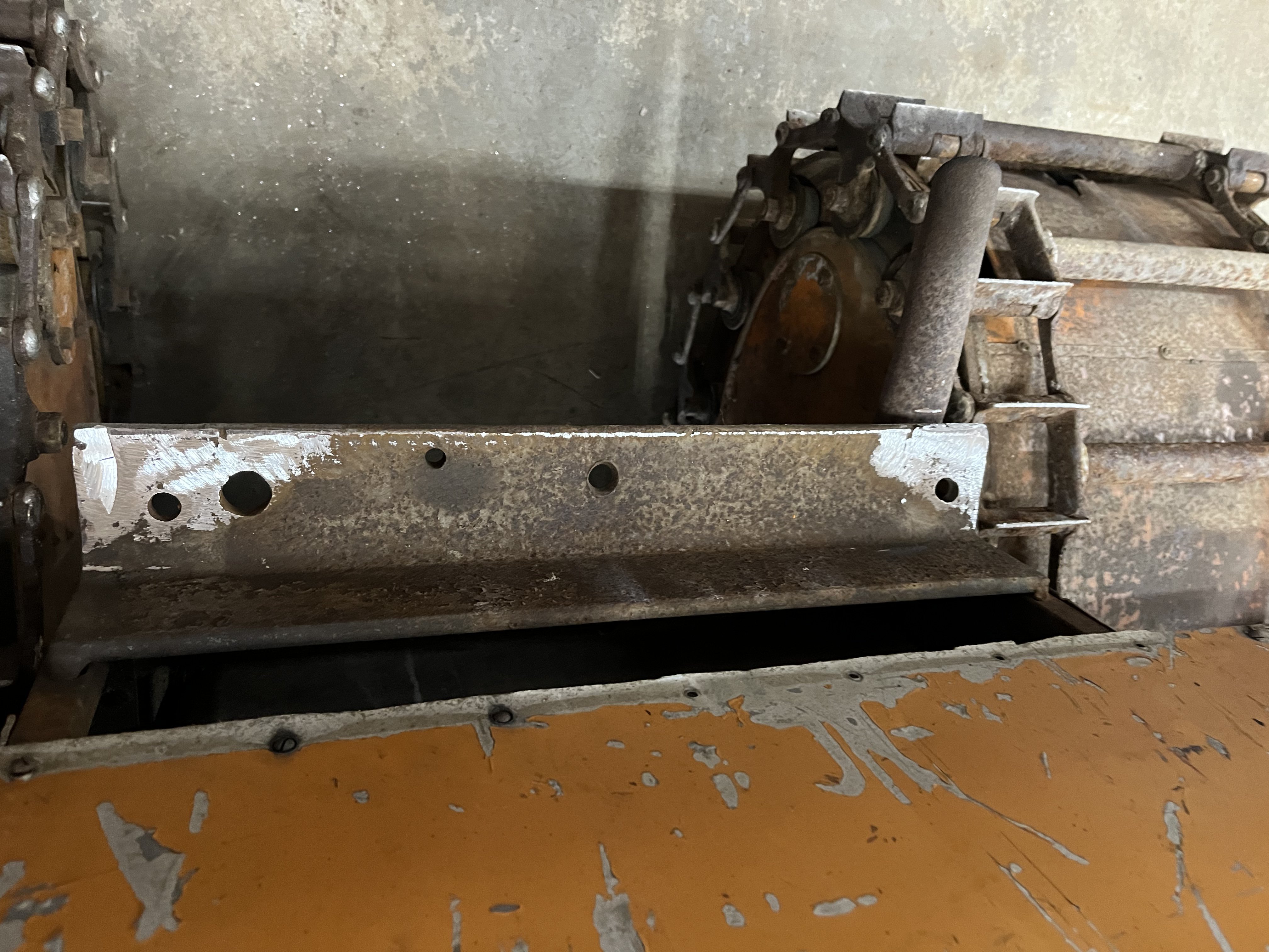

Removed the rear ladder attachment which was in poor condition.
I left the angle that was added. On the last picture you can see the original tow bar hole was worn out from the down hill.
Have some vintage implements I intend to resurrect for show so will utilize what’s there. Welds are decent and will look worse to remove.

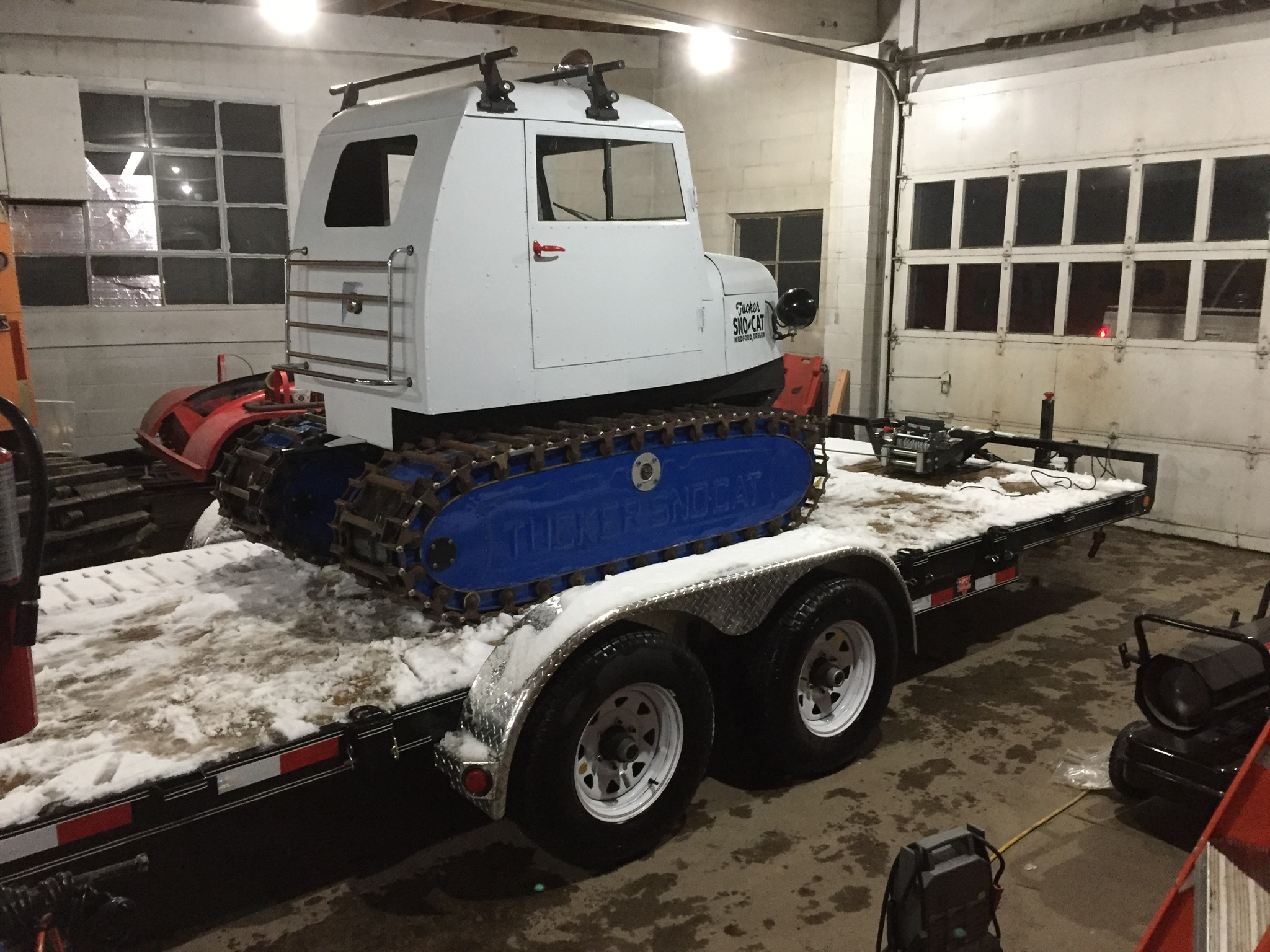

Our purpose modified Under Cover Kitten with a rear rack from a Triumph Spitfire. Perfect for a waterproof Pic-a-Nic basket.

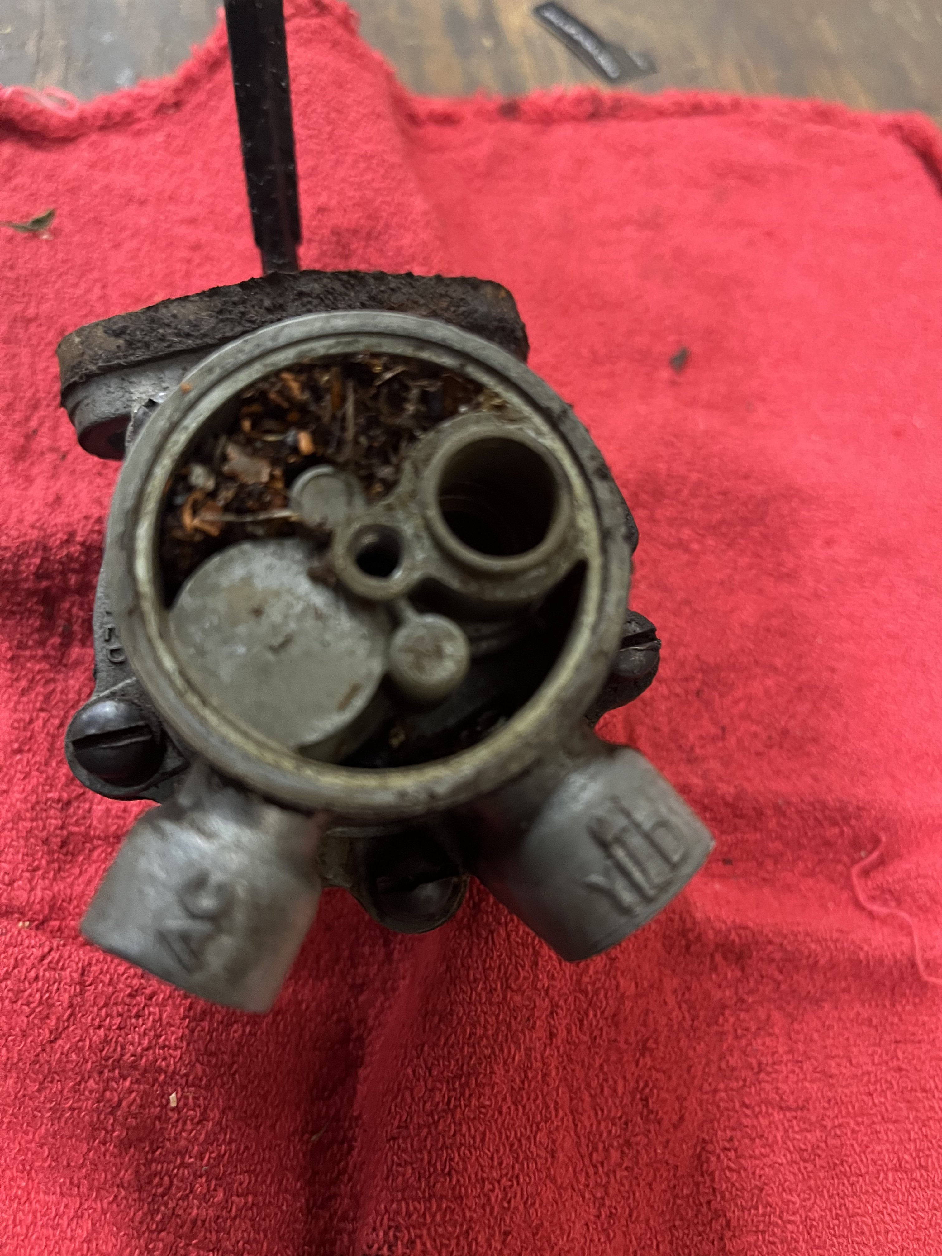

Out of summer slumber. Started right up but was starving for fuel on acceleration. Feared the luck of not rebuilding pump and carb had run out at the worst time.
Fuel didn’t seem to be flowing through the sediment bowl. Had a new ceramic filter yet to be installed. Pulled it apart. Cranked the motor and plenty of fuel was pumping.
This has a Carter Magna trap sediment bowl. There is a magnet in the top of the housing above the ceramic filter designed to catch the rust particles in steel fuel lines. Cleaned and reinstalled new gasket and filter running great. Carter part #30-82

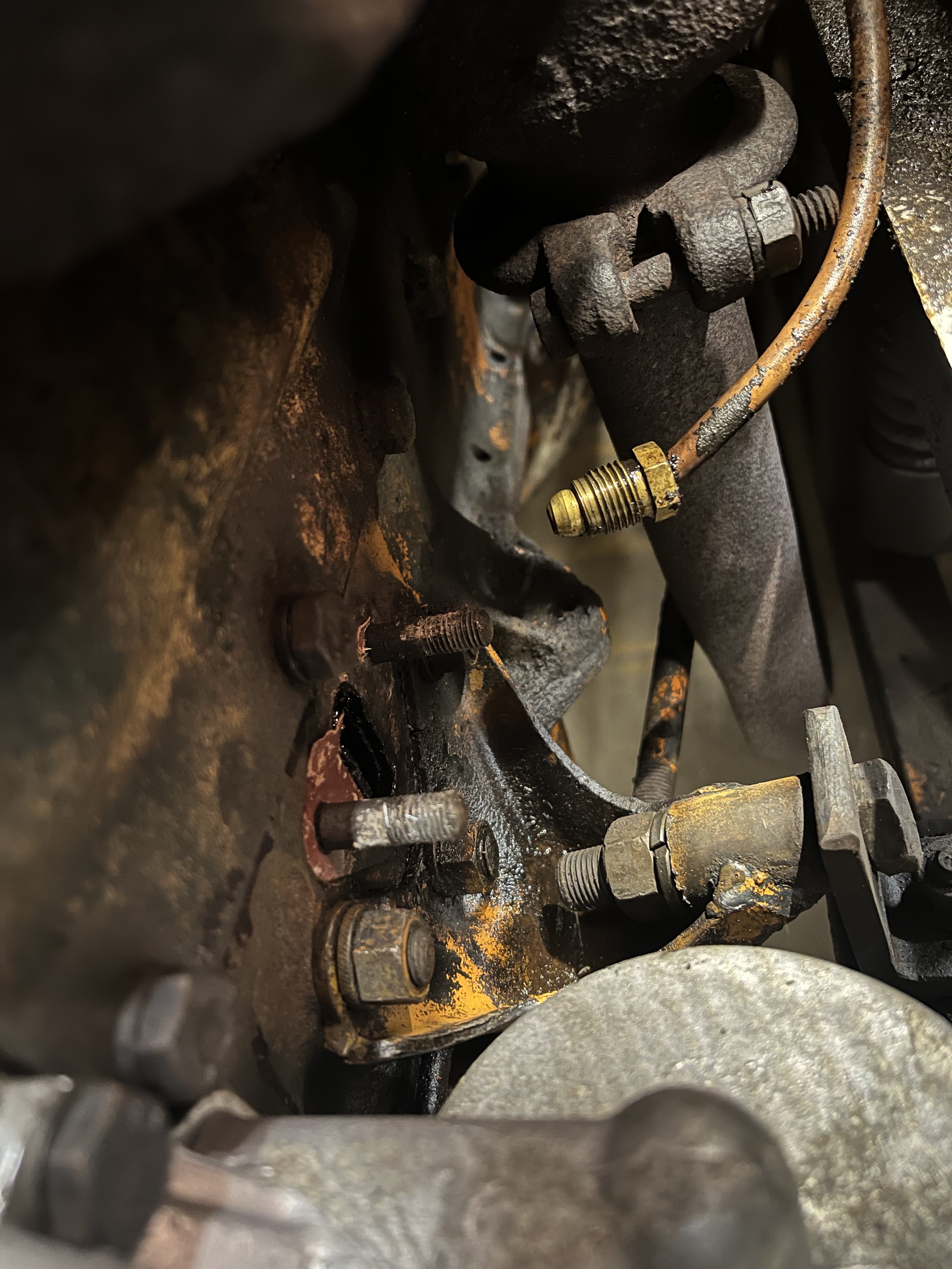

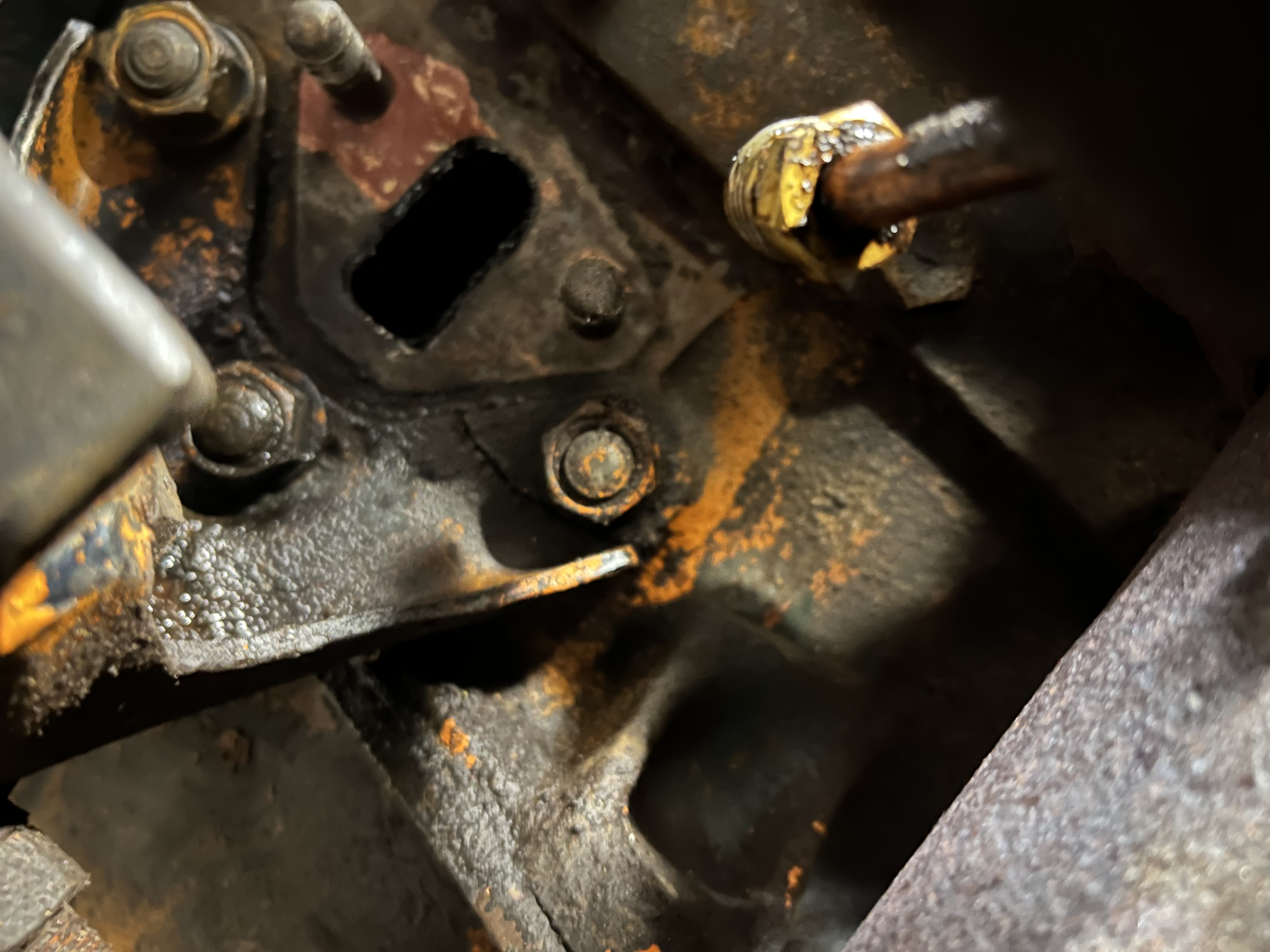

Been trying to figure out how to get the fuel pump out. It appeared that a pontoon needed to be removed to unbolt from the outside or exhaust intake removal from engine bay. Maybe motor removal?
Then I remember the springs fall out from the chassis moving up and down. Jacked the front up a little and there was my access from the outside right above the track with a socket and extension.
Rebuild pump this week then install. Will get to the carb right after.
This kitten motor has Ford Anglia mounts which use rubber and is unlike earlier. Sits on the lower frame rail where others were mounted to the upper frame rail solid with no isolation.
The frame at one time had the earlier style mounts I can see were removed. All the welds and paint match as being original.
My guess is they had frames already produced at this point and modified to this upgraded style. Other theory is this was a Sno Cat Corporation of New Hampshire upgrade.
Looking for pics of other 58 or newer to compare.
fwiw the 5mm spacer you have, controls your fuel pressure. if you don't have the 4-7 consider taking .030 off the plate. I learned this the hard way.
check the clearance of the #4 spark plug, I was told the motor mount help the plug from firing to the firewall.
My plug is far away from the firewall.
That spacer is what the manual refers to as an insulator on post 56 ish motors.
There were different engines in the Anglia over the years with different fuel pumps. These also used different mounting studs and spacers.

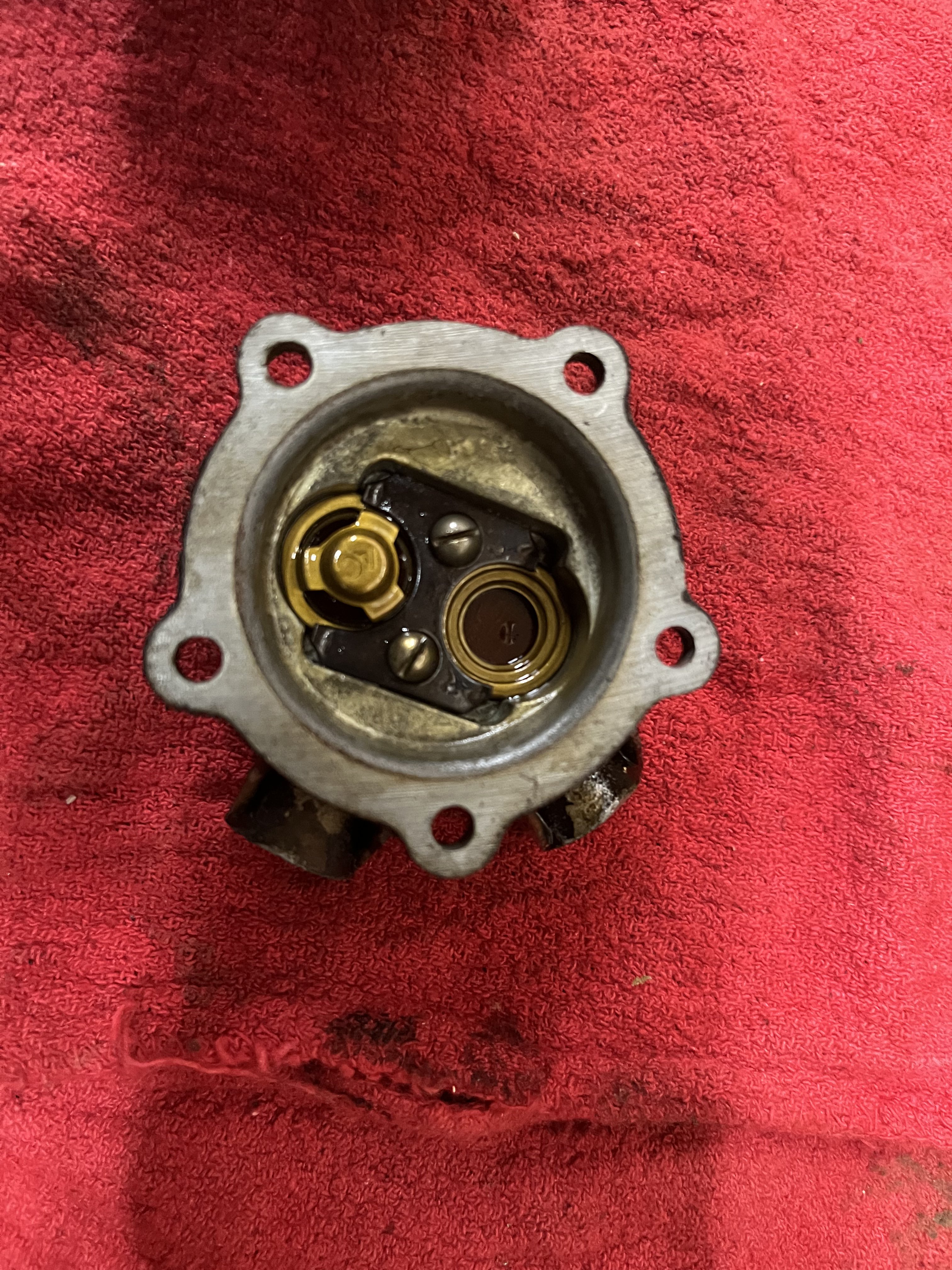

The earlier ones had a hand primer on the petrol pump and were fitted with a 6mm-1/4" spacer. Later ones around 1953 like this one used a 8mm-5/16" spacer. Some models of this motor in other cars used no spacer and a glass top bowl.

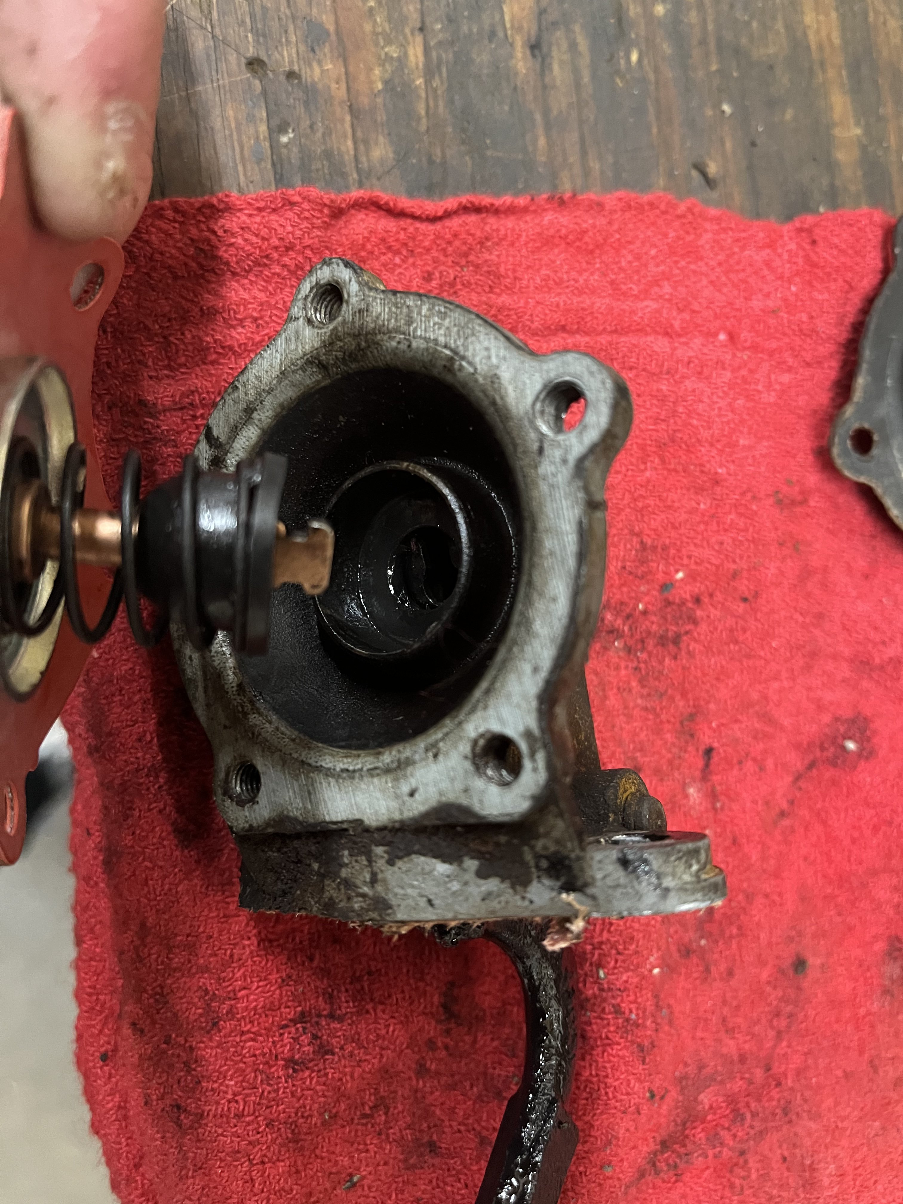

Kit only came with one gasket but the spacer required one on each side so will have to order another along with a new spacer. Gasket pretty stuck to this one on both sides.

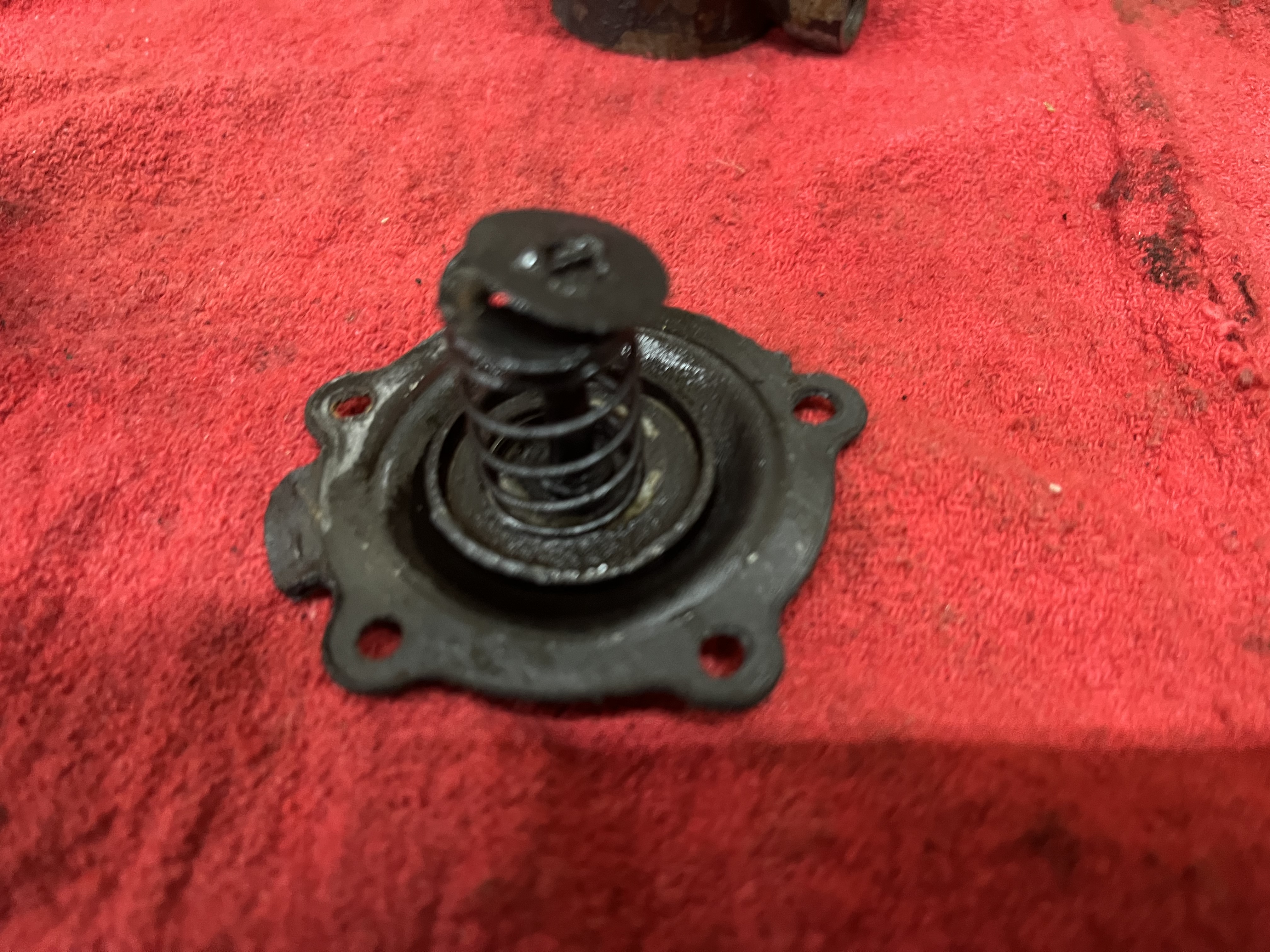

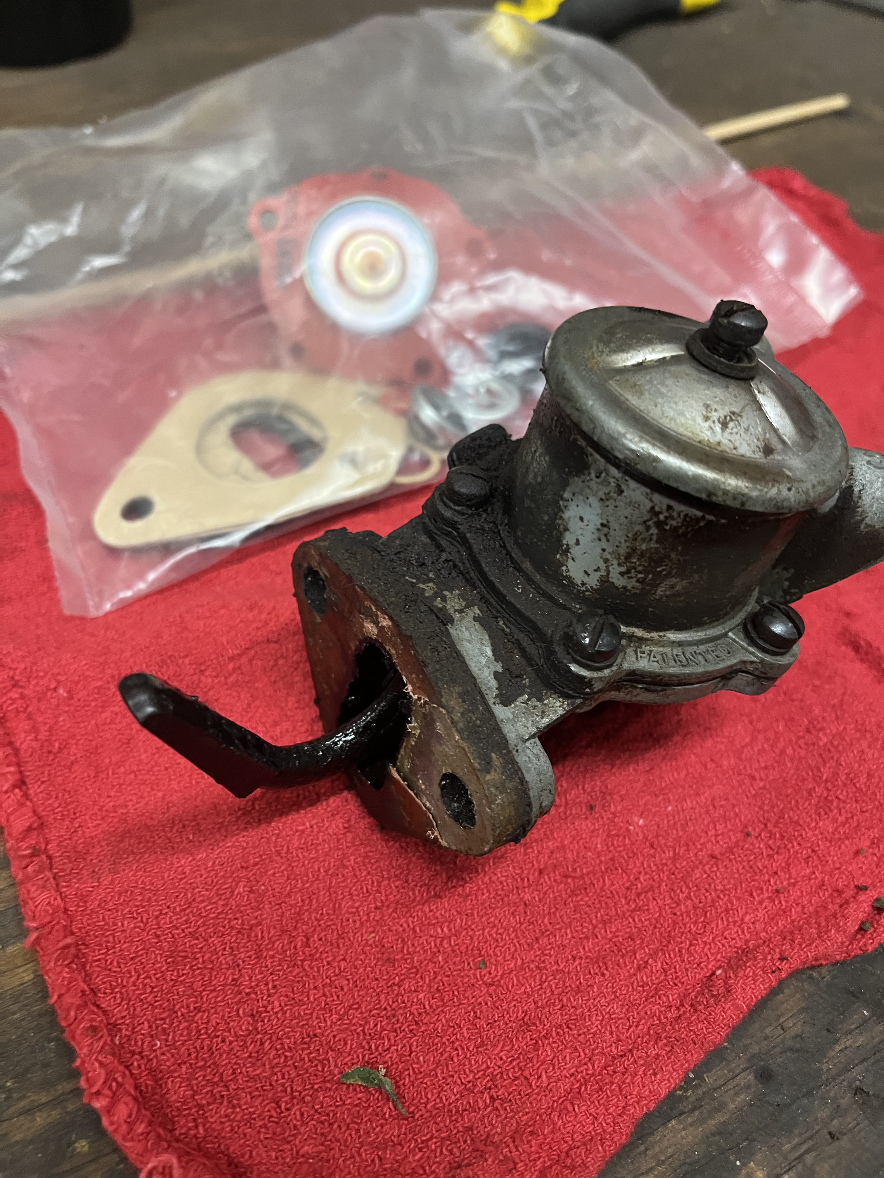

The oil seal around the diaphragm shaft was a source of oil leaks over the years.
The bottom of the pump is vented to atmosphere. In some instances oil would make its way into chamber and leak/blow out of the vent hole. Later they added a oil seal washer and a rubber gasket.
This kit uses a better rubber grommet that further improves the seal. Here I temp installed to illustrate old vs new.

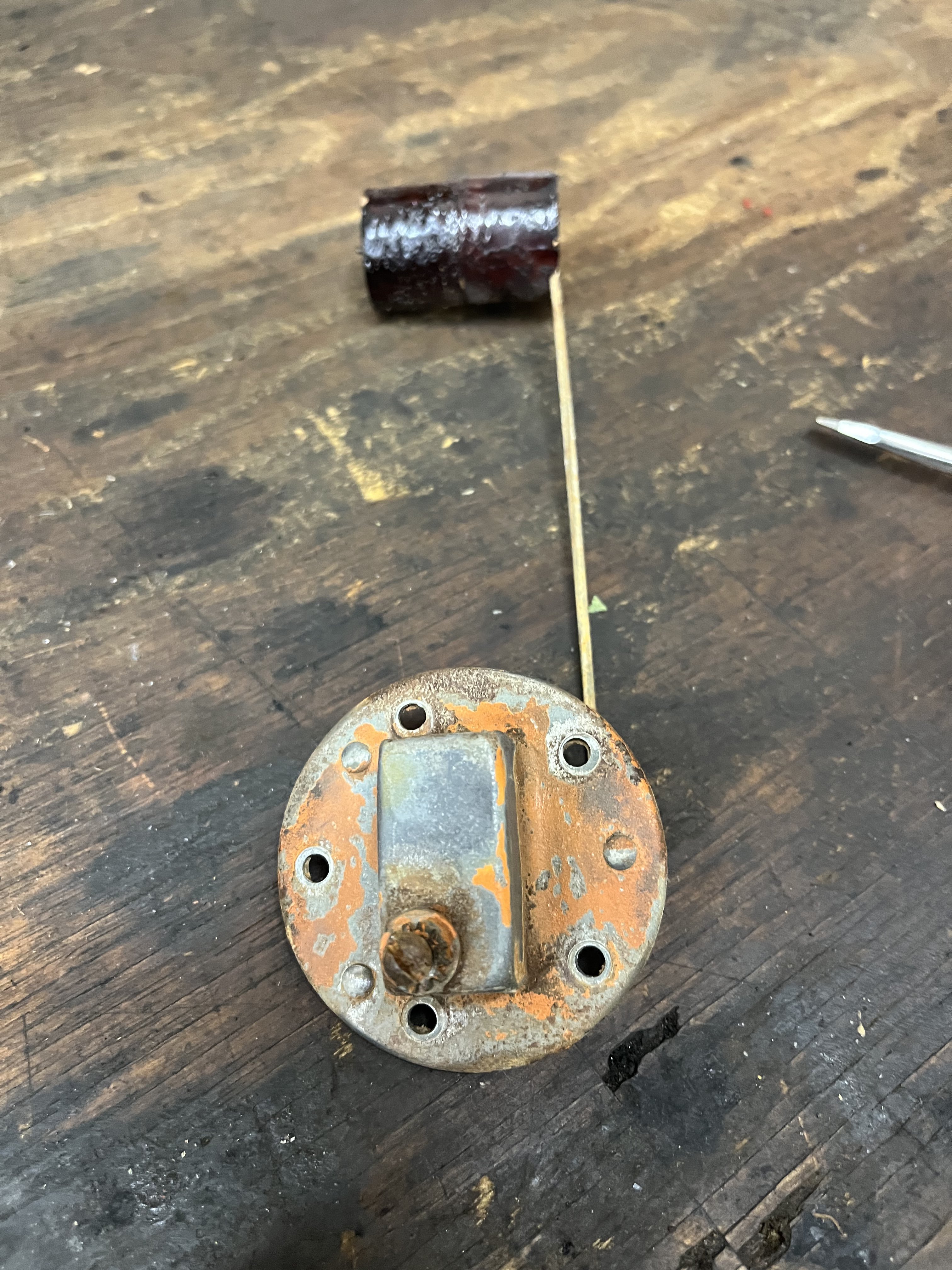

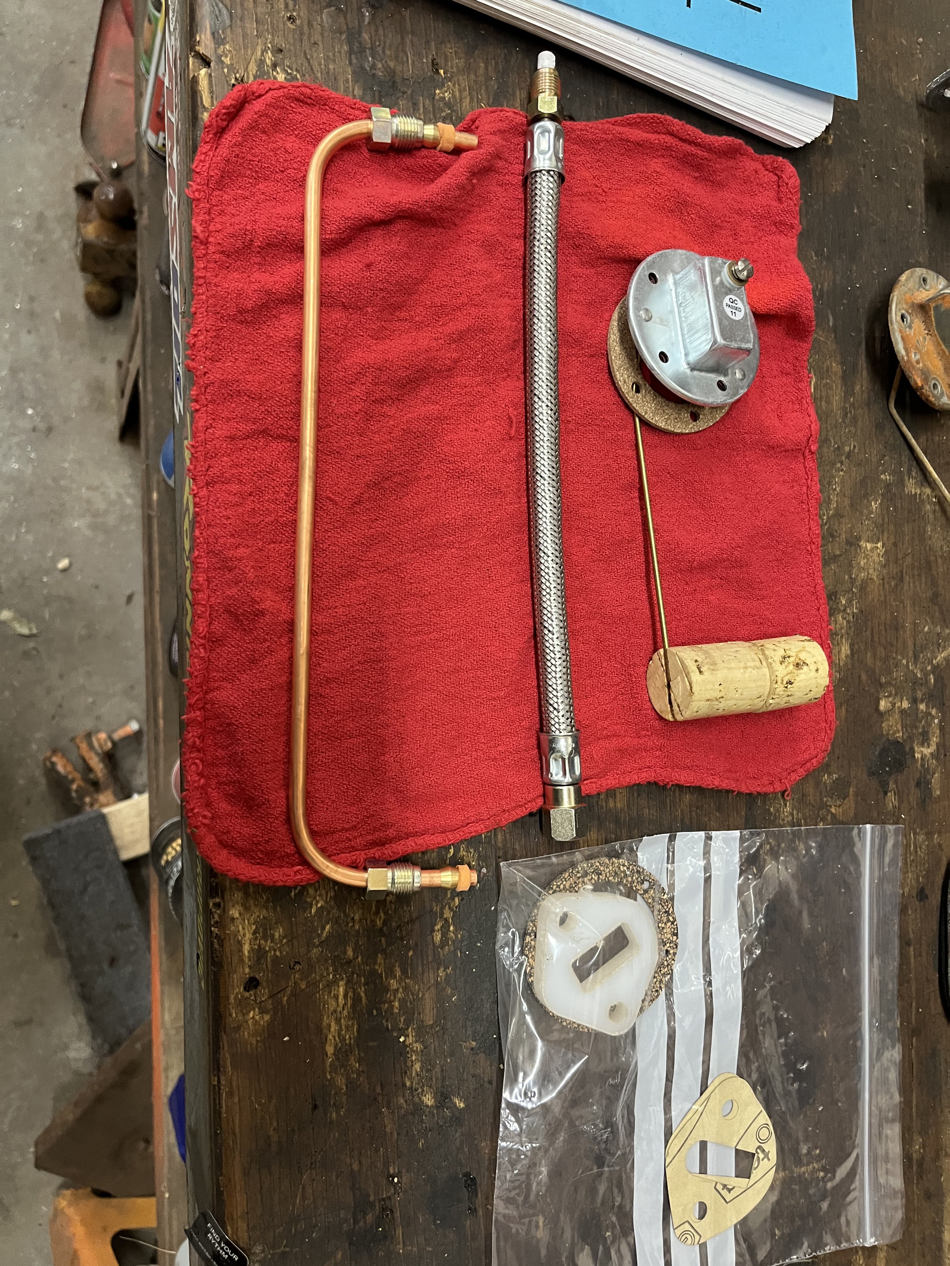

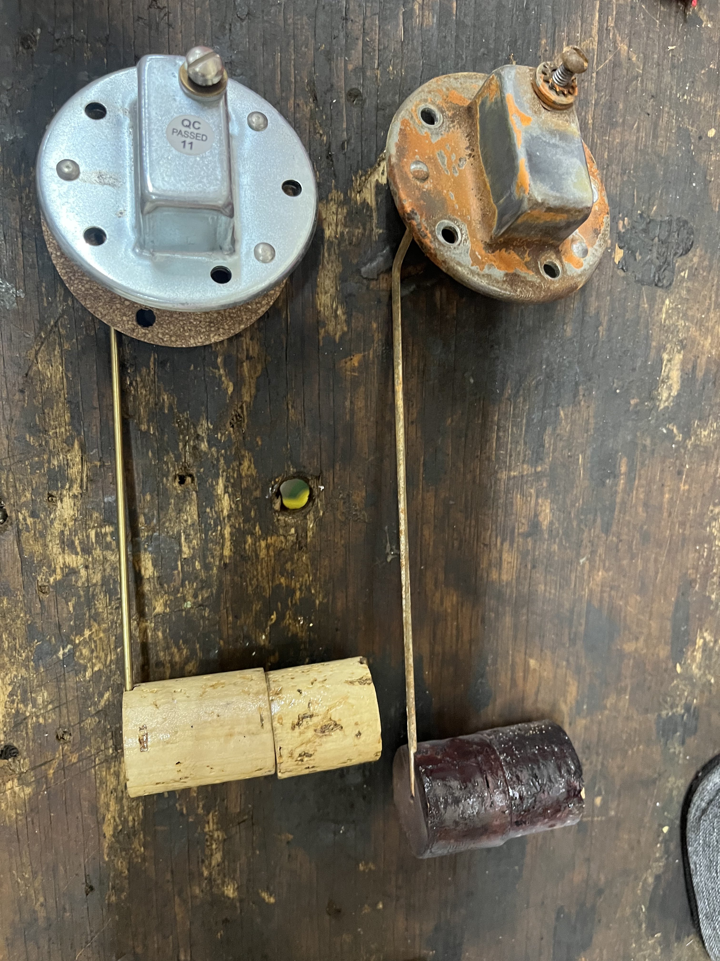

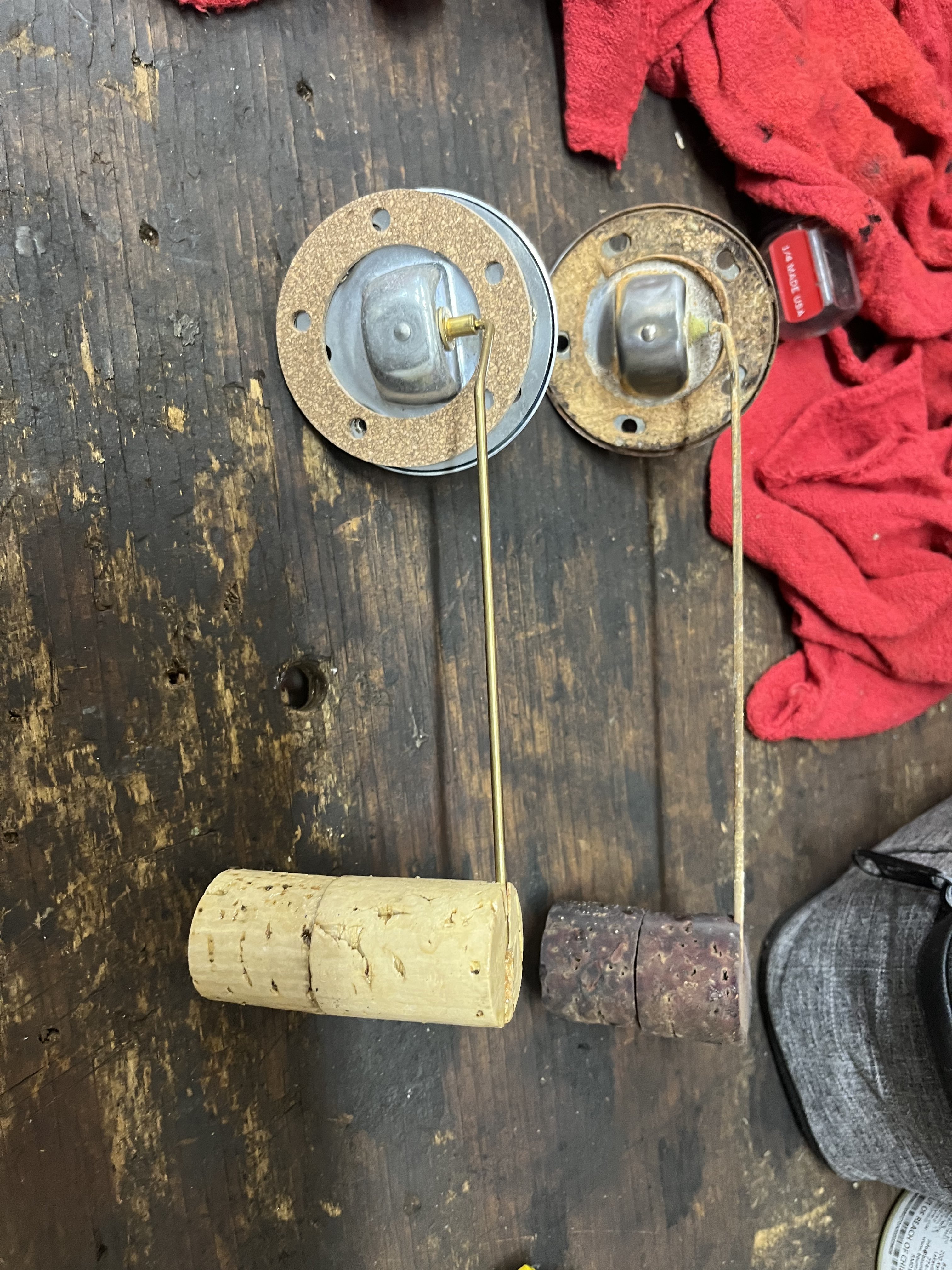

Took the fuel sender which still works out for a look. Not too bad.
My synopsis is years of metal fuel cans, open fuel cans, run whatever fuel cans, brought the shells, wood chips, rust, and dirt I can see in the tank.
Will pump out the fuel again dry and vacuum.
