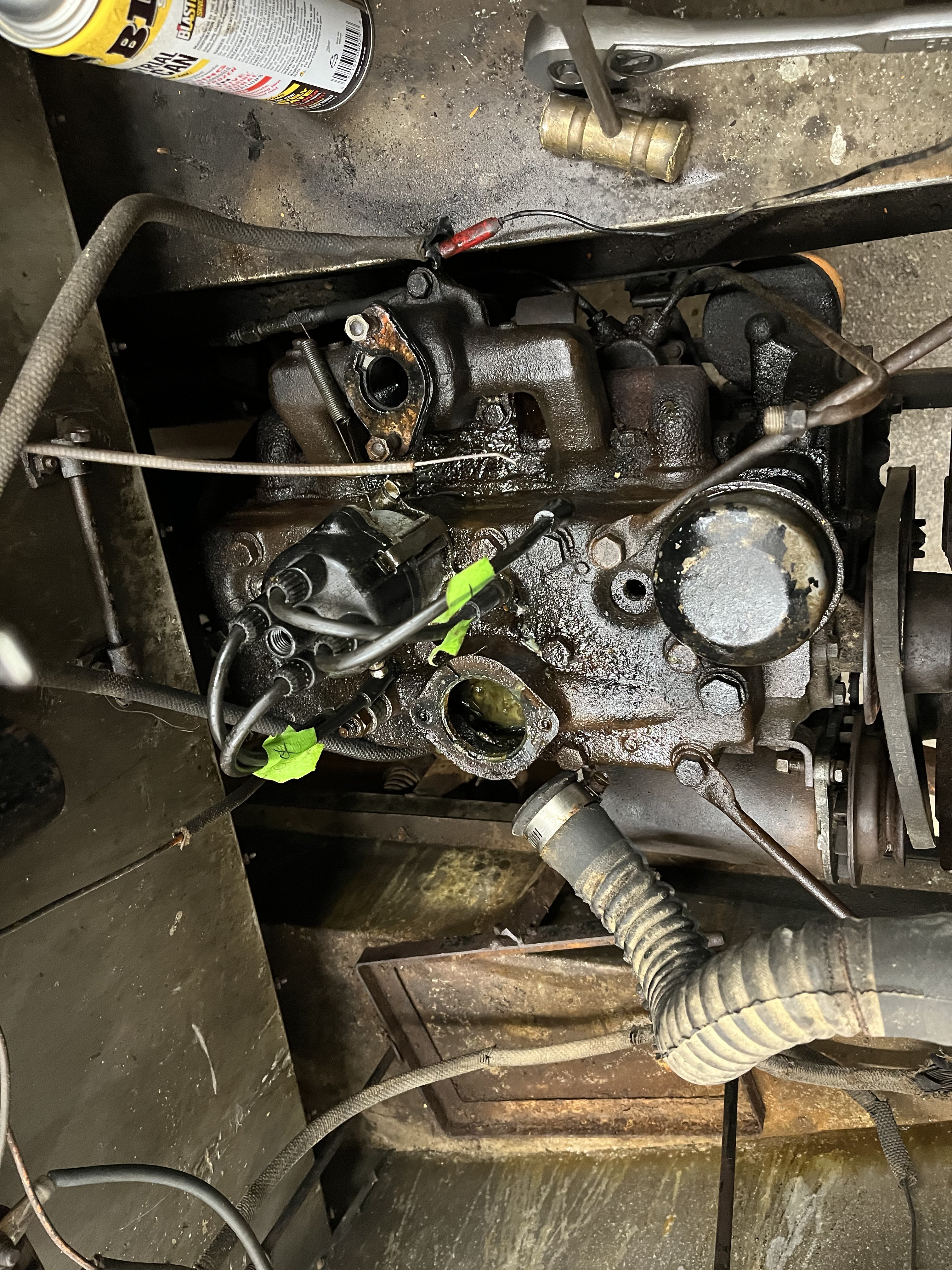

Motor is stuck from sitting. Took the starter out and drained down the antifreeze.
Soaking the hardware with PB blaster in preparation of removing the head to see what is next.

Few tweaks is all this Original specimen needs as well.

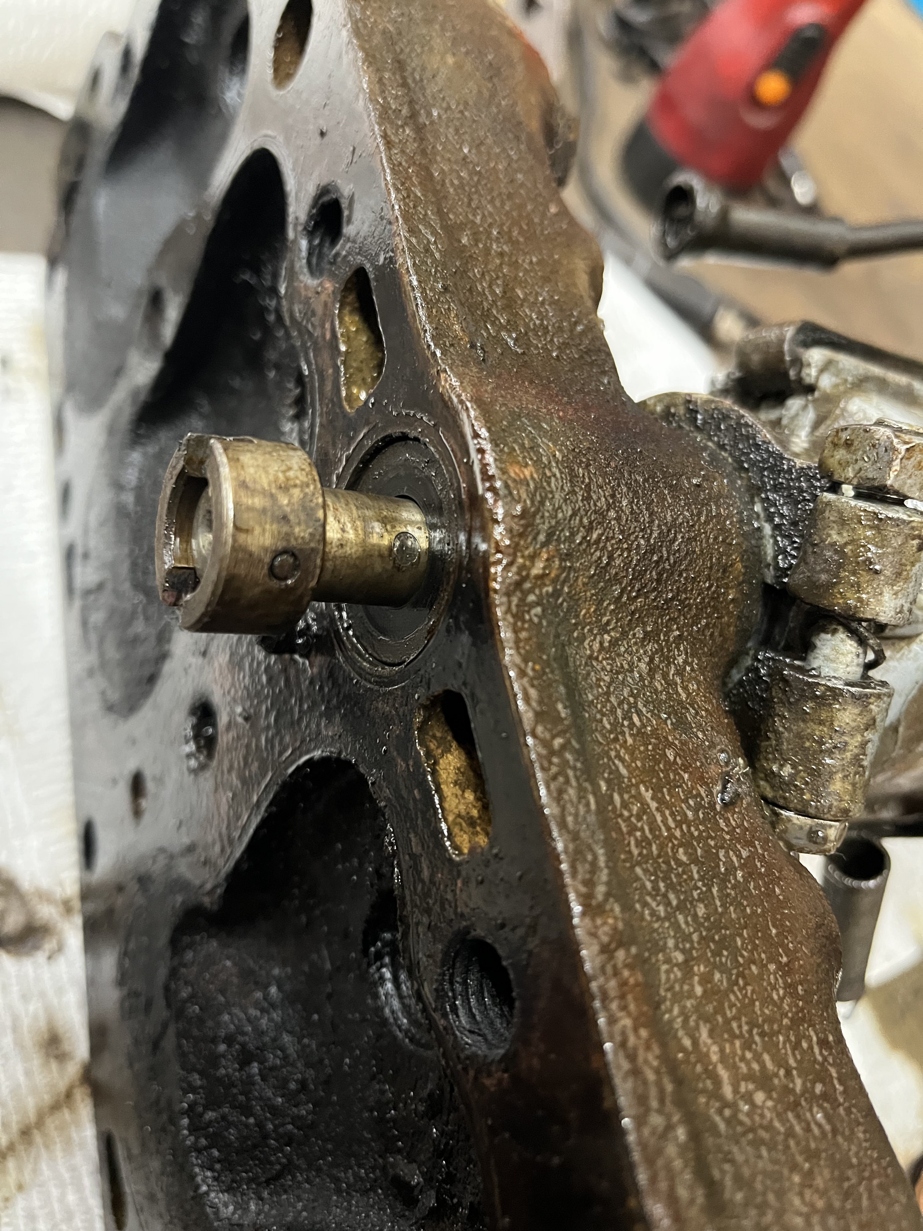

An Elf came to me and shared this wise proverb: “look past the stuck distributor to what is a head of you”.
Trick was to remove the head with the distributor attached.

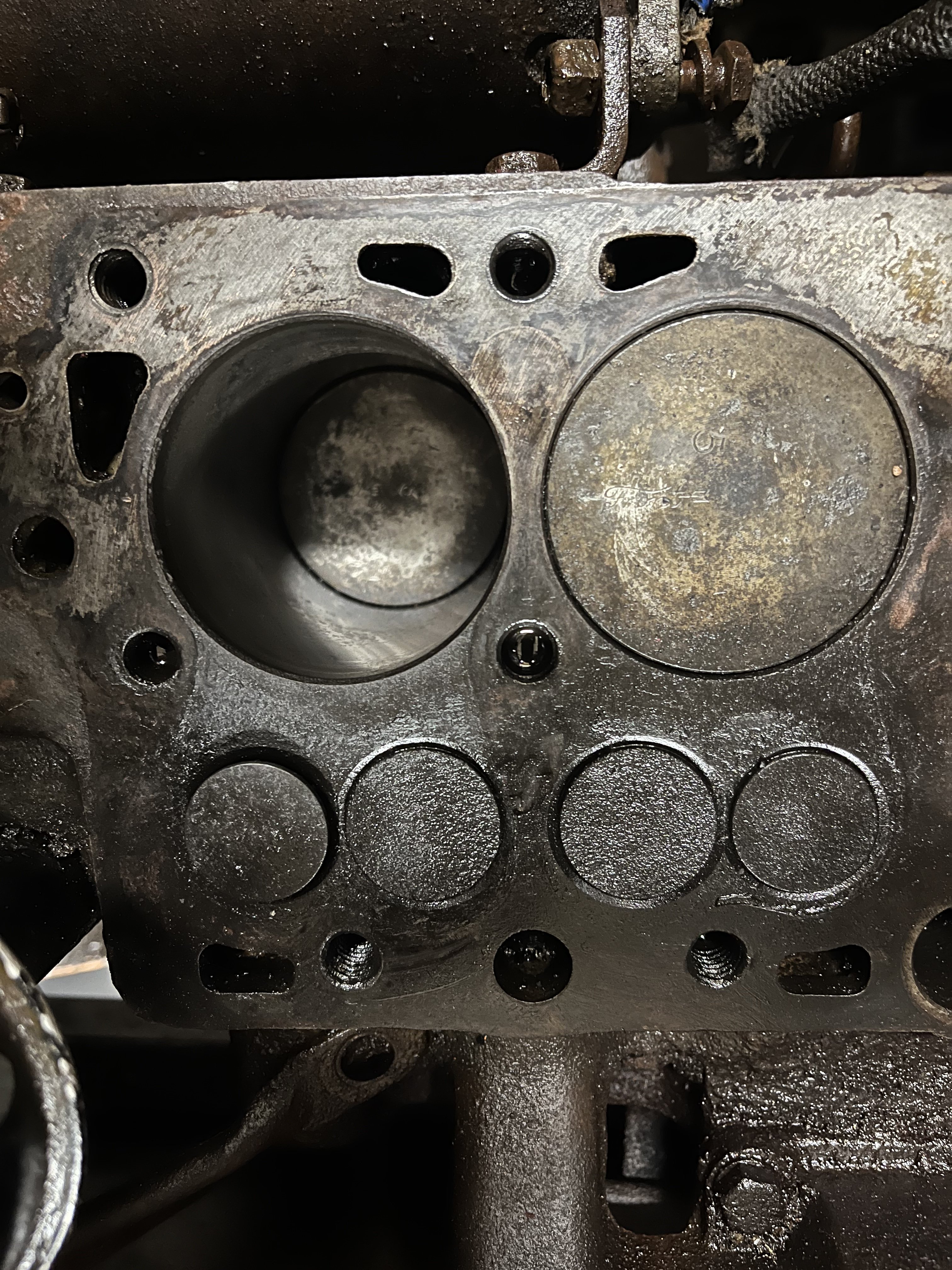

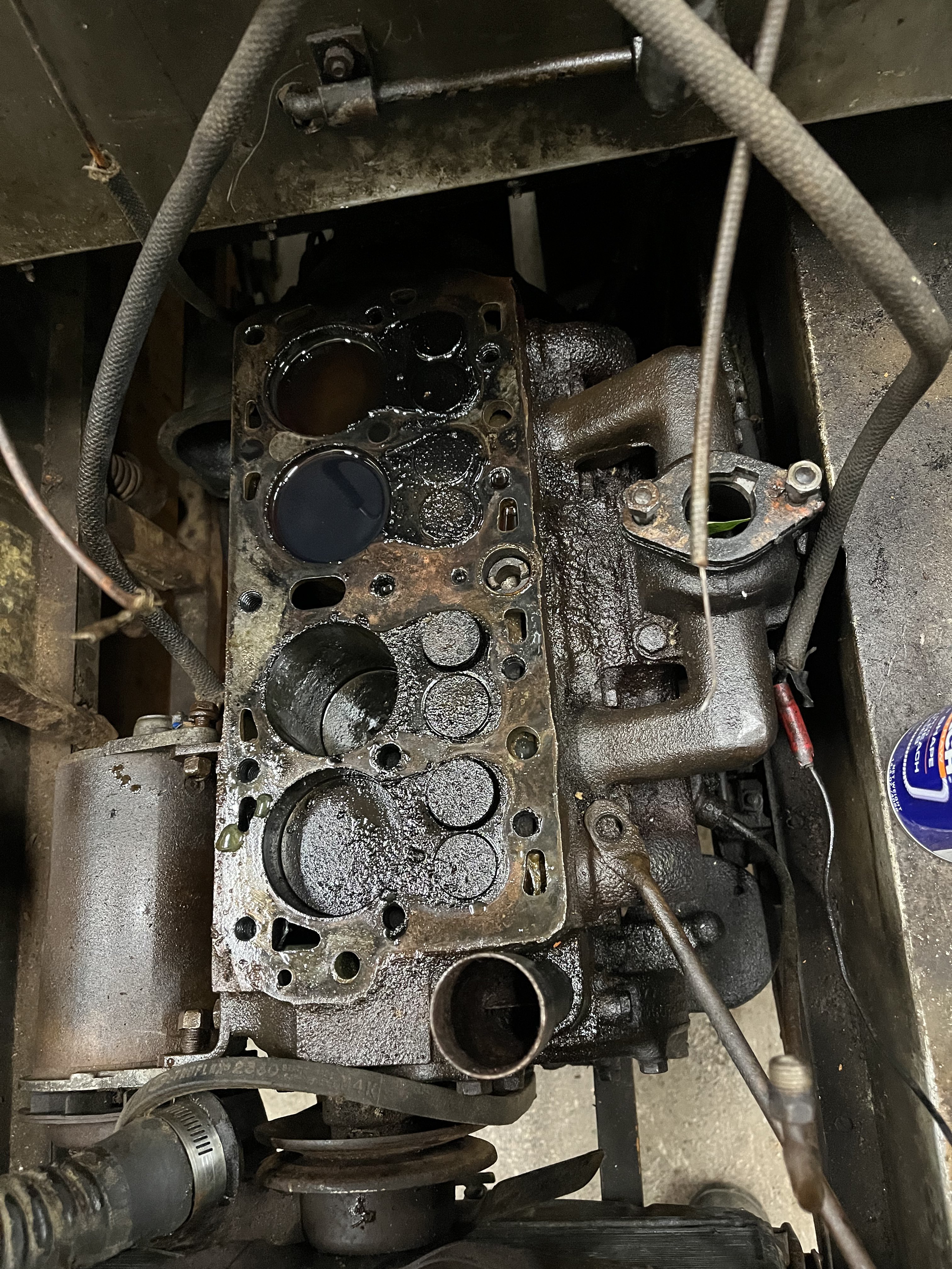

I shocked all the bolts with a large snap center punch. Outer head bolts loosened quite easily. Middle 4 gave the sensation of oh no but broke free. Was able to lubricate and remove all successfully. Head came right off.
Cylinder walls look great. Little tapping and I can see it move. Going to let soak.
Drained the oil that looked very clean no signs of moisture.
Distributor can now soak from the bottom and top as I work on removal. The drive gear pin rotted which may have been an issue or would quickly become one. Rebuild while it’s out. The lower adapter came right out.
Looks like the makings of a runner!

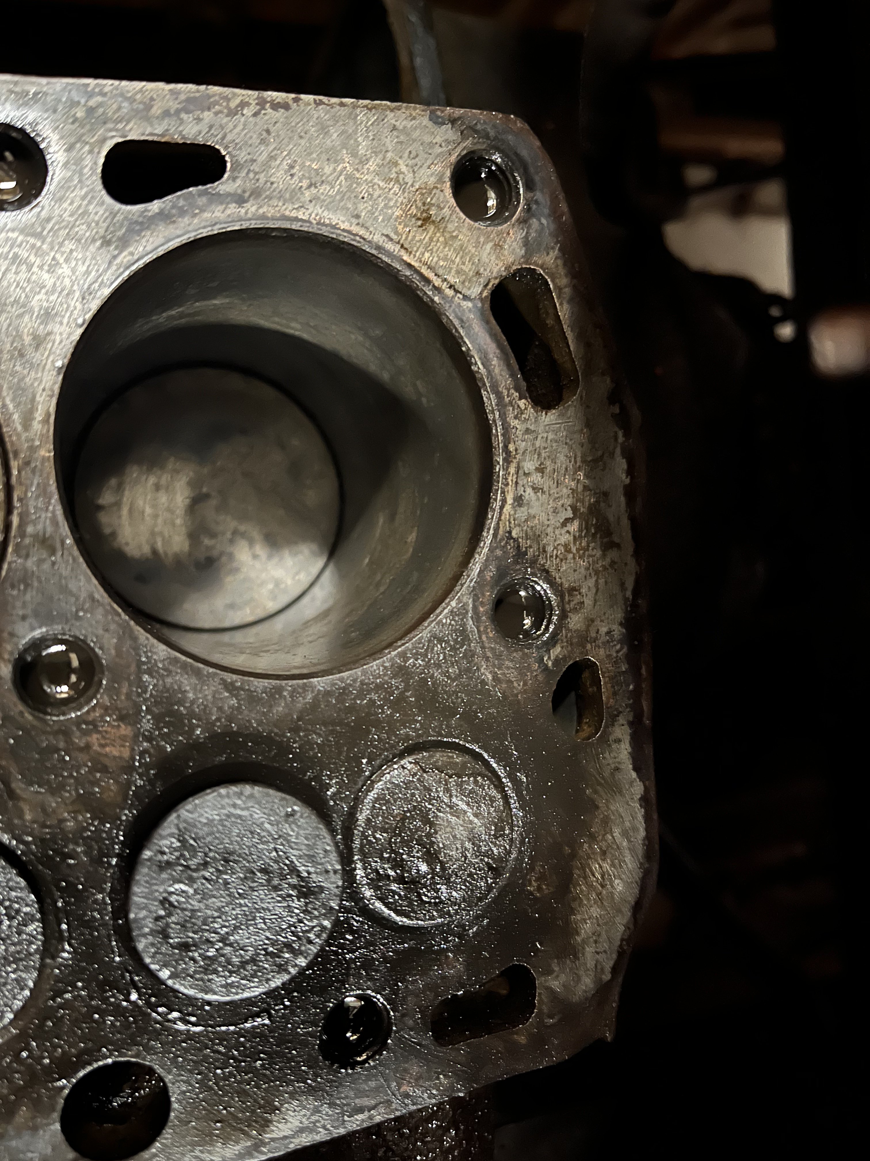

Cleanup continues process. Notice one of the valves has been changed in life because it doesn't match the other seven. I recall the son mentioning something about the rear cylinder valve upon pickup.

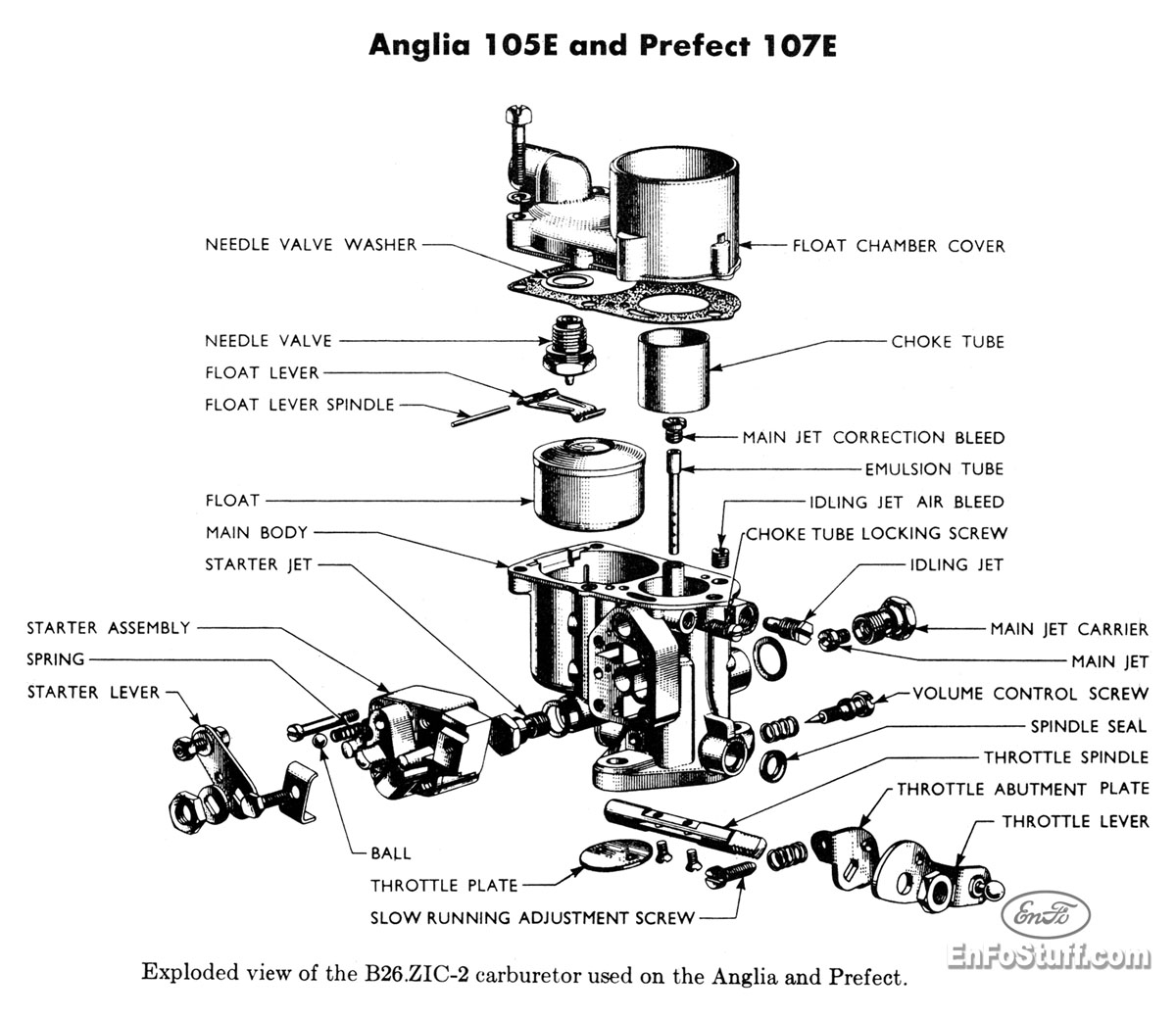

Carburetor: I rebuilt my Solex and reassembled it the same way it came apart. Well this was a mistake because it had been apart at some other time in it's life and the starter assembly (choke) was assembled incorrectly. I finally found a picture showing the correct orientation for the disks (#24 and #38) to be assembled, it is crucial the slots/holes are in the correct orientation. I have attached that here in case it can help.

One last thing on the carburetor rebuild. The issue with those disks is that they can go in front wise, back wise, or 180 degrees out, so that is why I blew up that one image so you can see the correct orientation. Just saying this because it was painful trying to figure out what the problem with mine was.
