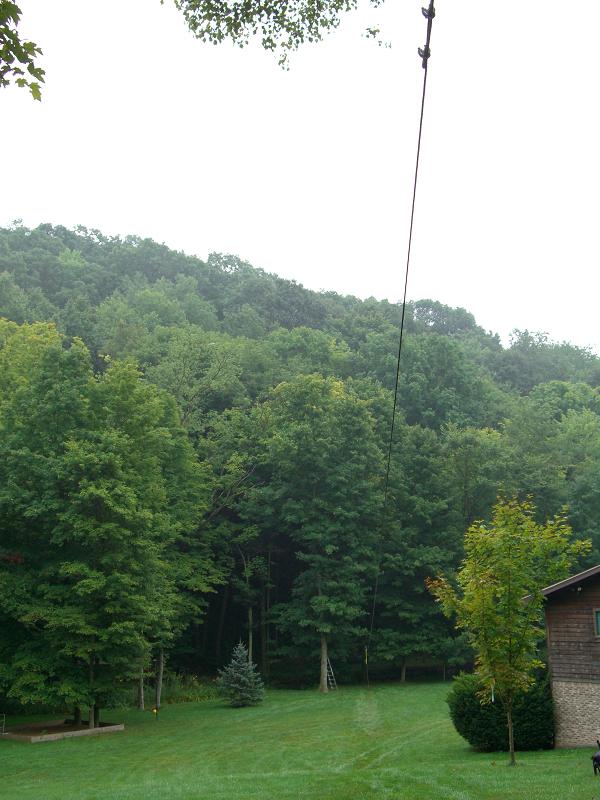

OK, I just snapped a picture of it (below).
The strap hanging from the trolley is visible at the very end of the ride (to the right of the ladder).
At the near end, where I snapped the picture, the cable is about 12' in the air. I part the RTV under the cable at this end and you stand in the box to launch. This is kind of a safety feature. The kids can't reach it to ride unless I put something like the RTV under it.

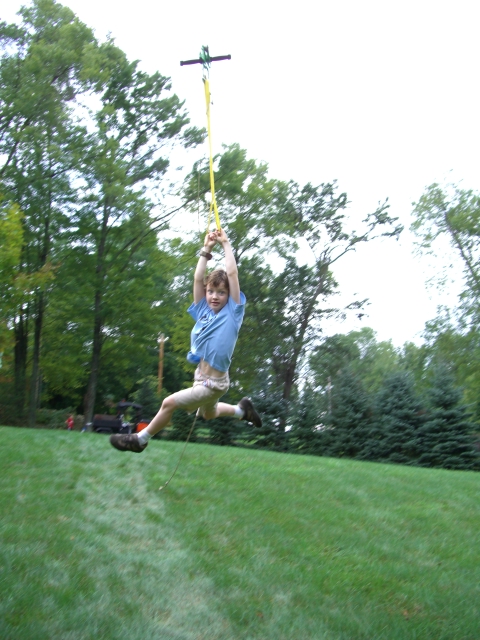

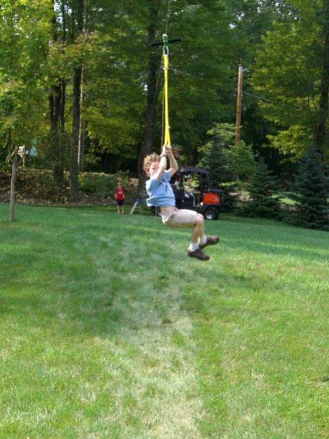

A couple pictures from today.
They may look and act like they're moving slowly but where they are in on the line, they're whipping by pretty darn fast.

Looks like their wrist have a band around them to prevent them from falling off as they go down the line??
You are gonna have a path wore down through the yard like a dog on a chain till they slow down using it. Good to see them out doing something instead of playing video games.
Say what Steve?
I see a sort of watch or band on Brian's little guy's wrist, I don't think having a kiddo attached to one of these things would be wise.
Oh per Mule's post, dig a zip trench! :w00t2:
Yeah it probably is a watch. But to me having a loose fit band and holding you to the trolley would be better than falling at the speeds Brian talked about.
True I suppose, but watching that kid, he looks positively fearless and fit.:yum:
They are on their own. They know they're ****ed if they hit the end of the trolley.
